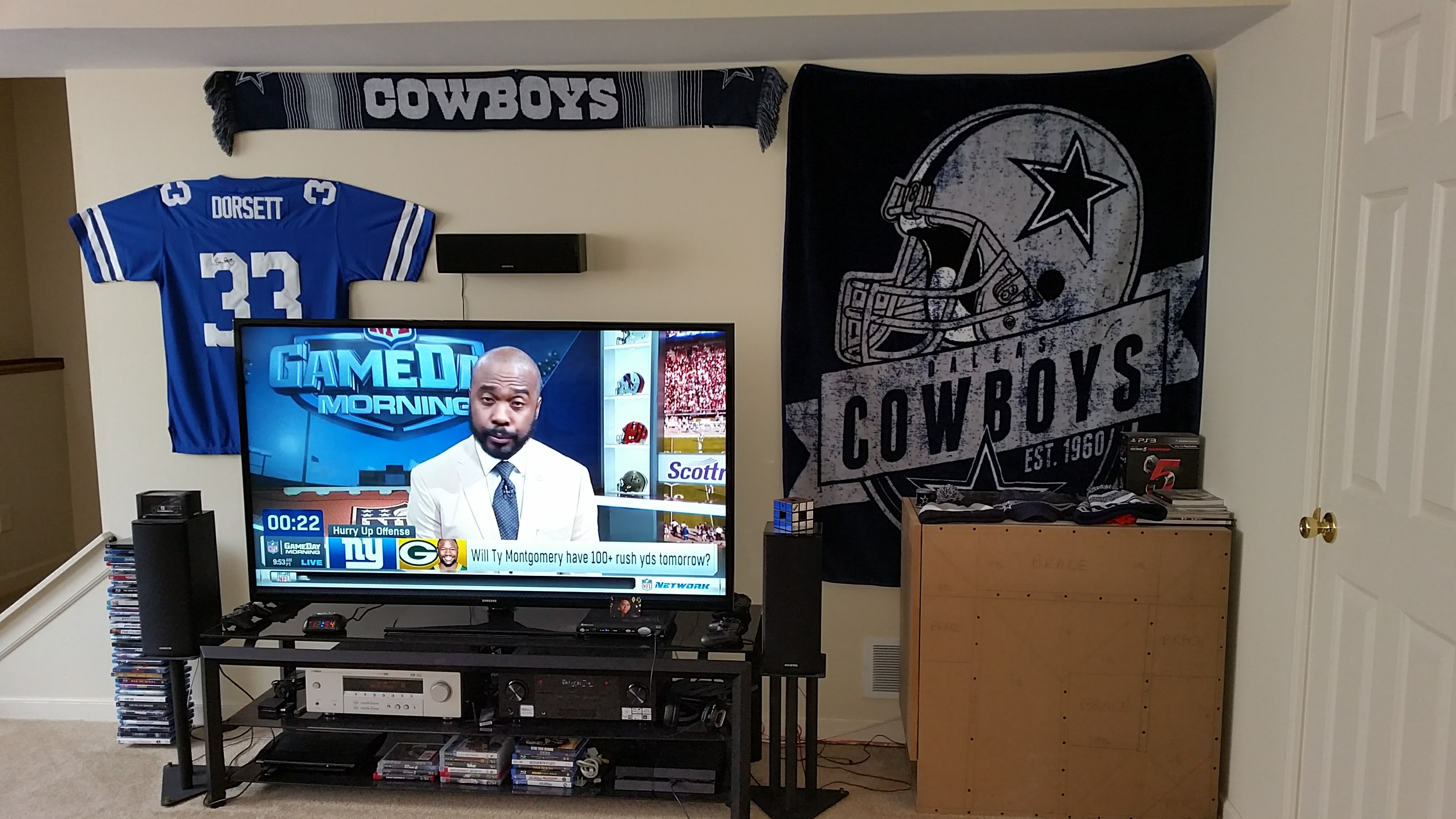

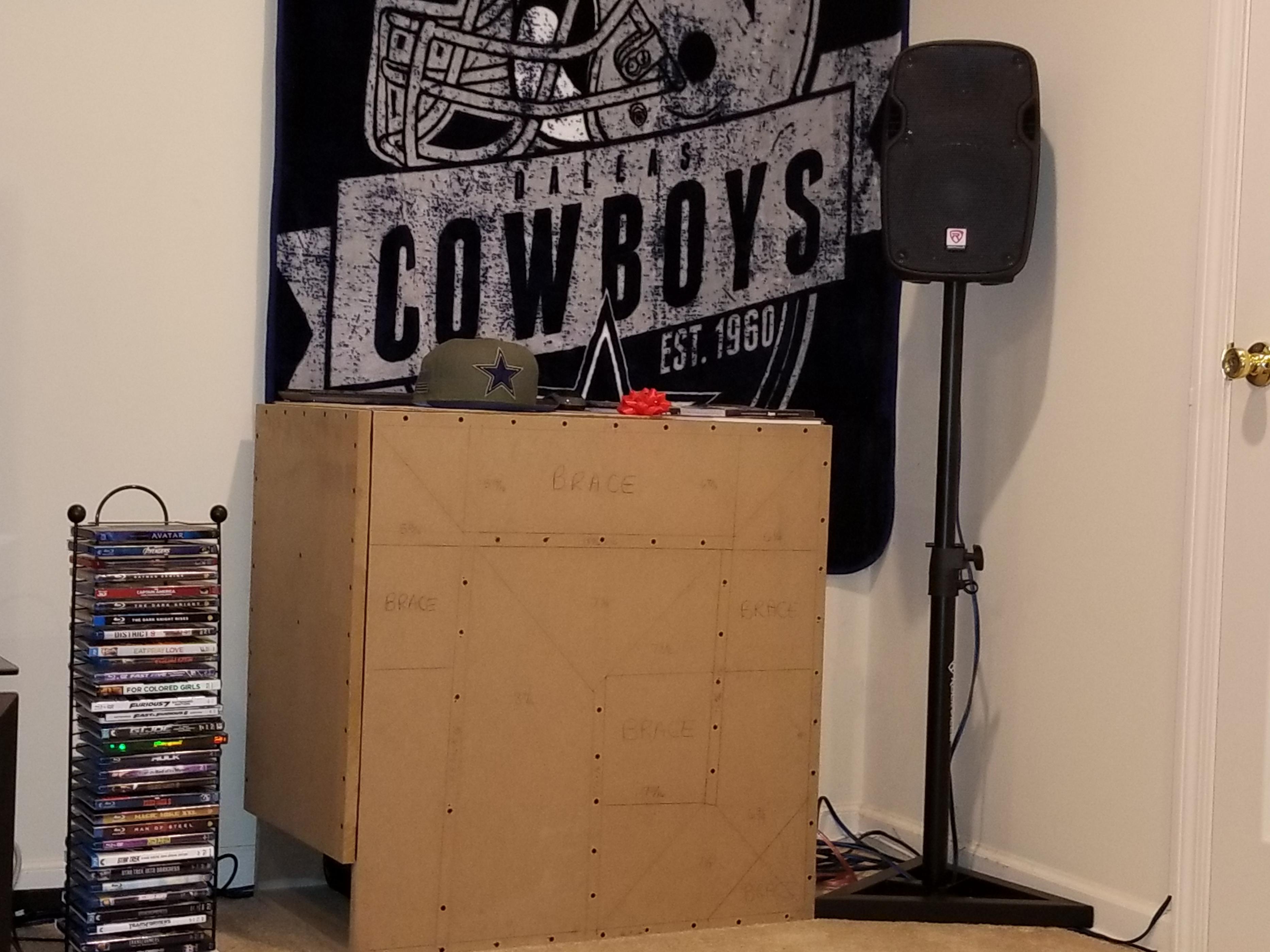

Example: I built my home theater subwoofer with a flat 2 Pi response while expecting it to fire into a corner (0.5 Pi). I ended up turning the enclosure 180* and it's been in that position ever since. The mid bass picked up considerably from that slight change.
1st pic, 2012. Sub firing into corner. 2nd pic, 2016. Sub turned 180*. 3rd pic, 2019. Sub further away from the corner

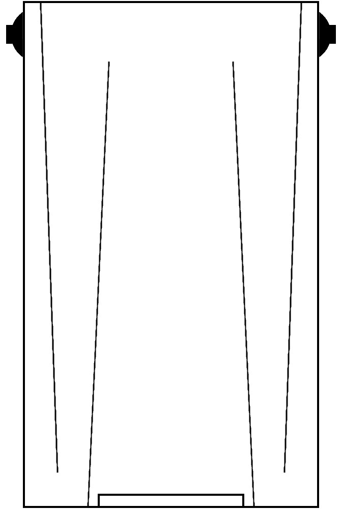

BTW, how about this (found online recently), looks like an infinite/isobaric/qw/th whatever but never seen before... 😀
As shown it's a dual driver ML-TQWT [aka what I call an ML-horn since it expands]. This is fundamentally one of the so called BIB horns except with a restricted terminus [vent] I played with in the mid '60s-70s with the guy that turned me on to TLs.
True, it looks a lot like a mass-loaded kinda horn, but I'm curious of that infinite-baffle kinda driver placement, what could be the real purpose of leaving the back energy in the free air? I don't remember from where I picked that pic, so just having a non-informative drawing how to build this? And who knows what at what frequency it'd play (though I know it's something about the ~ 20hz cos I found it when Googling for "infrasonic", barely remember)? 😕
Well, the room is ~ an 'infinite' baffle to any speaker that has one side open to it. 😉
IOW, it's one big parabolic horn split in half with a driver mounted to each half, then sums in the large main chamber with vent.
Why leave one side of any speaker driver in open air, he asks rhetorically? 😉
In short, it's a dual driver, end loaded, vented, BLH and the rear of the driver is exposed due to there not being enough internal depth to mount it normally.
