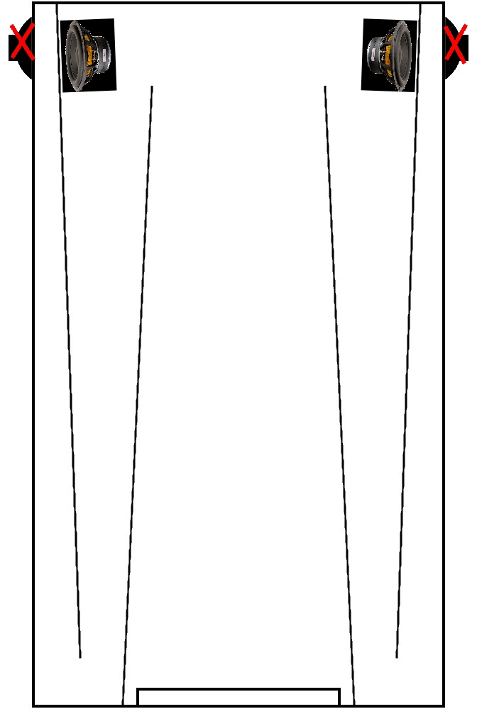

Now, back to the point, my intension was neither driver visibility and ease of replacement nor questioning the intrinsic nature of the "infinite baffle" in a rhetoric sense (I personally love its stereophonic accuracy in hi-fi listening), but this is all about SPL, I heard the TQWT usually takes the full energy of both front & back of the driver into account for optimal SPL gain, but this doesn't, why (am I being too serious on this)...?
If the above SPL statement is right, how about this, I put both inside (pretty bad edit btw)...?
For pure SPL, you want a regular TH, which is what you created when you moved the speakers inside the enclosure in your attachment.
TQWT/TQWP are for ease of build. There are no angles. They are between a TH and T-TQWT/T-TQWP when it comes to SPL efficiency.
T-TQWT/T-TQWP is for the smallest box for given tune. It still provides more SPL efficiency than sealed and BR.
Okay, two more things to know...Of course, you can build a stepped version of TH's and T-TQWT/T-TQWP's to eliminate angles.
1. Which is better for digging deep (~20hz), the original kind (using only the front energy) or the modified kind (using both energies)?
2. What program can best model it (if HR isn't that capable) as I can't find its original dims online?

Got it! Thanks bro...All TH's combine the front and rear wave of the speaker for output. All of them can dig to 20hz. The T-TQWT will have the smallest enclosure.
Obviously, HR! You can use Akabak too.
