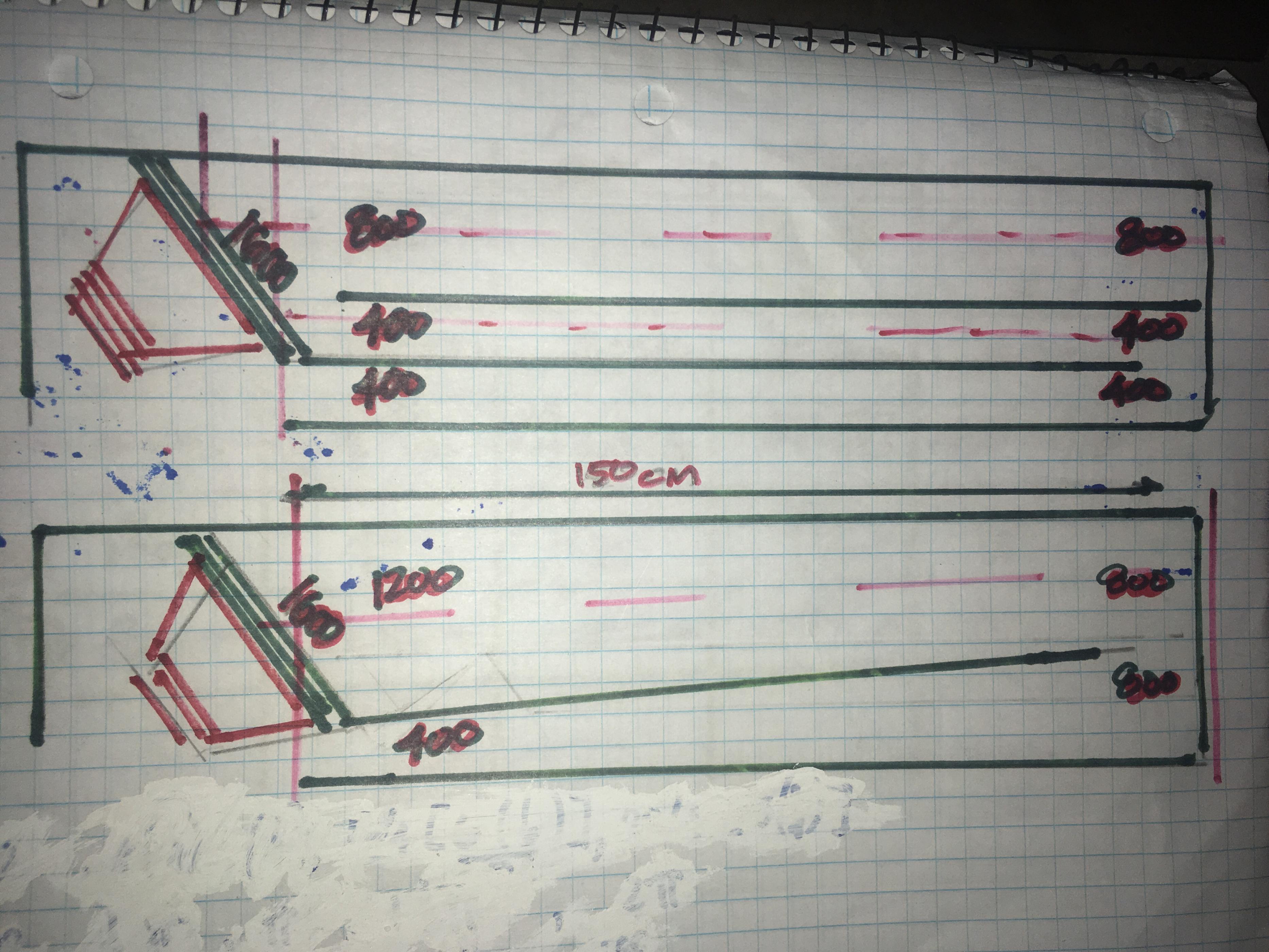

OK, basic 1/4 WL pipe cannon with both pipes = Sd/2 for nominally flat response and for increasing upper BW gain increase the 1/4 WL stub in multiples of desired gain, i.e. Sd x 2, 4, 8, etc., though 4x is normally enough to blend in corners.
12TBX100
42 Hz/2 = 21 Hz Fp
34400/4/21 = 409.5 cm
409.5/4 = 102.38 cm stub
409.5 - 12.38 = 307.12 cm closed pipe

Looks like a stepped positive flare TH. It could also be modeled with the BP6 series function in HR.
Yeah, after I 'ran the numbers' and did a constant taper, then horn tapered stub since I couldn't remember ATM how to do it in 'old' HR, the result looked familiar, so went searching and except for a bit extra HF gain due to mine having a greater Vb, it otherwise overlays your earlier TTQWT sim!
12TBX100
42 Hz/2 = 21 Hz Fp
Thanks mate, finally my design got something worth a try... 😀

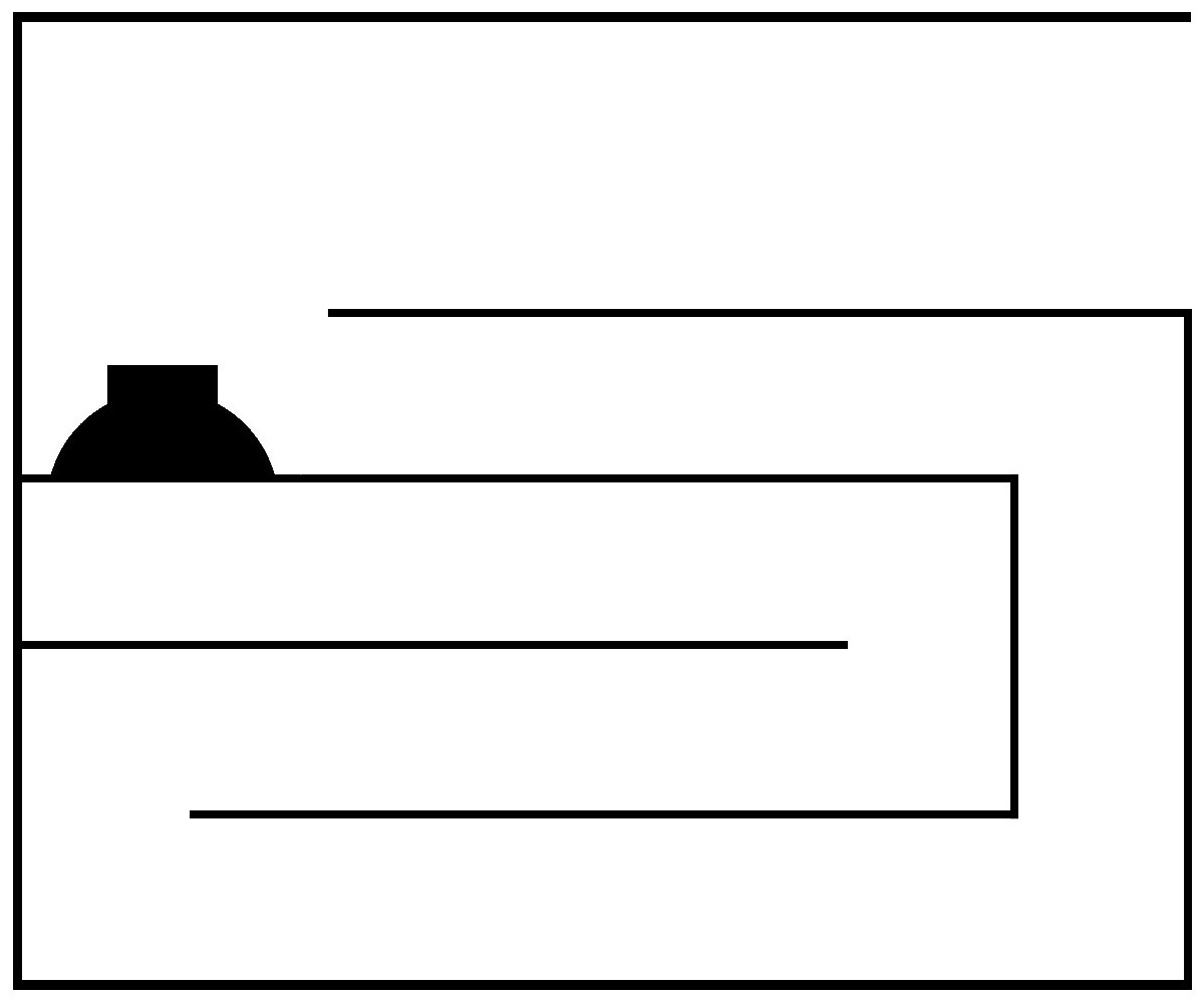

Vc1 = volume of front TL.
Vc1 = volume of rear TL.
Lc1 = length of front TL.
Lc2 = length of rear TL.
Lo1 = whatever it is to get the driver to the bottom of the HR enclosure.
Lo2 = same as above.
Ap1 = cross section of front TL.
Ap2 = cross section of rear TL.
Lp1 = thickness of wood, 1.905cm = 0.75in.
Lp2 = same as above.
The BP6S model should produce the same output as a stepped TH model.
The only thing missing from all the BP functions in HR are Atc and Vtc (should = Sd x the thickness of wood, where the speaker is mounted).

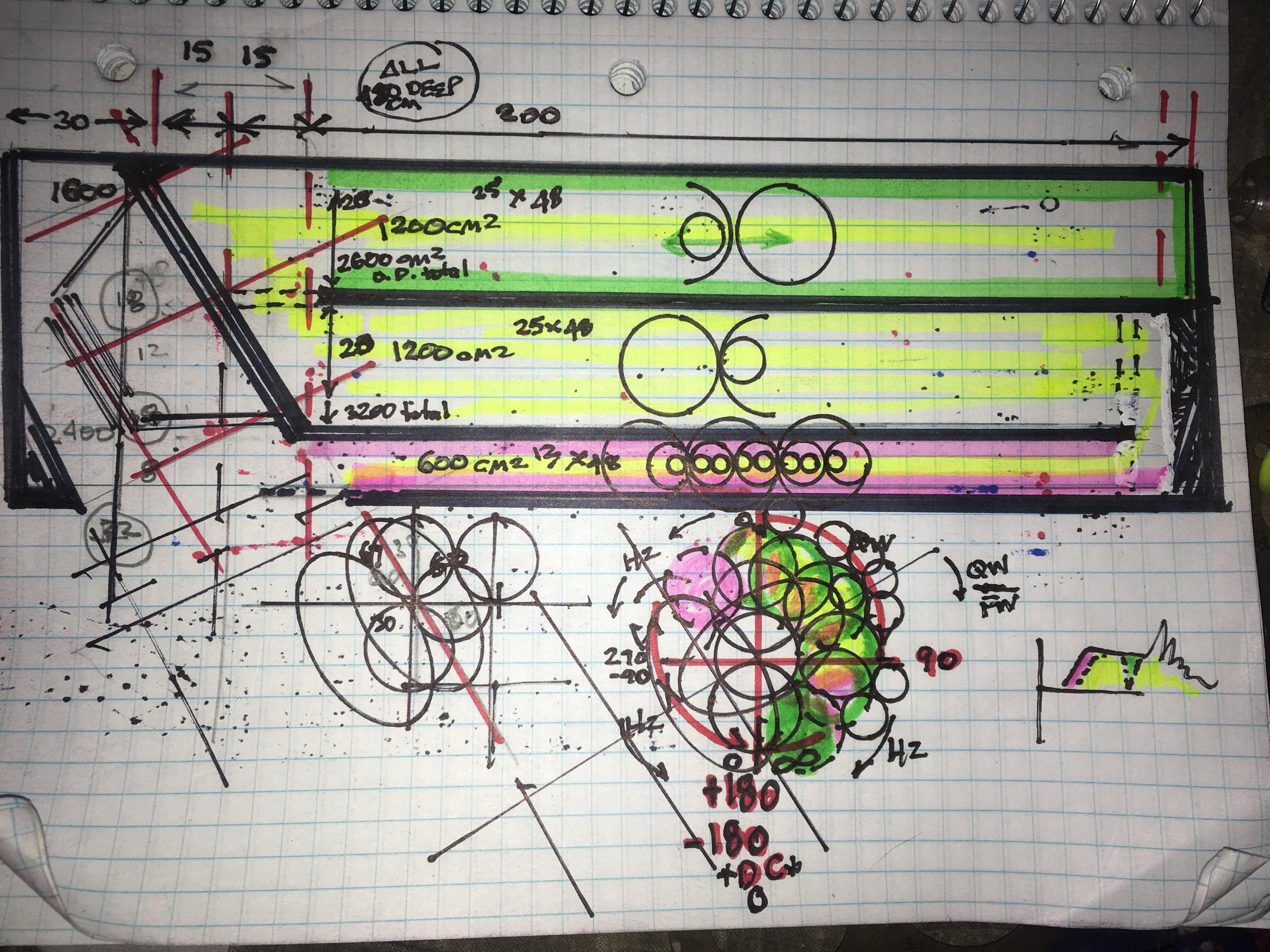

I could type 5 pages of objective? Subjective? I dunno, im not even able to begin but maybe a typer can type. Theres a lot to see, and its not stuck in anything in particular. Inckuding TH. Thats an opportunity, but putting a driver at the mouth is quite frankly good. But not the only good.. Im in a garage/shop, come on over, but bring these guys too.. we will quickly figure it all out. greg is there to guide us and suggest a certain course to which we will add any thing that might spice it up or deviate a bit incase it sparks his curiousity and i know a few things he might add anyhow.. its a win win, i not only listened (read) everything he told me, i used it and applied it. Its not as easy as it only is in the first (second actually) harmoinc of the full wave we use 1/4 of (90 degrees is a thing here to consider look and notice because once you do youre in the club. It matters in everything thereafte)...

Just for fun, Heres a pic of the greatest story never/ever told by a paraflex sim mode in horn response which isnt a paraflex... it just helps size things to understand why theres more on this pipe then anyone sees. Theres folding and since that matters might as well call it what it is. 4 pipes. each with a purpose and an exact reason the qw is no longer just a quarter of the full wave. Anything more and im pushing this driver out of its area of comfort(ultimax18 at below 12 hz once stuffed and tweeked at exit, and somehow i need a lower HP filter as mine is only willing to go to 18 hz and its too agreesive? After all i wont sh!t my pants until i find 7.2 is a great many things to anything? Even a thermal nuetron cause GI damage but thats another harmonic from uranium235/238. This stuff is weird!!! But maybe an LRAD diarehea fart maker is what i was born to do lol!!!
