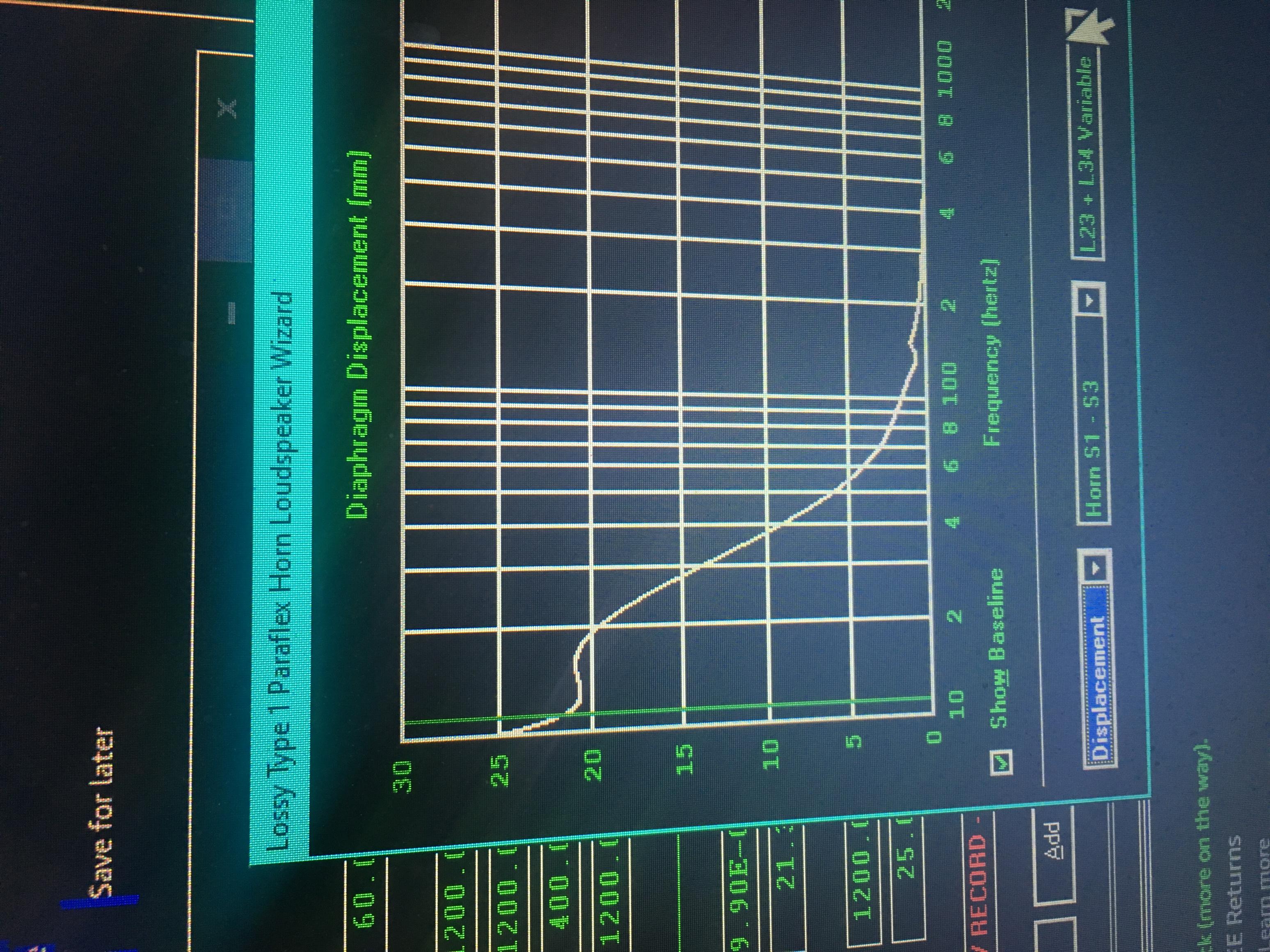

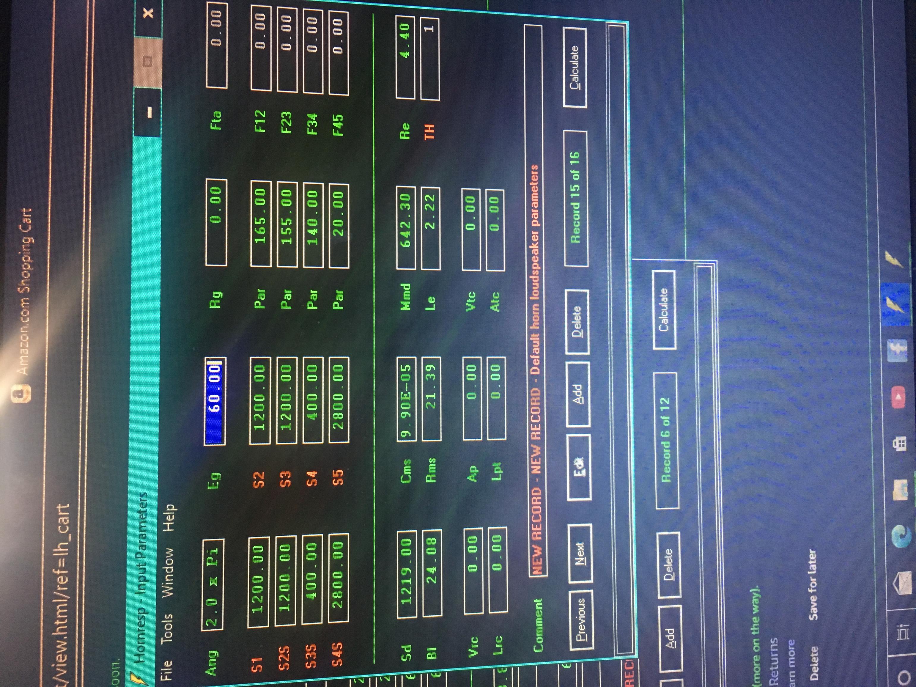

Dayton Audio Ultimax18. Given 60 volts by the Dayton sa1000 amplifier?

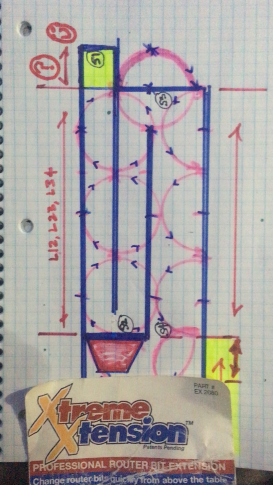

1200 cm2 then 1200cm2 and then 400cm2, as 3 segments (two 180 degree immediate turns on centerline)
Driver at 0.349 offset in the split of the first fold, also the first fold location on acoustical centerline for air mass accumulatively as pressure node vs antinodes.
So it is as follows: 165.0cm ,155.0, 140.0cm. —> and 20.0cm after( tapped horn sim with L45 as 20cm).. that S4-s5 actual ‘area’, as 1200cm2 +,1200 cm2, plus 400cm2(no wood included) is 2800cm2. As its the far side of the cone. A rear chamber, But also centered as it can only fit and be perfectly simmed?
Impedance null at 12.4 hz, 90 degrees in phase is 26.8 hz(im in Wizard looking) , 7hz is the antinode in pressure ~120-140 hz is occuppied by both thd first fold and the last (as pressure (in length) is catching up to the sum as a wave form and harmonics.
Meanwhile stuffing was added and the first (L12 ) pipe at 3.349 kg and .23334 in segment number two(L23) and 1.2333 in L34. Noting the excursion never ever exceeds Xdamage through <10 hz in any amount of stuffing or varieties that still keep dB >100 at 10 hz and thus hypothetically a serious threat to 7.2 hz(sound as a weapon).
I ordered another Ultimax a few days ago and it arrives today.
What do you think? And,
Even then, we can confirm it in ‘PH1’ mode now, soon to be stuffed in next update as well? add an actual rear wall in phase from the point already established to enforce this ‘back wave’ we call ‘tapped’ entry and ensure its aware of itself or defining the ‘end of a wave verses a pipe? Whatever that means(?)

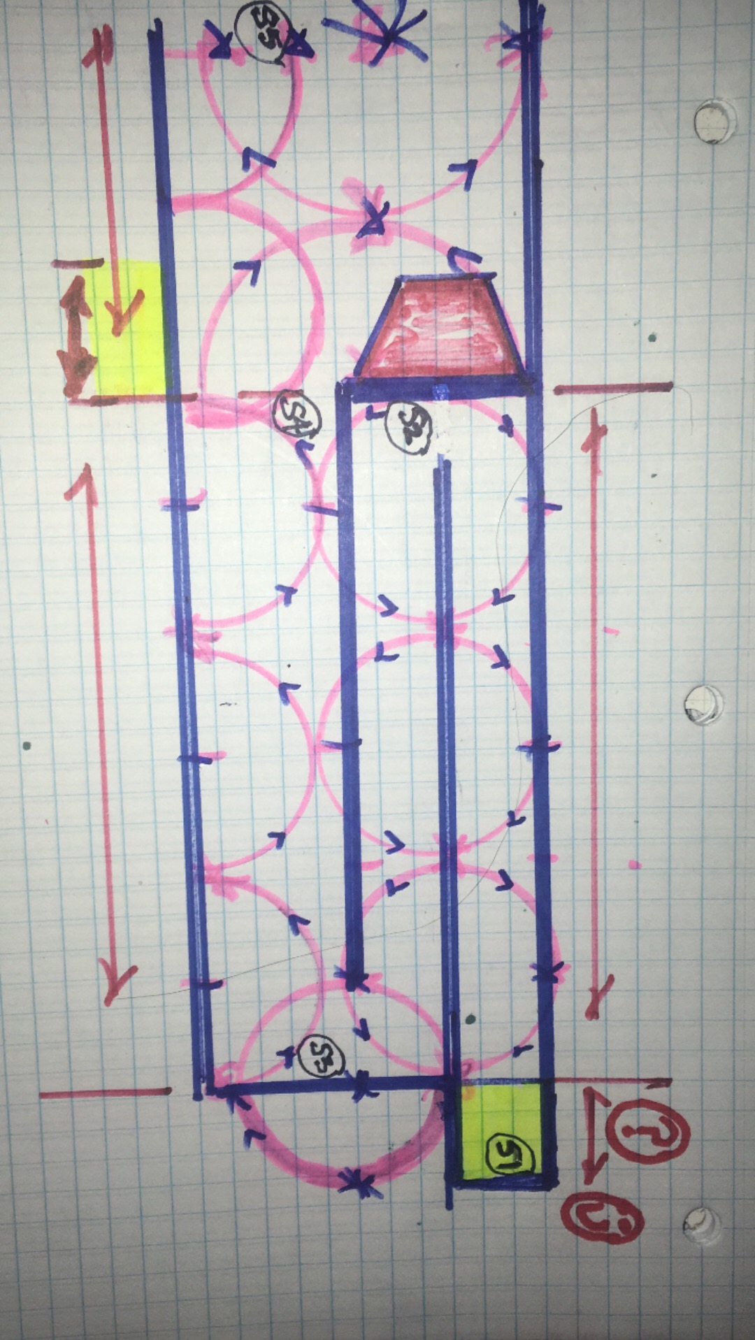

This: while abbreviated in many ways it still represents something at the harmonic of something the long one as a qw to the shared full wave they both define or represent parts of...
The green only depicts the length so its obvious what it is or that it needs to be in order to be ‘perfect’ . Its all very easy to confuse in a corner. Lets try not to comfuse anything, lets assume we are all wise and our collective wisdom will figure out some thing we all might find very intersting and mutually fun?
‘Perfect’ is the question? What is ‘perfect’ and we are going to assume the csa anywhere (as pipe segments shown ) at a turn or end and overall lengths are fair to Fs and Vas. As well as not put out of wack with any Qes/Qms(Qts) that might skew our Fb /Fs too extremes not inherint of the design (type C paraflex with 1, 2 or even 3 12” drivers and s2 as needed (on or two or three radius, 20,40,60cm assume) that then defines 40 cm everywhere(skip corners or skip trying to, i dont think i can feed any thing but optomism here. And the entire idea of a dual pipe attached at the end needs to help in doubt. I won't even waste a moment there. Ill keep building them and pretend i dont know anything? Its kinda hsrd after aWhile. The answer is ‘nobody cares how it works’, that voodoo is lucrative. And DIY is free love.
What do see? What do you think? What makes sense?
This shows how i have drawn it in a way that jumps ahead of itself by the same margin so its not confusing anything as a big single quarter of a wave shape (sine)on the main long path and its turns, yet needs to be flat and thrn just one swoosh of 4 it represents....

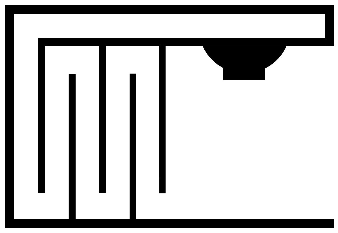

Just perused these replies at the free-time I got, wish you were nearby so that I'd learn some acoustics.
Back to the topic, "paraflex type-C" you described seems to be a simple build, I'd like it too, but does it really dig deep, Googled and it shows the typical "paraflex type-C" at most is tuned at 35hz, but I need to go deeper down to 20hz, can it?
I remember btw you've stated "HORN is a silly thought of a PIPE dream", then answer me now, below are a HORN and a PIPE, but design is the same, so which is the better (or you'd agree to)...???

A horn doesnt exist. An expanding shape toward exit is not an impedance match until its entirely different looking and the mouth at those hz would be as big as the front if my house?
Silly words, but never the less, the pipe is entertaining realistic physics thats tight inside as soon as you put the pipe around the right part of a waveform thats parts fit in it, and/or after it in the pics . My drawings suck, but theres still a ckear picture of the idea and whats ‘needed’ in mist of them, even if outta scake?
