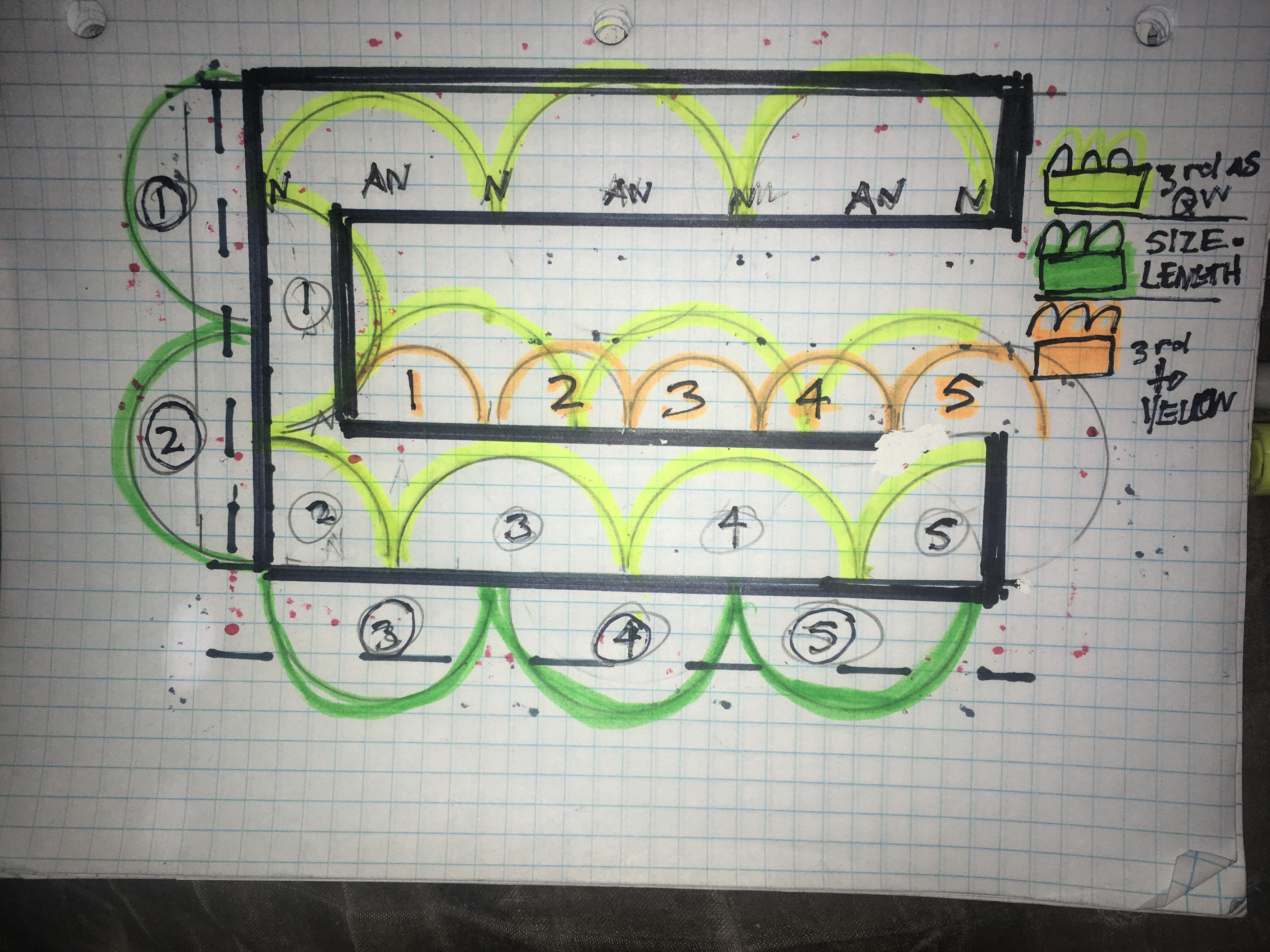

How about this...?
Please elaborate because all pipes/cones have a 1/4 WL fundamental regardless of type: Resonances of open air columns
I use this at least twice a week or more. Draw it on any folded pipe.. and then it shows what would work if adding more(pipes and their closed end as phase dictated-already if looking at a paraflex (or ODTL even).. the same visual aid can be seen in a sim in real time. It squiggly lines not smooth ones. People leave them squiggly and they get bitten. Its precurser to bad bad sounds. I even stick a blower (shop vac) in these things to driver air and listen. Hints of helmholtz or whistling edges or anything thats nicky digested in bracing with lots of holes to stir up a smooth not turbulent pattern? Seems so as the solid bracing will sometimes sing a song if at abd angle. Like a sunroof open but no windows in th car. Suddenly that even hurts everyone's ears. Well its not quite the same but yet theres similar issues in the chamber thats open to a high velocity area??

Here...
each with a purpose and an exact reason the qw is no longer just a quarter of the full wave.

This: while abbreviated in many ways it still represents something at the harmonic of something the long one as a qw to the shared full wave they both define or represent parts of...
The green only depicts the length so its obvious what it is or that it needs to be in order to be ‘perfect’ . Its all very easy to confuse in a corner. Lets try not to comfuse anything, lets assume we are all wise and our collective wisdom will figure out some thing we all might find very intersting and mutually fun?
‘Perfect’ is the question? What is ‘perfect’ and we are going to assume the csa anywhere (as pipe segments shown ) at a turn or end and overall lengths are fair to Fs and Vas. As well as not put out of wack with any Qes/Qms(Qts) that might skew our Fb /Fs too extremes not inherint of the design (type C paraflex with 1, 2 or even 3 12” drivers and s2 as needed (on or two or three radius, 20,40,60cm assume) that then defines 40 cm everywhere(skip corners or skip trying to, i dont think i can feed any thing but optomism here. And the entire idea of a dual pipe attached at the end needs to help in doubt. I won't even waste a moment there. Ill keep building them and pretend i dont know anything? Its kinda hsrd after aWhile. The answer is ‘nobody cares how it works’, that voodoo is lucrative. And DIY is free love.
What do see? What do you think? What makes sense?
This shows how i have drawn it in a way that jumps ahead of itself by the same margin so its not confusing anything as a big single quarter of a wave shape (sine)on the main long path and its turns, yet needs to be flat and thrn just one swoosh of 4 it represents....
