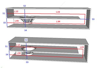

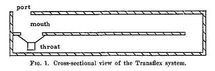

Alright, if you were referring to the 90°s marked in the 1st pic, how about the 2nd pic then?
Both pics are correct!
This is the simplest TH you can build...single fold straight flare TH or tapped pipe (TQWP).

Yeah, but just fixed any probabilities of "air compression" in the 2nd pic.Both pics are correct!

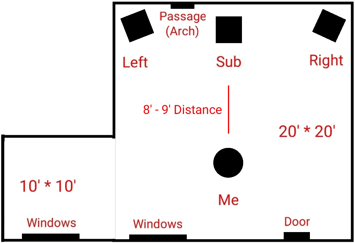

So, would my big room of 4000 cubes appeal for 2 T-TQWTs?
BTW, I saw you've applied only 200 watts rms @ 8 ohms on the 12TBX100 in the HR test, would that be enough for my room (at about 8ft distance)?
For reference, here's a sketch of the room...
Fold it twice back onto itself and create enough rear area in simulation that also yields an offset of the driver entry at the first fold(not well depicted in a drawing or photo as its only a few(12 or so here) cm more than 1/3 total.). This is mid-low 20s hz and <48” ‘tall’. But the BW extends up into the triple digits flat.

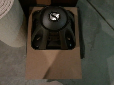

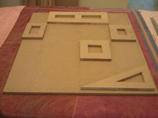

Ah, the double fold, interesting, have you built it yourself, why no paint (but I like unpainted), and what's that driver (never seen it)?
I love the shape of the single fold however (quite simple too), but could you give me the dims of this as well?
That's why it's unpainted, I built it myself! Kicker 08S15L74 is the driver. Actually, it was a test enclosure made with scrap MDF.
If I would have built a single fold T-TQWT, then the external dimensions would be 17.5" wide, 16.25" deep, and 61.5" tall.
Why not 4 T-TQWT's, 1 on each wall to cover all room nodes!

Ah, you're a sub maker then, do you have the machinery or cutting job from a depot (just asking)?That's why it's unpainted, I built it myself! Kicker 08S15L74 is the driver. Actually, it was a test enclosure made with scrap MDF.

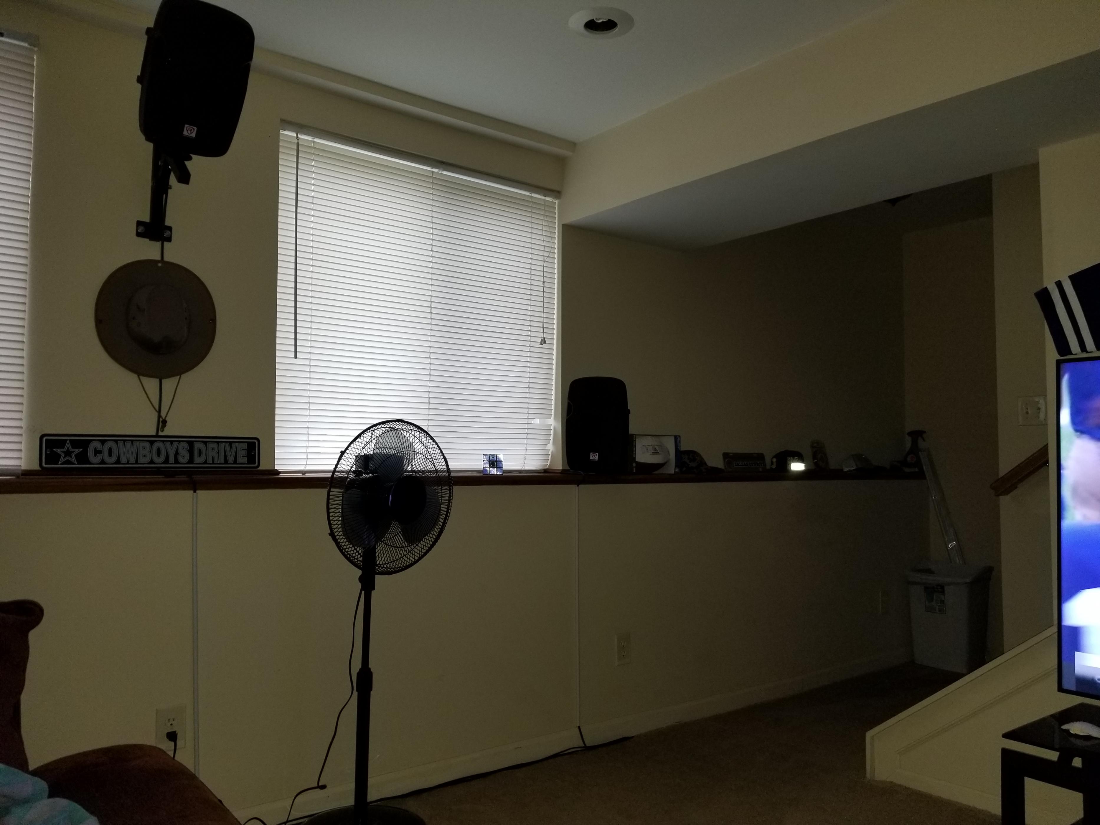

Ah okay okay, wires are nothing when it comes to BASSism... 😀Cover up the speaker wire. The grey strip running from the 18" bass bin is covering the speaker wire to the right rear surround speaker.

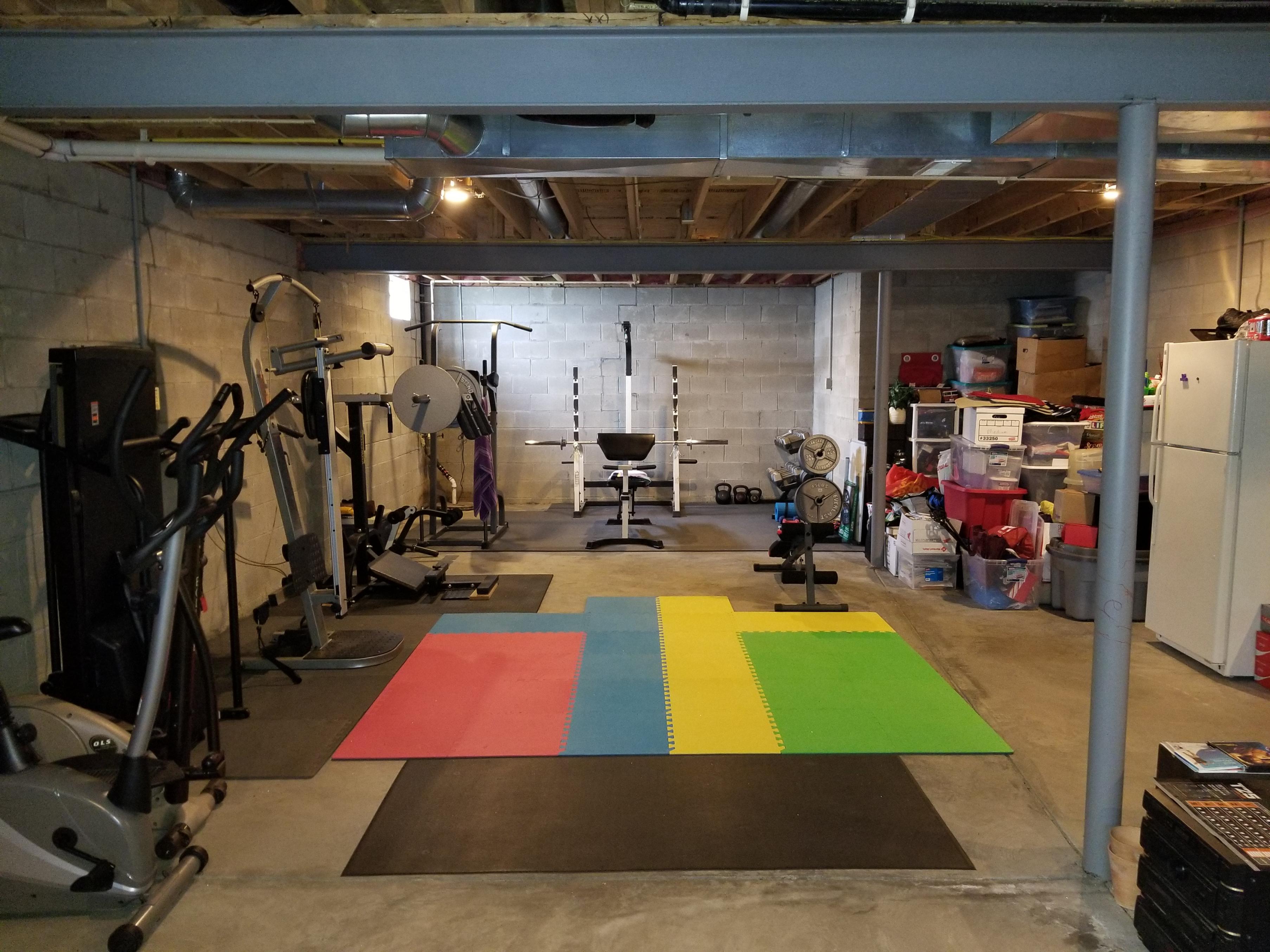

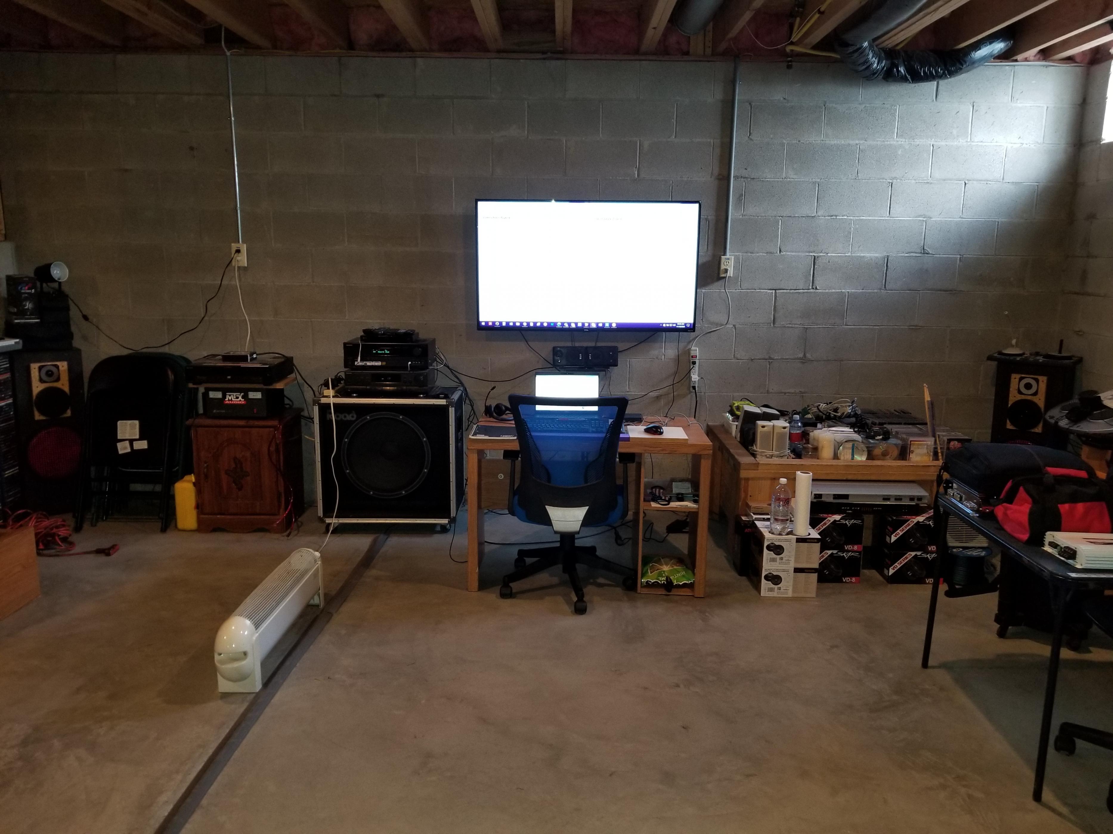

BTW, just asking, isn't your stereo too far apart, soundstage would lose?
My home office #2 is a gym too.
