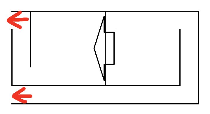

Wait, 90*??? 90 multiplied???
Ah, okay okay, if you meant 90° (degrees) away, that's how "PARALLEL" 6TH ORDER BANDPASS usually is.
Yes, 90* = 90 degrees.

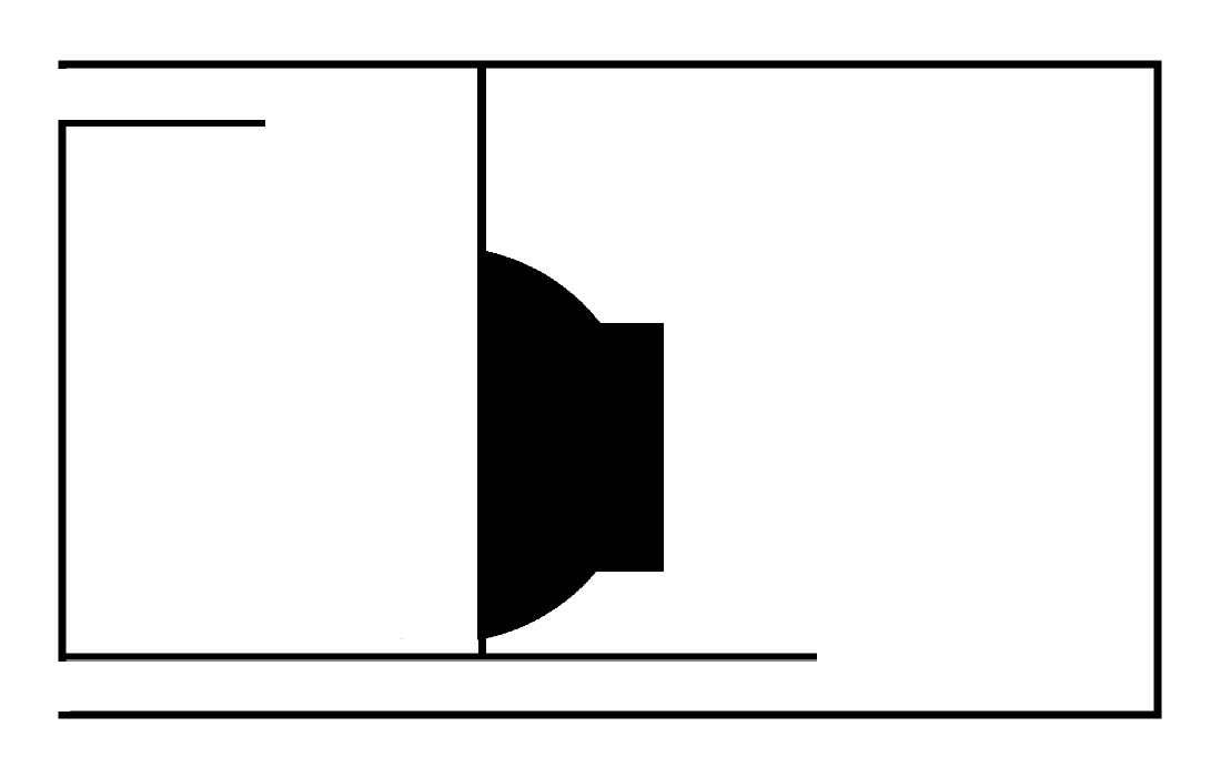

I know it's a BP6P. Why aren't both ports firing in the same direction?

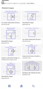

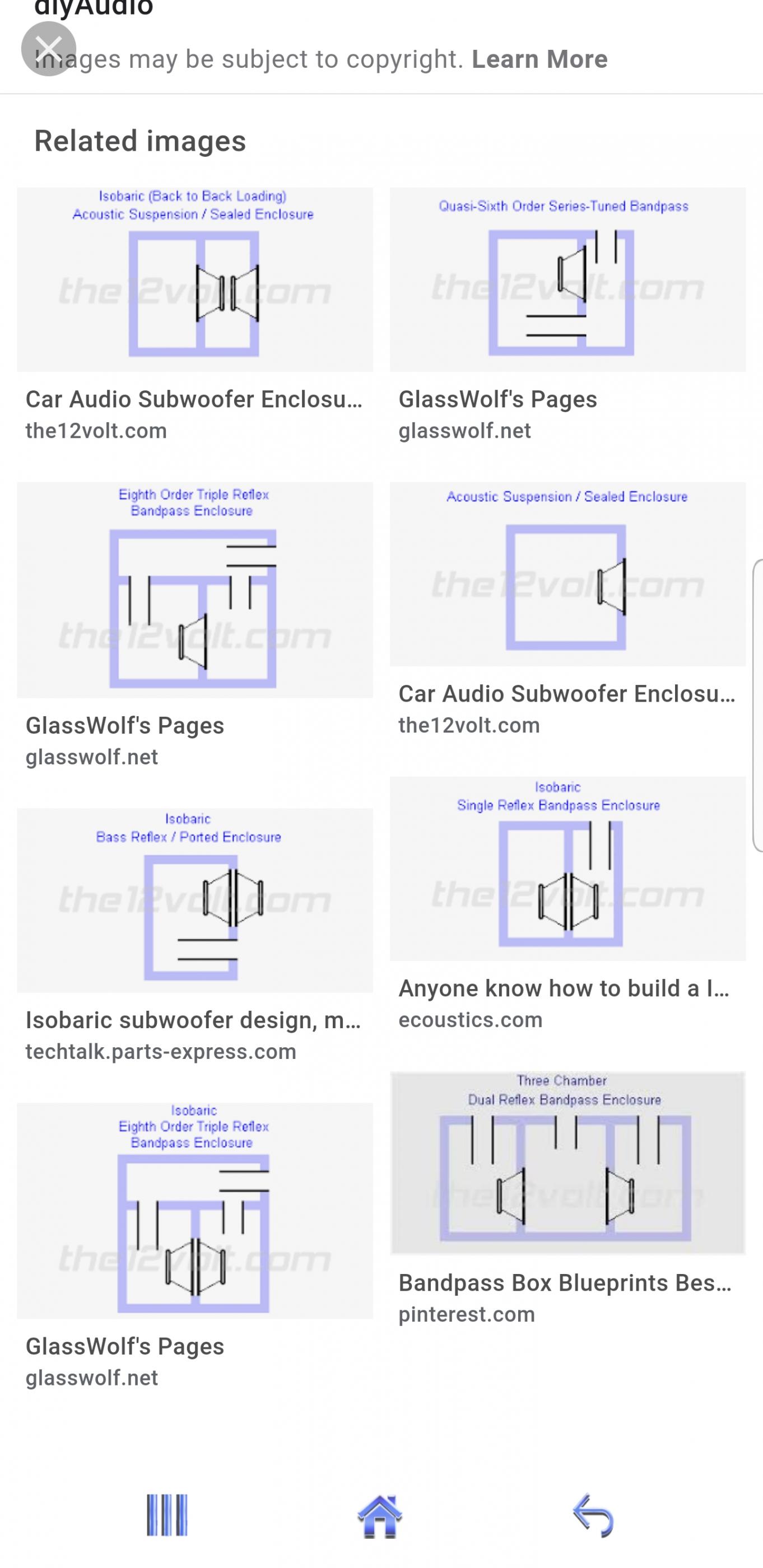

I don't understand why they shouldn't be, some PARALLELS are off-axis (I've posted one found online on page 6) and some are on-axis (like my design), teach me, I'm a novice???Yes, 90* = 90 degrees.

Note the difference in port exits in both BP6P's.

Do you actually mean the 6TH ORDER BANDPASS as a concept fails or the particular design I sketched would fail (I'm.confused)?
Well, IMNSHO your simple two chamber vented box is a poor choice for the B&C 12TBX100.
Do you mean I'm not interested in any other type?
Well, you didn't indicate that you were, so not being a mind reader I just responded to what you asked for.

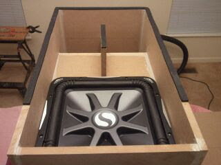

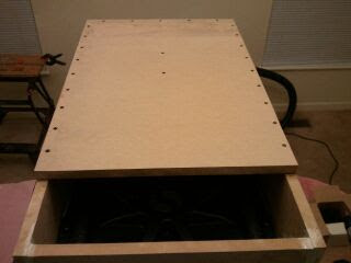

BTW, if you've actually built this "T-TQWT" (love its awkward shape!), can I have a photo?
Sorry mate, it was a misreading, you wrote AREN'T but I read ARE (quite busy nowadays), so replying again, yes they ARE, look at the arrows...Yes, 90* = 90 degrees.
Well, looking at those 2 pics you referred me to, coloured one is OFF-axis (one horizontal exit & one vertical exit), other one (Devastator) is ON-axis (all exits are horizontal), what am I missing...?Note the difference in port exits in both BP6P's.
Alright, if you were referring to the 90°s marked in the 1st pic, how about the 2nd pic then?The only time I can see 90* exit ports is in a BP6S or a BP8.

I'll tell you a reason (if you're implying 12TBX100 isn't for 6bp), I know B&C is generally a pa (pro) brand, which is why 12TBX100 plays really well at horn-loading, but I have no other choice, no specific home audio (hi-fi) brands available here, otherwise would be genuine car audio drivers, they can go below 25hz all by themselves (fs) but I'm not sure if they fit at home listening (I really don't know), you might ask me "why bothering on diy?, just go for a factory setup", of course we have showrooms, like takeaways, we buy them, how much is a 1000w 5.1 with amp/receiver (all-in-one system)?, just $150 (you know the story), tired of buying cheap-cheats.Well, IMNSHO your simple two chamber vented box is a poor choice for the B&C 12TBX100.
However, if you're explicitly talking about my design, whether "simple" or not, a both-chambers-ported-to-outside enclosure is theoretically called a "PARALLEL" 6TH ORDER BANDPASS.
Oh dear, you don't need to be either, I was to reply next saying "no, I'd be glad to welcome anyone with any other type of 20hz enclosure"...Well, you didn't indicate that you were, so not being a mind reader I just responded to what you asked for.
My double fold T-TQWT.
