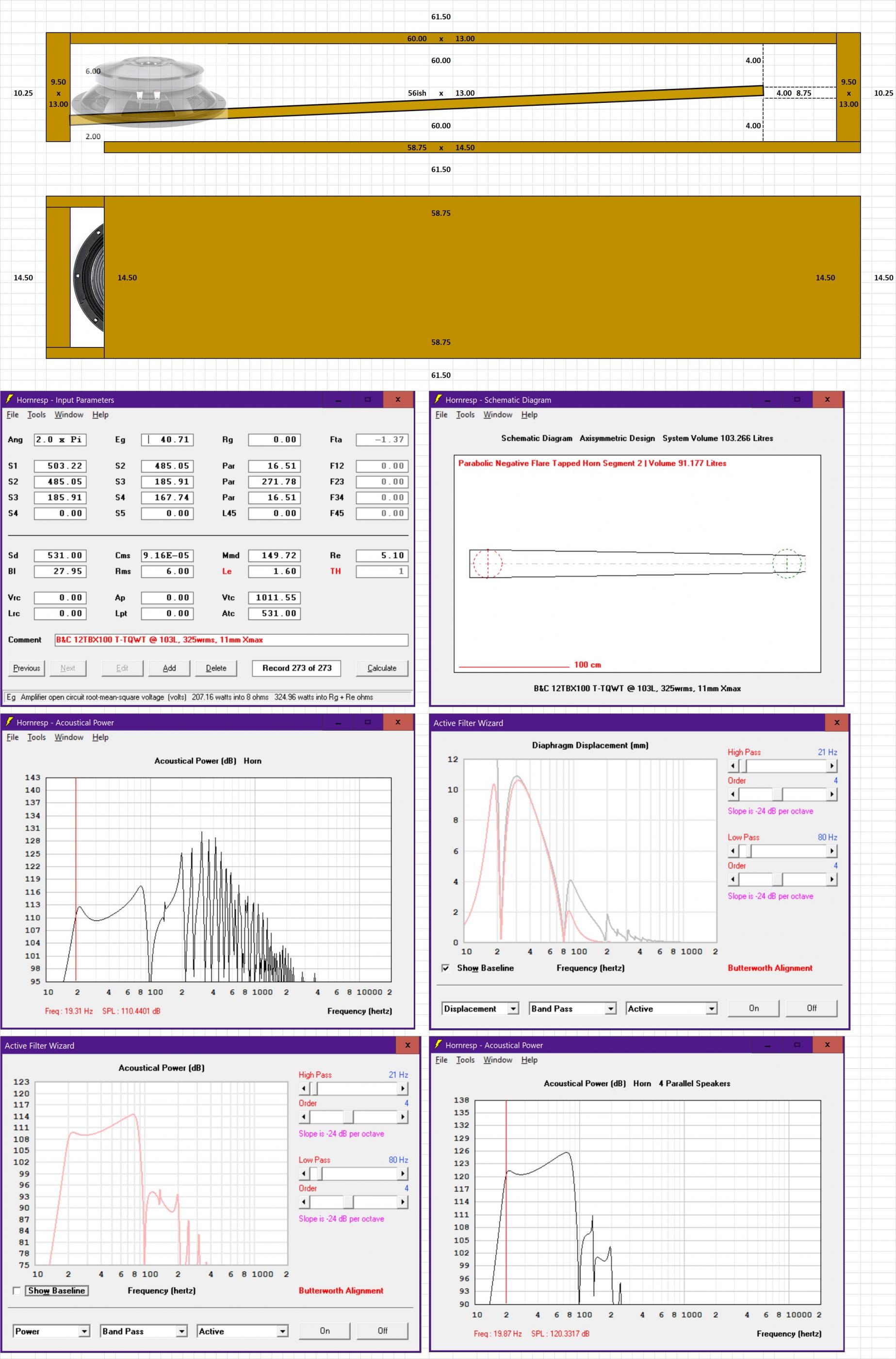

How about this...?
Top of BW is screaming
Yeah, both my default series and parallel sims look more like one of those ROARs than BP 6 sims as both 'get up on the pipe' [2 stroke racing jargon] around 80 Hz out to ~220 Hz except under damped [no stuffing] down to its ~26 Hz Fp [series] whereas parallel was a ~ 33 Hz Fp 'one note' 150 Hz/+20 dB peak.
Super low Vas drivers suck for vented alignments, so need multiples to get a good sim/performer without excessive EQ. That said, great for designing a large speaker, then built as stackable single/dual/whatever driver modules that can be EQ'd to work as singles as Danley, et al are doing nowadays and what I plan to do if I'm ever involved again with another HIFI/HT multiple sub-woofer array.
How about this?

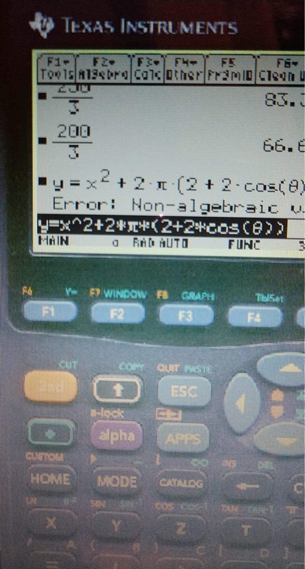

If i rotate that circle around and around as its a sine wave represented as the
Degrees or radians(1,2pi is 360/720). This on a polar plot to the 13/4 harmonic in distance tracks like pressure phase in anything.
That is me describing the way to fold that idea if representing it. its 80 or 100 cm. For an Fs/Fb as needed. Easy for me to use in what ive got.
But iys two pipes as 300 and 100. Rolled out as i described i end up with a shape for that sine wave all the way from 1200cm to zero and plot it. Connecting the 90 degree landing spot as it touches the other circle its rolling along leaving the mark.
is that shape of any significance to the sound signature? Or a hInt that it could be? That shape is eventually a cardoid shape. Plottted to imfinity(sorta). But its well represented in a certain shape thats also hard to actually achieve those lengths in the 3 parts /100cm x 3 is the long pipe folded) and the one of other.(100cm not folded).
I hate math. But its hard to draw too . But i cheat and borrow ideas from smart people. (0.349) is about 90 degrees just gotta spin the the circles to see in calculus or whatever..? Here it is(again),?

Yeah, im not sure i ever was able to describe what i thought you were . I dunno if you can look but GM(Greg) has broken it up into pieces (20cm portions) and i previously did 40 (same thing essentially but squares to cubes in youre chambers) to mimic all dimensions as they would fit as drawn. But a port area and the details or your ‘exit and lengths apart’ as well as 90 degrees vs 180 degrees were important ? Have a go at plugging it all in from the txt file. The speaker Jedi has constructed 🙂
Unfortunately none of the files opening dear...
Yeah, as 40 cm it still just created a tall skinny rippled two bump if trying to get at what the pics appeared to be conveying. Though what he had was almost exactly where this is in Isobaric
rF p3 d2
Sd
570
Re3.2 Le 4
Vas 57
fs 26
Qes .53
Qms 6.7
Xmsx 13
Pfms 600
Chambers are 48 liters and 300 cm2 wraps around at 240 cm length as the vent is just rear chamber fof an excuse to play with cone control and stuffing
I Cant really get a tbx to work where the other TS parameters above almost do alright in the shape as it appears(abbreviated the short side port to nearly nothing but open rear chamber volume at 1200cm2... x 40 cm.

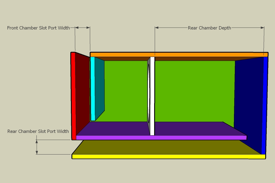

I found this on the Internet, PARALLEL 6TH ORDER BANDPASS (OFF-AXIS as opposed to mine), but very similar???
Do you actually mean the 6TH ORDER BANDPASS as a concept fails or the particular design I sketched would fail (I'm.confused)? 😕
