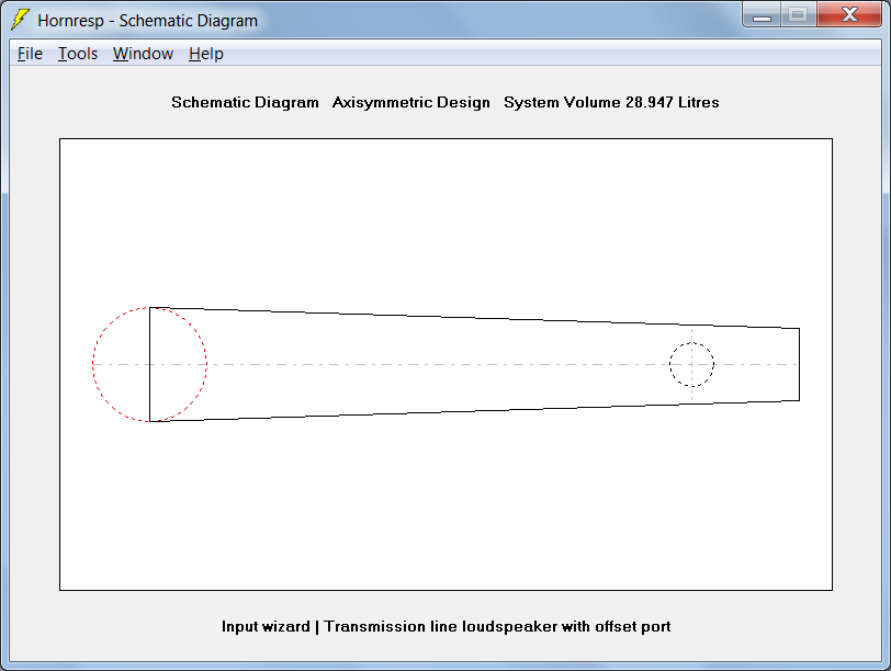

I wanted to ask for a fix to a specific issue I'm having with these schematic diagrams (see both attachments).
I'm slightly colorblind, and certain colors can be difficult for me to differentiate. Specifically, I often struggle to see the red line of the driver diaphragm. (Blends with black line to me)
Could you please add an option to change its color or make it more visibly distinct?

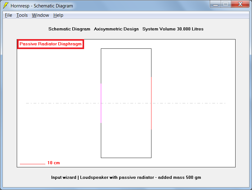

Would it be sufficient just to make the driver and passive radiator lines thicker as suggested by Dr Kolbrek, and as is already done for band pass systems?
You could add a tooltip on the right when you hover over or double click the line.
Tooltip-type information is already provided.
The example below shows the comment displayed when the mouse pointer is moved over the pink line representing a passive radiator diaphragm.

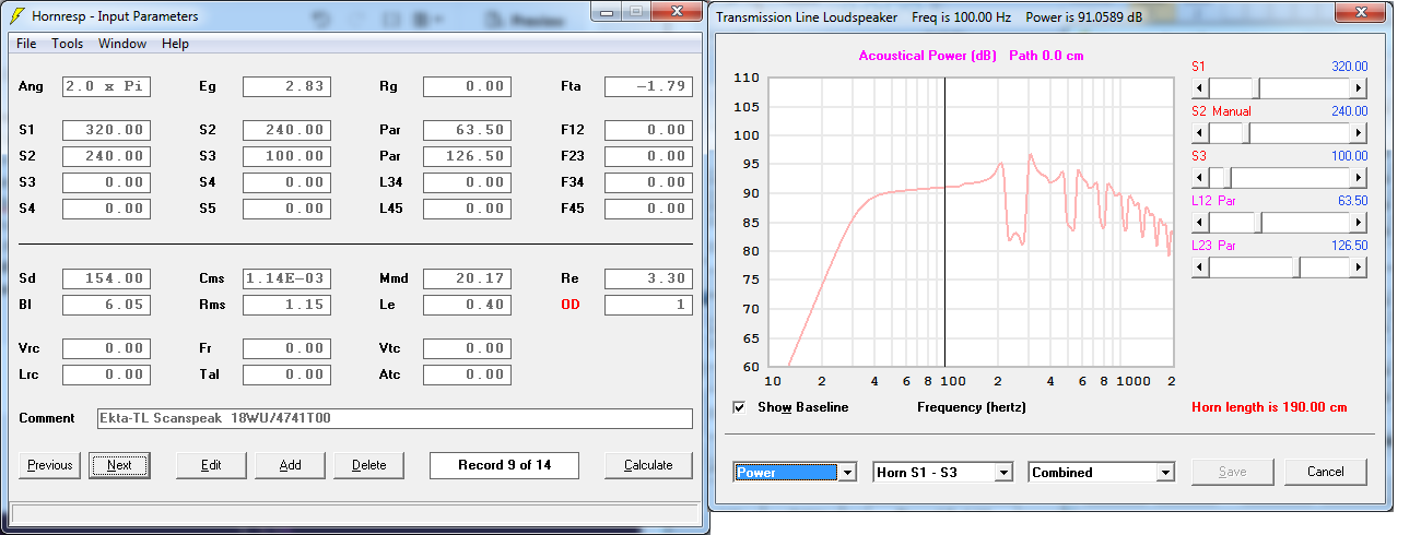

Hi all, I am in the process of selecting a driver suitable for a transmission line. I plan to build an enclosure based on Ekta-TL by Troels with necessary mods to accommodate the selected driver.
And I just can't figure it out what makes a driver suitable for a transmission line.
I simulated a couple of drivers and they mostly just do not perform the way I would expect. I want a good bass extension, good sensitivity, and short TL, yeah.
At first I selected SB Acoustics SB20PFCR30-8. And I got F6dB=38Hz F3dB=46Hz Sensitivity=91.4dB. Which is crap.
Then I read a report by Perry Marshall that says a good driver should have: large Qts, large Mms and large BL.
So I simulated Wavecor WF223BD02 which has it all, or so I thought, large Qts, large Mms and large BL. And I got F6dB=32Hz F3dB=39Hz Sensitivity=89.6dB. Not bad, but still way below the expectations from such a great driver.
So I simulated the driver that Troels put originally in the Ekta-TL enclosure, the ScanSpeak 18WU/4741T00, which is just the opposite of Wavecor- small Qts, small Mms, small BL. Theoretically should not work at all. Yet I got F6db=30Hz F3dB=35Hz Sensitivity=91dB. Which is excellent.
All speakers were sumulated in the same TL enclosure. But I do not understand why Scanspeak performs that well.
Why does this Scanspeak perform that well?
What parameters should I be looking at when selecting a driver suitable for a TL?
