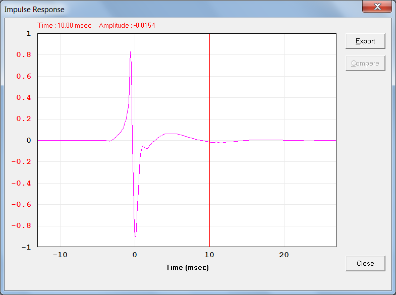

Hi Everyone,
CHANGE 1
The main impulse response chart can now be sampled. Attachment 1 refers.

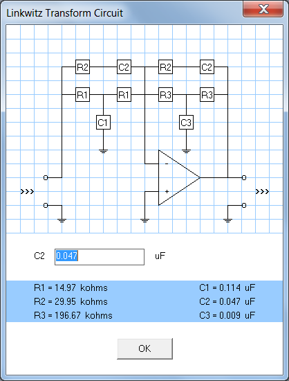

The colour scheme used for the Linkwitz Transform circuit has been altered. Attachment 3 refers.

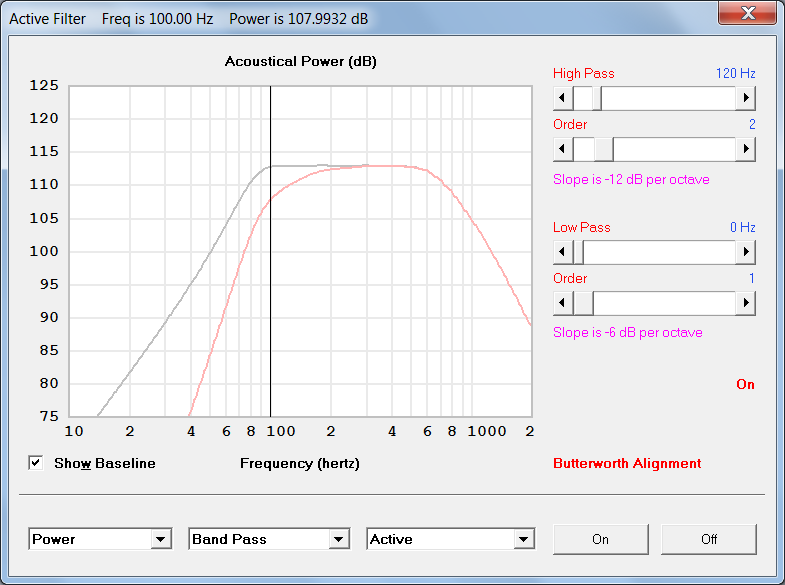

Hi Everyone,
CHANGE 1
CHANGE 2
All filter wizard charts can now be sampled. Attachment 2 refers.
CHANGE 3
CHANGE 4
Further measures have been put in place to prevent the occurrence of the 'Type mismatch' error detailed in Post #15,430. My thanks to BP1Fanatic for reporting the problem.
Kind regards,
David

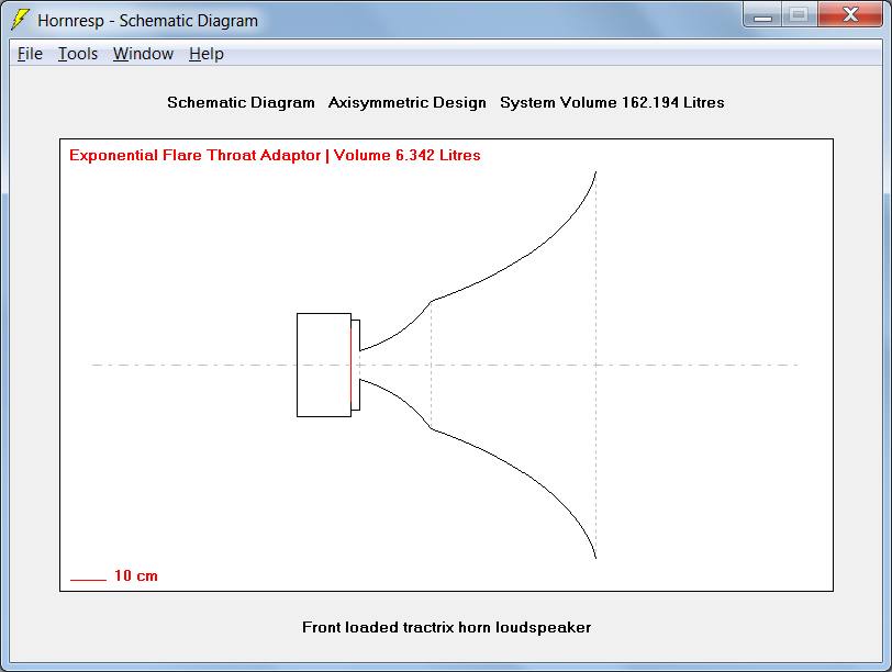

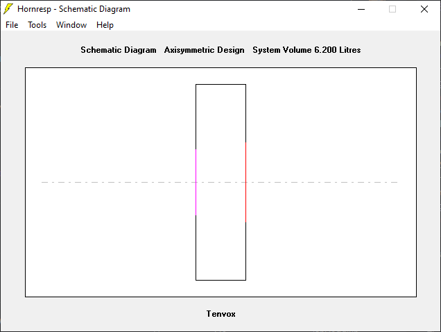

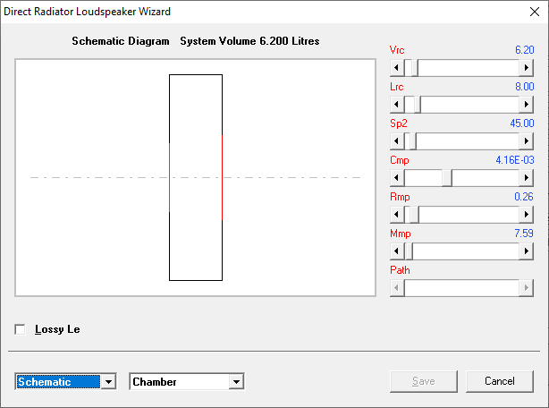

Hi David,
I wanted to ask for a fix to a specific issue I'm having with these schematic diagrams (see both attachments).
I'm slightly colorblind, and certain colors can be difficult for me to differentiate. Specifically, I often struggle to see the red line of the driver diaphragm. (Blends with black line to me)
Could you please add an option to change its color or make it more visibly distinct?
Hi Tachi778,
I decided at the very beginning not to include user-selected formatting options in Hornresp. Sorry, but I would still rather not do so.
One in 10 men are colour blind to some degree. We have a policy where I work that requires all visualisations to be CB accessible.
Or make the line thicker. While I'm not colour blind I find it harder to differentiate between similar colours of thin (1 pixel) lines, compared to thicker lines. If the black lines are kept the original width and the red etc. lines are made thicker, they would stand out more easily.
