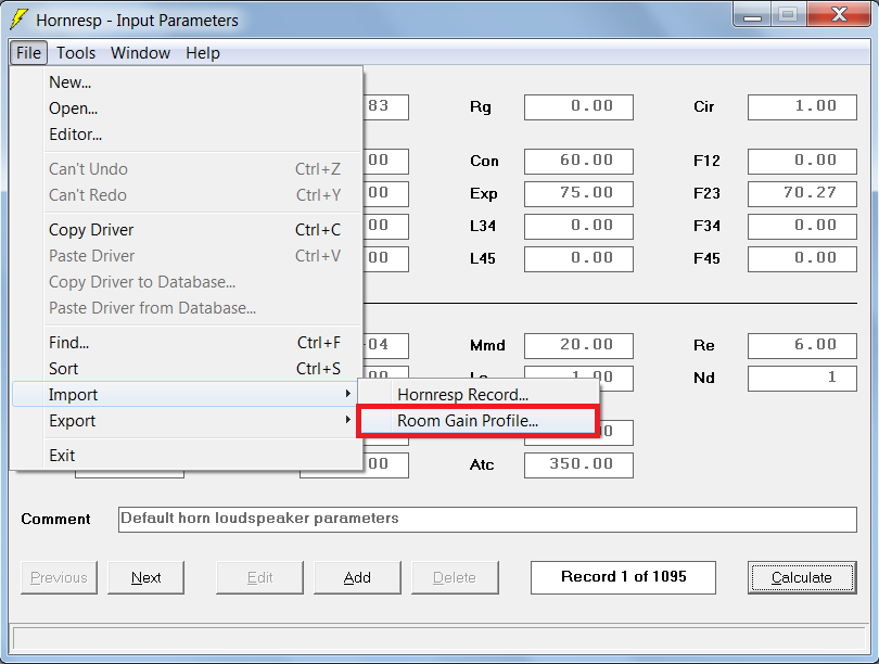

can it be possible to model room gain?
Room gain cannot be modelled in Hornresp but if the room gain profile is known it can be imported and taken into account when calculating the response.

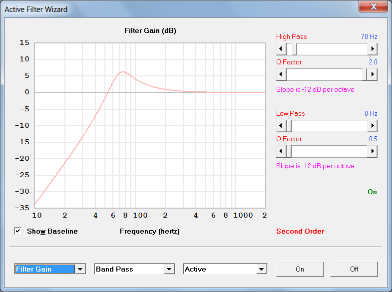

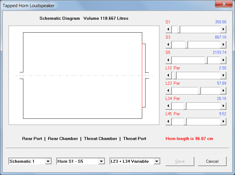

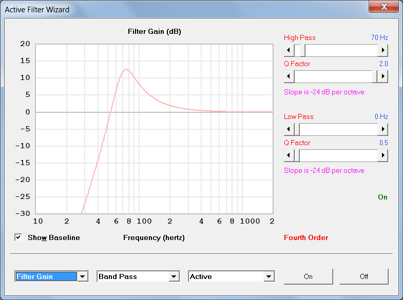

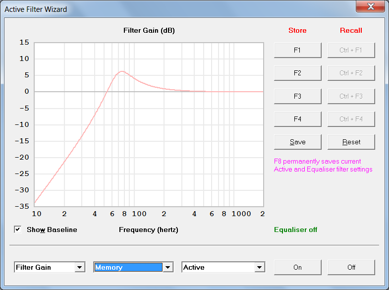

Is it possible to save the simulated filters & EQ points (maybe just a checkbox on/off "save current filter to record")? I'm simulating a b6 assisted cabinet which relies on filters/EQ points to make up for a small cabinet volume, and they are resetting every time I close (and save current record) hornresp. The alignment calls for a HPF with a Q of 2 (don't know what slope tho), could Q be a variable in the filter aswell? Thank you for a great software.
Click the filter wizard Save button or press the F8 function key. Attachment 1 refers.
Use either the Second Order or the Fourth Order active filter. Attachments 2 and 3 refer.

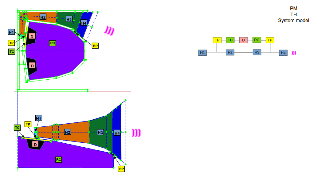

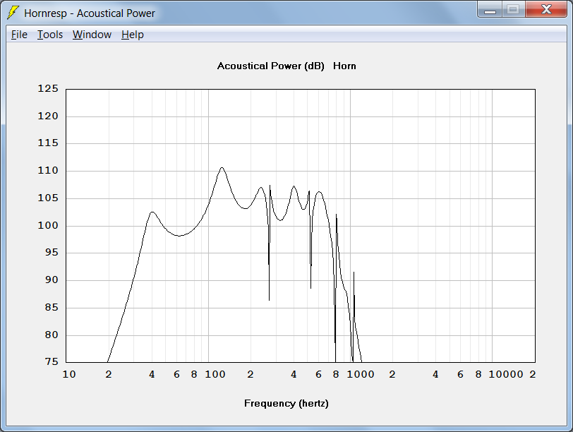

Hello David,
Was trying to test the new feature you released for TH but Hornresp is crashing or not responding. To check if it's Linux compatibility or maybe a bug, do you mind to run attach file exported from Hornresp.
Note: I still need to adjust box expansions to proper fit 4 segments, so i need to remove one expansion from H3.
Hi Marcelo,
Unfortunately it would seem that the problem you are experiencing is most likely due to yet another Linux incompatibility.
Everything works just fine for me.
I would not know where to start looking in the code for a solution.

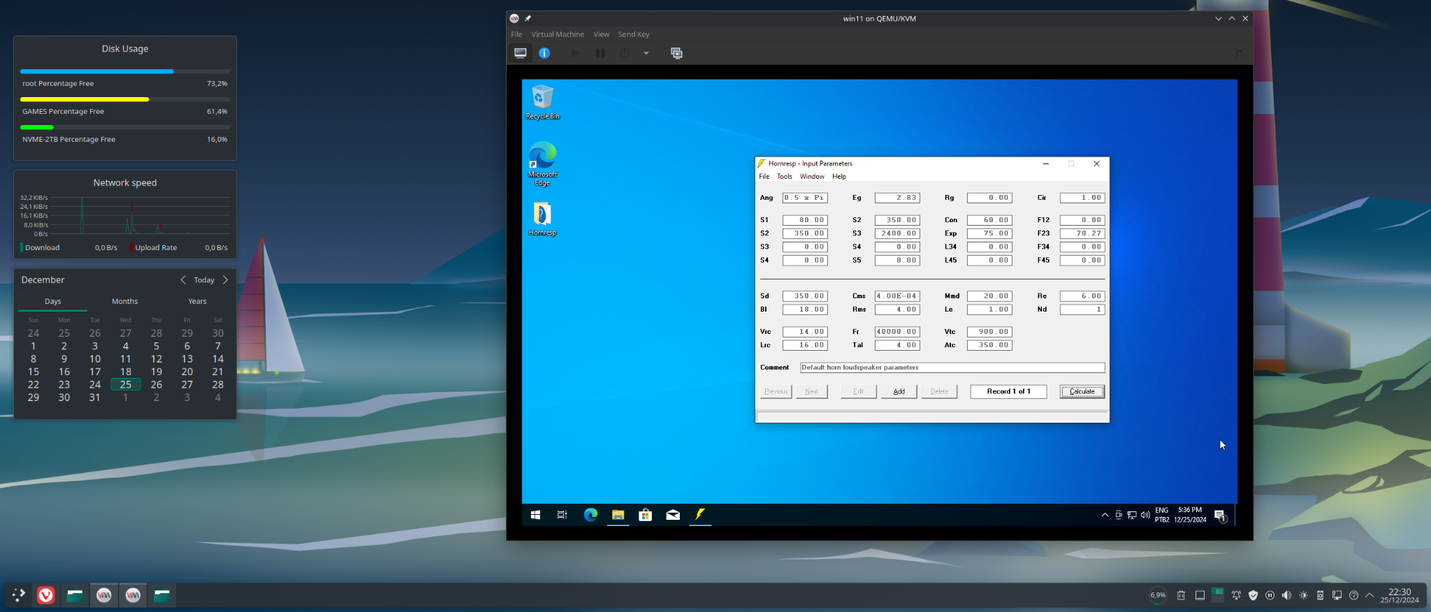

Yes I do have Virt-Manager but I'm lazy about windows, once I complete my migration to Linux 4 years ago I have no need to use windows again, when facing a issue I just about some months until developers provide the solution to fix the issue. It depends about the software people use, there are some that will hold you using windows.
Are you sure? try to looking for surveillance on windows and others issues.
Which is exactly why I suggested that you keep the VM offline and only use it for Hornresp. It is the next best thing to air gapping, where you do sensitive work on a computer that has no internet access whatsoever. All updates etc. are carried out using pen drives, etc.
I understand your concerns completely. As a Linux user you are not comfortable with your ability to stay safe online, just as I as a Windows user am not comfortable on Linux as I don't know enough to even set up a firewall properly - I could be hacked and not even realise it.
I have to run several essential work related software that will only run on ancient versions of Windows. I do the offline VM thing for those as well as they are vulnerable to online attacks.
See attached image, I have virtual machine.
All operation systems have pros and cons, I don't advocate for none of them but I encourage people to try Linux once the major part of people never try it, they already use windows since first school level and many machines they brought during the life came with windows pre installed.
No operation system, including iOS, Android, Windows or Linux should spy you or collect and use your data without your authorization in addition we should be able to reject all request, for some mentioned above if you reject something you are prevented to install or even use them, so, your data, your decision. For sure this forum and this particular thread is not the right place to discuss this subject and it's very sensitive.
I will wait wine or other thing to be fixed on Linux so I can back to use hornresp regularly again 🙂 if urgent, virtual machine is indeed an option.
