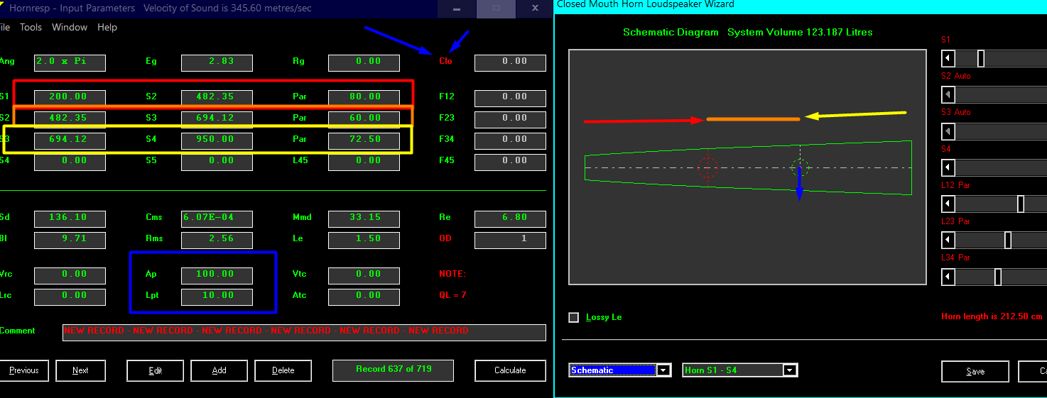

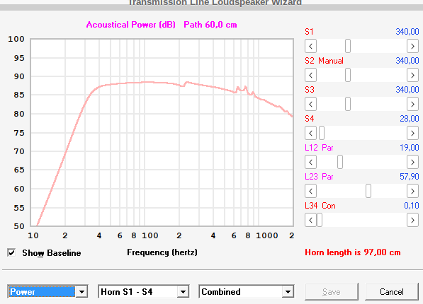

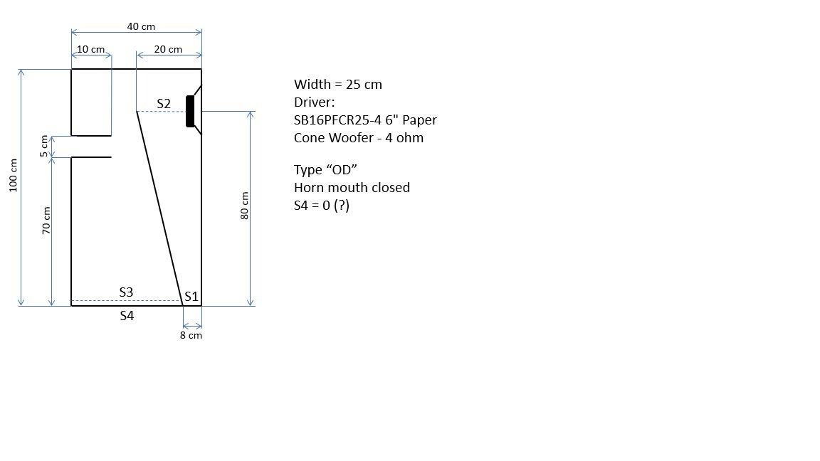

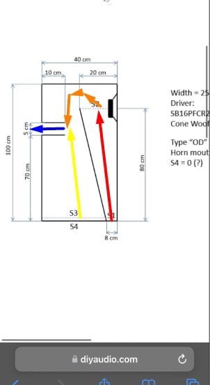

Hi, I am trying to simulate a transmission line enclosure with a bass reflex port. I tried to find an answer in this thread but did not succeed. If there is a thread about this topic please let me know. I've created a simple sketch of the design. It's neither proportional nor final, more like a starting point. In Hornresp I use the "OD" type for the offset driver horn. I entered the data according to my best knowing (see screenshot), but the FR shows I did something wrong... I need your guidance, please.
Greets!
Click on help, input wizard, whatever pi loading, direct radiator, transmission line, offset port, 3 segments, parabolic (all three), next shows an inverted TQWT, finish. Now save it as a master and add a new one to modify, then another master with an expanding taper, etc...
(I guessed at your length for the folded section ). Hopefully someone will chime in if they catch any mistakes
Maybe of interrest, i made a mltl simulation for 8hm version of that driver:Hi, I am trying to simulate a transmission line enclosure with a bass reflex port. I tried to find an answer in this thread but did not succeed. If there is a thread about this topic please let me know. I've created a simple sketch of the design. It's neither proportional nor final, more like a starting point. In Hornresp I use the "OD" type for the offset driver horn. I entered the data according to my best knowing (see screenshot), but the FR shows I did something wrong... I need your guidance, please.
Hornresp record attached.
Thanks a lot for the detailed answer! You guys are awesome!

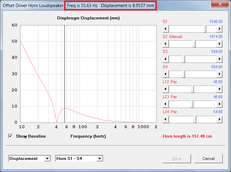

Hornresp Update 5700-241212

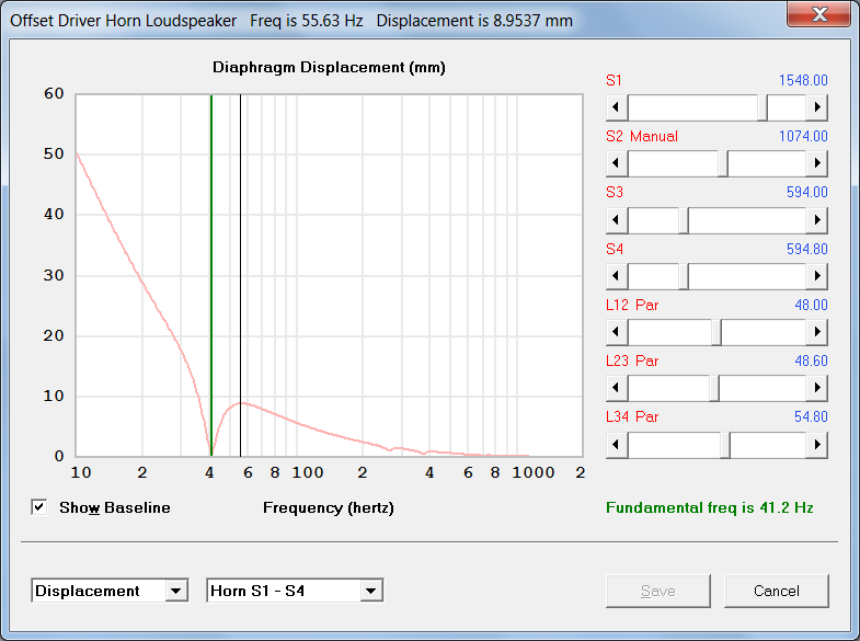

Hi Everyone,
CHANGE 1
Clicking on a loudspeaker wizard chart now shows the Y-axis value at the frequency given by the mouse pointer location. The information is displayed in the caption line at the top of the form.
The sampling frequency can be changed by dragging the black marker line, or by using the Up, Down, Left, Right, Home and End navigation keys. Press the Esc key to remove the marker.
Attachment 1 refers.
CHANGE 2
Clicking on a loudspeaker wizard chart with the Shift key pressed now shows the system resonance frequency. Previously it was necessary to double-click on the chart. Press the Esc key to remove the green resonance marker.
The sampling and resonance markers can both be displayed at the same time.
The resonance frequency feature is not applicable to the Multiple Entry Horn wizard.
Attachment 2 refers.

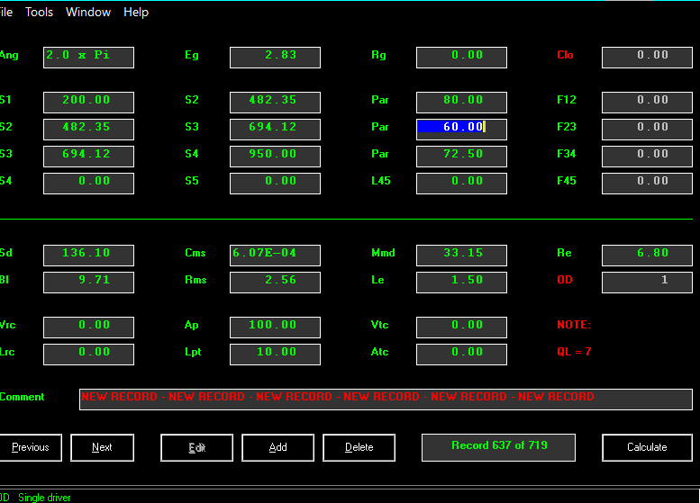

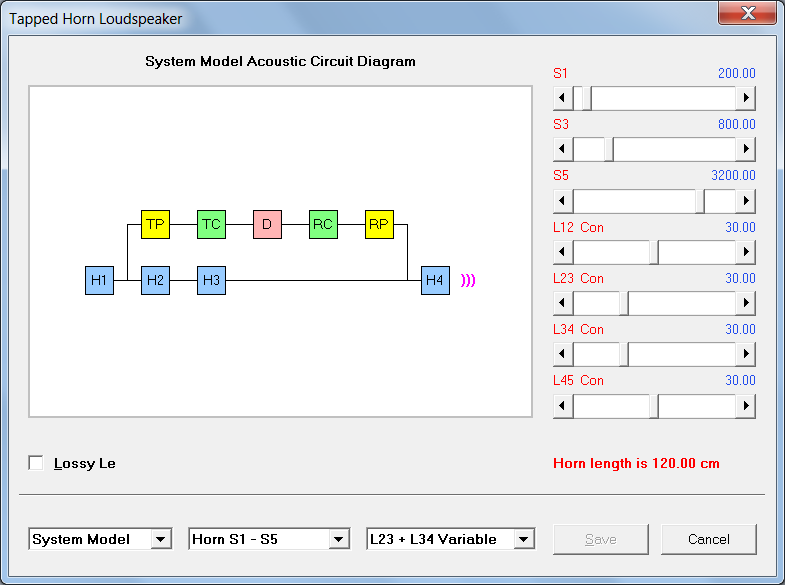

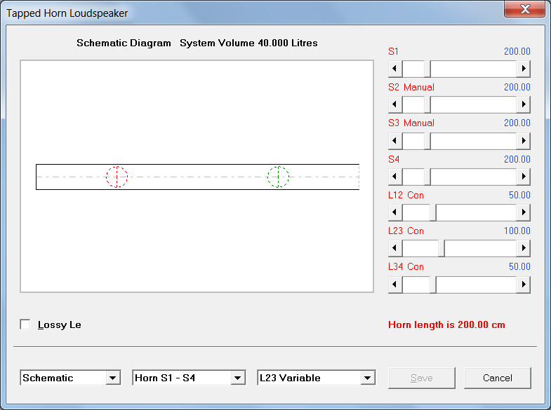

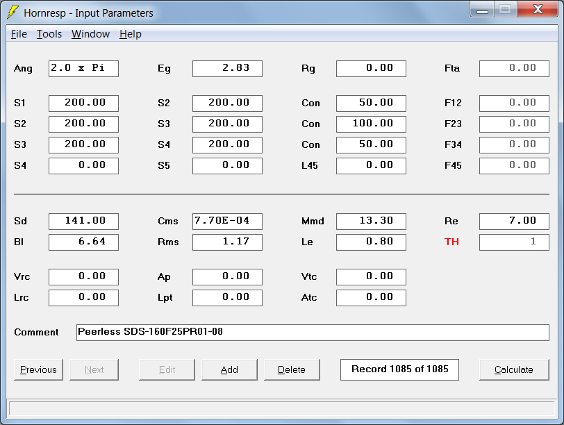

CHANGE 3
A tapped horn system can now have both a ported rear chamber and a ported throat chamber. The rear chamber port is specified using the Ap and Lpt parameters and the throat chamber port is specified using the Ap1 and Lp parameters.
From the main Input Parameters window:
Double-click on the Ap label in edit mode to switch to the Ap1 and Lp parameters. Double-click on the Ap1 label in edit mode to switch to the Ap and Lpt parameters.
Alternatively, use the Tools > Chamber Type > Rear Vented or Throat Ported menu commands to select the required parameters.
Set Ap and/or Lpt to zero if no rear chamber port is required.
Set Ap1 and/or Lp to zero if no throat chamber port is required.
Attachment 3 refers.
Extensive coding changes were made to implement the new features. Could you please report any bugs.

CHANGE 3

Thank you for your effort and this amazing xmax gift.
You're welcome. Not sure about the latest update being a xmax gift though... 🙂
Interesting now Hornresp is able to save both values even if they are not displayed at the same time in the interface.
The hidden port area and length values are stored in the two fields normally reserved for the Added Mass and Acoustic Path Length parameters (which fortuitously are not required with tapped horn systems).
Very tricky solution and can be explored in some different models 🙂
It is not possible to extend the feature to other models because they need to be able to access the Added Mass and Acoustic Path Length parameters (whereas the tapped horn models do not).

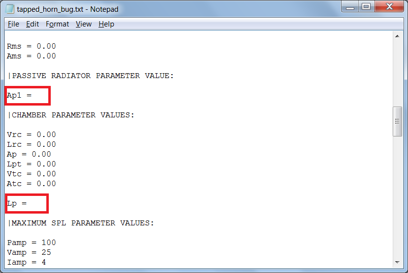

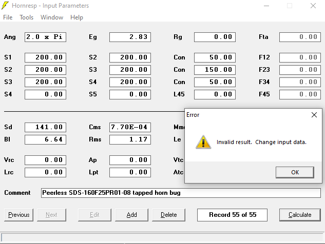

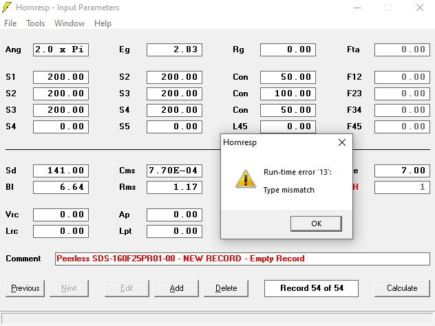

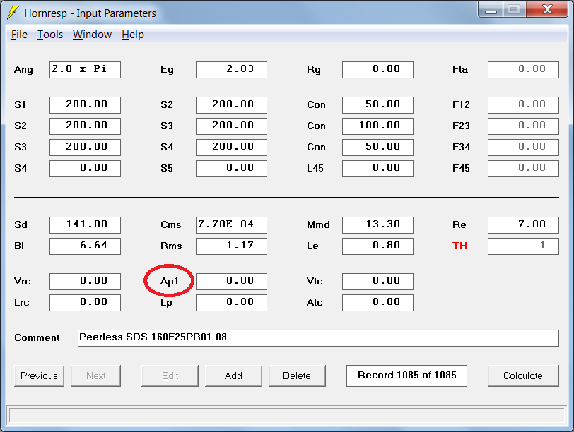

Bug report.
Attempt to open Loudspeaker Wizard in any mode of Tapped Horn (TH, TH1) causes error '13' type mismatch (attachment).
Update: trying to switch to Ap1 in Tapped Horn mode makes values disappear and causes the same error (attachment 2).
Bug report.
Hi Tachi778,
Thanks for the feedback.
Unfortunately I have not been able to replicate the problem, everything works just fine for me.
Would it be possible for you to export a copy of the record you are using and post the file here so that I can check to see if the data has been corrupted in any way? Many thanks.
Kind regards,
David
Hello David
Indeed, here's the record. (attachment 2)
And by the way, just noticed one more thing about it. If I close and open hornresp again, the record becomes completely unusable. I can't click calculate, it shows the error (attachment 1). Changing any data in the record doesn't solve the issue.
I also tried making new records with different drivers, but the same issue always happens with TH.
Note: my copy of hornresp is up to date.
Thanks, I have found the problem.
For some reason the Ap1 and Lp parameters have null values - they should be zero by default.
I will try to fix in the next day or so, but to get around the problem in the meantime either import the attached corrected record or use the Input Wizard to generate a new TH record and then amend it to suit your specific design.
Thanks again for the feedback!
