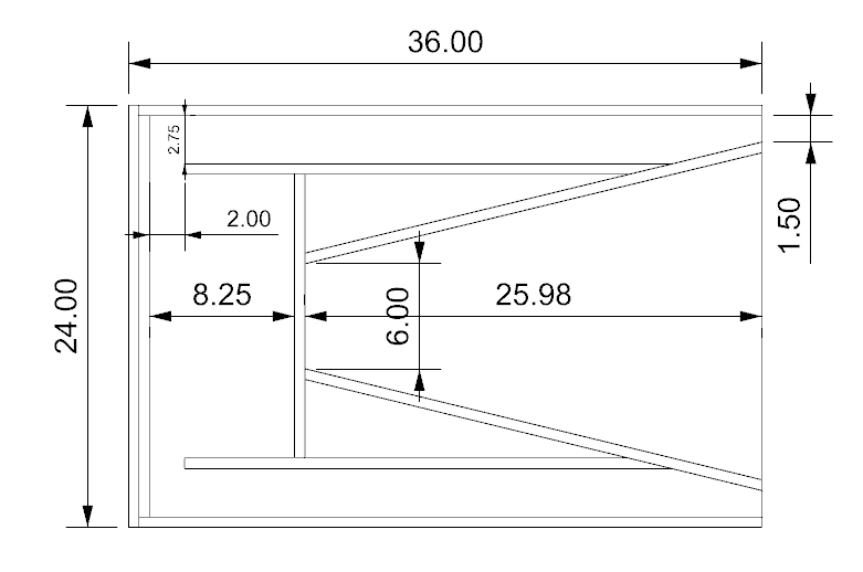

Can you offer some help with input parameters for this?
Assuming that the enclosure is rectangular and not circular, and given that the x and y dimensions are shown, presumably in inches, what are the z dimensions? Also, where is the driver located - on the rear panel of the enclosure or on the horn throat panel?

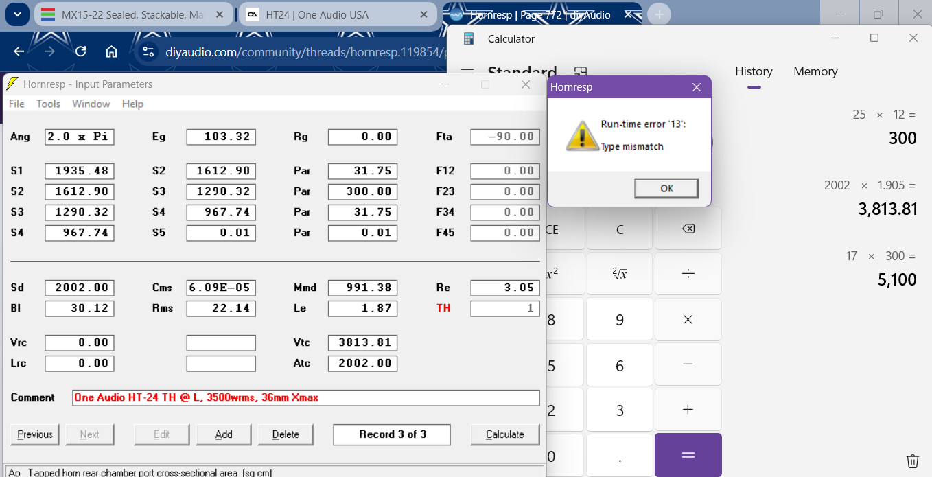

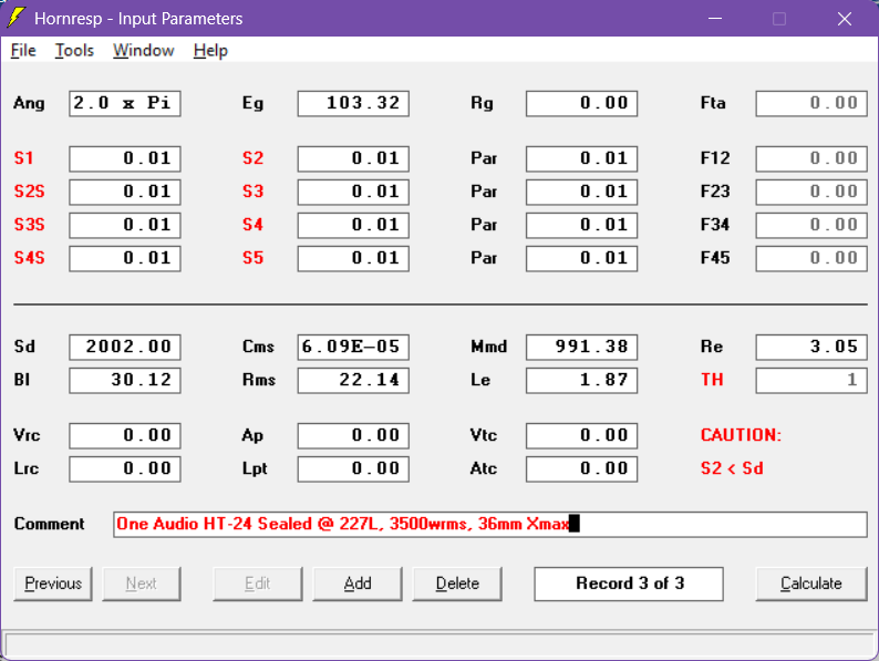

Good afternoon DMB! I'm getting the following error when switching from Nd to TH when clicking on the functions. HR switches to stepped mode and fills all the segments with 0.01. It also happens when switching Ap & Lpt. I got a new HP laptop for xmas.
Hi BP1Fanatic,
Many thanks for the feedback!
Having heard nothing further from Tachi778 or campbell p I didn't know where to go looking for the problem. The information you have provided has enabled me to hopefully resolve the issue once and for all. I will try to release an update in the next day or so.
Note that switching to stepped segments when clicking from OD2 to OD3 (Ripole) is quite normal.
Thanks again for helping to make Hornresp a better product.
Kind regards,
David
Kind regards,
David
Just to clarify, I should have said not cylindrical rather than not circular.
Only if you can provide the further information requested in Post #15,429.
It was hoped that the most recent update would fix the problem. Unfortunately Tacchi778 never came back to advise if it did or not. Are you using Windows and Hornresp Product Number 5700-241216? If so, then could you please export a copy of the record you are using and post the file here so that I can check the data.
Hello David,
Sorry for not replying earlier; I've been up to my ears with various stuff.
So, the fix you released didn't work right away. I tried completely reinstalling Hornresp while keeping the Drivers folder, and what's weird is that the issue was still there. I called it a day that time. Some time later, I went back to Hornresp, and the issue was resolved seemingly on its own.
A few days later, I built a new PC, moving just the Drivers folder to the completely new system where I freshly installed Hornresp. Since then, I haven't experienced any issues with Tapped Horn mode.
By the way, I think it might be Windows Defender or some new safety features interfering with the lesser-known program. They've been pretty aggressive lately, and I get like a million warning screens every time I install or update Hornresp. Maybe you should try debugging it on Windows 10 version 22H2.
