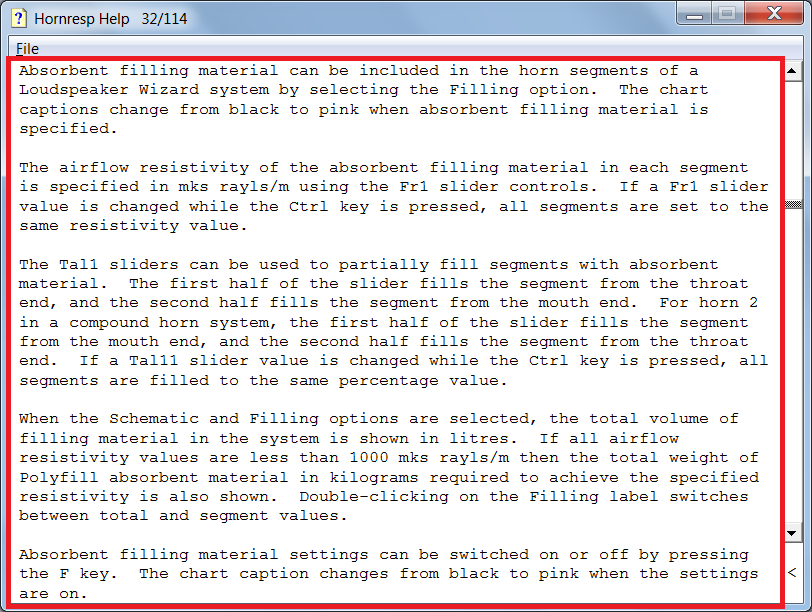

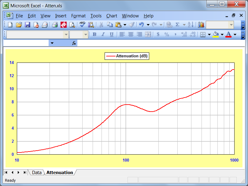

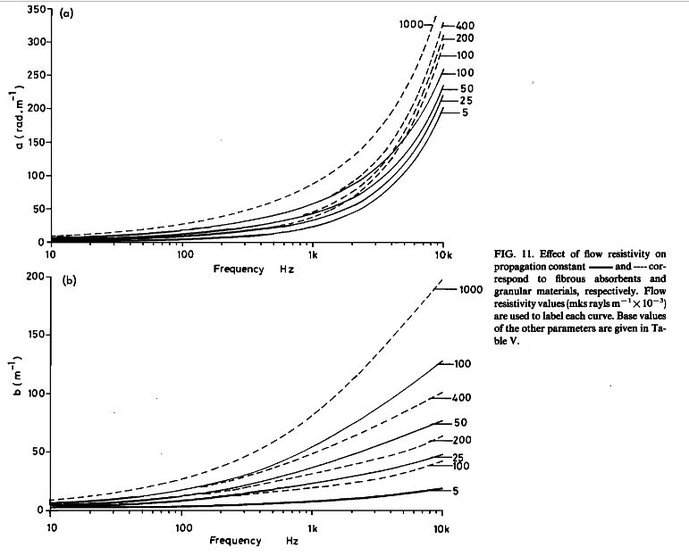

The attenuation of the absorbent filling material increases with frequency. The image below compares the default record number 1 power response (green trace) with the power response after an amount of filling material is added (red trace).
What filling material does Hornresp simulate and what are its properties?
Hornresp does not care what sort of filling material is being used.
All it needs to know is the airflow resistivity of the material, specified in mks rayls per metre.
Hornresp shows "total filling [litres]" and "total polyfil [kg]". IF simulating a transmission line, is it the total volume ofthe TL in litres. And "total polyfil" is the weight of ?what? evenly (?) distrybuted in the total volume of the TL?
It's all in the Help file (use the Find tool to search for filling).

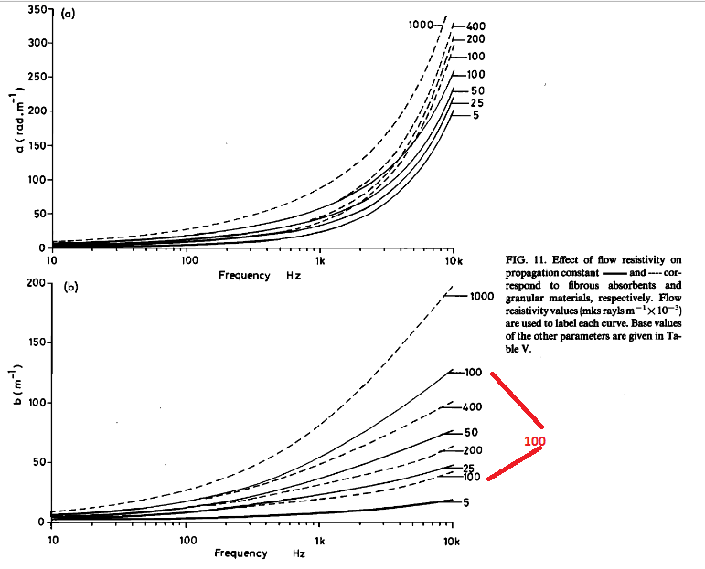

I have a question about "filling". Does Hornresp assume uniform attenuation over the frequency of the filling material?
What filling material does Hornresp simulate and what are its properties? Does it assume frequency dependend attenuation of the material?
In "Laudspeaker wizard" window, when selecting "schematic" and filling, Hornresp shows "total filling [litres]" and "total polyfil [kg]". IF simulating a transmission line, is it the total volume ofthe TL in litres. And "total polyfil" is the weight of ?what? evenly (?) distrybuted in the total volume of the TL?
IIRC, the Hornresp filling model is based on this paper: Simple, relaxational models for the acoustical properties of porous media.
I read this part of the help file before posting my question.
@Kolbrek @David McBean Thank you for clarification. I still however do not understand what what does the attenuation charactristic of the filling material look like as a function of frequency?
I have to say that I am not an expert in this field. But I read the paper you mention (frankly, I do not understand much of it) Simple, relaxational models for the acoustical properties of porous media and it references a paper by Attenborough, K. (1983) Acoustic Characteristics of Rigid Fibrous Absorbents and Granular Materials. Journal of the Acoustical Society of America, 73, 785-799. The graph below is taken from [Attenborough]. If I am reading it correctly, specifying the airflow resistivity of the material in mks rayls per metre does not define the frequency dependend attenuation of the material used. For example, if we look at the graph below we will see that a material of 100 mks rayls per metre can have different chararacteristic depending on whether it is a fibrous absorbent or granular material (dashed or continuous line).

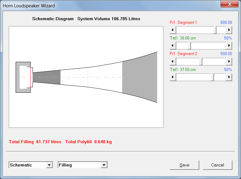

In you screenshot below, is the "Total polyfill 0.648 kg" calculated from Fr1 and Tal1 and valid only for the specific type of "polyfill" embedded in Hornresp?
I mean the nr 0.648 kg. In other words, if I buy "polyfill" form Amazon it will be different than "polyfill" from Digikey? I may need 0.7kg of one polyfill while 0.648kg of the other one?
What if I want to use wool or cotton as my dumping material? Is the model embeded in Hornresp still valid? How to recalculate it?

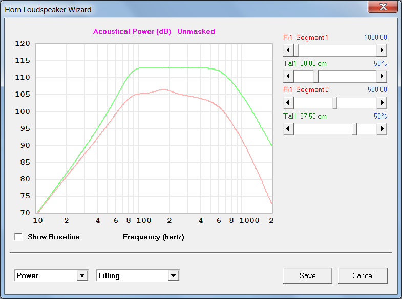

For the example I gave it's simply the difference between the green and red trace values at each frequency. If required for some reason, the data for the two traces can be exported and the attenuation (green value minus red value) plotted as shown below.
That's because different models are used for the two material types. The Hornresp model assumes that the absorbent material is fibrous. (Concrete, gravel and sand are examples of granular sound absorbers).
Yes.
Yes.
Hornresp uses an empirical model to determine equivalent Polyfill weight. It is only intended to give the user an idea of the amount of filling material likely to be required. The Polyfill model was requested by a user and was developed based on data provided by them. It is completely separate from the main absorbent filling material model used to calculate power response.
If the airflow resistivity of the material (at the packing density being used) is known, then the model is totally valid.
There is nothing to recalculate - simply enter the correct Fr1 and Tal1 values.
