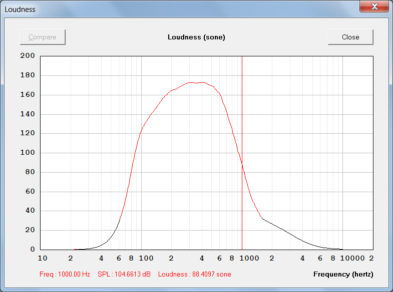

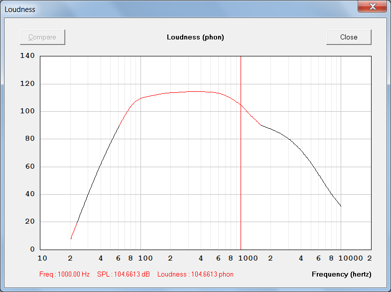

A chart has been added that displays the loudness or perceived sound intensity of the power response sound pressure between 20 Hz and 10000 Hz, with the results being calculated in either phon (logarithmic) or sone (linear) units using the normal equal-loudness-level contours given in ISO 226:2023.
Results are valid from a lower limit of 20 phon to:
An upper limit of 90 phon from 20 Hz to 4000 Hz.
An upper limit of 80 phon from 5000 Hz to 12500 Hz.
Phon and sone values outside the limits are shown in red and are informative only, because of the lack of supporting experimental data.
The chart is selected from the acoustical power chart window using the Tools > Loudness menu commands. It is not applicable to the loudspeaker wizard.
Attachments 1 and 2 show the results for the default record (with resonances masked). Note how the SPL and phon values are the same at 1000 Hz.

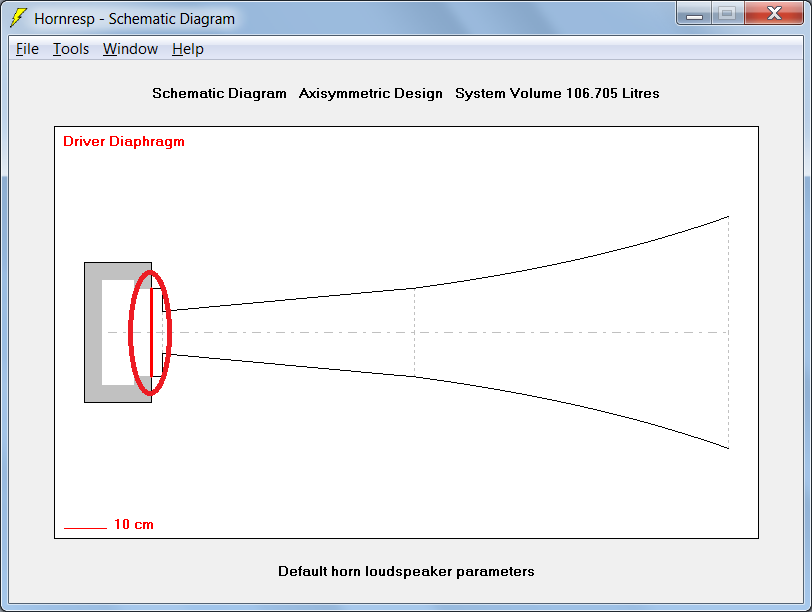

Double-clicking with the Ctrl key pressed on a schematic diagram that has the driver or passive radiator diaphragm shown as a straight line, now increases the width of the line to make it easier to see. Double-clicking again with the Ctrl key pressed resets the diaphragm line back to the default thickness. Not applicable to band pass enclosure systems as they have thicker lines as standard.
Attachment 3 refers.

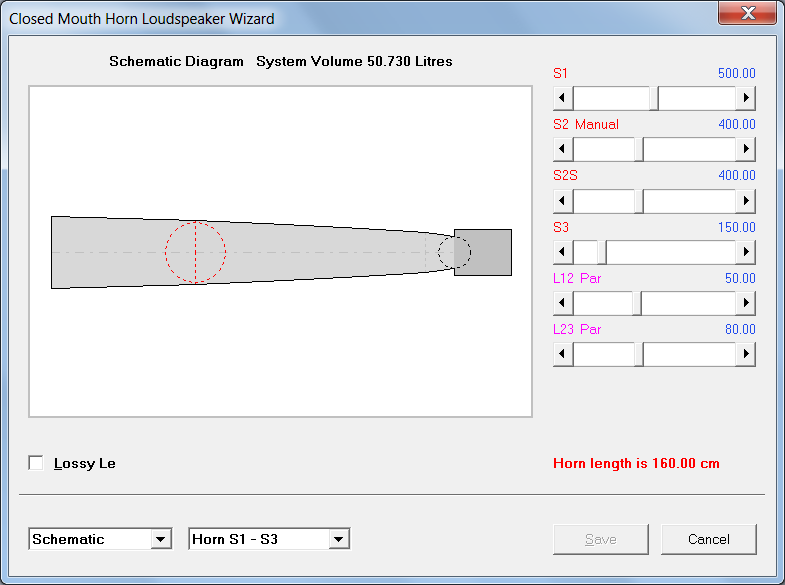

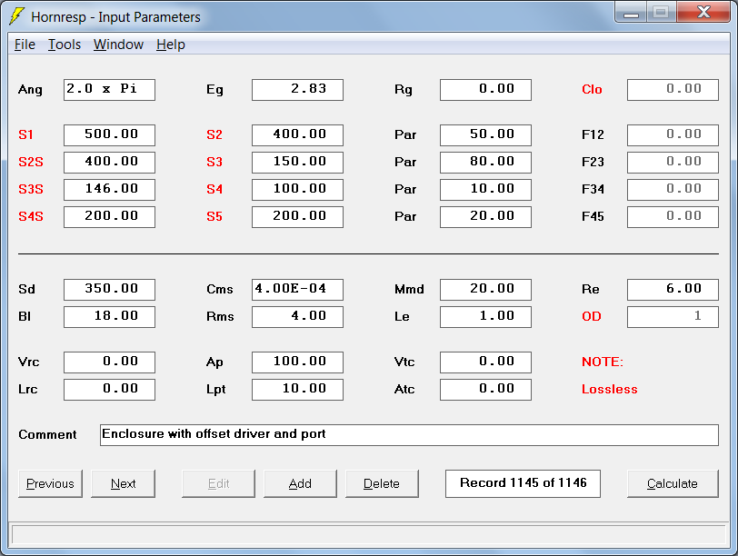

Wow, so the Input Parameters looks like a negative flare horn (S1-S4) even though the Schematic Diagram comes out a positive flare horn.
I see its a left to right situation.
I really dig how that Schematic Diagram came out!
I'm on my work laptop so I can't play with latest version. Does the OP (Offset Vent?) part of ODOP equal the NOTE: Lossless message?
The schematic diagram shows a negative flare also (the closed-throat is at the left-hand end and the closed-mouth at the right-hand end).
As indicated in Post #15,483 Hornresp does not have a model specifically intended for the system described in Post #15,478. The model suggested by Brian in Post #15,484 is about the best that is available. Using this compromise model Hornresp assumes that the loudspeaker is a bass reflex design with offset driver and offset port. It also assumes a default QL vented-box system losses value of 7 and that the port tube has an end correction.
For the transmission line / stub system being simulated however, the QL value should be set to Lossless and the port tube end correction compensated for. The Lossless note is related to QL and is referring to the total bass reflex system, not just the port tube. In reality the TL design in question is not actually lossless because absorbent filling material has been specified.

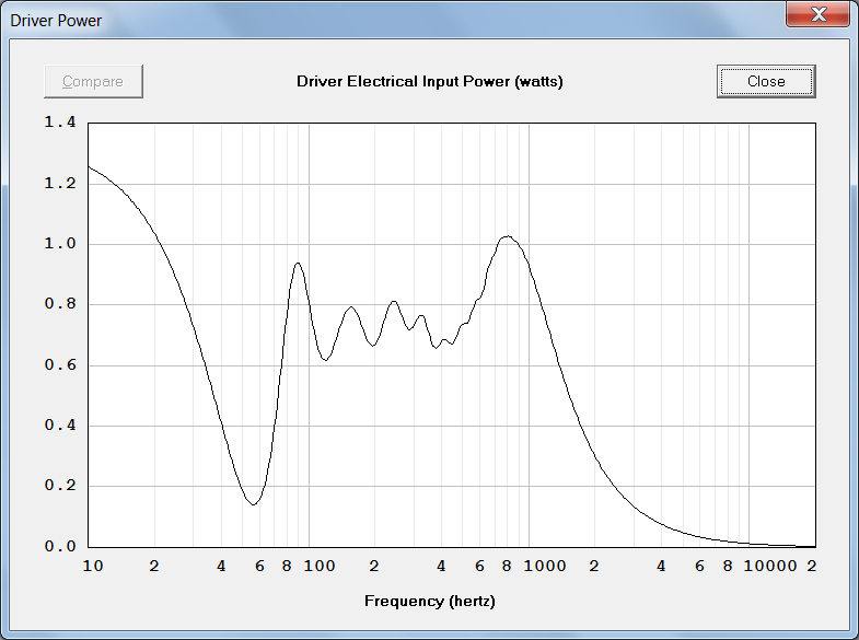

A bug was inadvertently introduced when the above chart was added. All secondary charts are now limited to the 20 - 10000 Hz frequency range, not just the loudness chart. The driver input power chart is shown below as an example. The bug will be fixed in the next update.
