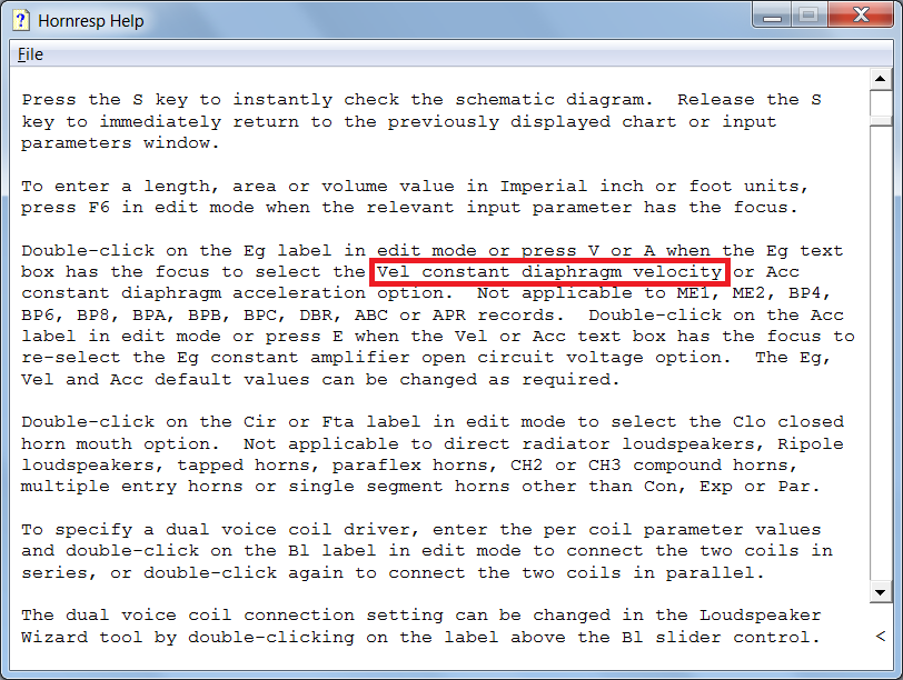

Which Thiele-Small parameters for the compression driver are necessary/enough to input?
That is not so easy to get. We used to be able to design a horn purely on the input specifications without regard to the driver parameters. I tried quickly yesterday but I did not succeed. Over today I will read in the manual where this option has moved around to. If I find it I will post it here for kypti. As David posted and as I have also designed horns for high frequency it can be done. It has been a few years since I have designed a horn like this and David has changed the program quite a lot!

Thank you for your reply, but I've gone through several variants of existing horns for this driver (including this one) and I don't like them, either with the resulting frequency response or the uniformity of the decay, and really good solutions are large in size. I'm looking for a compromise between size and good frequency response, so I decided to design a horn that will satisfy my needs myself
Be sure to try the Oblate Spheroid, Tractrix and Spherical horn types as these are generally better behaved.
Reactions: kypti

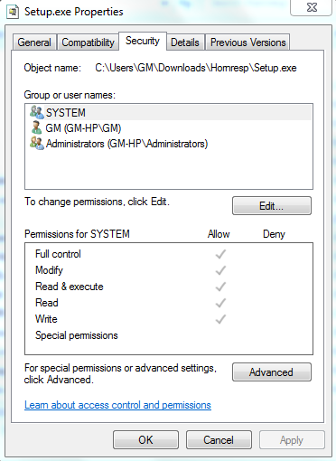

@GM
Windows (sometimes) defines downloaded files as "not safe" and will not run exe-files.
By right-clicking the file and selecting "properties" there should be an "unblock" tick box at the bottom under "security" that allows execution of the file.
It's different from this, but appears to allow it.........

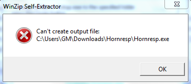

That said, There is an 'unblock' in the 'General' tab, but checking it changed nothing with a new setup.exe download/install, so still only have the hornresp.exe 250210.......or was I supposed to delete it too? With these updates historically 'transparent', really clueless :scratch1: :sigh:
I did just now and got this error
1. Right-click on your existing Hornresp shortcut and delete it.
2. Using Windows Explorer, create folder C:\Hornresp if you don't already have one.
3. Download Setup.exe, unzip it and save the four files to the C:\Hornresp folder.
4. Right-click on the Hornresp.exe filename in the C:\Hornresp folder and create a new shortcut.
5. Run Hornresp.
6. Close Hornresp.
7. Find your existing Hornresp.dat data file, wherever it is, and copy it into the C:\Hornresp\Data folder, overwriting the default one that Hornresp has just created.

I work in a company where I am trained and share my experience (you can learn more by looking at my thread), and I am currently revising existing loudspeakers, and the speaker with this driver is loaded with its own milled MDF horn, and the measurements showed that it is not good enough. This is an installation loudspeaker that needs to be small in size. There is a commercial horn, the B&C ME10, which would be a good solution, but it is expensive for such a speaker system. I'll attach the measurements of our horn and the ME10 off-axis in 10 degree increments
The easiest option for the simulation is probably to use the constant diaphragm velocity option David mentioned. You can try to model the ME10 in Hornresp to get a feeling for how close to reality Hornresp can get for this kind of horn.
But if the ME10 works, and you need to design a horn yourself, why not use the geometry of the ME10 as a starting point?
seems there are some mixups on your PC, maybe multiple copies of hornresp.exe or shortcuts......
make a backup of the folder you know is working with an old version to safe you designs. You could put all the contents in a ZIP file for example and store it somehwere safe.
download "search everyhting" tool. This scans ALL of your harddisk and is able to find ANY file within a fraction of a second, once it has scanned the drive initially.
with "evrything", search for "hornresp.exe"... This will show you EVERY Copy of hornresp - as well as shortcuts pointing to any of these files.
If you have your backup safe (see above), delete ALL copies of honresp, folders, shortcuts...
Now go to the security center in windows and check, if there are leftover warnings which might have falsly appointed a security risk to any hornresp.exe files. If there are some left, windows might have put a copy of horensp.exe in the quarantine... Make sure there is no infinished business left in the security section.
now download a fresh setup.exe and install a new version of hornresp to the folder of your choice. Pay attention to any popups from windows. Windows might think hornresp is not safe to download or install. If any popoups show up - tell windows, its all good and safe and that you really want to download, keep the file and install it (according choices are presented to you in the dialogs from windows).
now you should be ok - recheck with everything if you really have only ONE copy of hornresp. If you have started hornresp prio to checking with everything, you might also encounter another file looking similar - this could be a new shortcut, a "recent opened files" shortcut or maybe a prefetch version (.pf ending)... This should not be harmfull and be ok...
now start hornresp.exe and ccheck if it runs and is the most recent version...
if so, close hornresp again - go over to your backup and restore your old folder with your projects into the new hornresp folder...
Should be finde now 🙂
Hope that helps, looking forward to your response.

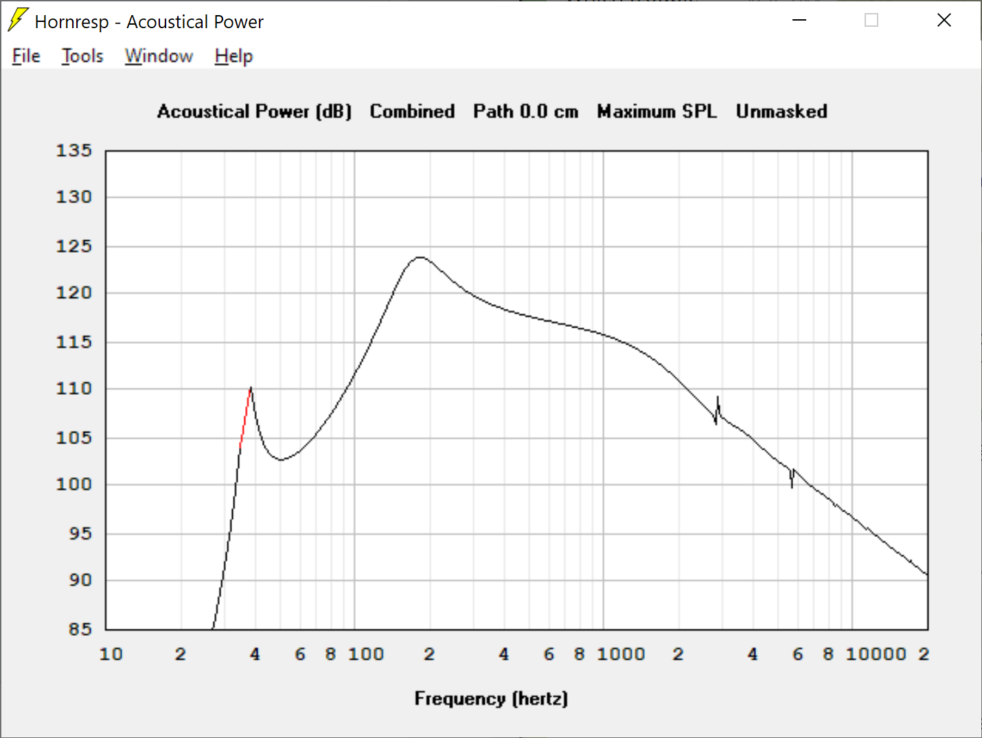

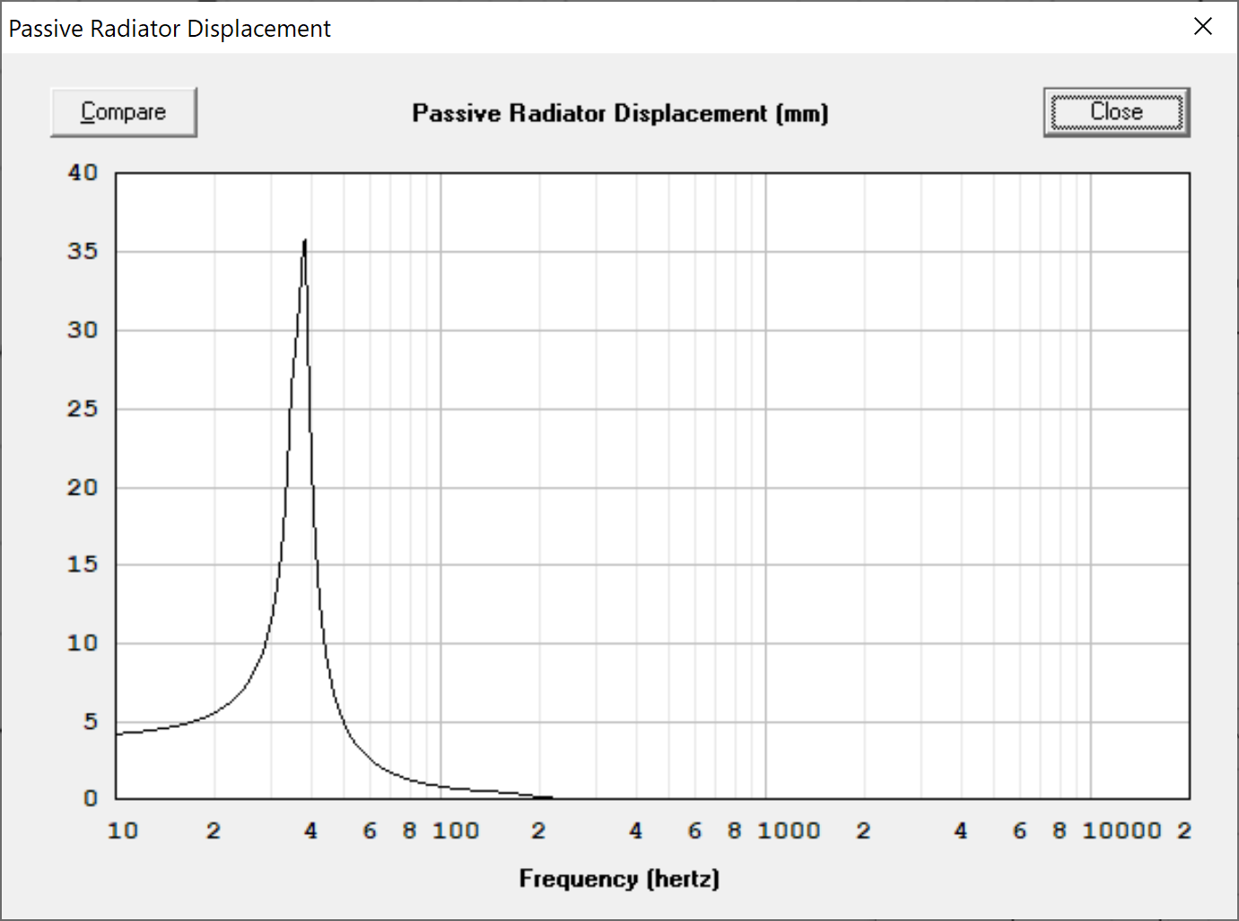

Either I found a bug, or Mark doesn't know how this part of Hornresp works.
In 25 years of using this program this is only the second time that I modeled a passive radiator.

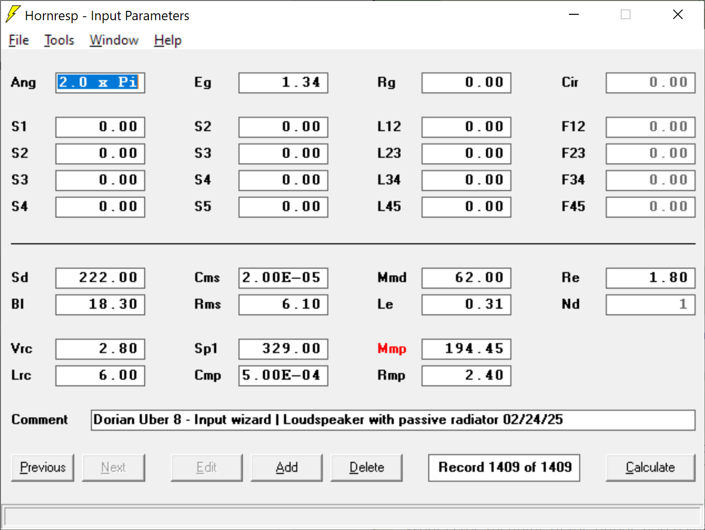

Input screen. Custom Driver and Custom P.R.

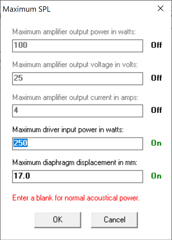

Setting up for max SPL and checking the P.R. excursion.
We get this. Now this is limited to 17mm X-max. The surface area is about 1/3 smaller than the P.R. so the P.R. should be about a 1/3 less.
How?

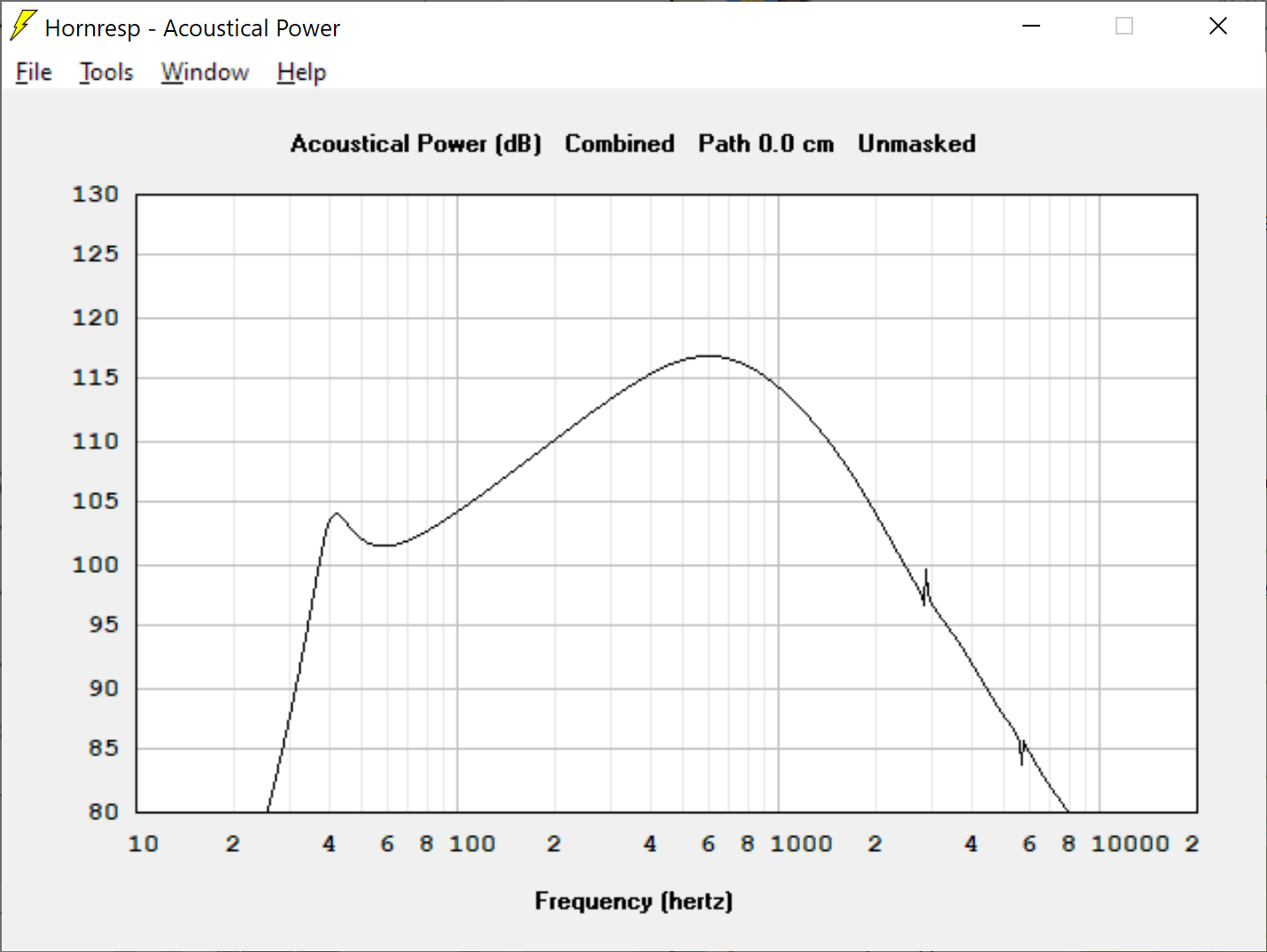

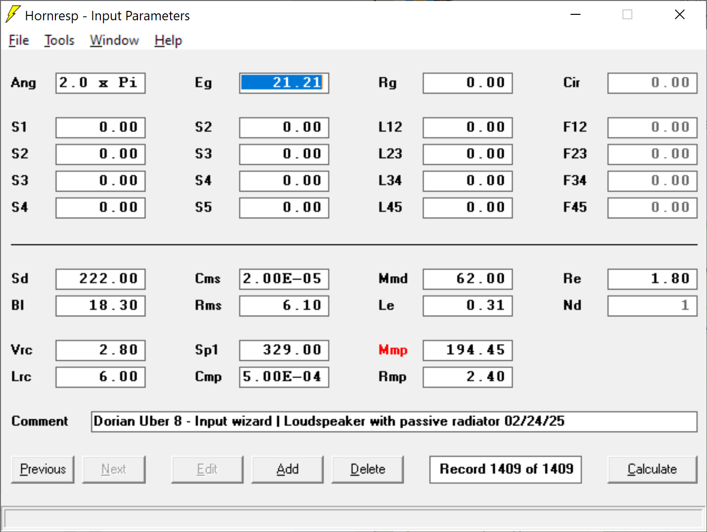

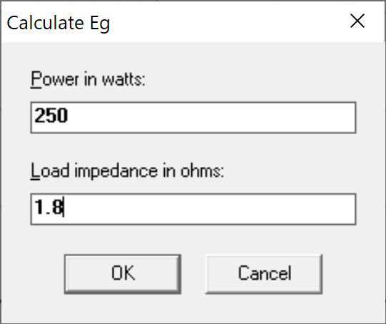

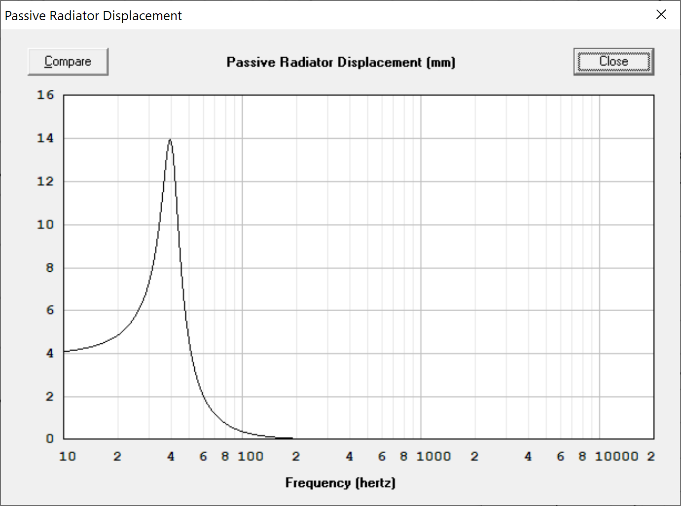

If I do a proper 250 watt input from the input screen I get a realistic result:
This is what should be the result.
