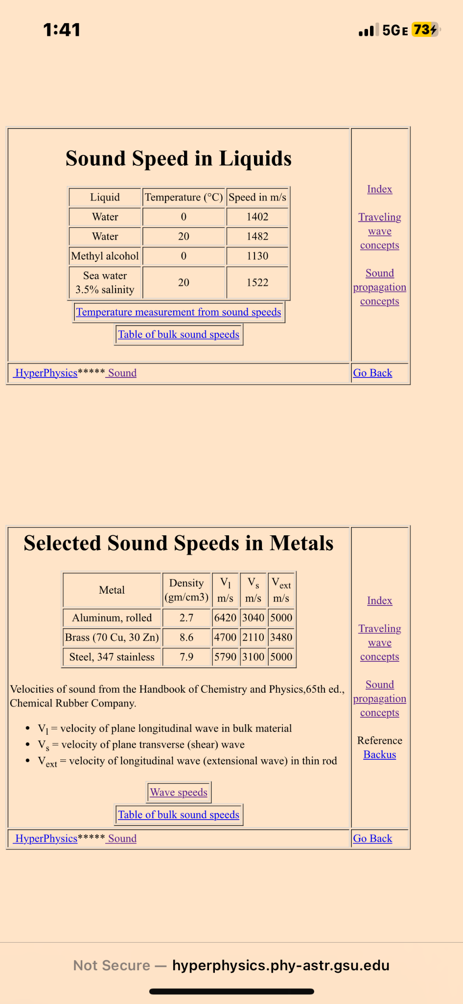

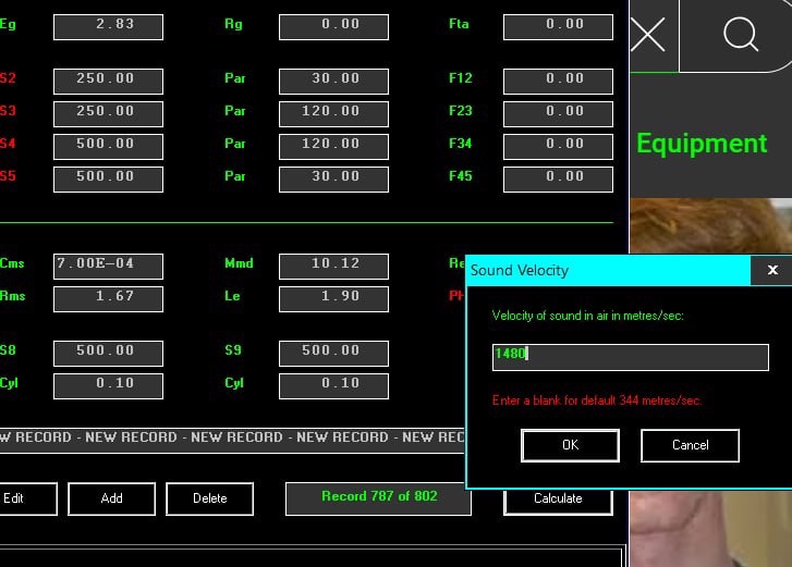

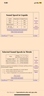

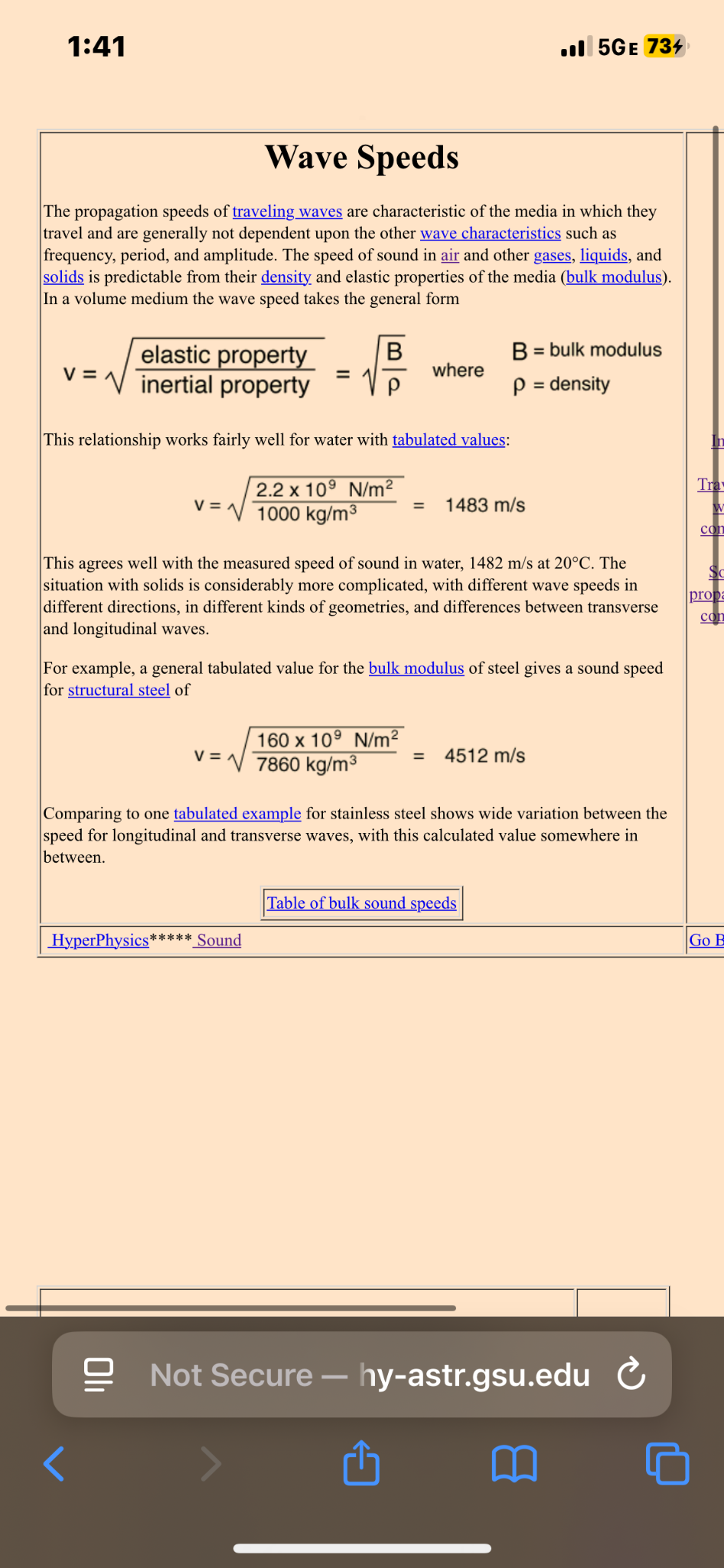

I’m guessing this doesn’t really portrait what would happen in a liquid or solid? (If we used the speed of sound in water in horn response )
