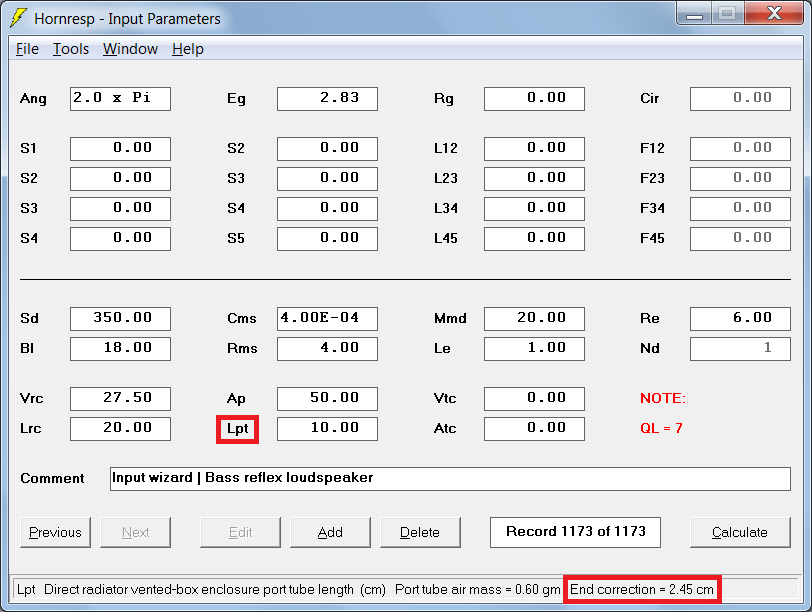

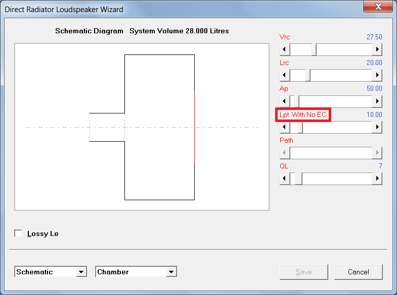

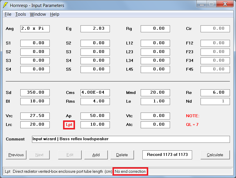

Hi Everyone,
CHANGE
Previously when the Lpt port tube length parameter was used in other than a tapped horn design it automatically included an inner end correction. The Ap / Lpt combination is sometimes used for other purposes however and in these situations it is often better if the end correction is not included.
Instead of having to manually adjust Lpt by subtracting the end correction, and which cannot be done if Lpt is shorter than the end correction, it is now possible to specify Lpt with or without an end correction.
The end correction is included by default but can be removed by double-clicking on the Lpt label in edit mode. The label changes to red to indicate that there is no correction added. (Not applicable to ME1 and ME2 records).
Kind regards,
David

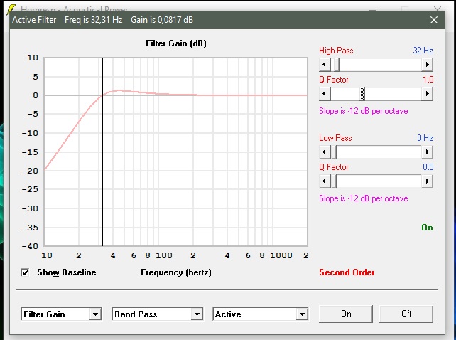

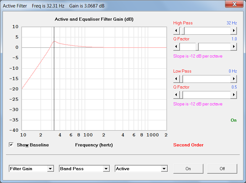

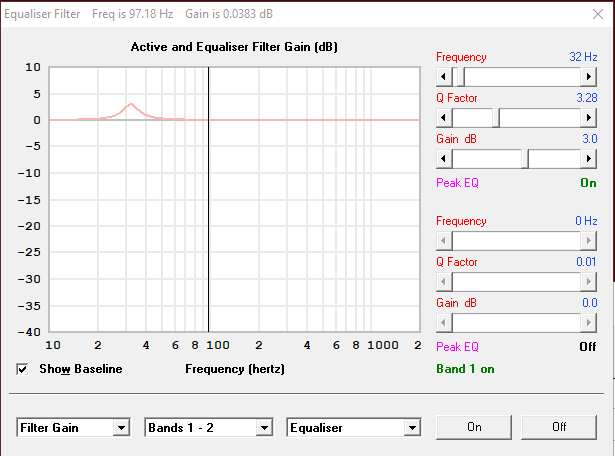

Hello @David McBean
Can you take a bass boost at a certain frequency into account in Hornresp? For example, the Mivoc AM120 (no longer available to buy) has a bass boost with a subsonic that depends on it. That is exactly +3dB at 32Hz. WinISD has a special function for this called "Peaking 2nd Order Highpass". You can find it under
Filter. Here you simply enter the 3 dB for the boost factor and the 32 Hz for the boost frequency and that's it. The program takes this bass boost into account. Is there a comparable function in Hornresp to take a fixed bass boost of the active module into account in the simulation?
Kind regards
