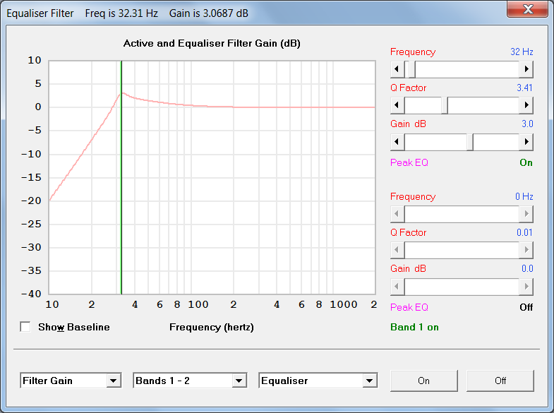

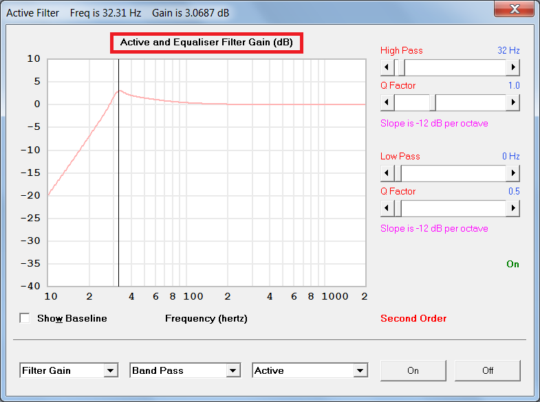

But how am I supposed to know?
The title of the chart is "Active and Equaliser Filter Gain (dB)".
why does your image have a Q-factor of 3.28?
It was an attempt to match the gain profile I gave. The value actually used originally was 3.41.

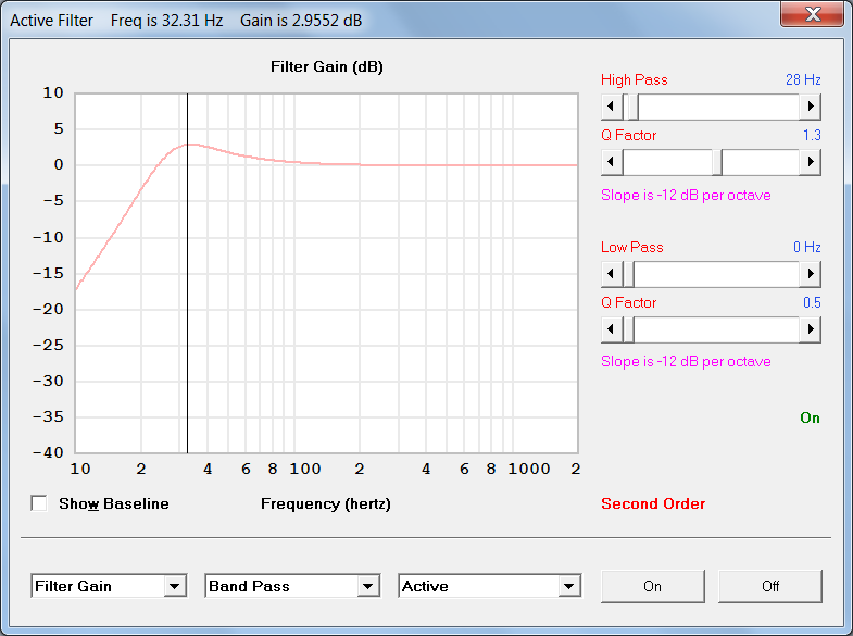

If you don't wish to tweak the profile with equalisation then the best result using just the 2nd order active filter becomes:

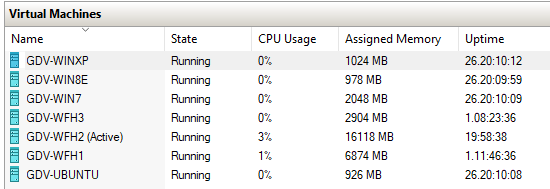

I use the VM approach 🙂[snip] I STRONGLY urge you to move to Windows 11 and run Windows 7 in a VM (virtual machine) if you need it.
