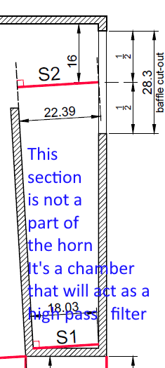

Careful what you consider a part of the horn length. The part below the driver entry hole is not a part of the horn path. It will act as filter in the horn path. Limiting the higher frequencies. Just as an inductor in a crossover limits high frequencies.

Basically, you're right. But this range also offers a few advantages. You can influence the height of the first resonance by experimenting with the length. And you can also use this range as an internal Helmholtz absorber (IHA) by introducing damping here. So there's definitely tuning potential here, allowing you to model your frequency response as desired. I've done this a few times with my TH projects.
Exactly. Just don't count it as path length. I agree it has a lot of function. Line it with absorbing material like wool or cotton fibre, Rockwool you can really attenuate the midrange. I have used this a number of times for different back loaded horn projects. The first one of these I made was of a plan that I really did not understand in 1994. I slowly learned about the useful benefits of this kind of chamber.
Thanks for your imput Mark.

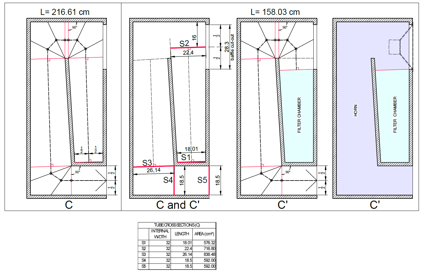

Well, this greatly changes the length of the tube. Although until now I've been almost mechanically integrating the feedback from those who have commented in order to feed the software with the appropriate data, I'd like to learn the theory behind it.
I did the graphic exercise based on what I understood from your suggestion. What's not clear to me is whether the determination of the areas of sections S1 through S5 should change with this new consideration, because these are the ones that volumetrically determine the folded horn (something like a folded Voigh pipe, which is what I understand), that is, width X height X (and)length.
Above is a sketch comparing what I had (C) and the new information (C'). This changes the data enormously.
B.
Moving the driver from the closed end of a horn/pipe doesn’t disconnect that section from it. It’s just an attempt to prevent the /3,9,15…. Resonace from being excited ?
It will do a few things. Yes, there will be a resonance excited. You can calculate that with the reflective path length of the bottom of the bucket, and the inside of the enclosure top. A secondary resonance will be left of the bucket to the inside of the front baffle. Many people never think about these things. But they are there. I spent months with one client chasing all of this stuff.

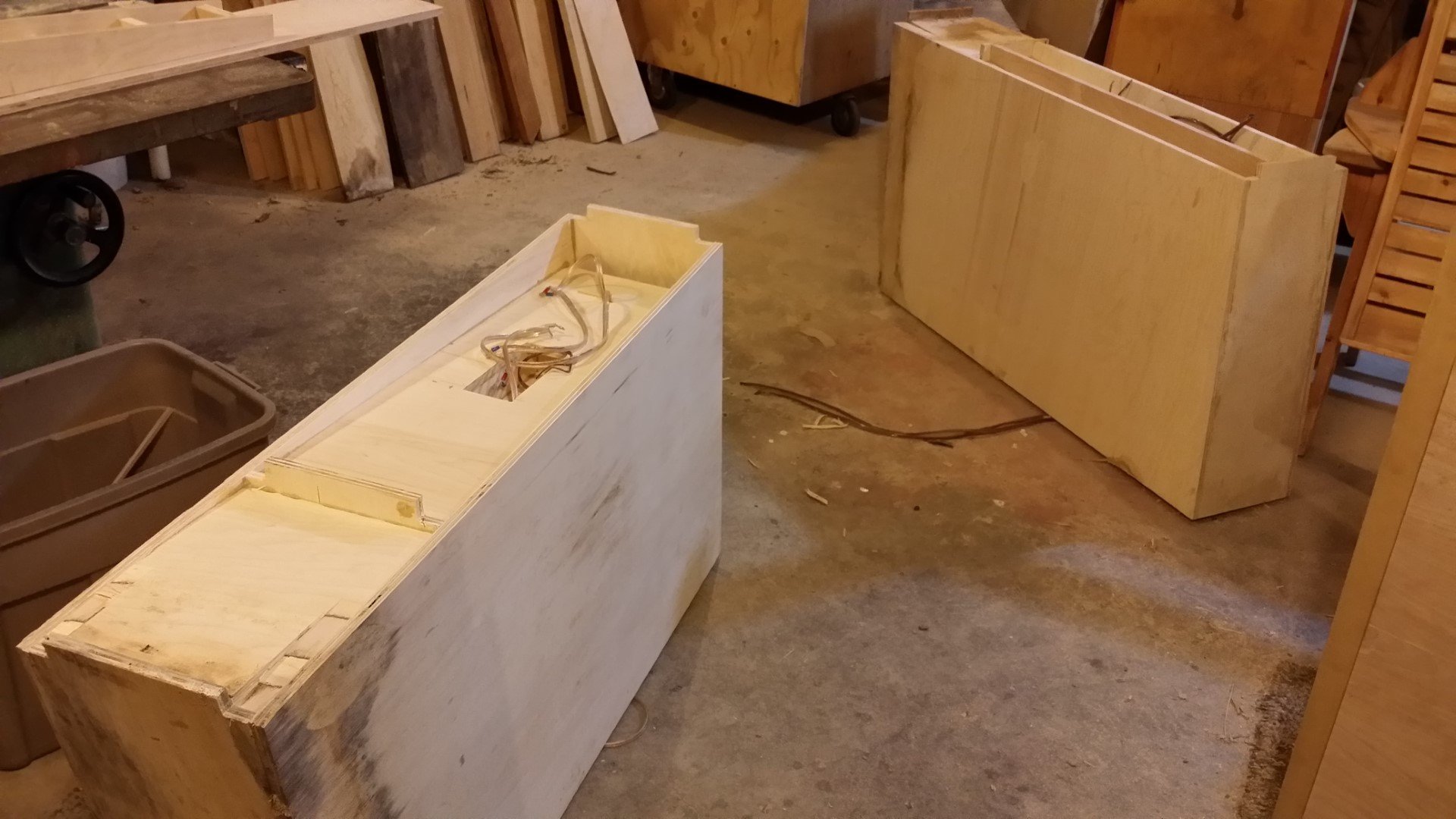

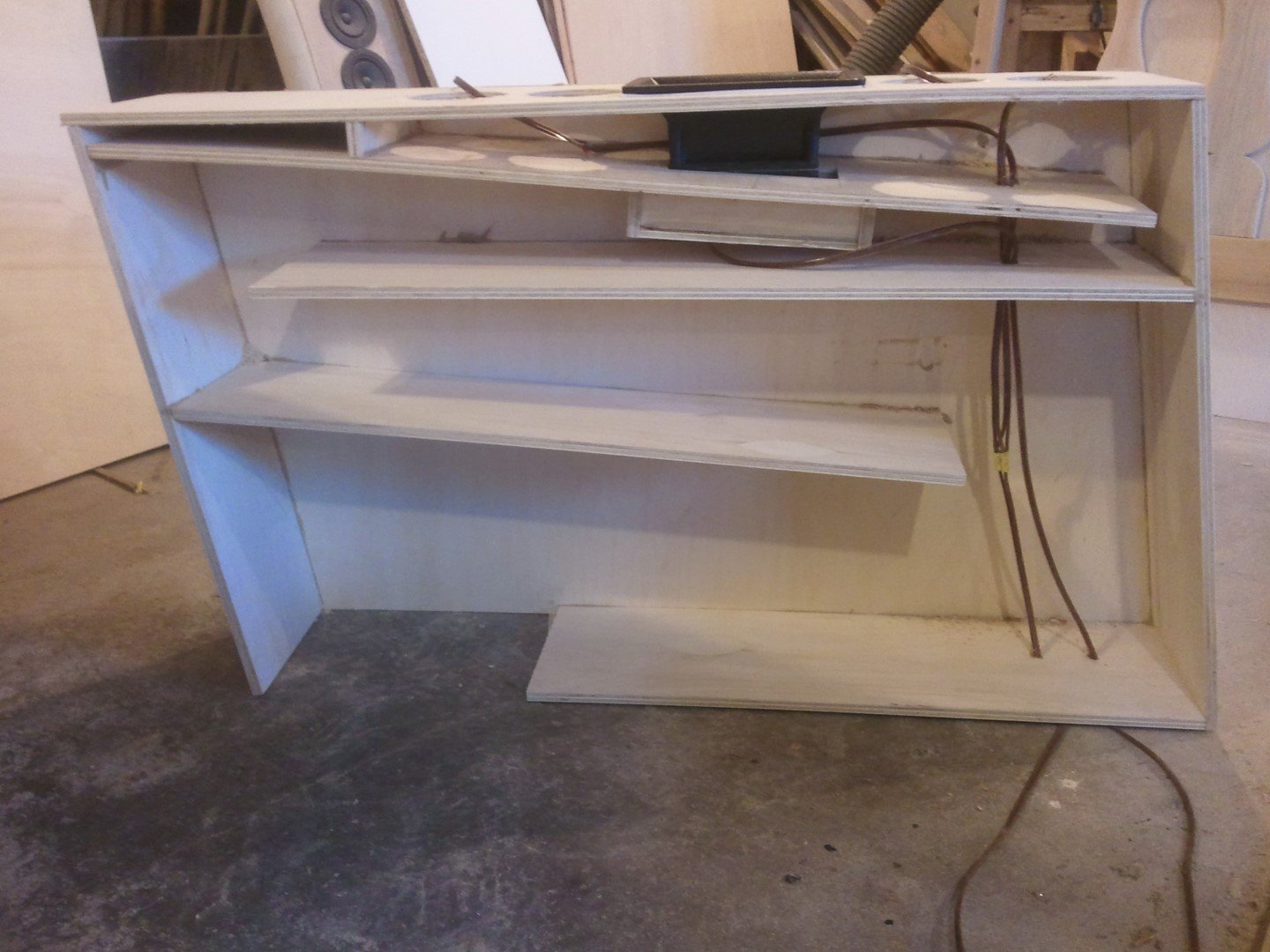

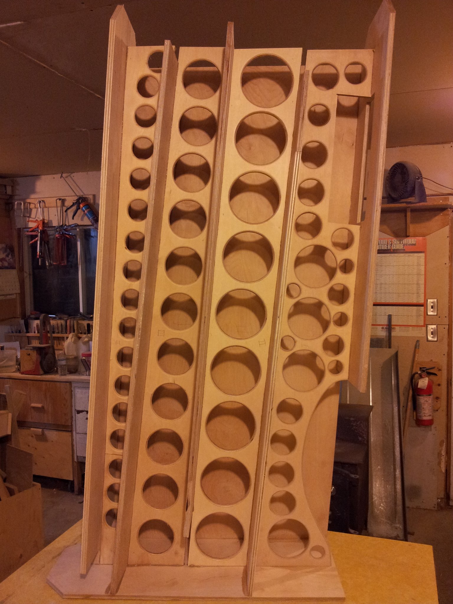

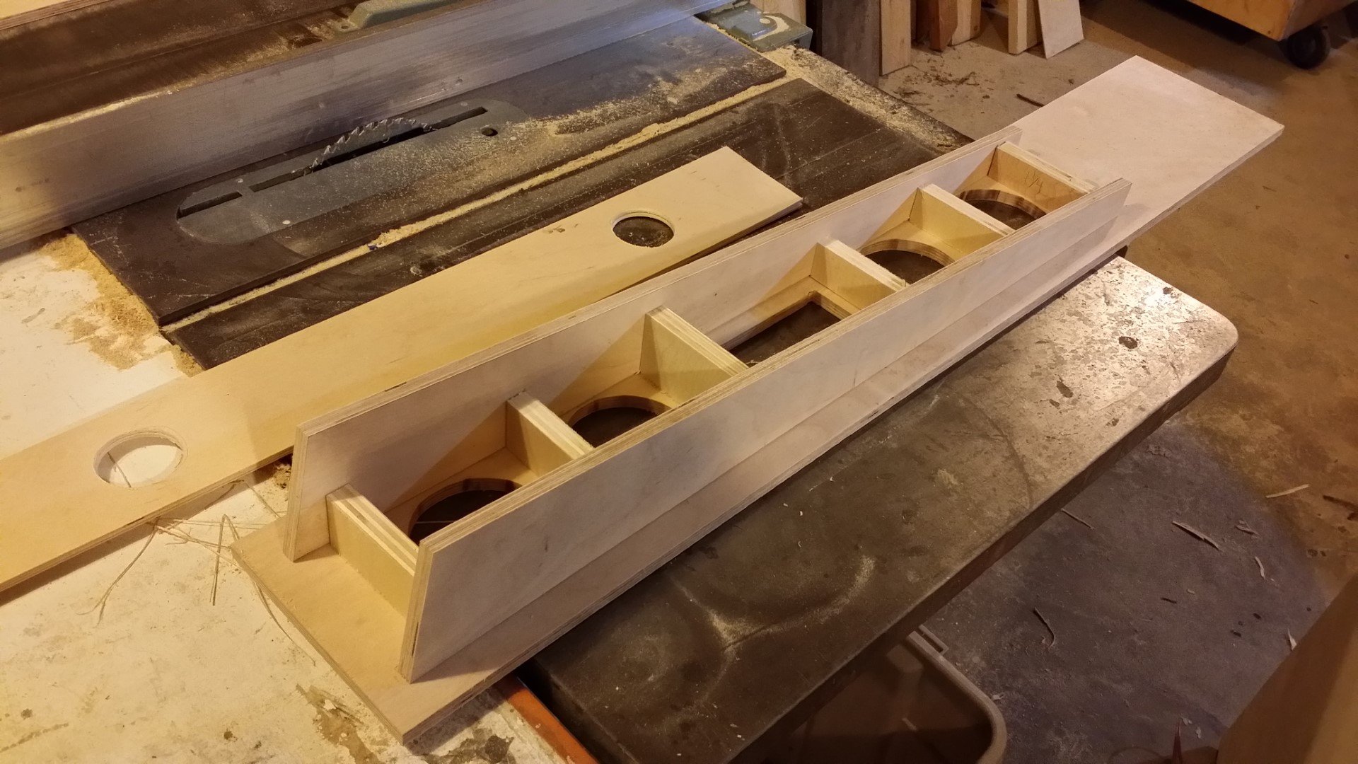

A few examples of how I have applied these principles. When I design ed these about 13 and 14 years ago I was not really thinking about using absorbing materials. Those epiphanies cam along later. These are back loaded horns. The smaller one with a bit of EQ is flat to 30 hertz. THe larger one we had flat to 14 hertz in a hotel room. Lets just say it was fun!

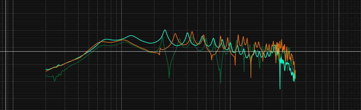

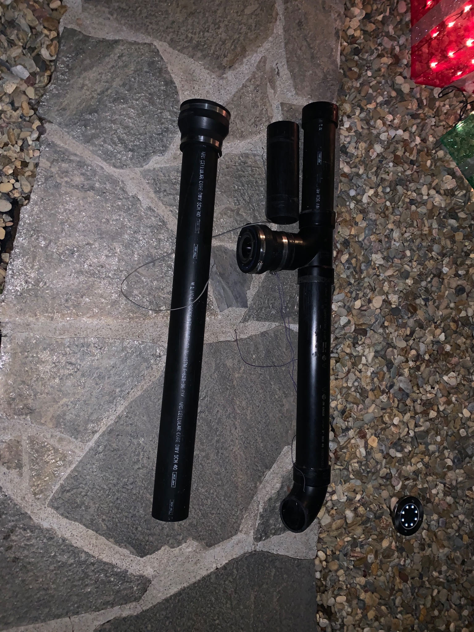

I messed around with it in an effort to find the velocity node for those resonances(and prevent them). I didn’t know if you could also use it to land on a (specific) pressure node and further excite them? I should mess around with thus more

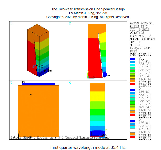

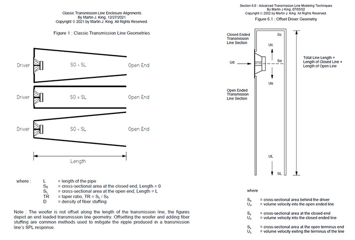

OK Mark. What I had read preliminary, in Martin J. King's papers, which summarize the determination of the line in outline, is that the entire length was considered. Of course, the confusion lies with the folded line versus the driver's position, which subdivides the direction, affecting "displacement, velocity, and acceleration" (I suppose).
I drew the enclosure with the line without considering the chamber used as a filter, which greatly affects the length of the line. Could you comment? Thanks in advance.
It actually IS treated as part of the horn in an Offset-Driver Model in Hornresp. My BOXPLAN sims treat it the same way as well, and the measured results of my builds are a good match for the sims. Almost every build I've done is based on an offset-driver Hornresp model.
B.

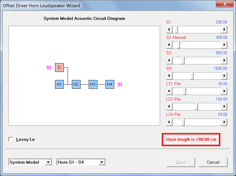

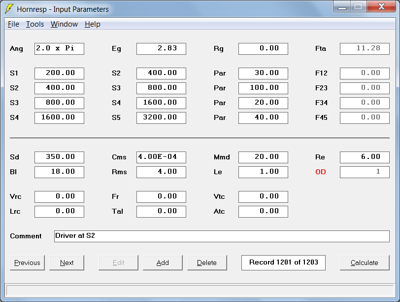

It shouldn't change anything because it doesn't apply to your model. By indicating S2 as the location of the driver, what you are modeling is an OFFSET-DRIVER design, and in such a design the path DOES start at S1!

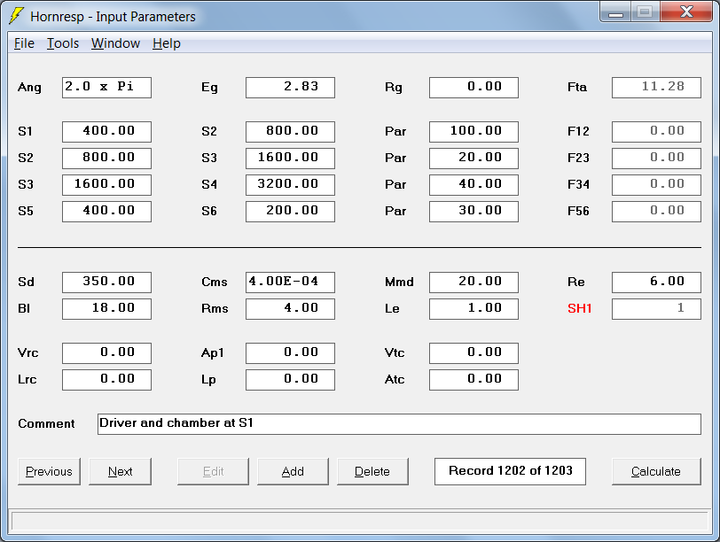

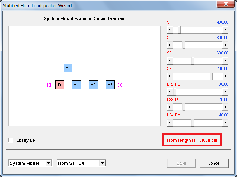

If instead you were modeling this as if S1 was the location of the driver, then yes, that space below the driver should be considered as a chamber in Hornresp, but as Hornresp does not provide a means of modeling that chamber as tapered, so don't do that, LOL.
I missed that detail Brian! Perfect. So the sims are correct. The absorption advice still applies. So does the chamber characterization. So many things with Hornresp are out of my normal usage. I need to pay better attention to the posts!

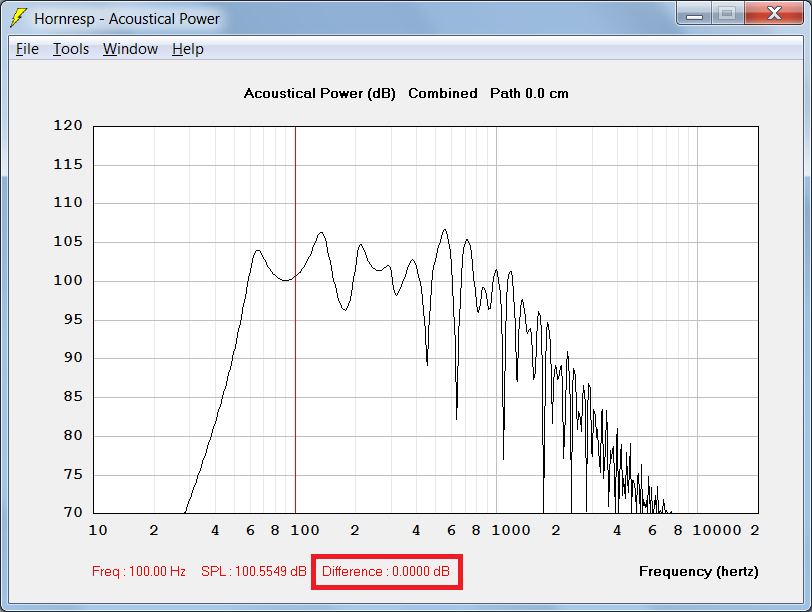

It can be modelled using the SH1 loudspeaker configuration option. The results for the following two systems are identical.
OD:
SH1:
COMPARISON:
