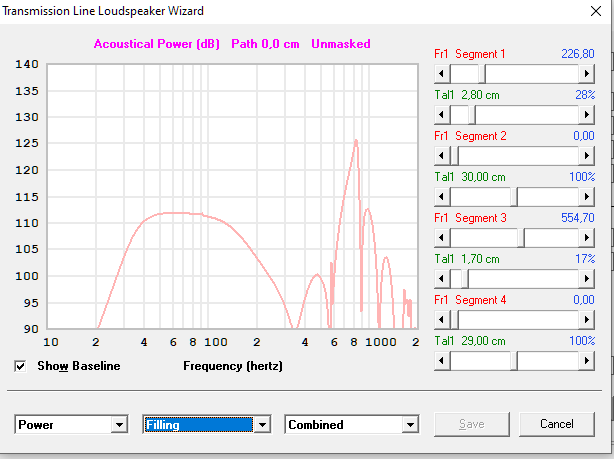

I just upgraded to the latest version (5310-210814) and opening the saved project shows different response than some older versions that I tried (5230, 5210 and 5220).
Screenshots:
Response on old versions:
Response on new version:
On new version i can get quite close to the response on old ones if I remove the filling from the first segment (i have it set at 20%).
BR,
Dudo

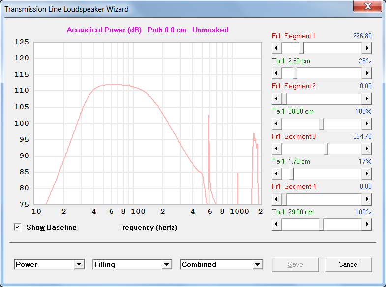

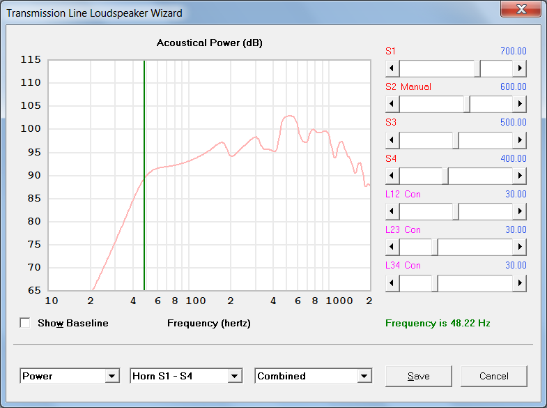

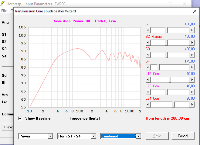

Thanks for the feedback, this is very strange indeed. Using the Internet Archive: Wayback Machine I was able to download a copy of Hornresp Version 40.20. Attachment 1 shows the test example I tried (with Fr1 = 100 and Tal1 = 100% for each segment).
Attachment 2 shows the power response with filling included, calculated using Version 40.20. Attachment 3 shows the power response with filling included, calculated using the latest Version 53.10. As you can see, for my test example, the results are identical for the two versions.
I am not aware of any changes made to the program between Versions 40.20 and 53.10 that could explain the differences you are seeing. Would it be possible for you to post an exported copy of your record? I can then import it into my two different versions of Hornresp, and see if I have the same problem as you.

Here's the export.
Many thanks Dudo - I now get the same results as you.
The difference occurs when the Tal1 slider for segment 1 has a value other than 0% or 100%. I have had a quick look at the code but it is not immediately obvious to me what is causing the problem. Unfortunately I do not have the source code for earlier versions to check back against, so I am not sure at this stage how long it will take me to track down the reason for the difference.

It would not have helped much in this instance though because it was really the old source code that I required to make the debugging task easier, not the compiled executable program. The good news is that I have managed to track down the cause of the problem without having to see the earlier code. I made some changes a while ago to simplify some of the internal operations - unfortunately it seems that I simplified them too much... 🙂.
The problem will be fixed in the next update.

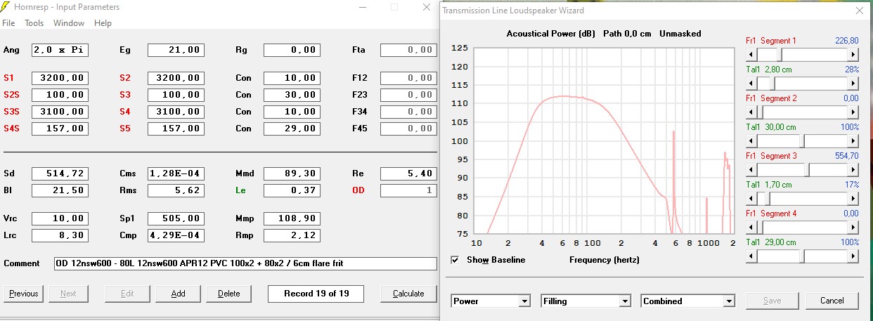

I have found the same Stuffing issue as Cro maniac in my own sims. I Have 51.1 release on one computer, and last one on another. Here files. Filling % in segment 1 is easy to see not working as expected in last release (first picture), compared to hornresp 51.1. Stuffing adding resonnance is weird. Can you investigate ?
Thanks a lot,

The bug reported in Posts #12341 and #12353 has now been fixed. My thanks to Dudo and Damien for their valuable feedback.

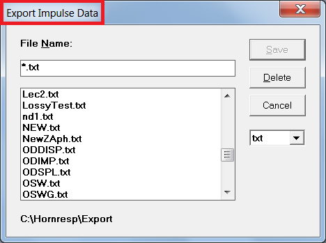

The file export form was being displayed with the caption "Export Impulse Data" regardless of the data being exported. The bug was introduced with Version 52.40 when it became possible to export the impulse response as a 32-bit file with either a peak or rms dB offset. This problem has now been fixed.

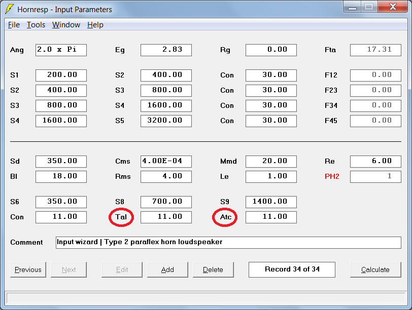

When paraflex horn records were created using the Input Wizard, segment 6 and 7 flare rates were not being specified for PH2, PH3 or PH4 systems (see Attachment 1). This bug has now been fixed.

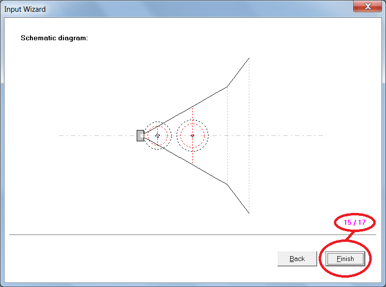

Input Wizard page numbering was not correct for compound and multiple entry horns (see Attachment 2). The problem was introduced when the paraflex horn option was added to the Input Wizard. This bug has now been fixed.
