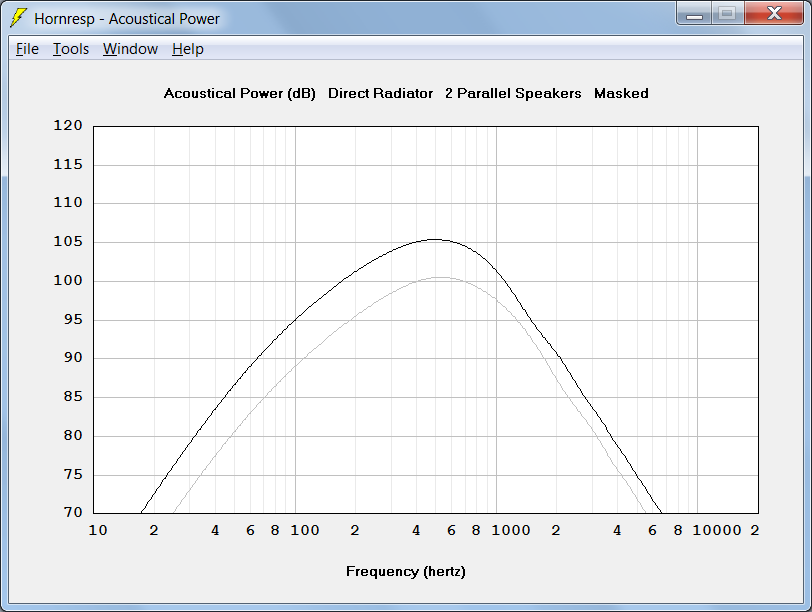

I have now tried a simple closed-box direct radiating system, and get quite different outcomes.
I checked the code and couldn't find any obvious errors so I ran my closed-box test example again, and it worked perfectly this time! I have no idea why it did not work correctly on the first occasion. The attachment compares a single speaker (grey trace) to 2 speakers connected in parallel (black trace).
The 6 dB increase at low frequencies and 3 dB increase at high frequencies as shown in the attachment, is what I would expect to see theoretically.
For two speakers connected in series I would expect no difference at low frequencies and a 3 dB reduction at high frequencies.

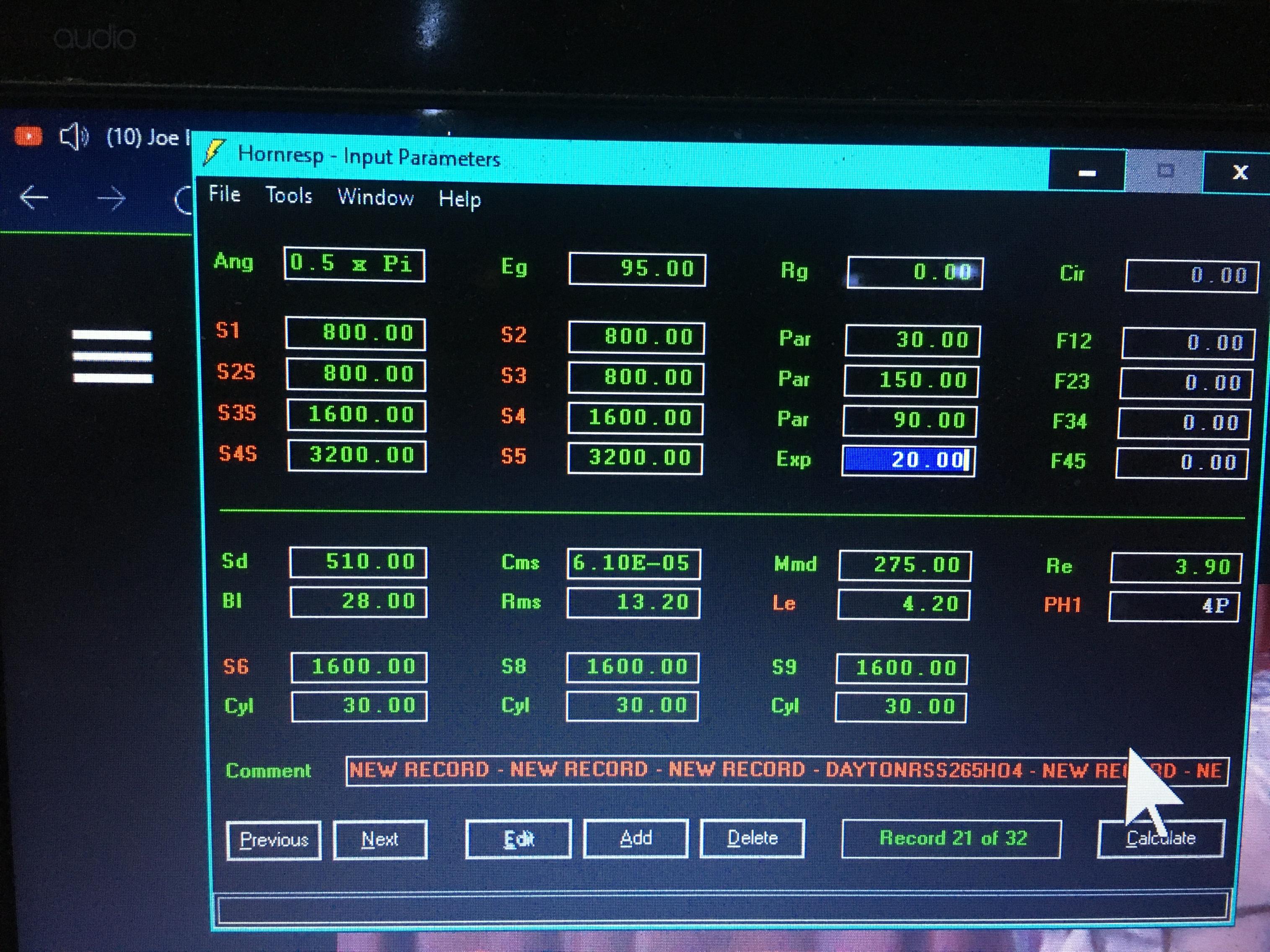

here's what i mean on the bottom(sorry it tilted my pic). long skinny throat chamber at 1.6 liters ?
(this is 5210-210410)

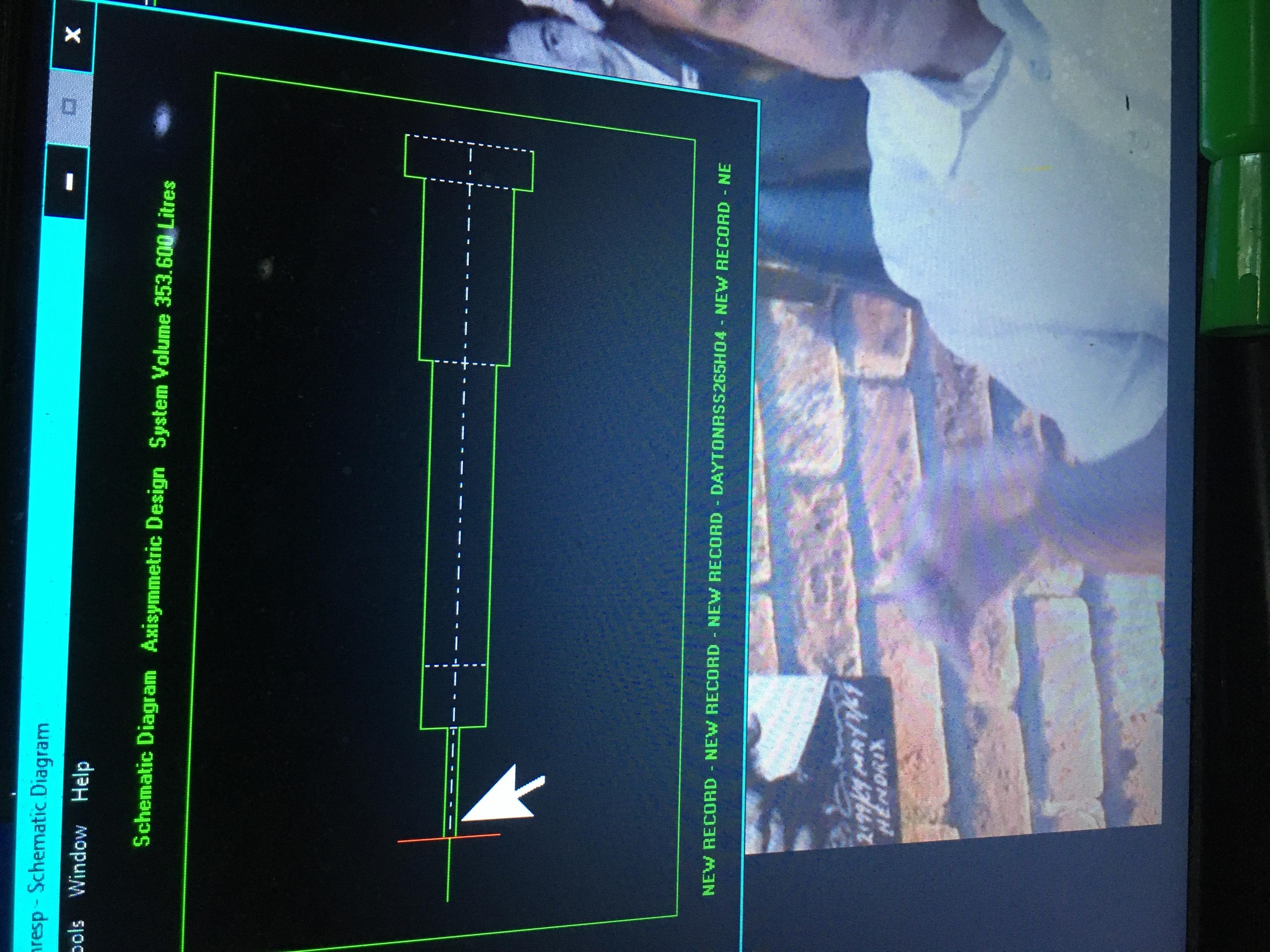

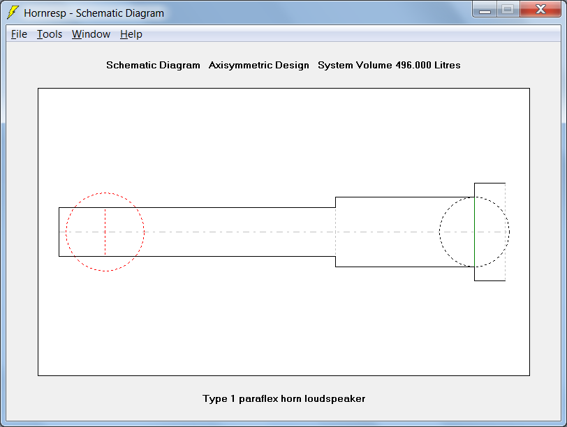

Hi Bw,
I get the result shown in the attachment. Please try updating to the latest release (5310-210718), and let me know if there is still a problem after doing so.

what's this (alt s) in schematic depicting ? i can't say i ever noticed ? thus is ph1 mode
