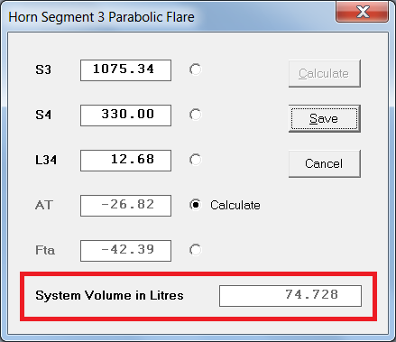

BUG FIX 1
In some cases the system volume value shown in the Horn Segment Wizard was not correct. This bug has now been fixed.

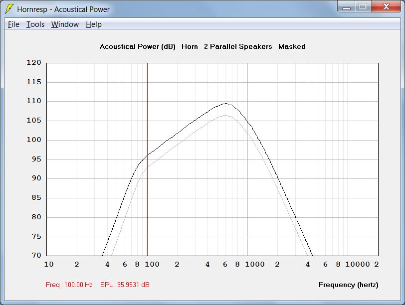

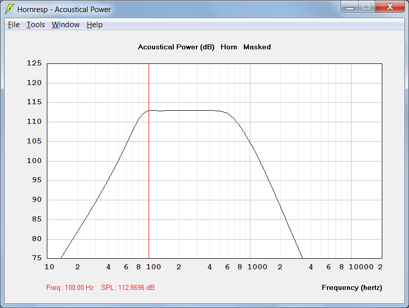

It appears that when using multiple speakers, but then changing the filter wizard settings the program still shows lets say 2 parallel speakers but the graph only shows the response for one speaker. You can set the filter parameters first and then click multiple speakers but the filter wizard doesn't reflect the multiple speaker arrangement if you go back to tweak something, at which point you also need to re-enter the number of speakers you're using.
Hi Kapha Sound,
Thanks for the feedback.
Using the default record, everything seems to be working fine for me.

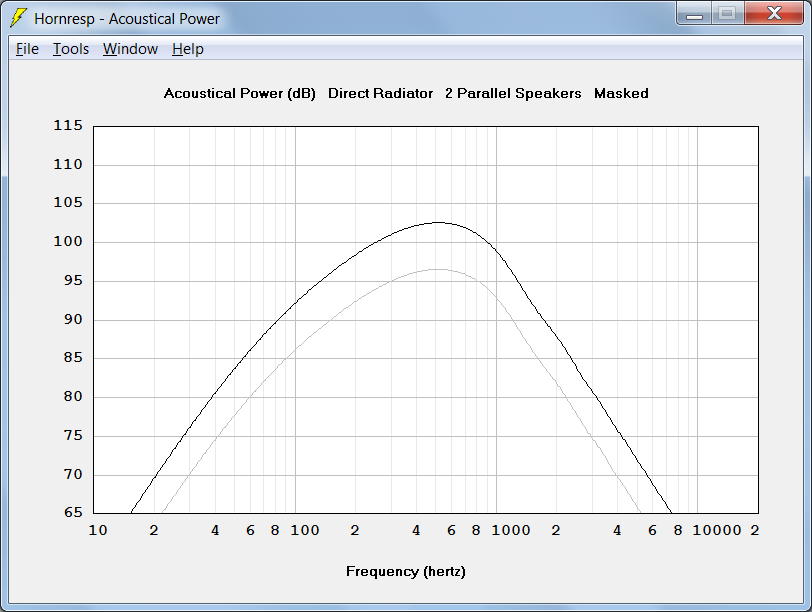

Attachment 1 - Default record power response with resonances masked.
Attachment 2 - Attachment 1 response with 2 parallel speakers.

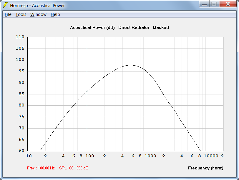

Attachment 3 - Attachment 2 response with 1000Hz high pass filter.

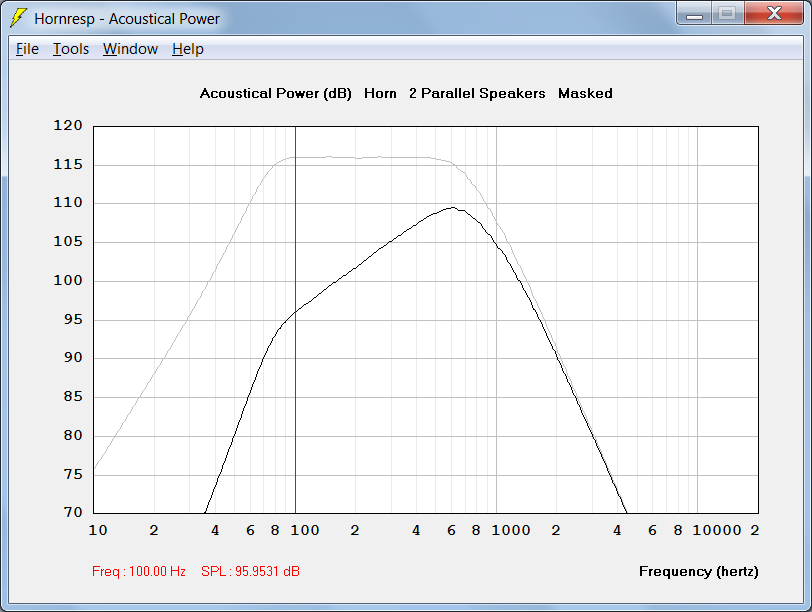

Attachment 4 - Default record power response with resonances masked.

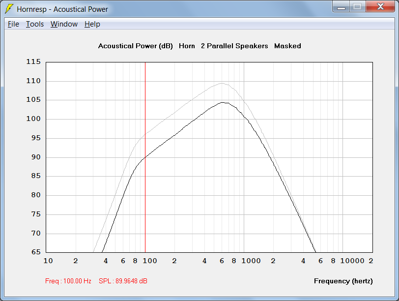

Attachment 5 - Attachment 4 response with 1000Hz high pass filter.

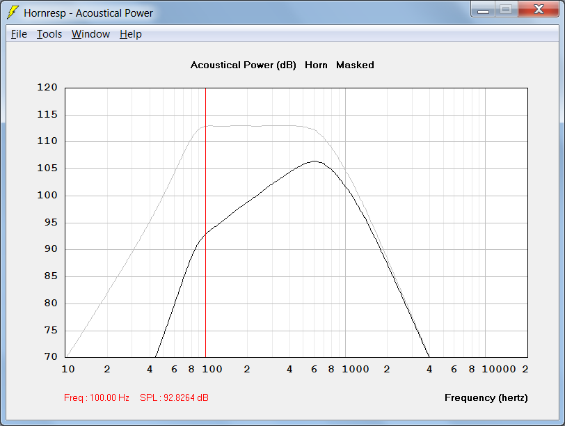

Attachment 6 - Attachment 5 response with 2 parallel speakers.
Attachment 7 - Attachment 6 response after filter reopened and tweaked to 2000Hz high pass.
The grey trace shows the previous result so that response changes are easy to see.
The Attachment 3 and Attachment 6 results are identical, as expected.
Are you getting something different to this?

Hi David,
Interesting I managed to get it to happen again by changing the power and then the filter one way then back to the initial settings.
Inputs:
Unfiltered Single Cab:
Filtered Single Cab:
2 Parallel Speakers Filtered:
2 Parallel Speakers after changing power then multiple speakers then filter settings (voltage hardly changed, you can see it's showing the response as if it's one cab but the title is 2 parallel speakers):
Re entering 2 parallel speakers without changing anything else brings us back to what we'd expect:
Hope that makes sense!

Hi Kapha Sound,
It does indeed make sense. I need to investigate further to try to find out what is going on here. Many thanks for the very valuable additional feedback!
Kind regards,
David
I have managed to track down the problem. It was not easy to locate - it was another one caused by the bug in Visual Basic I mentioned in Post #12308. I have come up with a further workaround which hopefully will fix things once and for all. It will be in the next update.

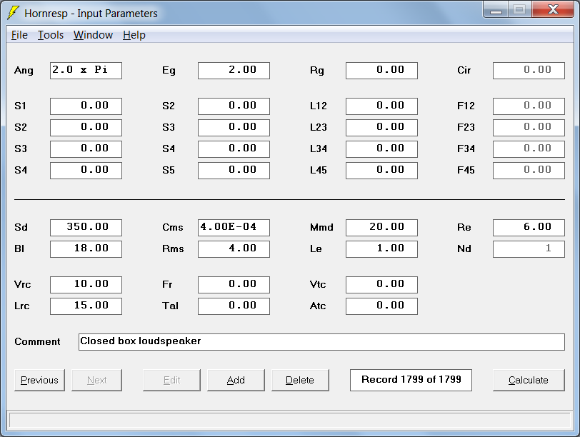

Multiple Speaker / Multiple Driver Sanity Checks
To confirm that the multiple speaker and multiple driver tools were working correctly I checked to ensure that the following systems produced identical power response results:
1. Closed box with single driver radiating into 2 Pi space with Eg = 2 volts and Vrc = 10 litres.
2. Closed box with two drivers connected in parallel radiating into 4 Pi space with Eg = 2 volts and Vrc = 20 litres.
3. Closed box with two drivers connected in series radiating into 4 Pi space with Eg = 4 volts and Vrc = 20 litres.
4. Two single-driver closed boxes connected in parallel radiating into 4 Pi space with Eg = 2 volts and Vrc = 10 litres.
5. Two single-driver closed boxes connected in series radiating into 4 Pi space with Eg = 4 volts and Vrc = 10 litres.
I then confirmed that the response of two single-driver closed boxes connected in parallel was 6 dB greater than that of two single-driver closed boxes connected in series (Attachment 3).
Reason for 6 dB difference:
If the amplifier output voltage Eg is 4 volts and the loudspeaker electrical input impedance is 8 ohms:
For two boxes connected in parallel, the power delivered to each box is:
P = V ^ 2 / R = 4 ^ 2 / 8 = 2 watts or 4 watts into the two-speaker array
For two boxes connected in series, the power delivered to each box is:
P = V ^ 2 / R = 2 ^ 2 / 8 = 0.5 watts or 1 watt into the two-speaker array
Difference in power response levels = 10 * Log10(4 / 1) = 6 dB
