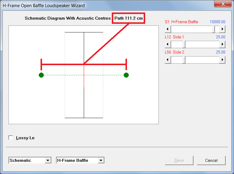

Almost certainly they were sitting in front of the speaker. They would of course also be hearing the reflections off of the back wall a few feet behind the speakers. I assumed that the loudspeaker wizard is showing on axis. But I guess come to think of it the HR results must be essentially an anechoic response. Apparently the in room reflections are a major part of what people actually hear. Is there a user settable path length for the combined response?
Not for H-frame or U-frame type loudspeakers. The acoustic path length is calculated automatically, and is the length of the shortest acoustic path between the two acoustic centres of the dipole system. The acoustic centres are assumed to be point sources.
Post #10453 linked below, and subsequent posts #10455 and #10456 provide further relevant information.
https://www.diyaudio.com/forums/subwoofers/119854-hornresp-1046.html#post6069923

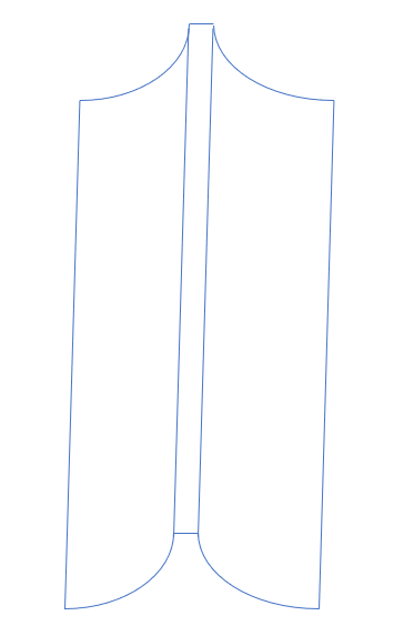

Help needed for modeling weird horn/planar speaker/linesource
I had the weird idea if a combination of horn and planar would be possible.
It would be full floor to ceiling planar linesource of lets say 7-10cm wide used as a driver for this kind of horn:
attachment.php
No idea how to start simulating this.
Key thing I want to know how low this combination would go given that such a linesource implemented as for instance a electrostatic dipole would no go lower than roughly 300Hz.

Can't do this in Hornresp. You can only do round horns.
