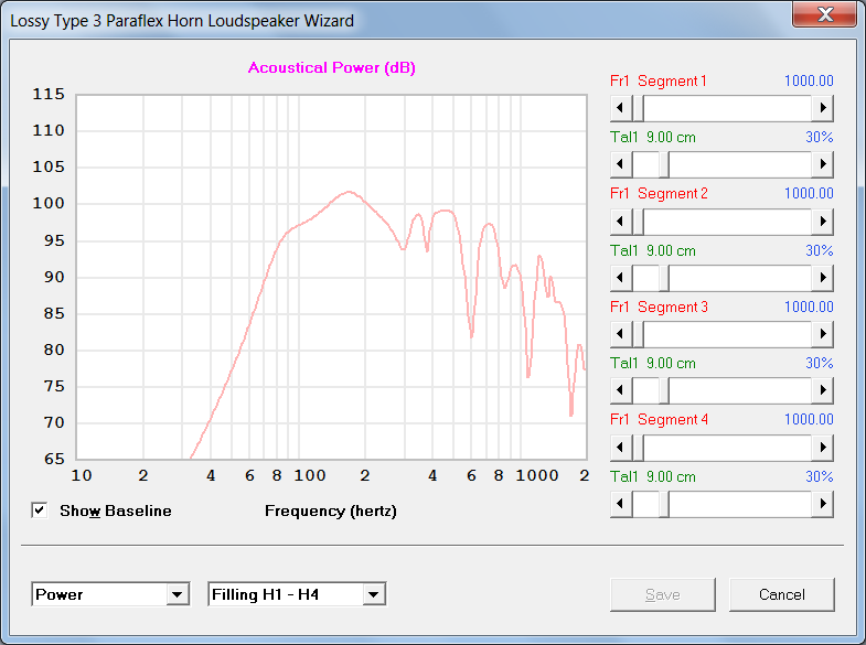

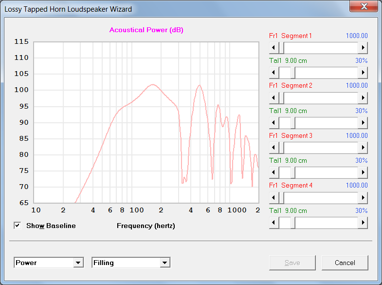

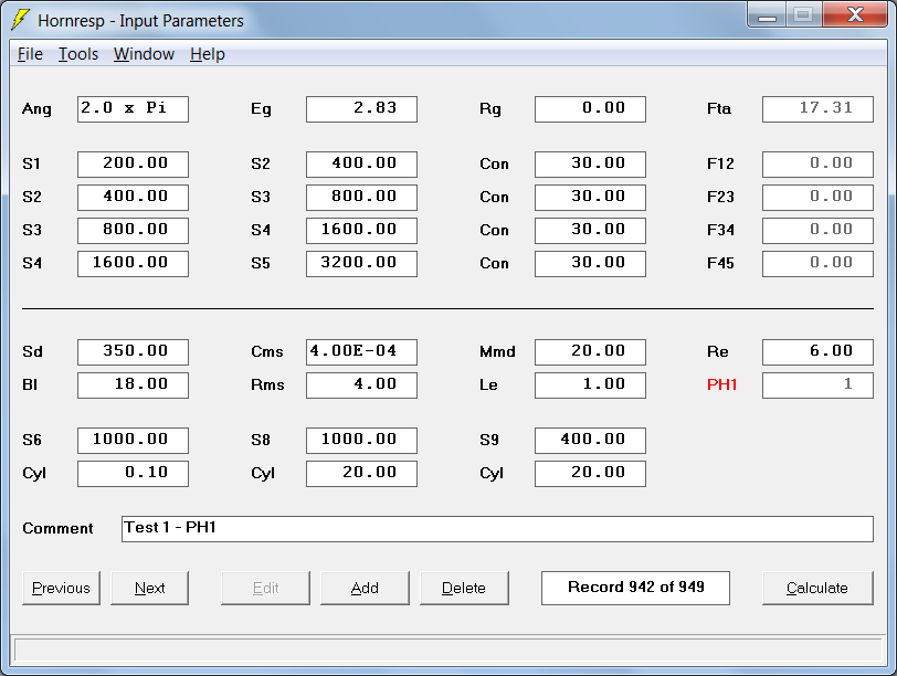

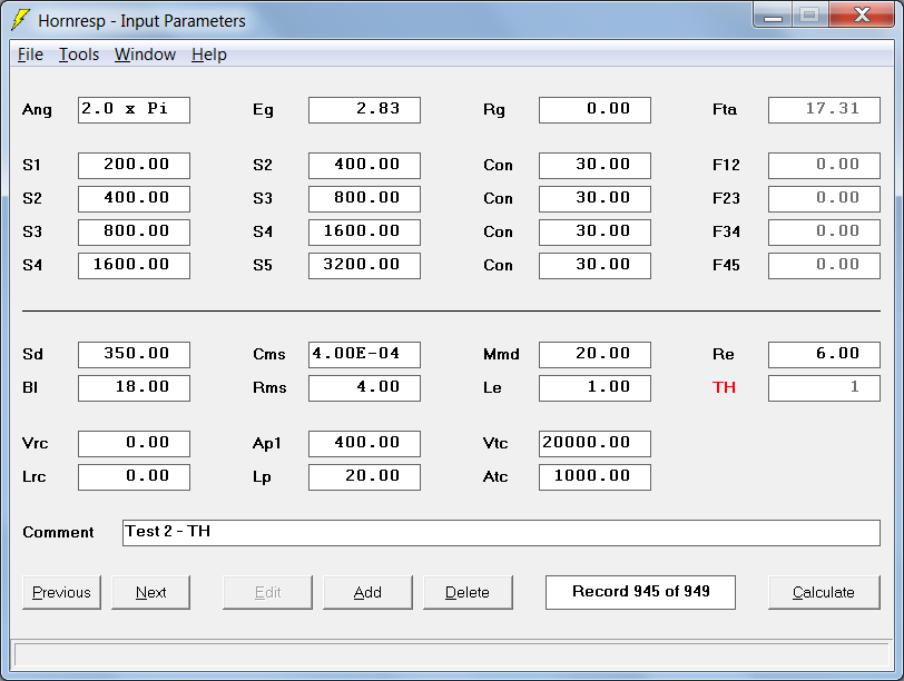

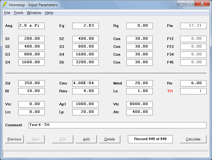

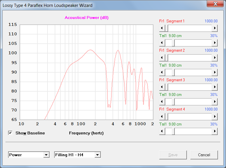

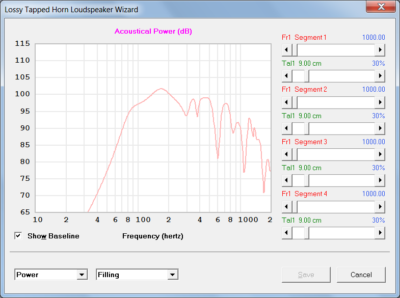

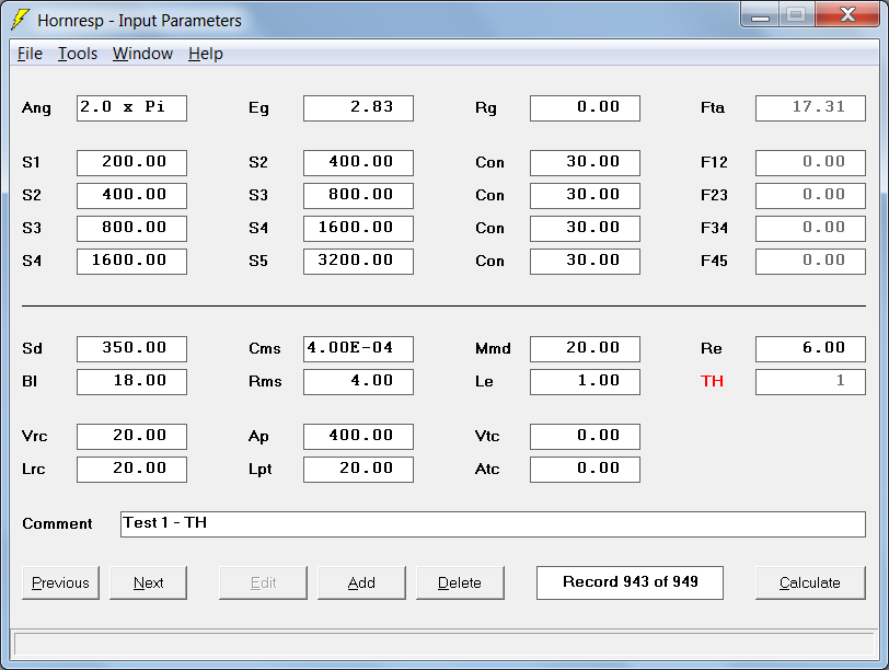

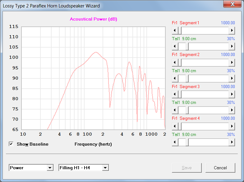

PH1 Paraflex Horn Model Validation
The results for a PH1 horn and its TH equivalent are effectively identical, confirming that the PH1 model is working correctly.

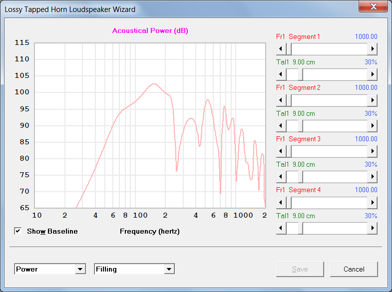

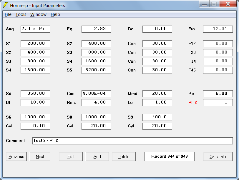

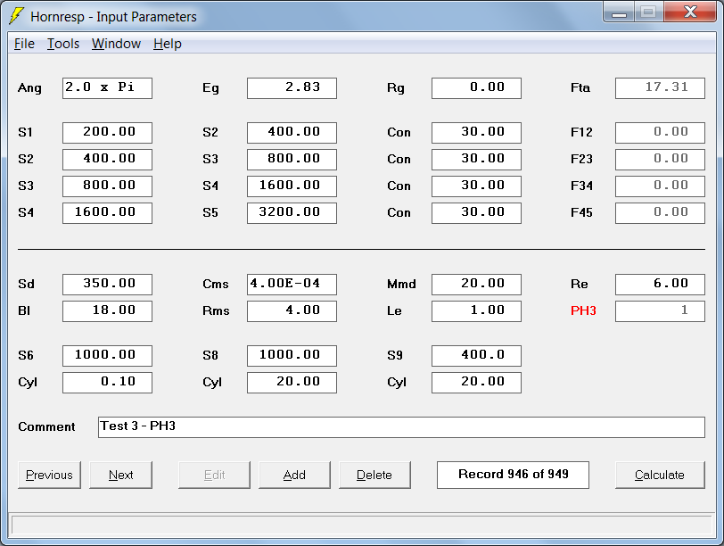

PH2 Paraflex Horn Model Validation
The results for a PH2 horn and its TH equivalent are effectively identical, confirming that the PH2 model is working correctly.

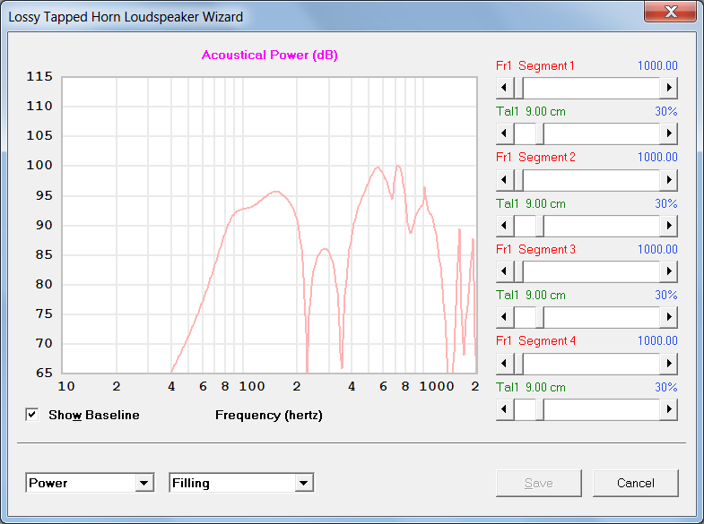

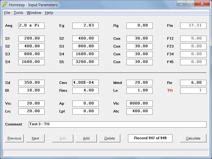

PH3 Paraflex Horn Model Validation
The results for a PH3 horn and its TH equivalent are effectively identical, confirming that the PH3 model is working correctly.

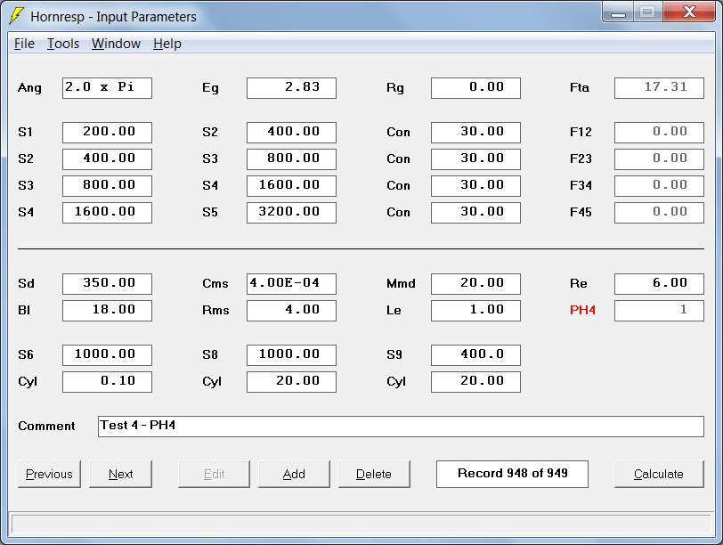

PH4 Paraflex Horn Model Validation
The results for a PH4 horn and its TH equivalent are effectively identical, confirming that the PH4 model is working correctly.

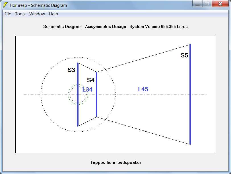

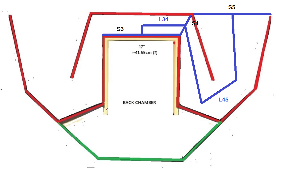

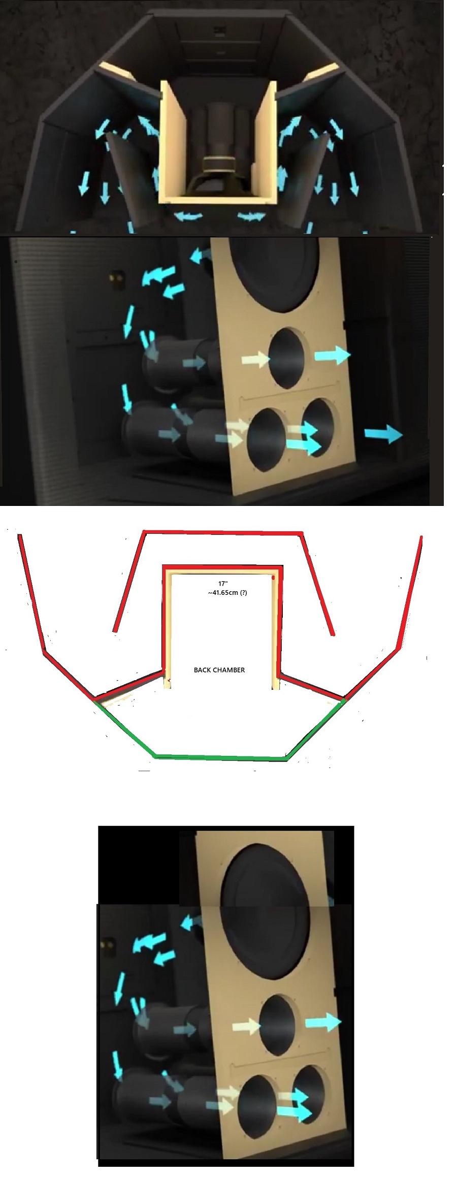

How should this arrangement's throat be specified for a throat vented horn?
Hi David
is the case of the new Klipsch Jubilee, there's a baffle board with 15 inch woofer and 3 duct ports "below" that woofer that fire into a flat panel then the expansion starts.
Knowing driver area, port area, baffle height, baffle width, and cross sectional details for the front horn, what area figure does one use for the throat?

Hi Freddy,
Having only segments 3 and 4 to play with, probably the best that you could do would be to set:
S3 (throat area) = mounting baffle height * mounting baffle width
S4 = 2 * angled width across duct at first bend * mounting baffle height
S5 = 2 * duct width at mouth * mounting baffle height
L34 = best estimate of axial length from S3 to S4
L45 = best estimate of axial length from S4 to S5
The horn would then have the general form shown in Attachment 2 (not to scale).
Kind regards,
David
