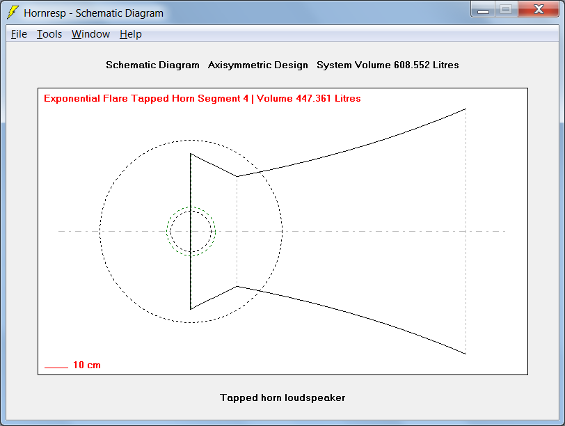

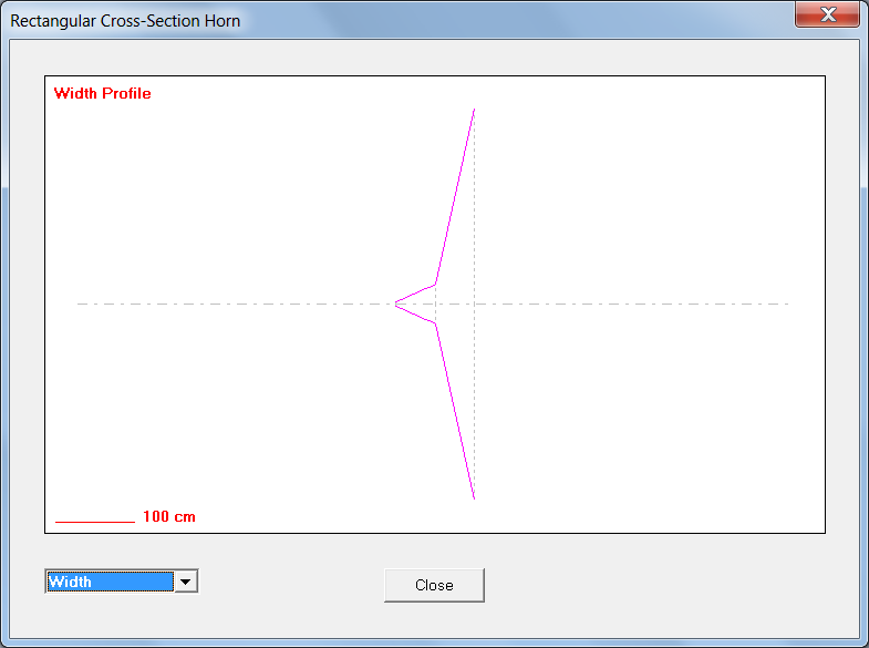

Looks like all the segments should be parabolic.
Because segments 1 and 2 have been specified as very short cylinders, the flares chosen for those segments have no meaning, and are therefore disregarded when calculating the results.
The flare of segment 3 is ill-defined, it is neither one thing or the other. Take your pick - your guess is as good as mine 🙂.
Because only segment 4 is available to specify the remainder of the system, it needs to be exponential to reflect the overall cross-sectional area expansion rate of the horn.
However:
If three segments were available to specify the remainder of the system, then strictly speaking the first and third segments as shown in Attachment 1 should be parabolic. The flare of the middle segment shown in Attachment 1 is ill-defined (similar to segment 3 mentioned above).
Even if parabolic segments were used, the overall flare expansion rate would remain effectively exponential, as can be seen by comparing the profiles of Attachments 2 and 3.

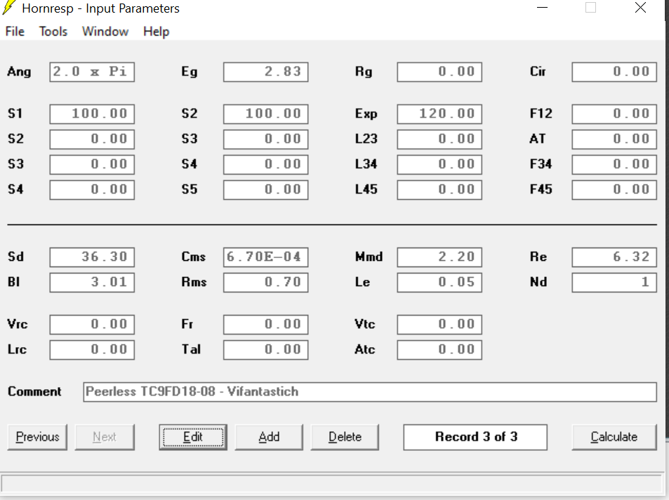

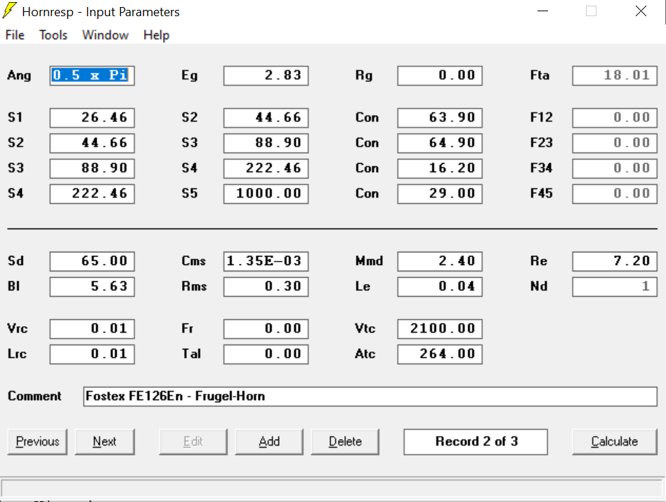

Hello,
I apologize for the very basic questions, hopefully they can be answered quickly (I honestly cannot read 1300 pages before I post, I did read a good bunch of the wiki and the hornresp help).
I am trying to model some simple (Vifantastich (see post #155) with TC9FD18) and not so simple (FrugelHorn with FE126En).
I take the driver parameters from loudspeakerdatabase.com, which may be a first isue as I don't have the same parameters as the references on the respective threads.
Also there must be other significant errors in my sims, because the results are way off (so much I don't dare to post them) :
Would someone be so kind to post the correct input parameters for either or both loudspeakers ?
Thanks lots in advance
However:

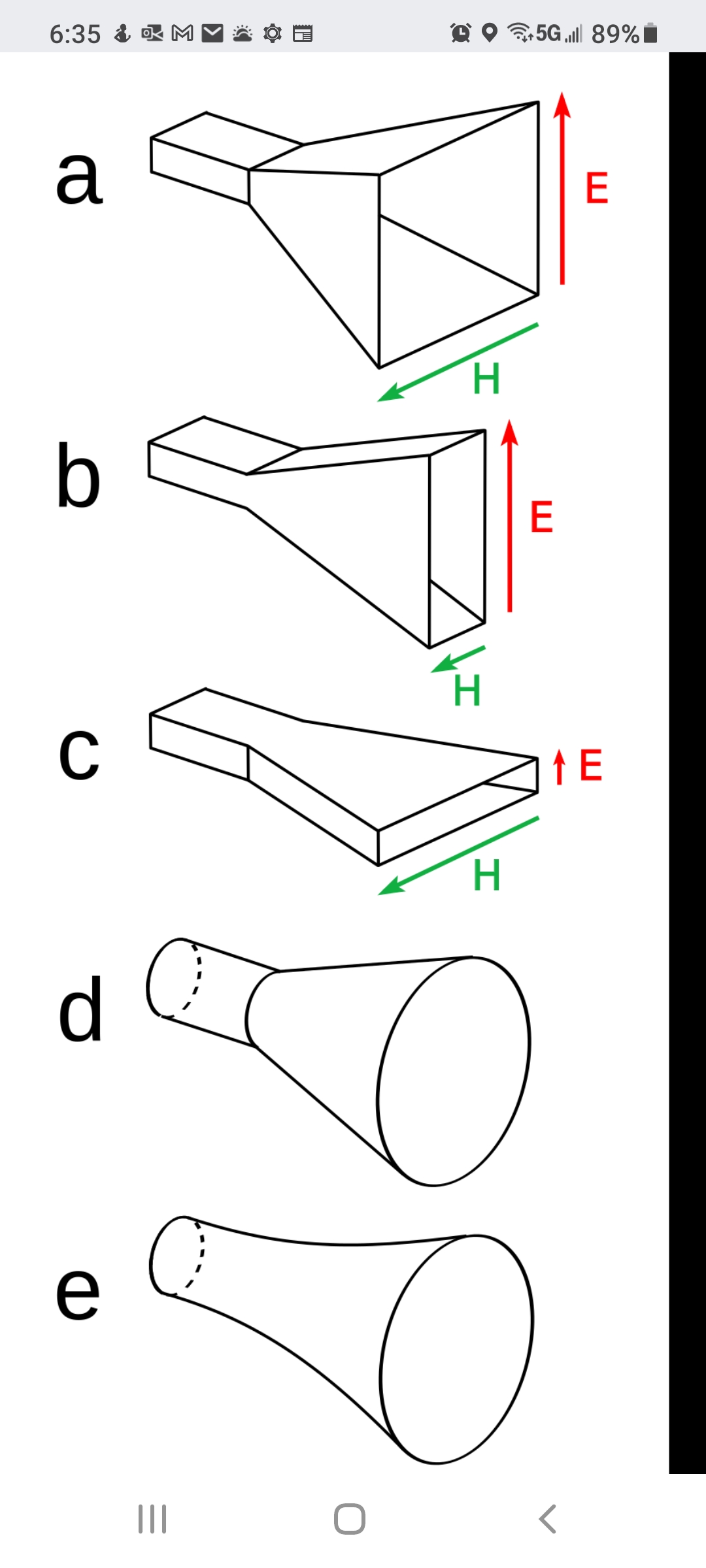

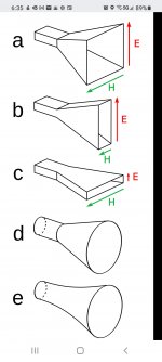

If there are parallel walls (top & bottom or left & right
panels) from the throat to the mouth of a horn, then all the segments are parabolic.

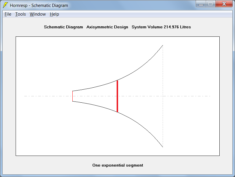

If a segment has two parallel walls and two straight tapered walls then the flare profile for that segment will be parabolic. However, as I attempted to explain and demonstrate in my previous message, in the case of Freddy's Jubilee design we have only one segment to specify the main horn, and it needs to be exponential because the taper rate is not constant over the length of that segment. (I have assumed that Klipsch uses an exponential expansion for the Jubilee, the same as for the original Klipschorn).

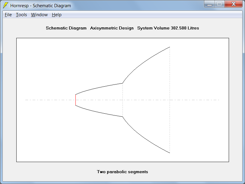

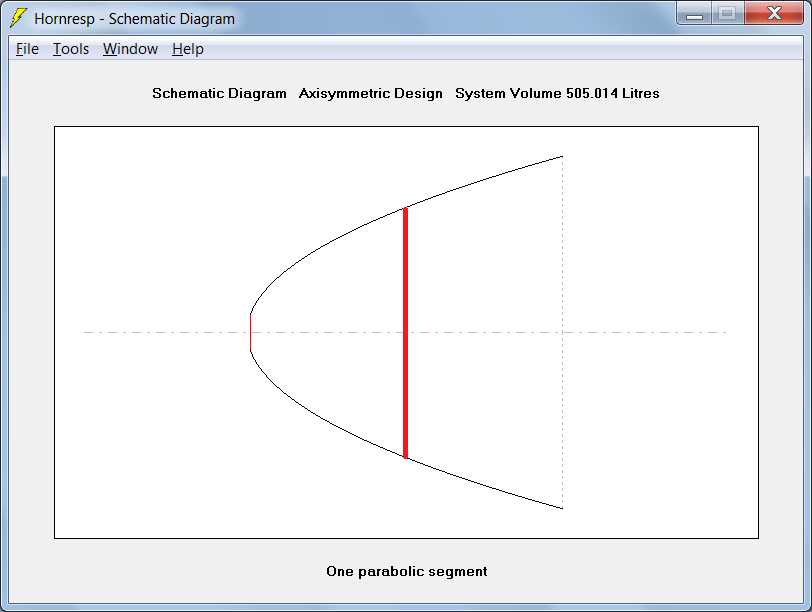

Perhaps the example below will better illustrate the point regarding parabolic horns:
Assume we have a horn made up of two parabolic segments, where
S1 (throat) = 100 cm^2
S2 = 1000 cm^2
S3 (mouth) = 10000 cm^2
L12 (Par) = 50 cm
L23 (Par) = 50 cm
Attachment 1 shows the axisymmetric profile, and Attachment 2 shows the width profile if the horn has a rectangular cross-section with a constant height of 20 cm.

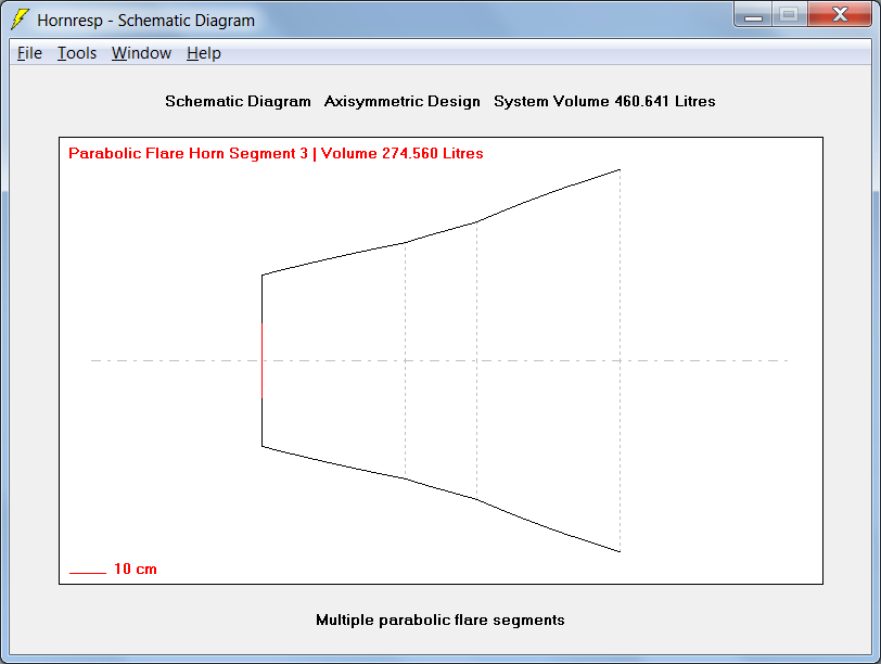

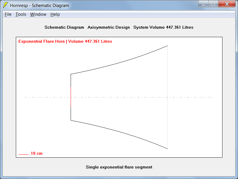

If we have only one segment to specify the horn:
S2 (mouth) = 10000 cm^2
L12 = 100 cm
If the flare for the single segment horn is parabolic, as shown in Attachment 3, then the cross-sectional area halfway along the horn works out to be 5050.27 cm^2, not 1000 cm^2 as it was for the two segment case.
If the flare for the single segment horn is exponential, as shown in Attachment 4, then the cross-sectional area halfway along the horn is 1000 cm^2, the same as it was for the two segment case. This profile is therefore a closer approximation to the overall area expansion rate of the horn, particularly in the critical region near the throat, and is the one that should be used.

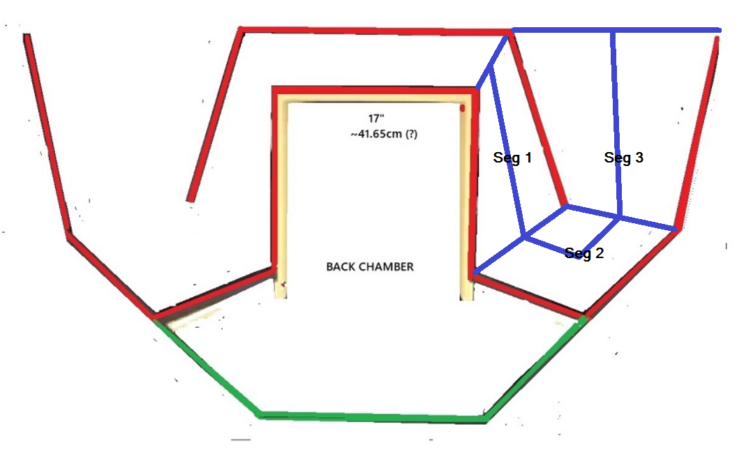

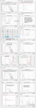

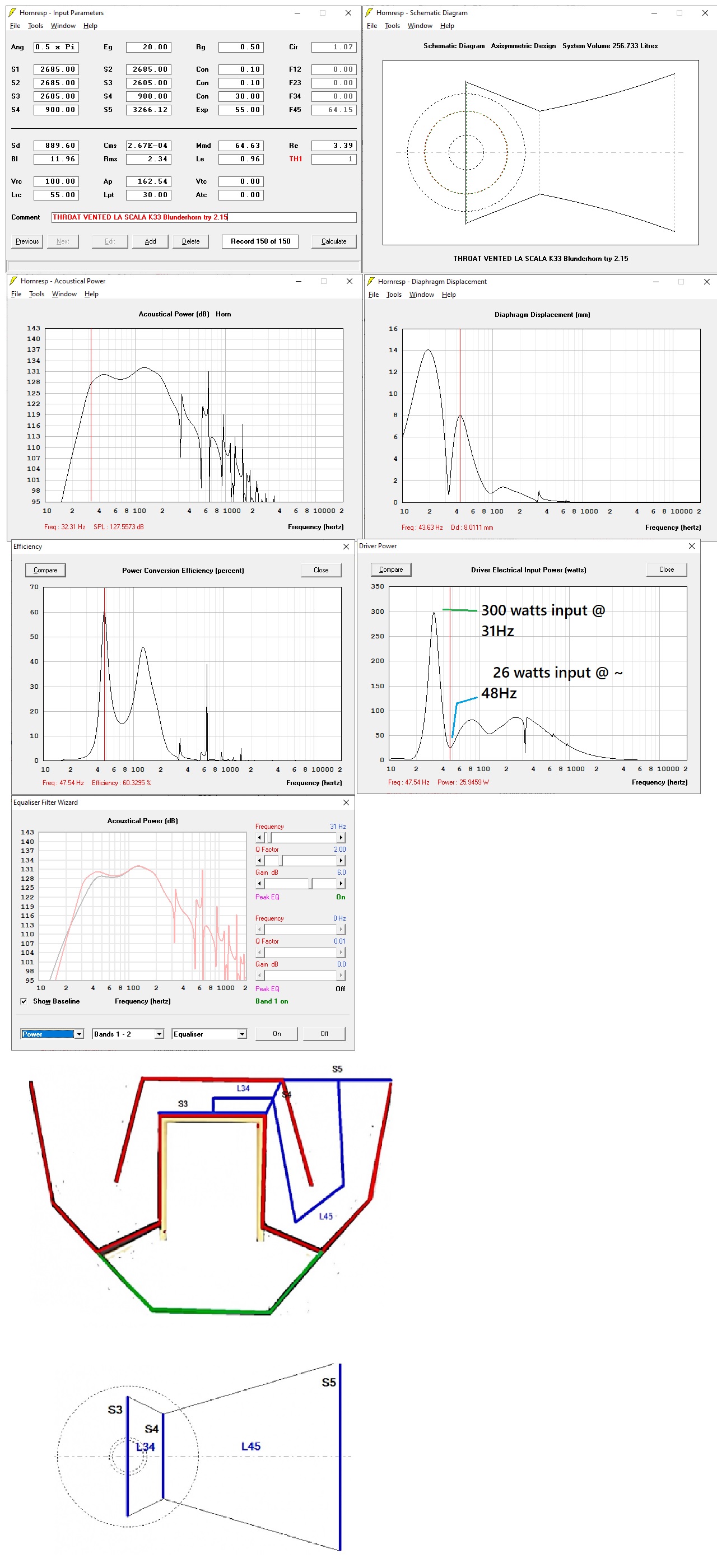

Thanks David - since you say its basically doable -here's some numbers (chamber depth at 100 liters sans driver and ports should be manageable)
With only 93 sq.in. coming into the horn and a 22.5" baffle height. things would be tight (? -like a 5cm spacing from the baffle-throat plate - ??)
What would you suggest to make it "better" without getting out of hand in growth?
making S4 1.5X that of the previous sim seems a step in the right direction with regards making it work (?)
60% efficiency, even of only a narrow band down pretty low, seems good.
Chamber depth with a 22.5" high baffle would be less than 16" with driver and ports displacement. Speaker size would be around 2 foot high by 3 foot wide by 2 feet deep -(IF the horn fits - lol)
I must need new batteries in my calculator - the half-way area figure quoted should have been 5050.00 cm^2 not 5050.27 cm^2 🙂.
Because the cross-sectional area of a parabolic horn expands at a linear rate, at the half-way point it is simply equal to (S1 + S2) / 2. If S1 = 100 and S2 = 10000 then (S1 + S2) / 2 = 5050.

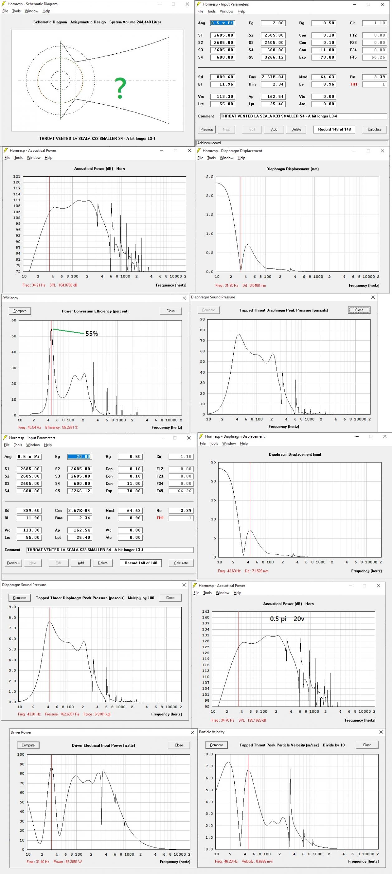

oops - I had L34 less than half the width of the baffle and assume that's impossible (?)
A revised sim with 30cm L34 looks good on the low end but the already limited high end is cut back more
