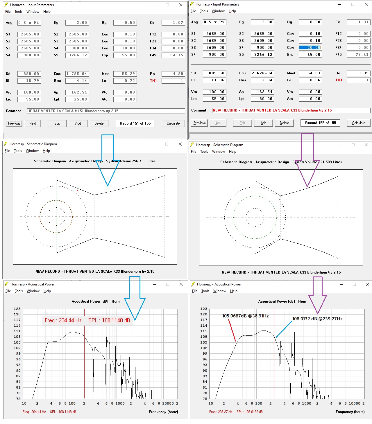

Is the low pass behavior mainly due to the "chamber" formed by chamber depth times the baffle's area?
Not sure. What happens when the sliders specifying the chamber are adjusted in the Loudspeaker Wizard? Could that perhaps give an indication of what low pass effect if any, the chamber is having on the response?
Is it accurate to say one is a parallel vented horn while the other series ?
Again, not really sure. I guess it all depends on what is considered to be connected in parallel, and what is considered to be connected in series. Perhaps someone with more knowledge on such matters would care to comment further.
maybe there isn't a lot of effect ? here's a one example - if not too confusing
Hi Freddy,
It doesn't really surprise me that the effect could be minimal. Firstly, the system does not have a clearly defined throat chamber and secondly, the rear chamber vents into the throat, which presumably could be deleterious to any filtering action.

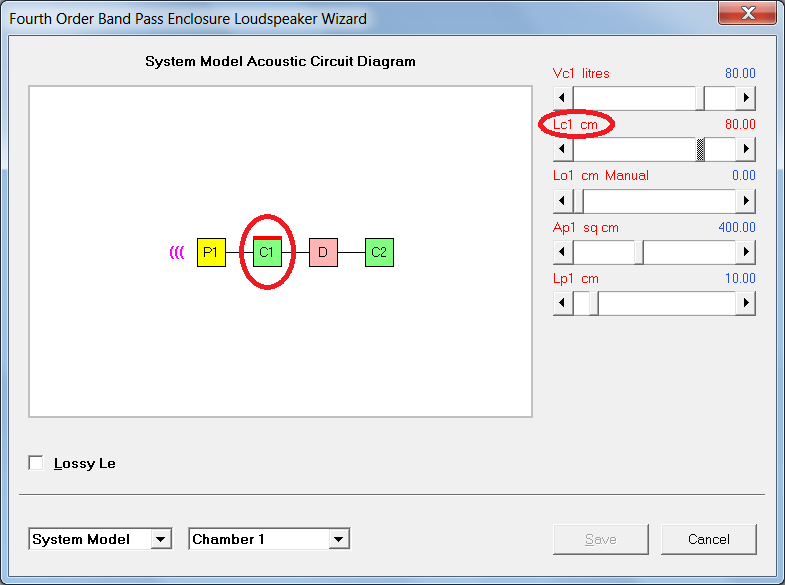

I have been using Hornresp to model a bandpass enclosure. I'm pretty satisfied with the modelling results however have a couple of queries which I cant find the answer to online and would appreciate some quick direction from those more adept.
1. I need to model the sub using two ports due to design constraints but cant do this with hornresp. Is there a quick formula to convert between single port diameter and length to two ports diameter and length to achieve the same bandpass results as modelled in Hornresp?

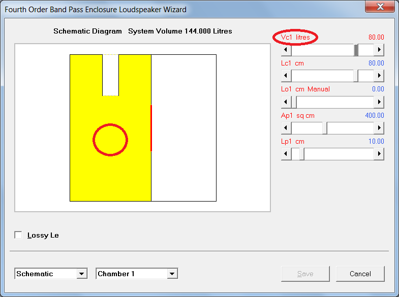

2. Just to confirm VC2 is the sealed chamber volume and LC2 is the height of the chamber. VC1 is the ported chamber and LC1 is the height of the chamber?
3. Is there any value in stuffing the chambers or ports to reduce unwanted resonances? How is this calculated and is the effect of stuffing similar to sealed / other ported subs? Does this help in tuning the box perfectly once the thing is built given how sensitive bandpass subs are to build anomalies affecting performance?
Thanks,
Rob
Hi Rob,
Make the combined cross-sectional areas of the two port tubes equal to the cross-sectional area of the single port tube, with all the tubes having the same length. For example, if the single port tube has a cross-sectional area of 200 sq cm and a length of 25 cm, each of the two port tubes should have a cross-sectional area of 100 sq cm and a length of 25 cm.
Yes. This can be readily checked by clicking on the Vc1, Lc1, Vc2, Lc2 slider controls while viewing either the schematic diagram or system model.

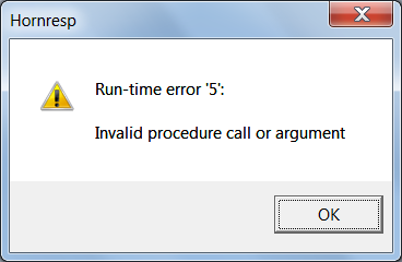

The Loudspeaker Wizard menu command under the Tools menu was being disabled in all cases when a Hornresp record was imported. The menu command is now only disabled when a record that would not normally use the Wizard, is imported.
BUG FIX 2
The fatal run-time error message shown in the attachment was being generated when an attempt was made to export a record not in Edit mode, containing invalid data. This bug has now been fixed.
Kind regards,
David
I have just discovered that fixing the above bug has unfortunately created a new one. While the error message is no longer generated when an existing invalid record is exported, the following sequence of actions still causes the problem to occur:
1. Import a valid record.
2. Make a change to the imported record so that it becomes invalid.
3. Click the Previous button.
4. Save the changes made to the record.
5. Click the Next button.
6. Attempt to export the invalid record.
I will try to release an update tomorrow to hopefully fix the bug once and for all.
