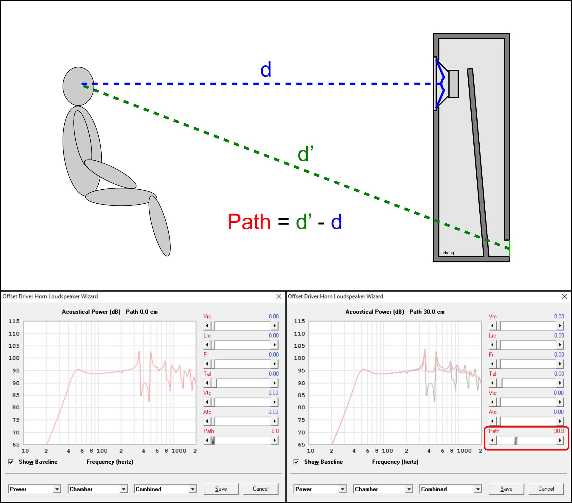

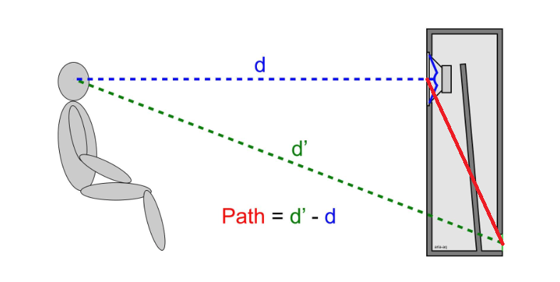

Hello, my first post here..
I want to build TL enclosure with rear opening, driver is Tangband W8-1772, I need to understand about Path length, if:
d = distance from cone to listener
d' = distance from opening to listener
path = d' - d
Am I correct? Thank you..

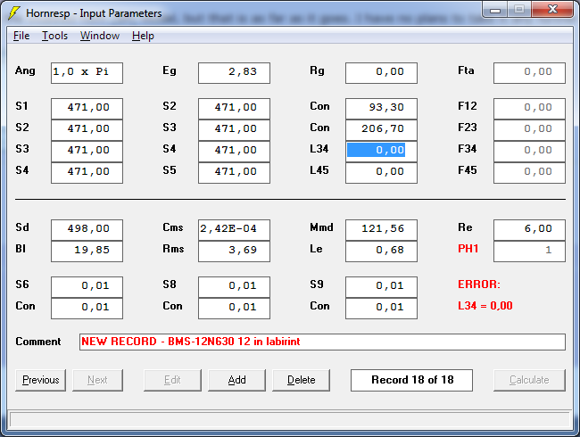

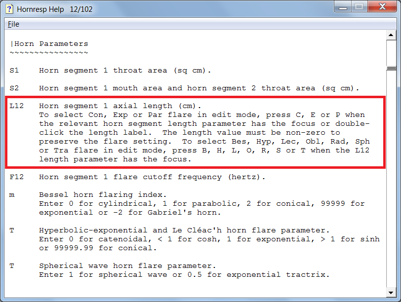

Assuming that you wanted segments 3 and 4 to have conical flares and each be 30 cm long:
1. Highlight the L34 input box, type C30 or 30C, and then press the Enter key.
2. Highlight the L45 input box, type C30 or 30C, and then press the Enter key.
(Type C for conical, E for exponential or P for parabolic).
After entering, the value was reset to 0 again, and so in the loop... However, I typed the number without the C character. 😕

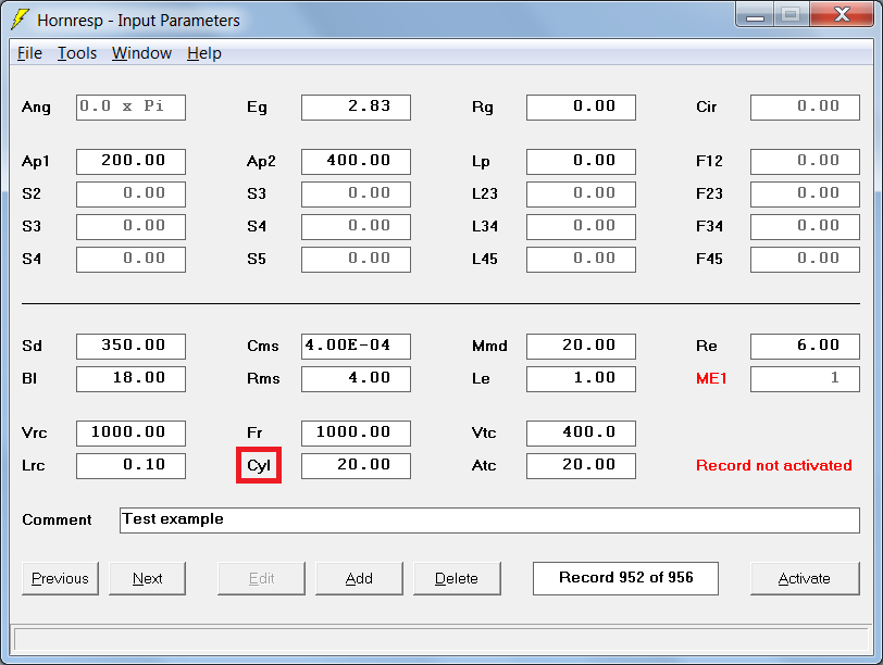

Hi Everyone,
BUG FIX 1
If a PH4 label on the main input parameters window was double-clicked in edit mode to change the loudspeaker type to CH, the old PH4 segment 7 labels were not reset to Vtc and Atc (Attachment 1 refers). This bug has now been fixed.

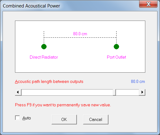

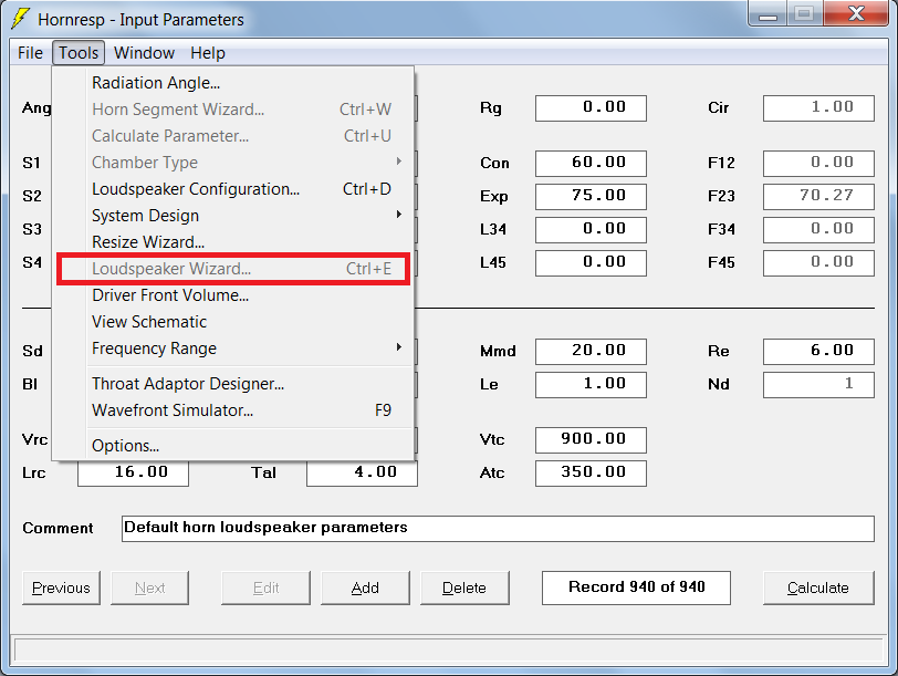

If a change was made in the Loudspeaker Wizard and saved back to the main input parameters window, and the schematic diagram then displayed followed by opening and cancelling the Loudspeaker Configuration tool, the Loudspeaker Wizard menu was no longer enabled (Attachment 2 refers). This bug has now been fixed.

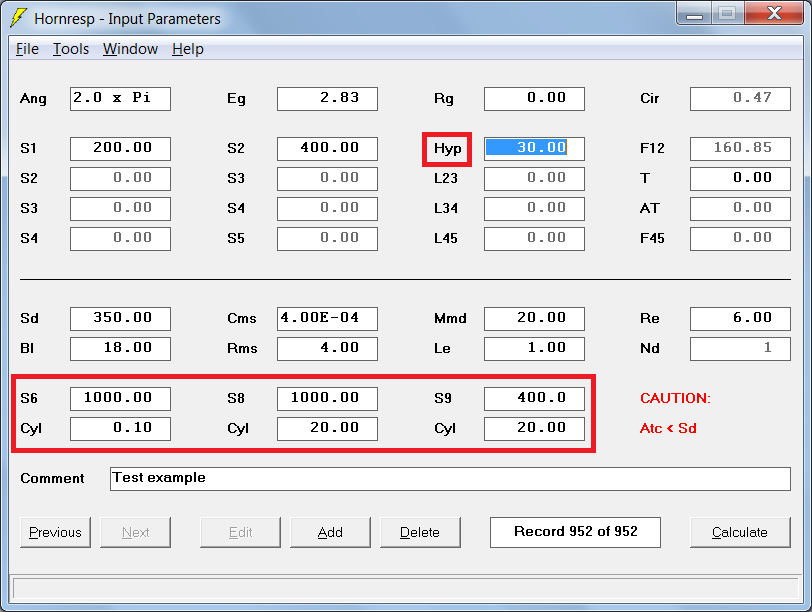

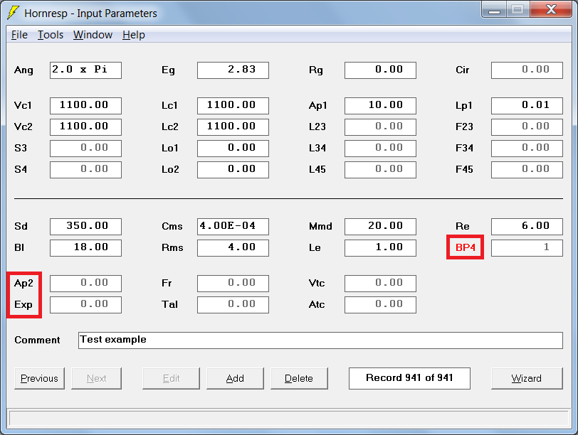

If a paraflex horn was specified and then changed to a hyperbolic-exponential horn (for example) by pressing the H key with the segment 1 length input box highlighted, segments 5, 6 and 7 were still shown (Attachment 4 refers). This bug has now been fixed.

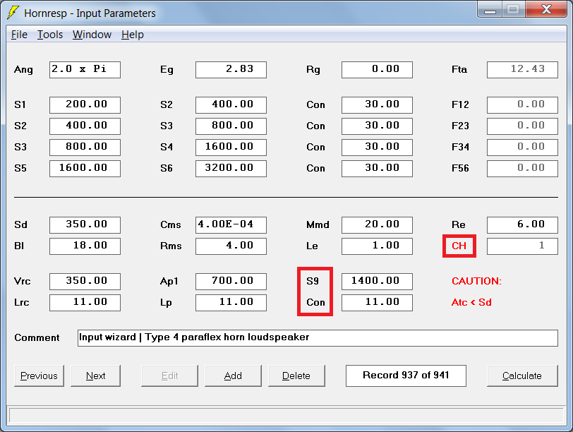

If a PH4 label on the main input parameters window was Ctrl double-clicked in edit mode to change the loudspeaker type to ME1, and the change then undone and redone using the File > Undo and File > Redo menu commands, the PH4 segment 6 flare was shown, rather than the Tal label (Attachment 5 refers). This bug has now been fixed.

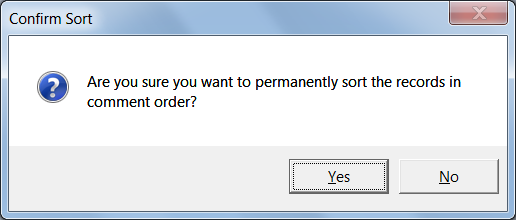

1) Sort - pretty sure records get sorted no matter what once Sort is selected (or maybe also when "No" is chosen at confirmation?).
The Sort tool is working correctly for me - the records are only being sorted when the Yes button is clicked. The No button simply closes the Confirm Sort form.

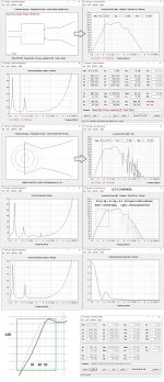

FWIW here's a rough comparison of a vented "Belle" to a throat ported horn, each with a 100 liter back chamber, K33 spec and similar tuning. (no EQ or HPF)
Is the low pass behavior mainly due to the "chamber" formed by chamber depth times the baffle's area?
Is it accurate to say one is a parallel vented horn while the other series ?

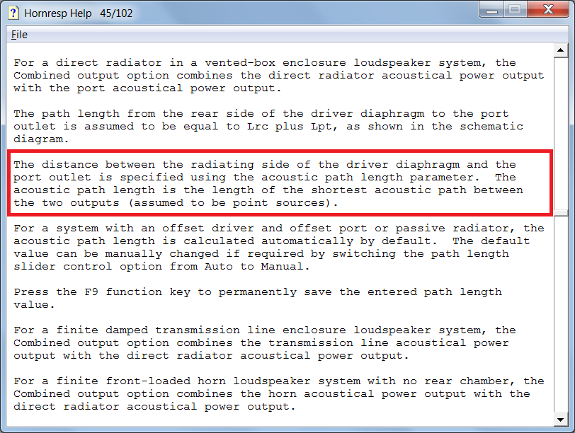

In my case,
When the Input Parameters form has the focus, pressing Alt+F opens the File menu and pressing F again opens the Find record form.
When the Hornresp Help form has the focus, pressing Alt+F opens the Help File menu and pressing F again opens the Find search form.
