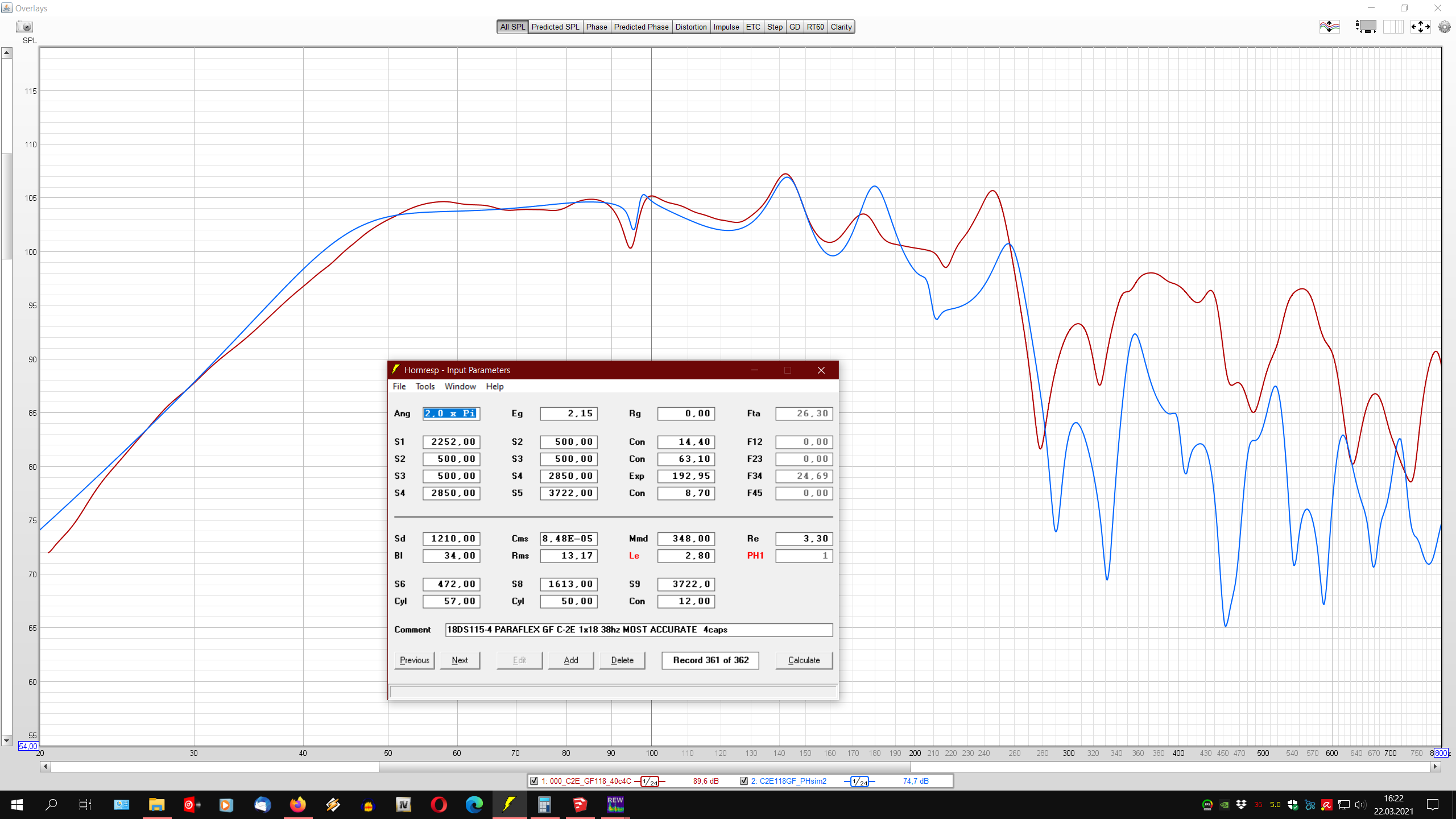

Initial tests by myself (and several other users) suggest that its working "REALLY" well. Here is the PA1 Hornresp model vs a pure BEM AKABAK3 plot. As you can see the peaks and dips are all there (frequency shifted due to driver volume). I've also had reports that actual measurements are lining up with the sims and that this is already informing design decisions of semi-pro builders. I dont really know how to than you for this! It's literally amazing.
Hey David!!
Thanks a lot for implementing the Paraflex code into Hornresp! We had some funny issues while simulating in TH-mode and saw things that Hornresp was not capable of, but that did not matter.
The reason i do this post is the unreached accuracy for Paraflex now! I built a C2E Golden Formular 118 loaded with 18DS115-4 and i changed the length of the High-tuned fold a bit (40cm instead of 34cm and capped - as offset) and look what is does! The cabinet is nearly flat up to 200Hz. Really sick for such a complex design. Will do some further experiments on that and keep you updated!
Thanks for the code, David! :worship:

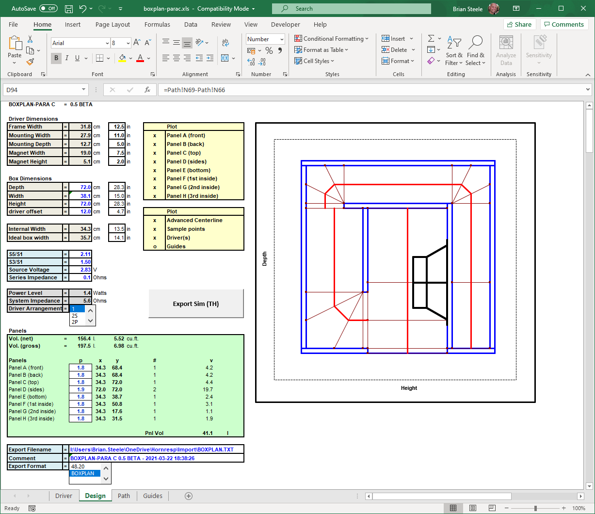

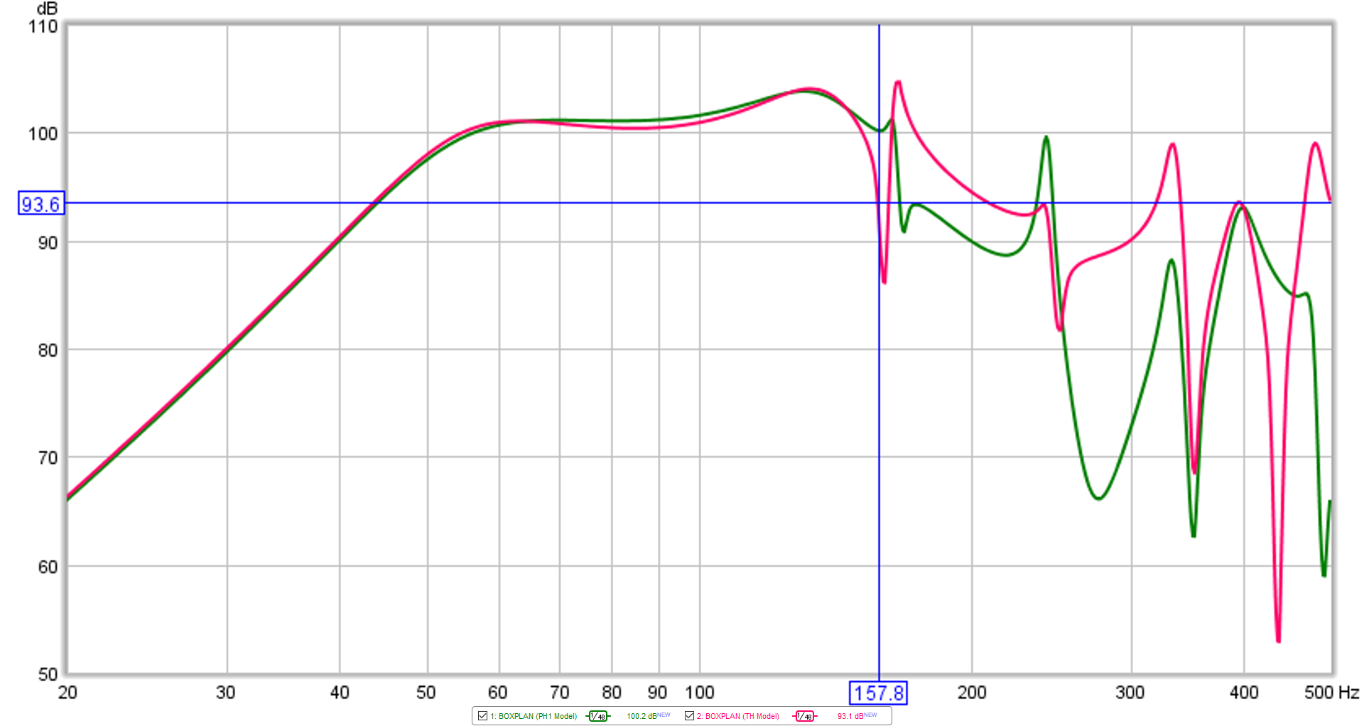

I updated my BOXPLAN-PARAC workbook to support the Hornresp "PH1" simulation model. The results look promising. The offset of the driver can be used to smooth the response between 100 Hz and 200 Hz. One could argue that you're not supposed to be using an enclosure designed for basically subwoofer duty, but I'd argue that a smooth response through that region usually implies also smooth phase response and therefore a box that's much easier to x-over through that region 🙂.
I'll update my other Paraflex BOXPLAN workbooks accordingly when I have time to do so.
Oh, BTW, I came across a pretty big bug. I'll detail that in my next post.

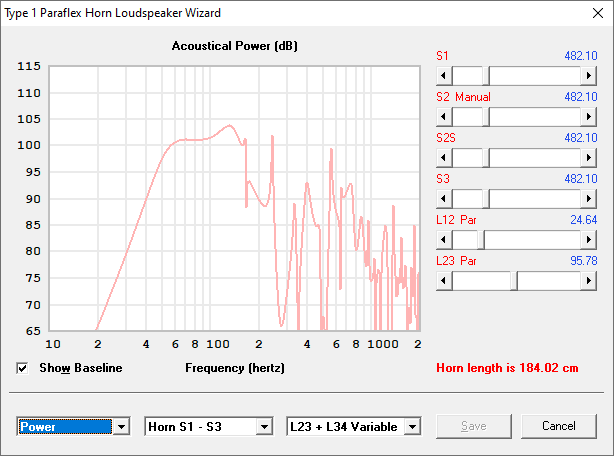

BUG Report
To reproduce the bug:
Using the "PH1" Model,
1. Select "Edit"
2. Select "Tools..Loudspeaker Wizard"
3. Select "Schematic 1". Take note of the image and settings
4. Select "Power"
5. Select "Memory & Width"
6. Select "Export Data", and export FRD data
After completing the export, the Loudspeaker Wizard resets to the "Schematic 1" view, and the model appears to be no longer a "PH1" model.

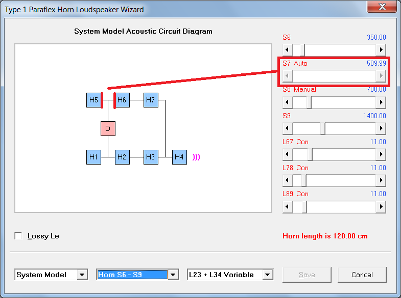

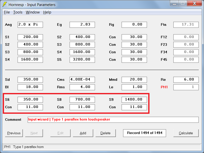

Looks like the additional segments are S6, S8 and S9. What happened to S7? 🙂
Just to clarify, S6, S8 are S9 are cross-sectional areas, not segments. The additional segments are designated as H5, H6 and H7.
S6 = H5 throat area
S7 = H5 mouth area and H6 throat area
S8 = H6 mouth area and H7 throat area
S9 = H6 mouth area
S7 is calculated automatically because there are only three area parameter values available to use as inputs. To be able to calculate S7 the flare types for segments H5 and H6 have to be the same.
