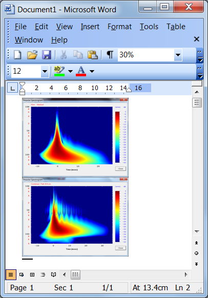

Is there a way to make the graphs static so that comparison can be easier to see visually?
It's not going to happen .
If I have a need to compare such things, I simply take form prints (press Alt + Prt Scr keys) and paste them into an open blank document in Microsoft Word. It's very quick and easy to do. (In the attached example the Zoom setting has been reduced to 30% to fit everything into the image shown).
It is not actually necessary to copy both results - just put the first into Word and compare it to the second in Hornresp.

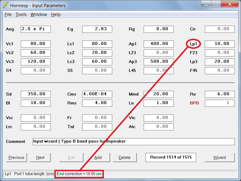

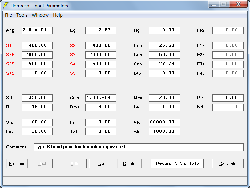

Is there a way to get the impulse response(wav) of the Type B Band Pass?
Yes, but not directly from the Band Pass Enclosure Loudspeaker Wizard.
Specify an equivalent design in the main input parameters window using stepped segments, and calculate the results with resonances not masked.
To illustrate:
Attachment 1 shows the default BPB design produced by the Input Wizard. Moving the mouse pointer over the Lp1 and Lp3 input boxes displays the port tube end correction values, which have been added to L12 and L34 in the equivalent design shown in Attachment 2. The results for the two designs are identical.

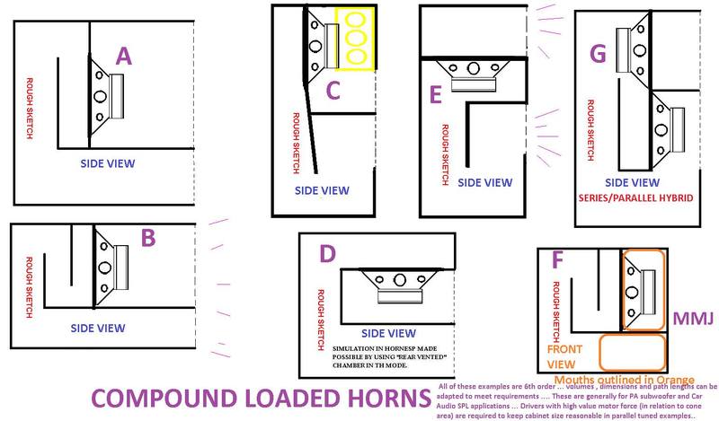

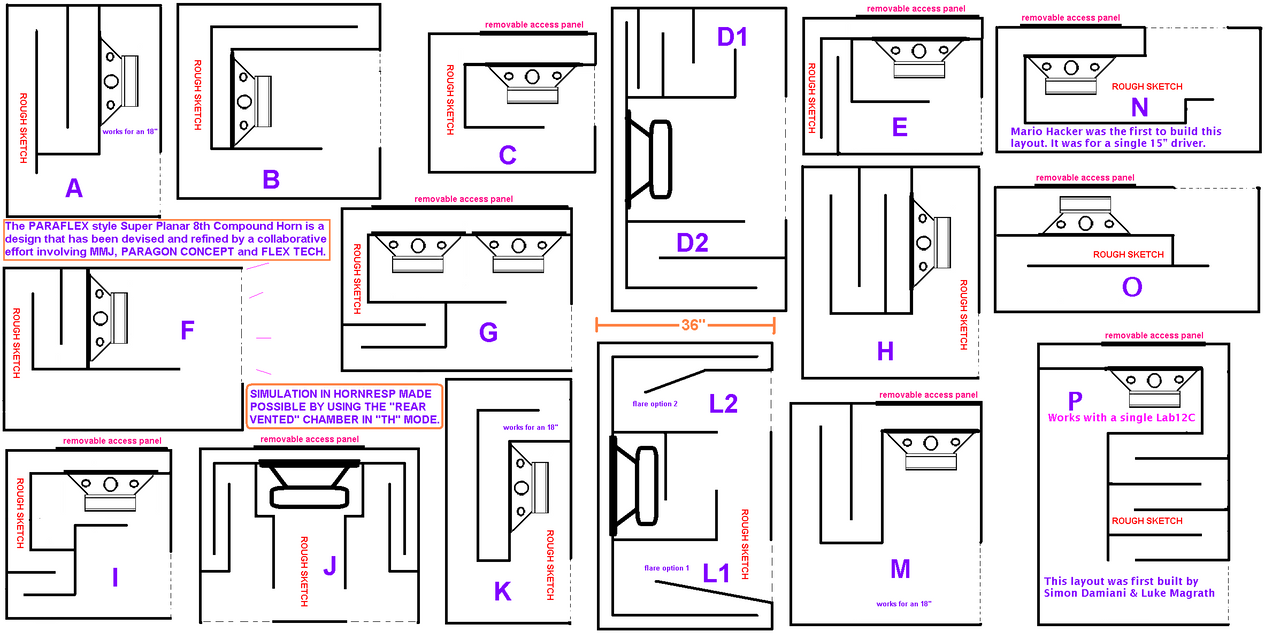

Even though we do (or did previously) use Hornresp's "TH" mode to simulate Paraflex cabinets the addition of the High-Tuned resonator makes them something significantly different than a TH, a compound loaded creature more closely related to a Compound Horn (or Compound QW) design with the ends of it's resonators merged to share a single mouth .
It can't be a Compound Horn and share a single mouth.
Your Paraflex single mouth (pic 1) = BP6S = stepped TH.
Compound Horn = BP6P = your Super Planar (pic 2).

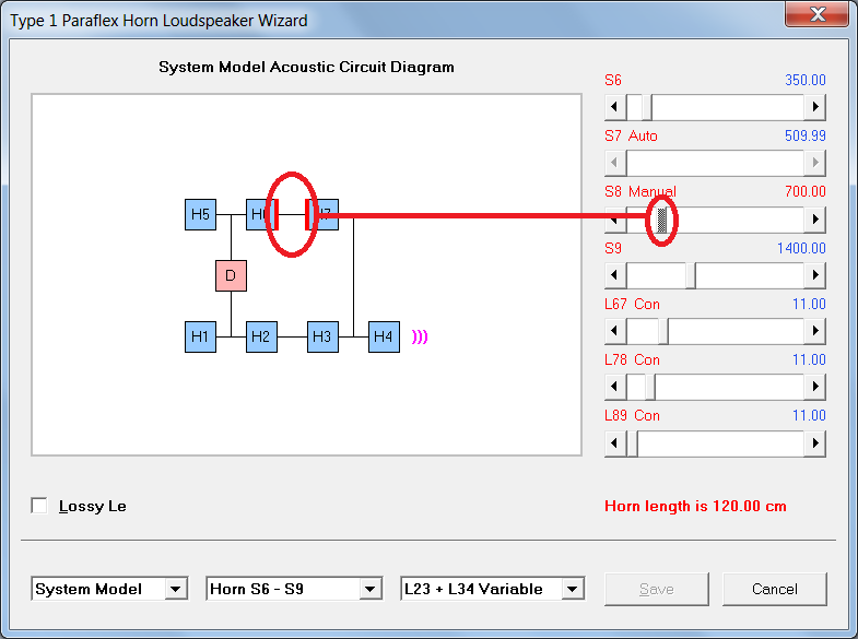

re: "Ring of Fire" - - any help to jump using the new models would be appreciated.
Hi freddi,
To get started:
1. Use the Input Wizard to create the initial paraflex record, and then edit values to suit.
2. Use the System Model in the Loudspeaker Wizard to see what parameters apply where.

BP1fan,
Notice I said "closely related to a Compound Horn" ... .The ends of both resonators merging to share a single mouth is what separates it from a standard Compound QW/Horn design...... The additional resonator is what makes it something other than a Tapped Horn...
Some of the Paraflex subwoofer designs are stepped and some aren't ....The Paraflex tops have a more traditional horn flare as their High-Tuned resonator section (but still merges with the other resonator path or paths near their ends to share a single mouth) ....

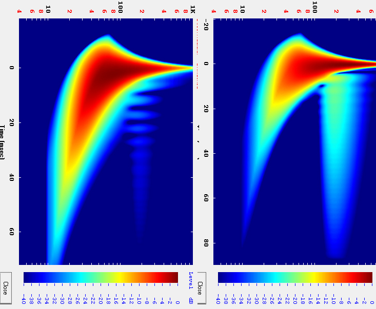

I think what he is asking is something I myself asked for earlier (and was turned down ) which was that the axes for both graphs could be forced to be the same. I'm not into coding any more, but I've seen many libraries which allow defining the axes. Even LabView has this capability, wherein you double-click the value shown at the end of the axis you want to modify and type in the desired value.It's not going to happen .
Eg. in the second graph, double-click -20 and type 0 and press enter. The graph will be redrawn with the axis starting from 0. Then double-click 80 and type 60 and press enter. Now the y axis will be the same for both graphs.
I agree that it is a lot of work to code this by hand, but please do keep your eyes open for a graphing library/ control that has this functionality built in. If such a vbcontrol exists, then it is a fairly simple matter of using that instead of what you're using now.

BP1fan,
That's no different than saying a BP6S is closely related to a BP6P.
Agreed. I see your stepped versions more often...ease of build because there are no angles to deal with.
