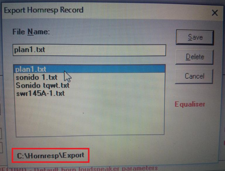

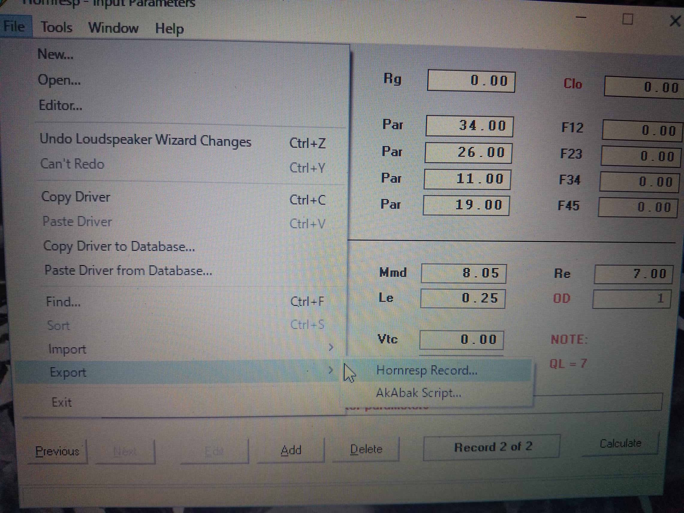

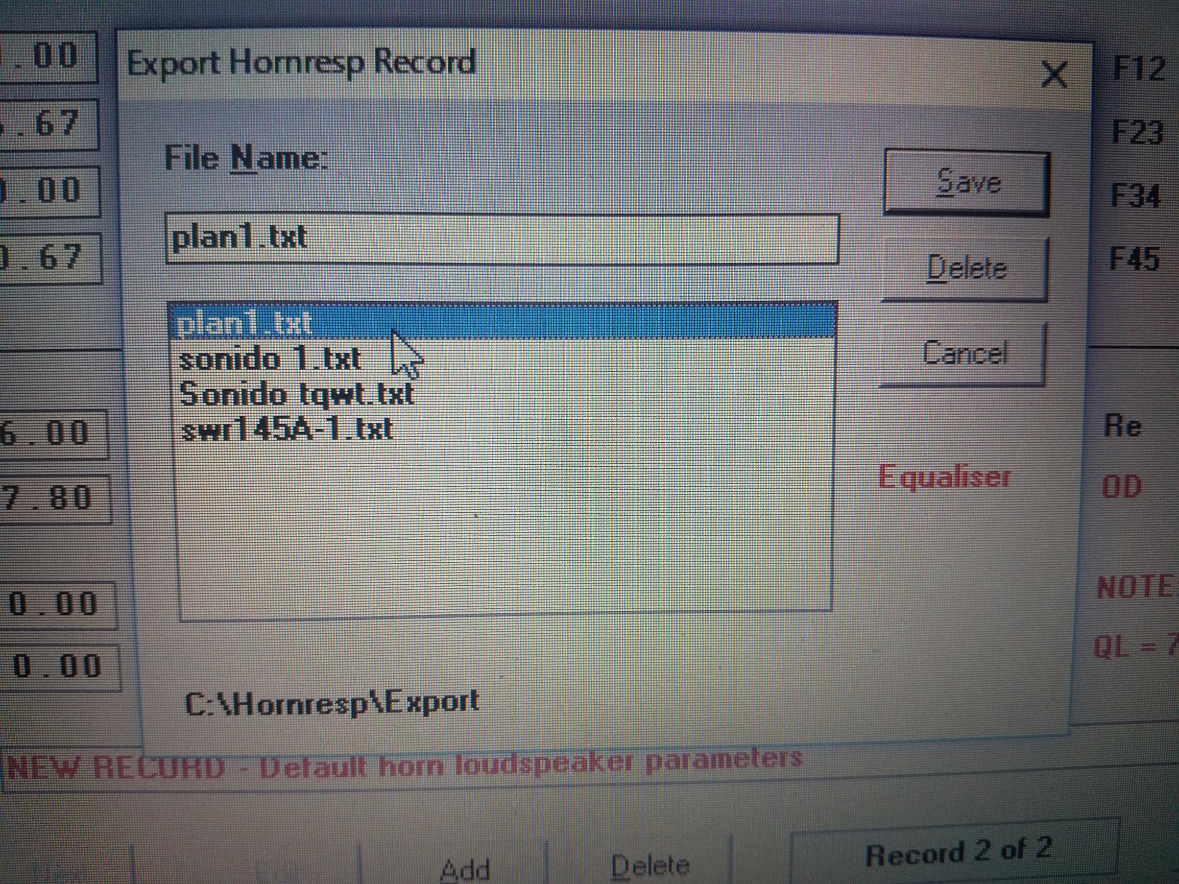

How I can file on my pc?
Hi tamra,
The exported file should be in the 'Export' sub-folder under the 'Hornresp' folder on your C: drive.
(The path to the file is shown at the bottom of the Export Hornresp Record form, as highlighted in the attachment).
Kind regards,
David

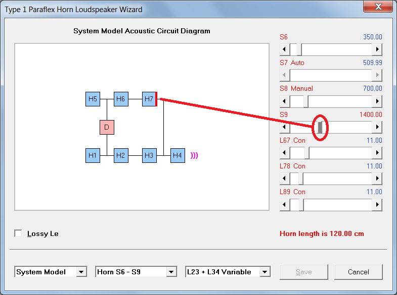

Just to clarify, S6, S8 are S9 are cross-sectional areas, not segments. The additional segments are designated as H5, H6 and H7.
S6 = H5 throat area
S7 = H5 mouth area and H6 throat area
S8 = H6 mouth area and H7 throat area
S9 = H6 mouth area
S7 is calculated automatically because there are only three area parameter values available to use as inputs. To be able to calculate S7 the flare types for segments H5 and H6 have to be the same.

Should this be H7?Just to clarify, S6, S8 are S9 are cross-sectional areas, not segments. The additional segments are designated as H5, H6 and H7.
S6 = H5 throat area
S9 = H6 mouth area
Should this be H7?
Hi SamAnytime,
It should indeed be H7. Thanks for making me aware of the error, my apologies for any confusion caused.
Kind regards,
David

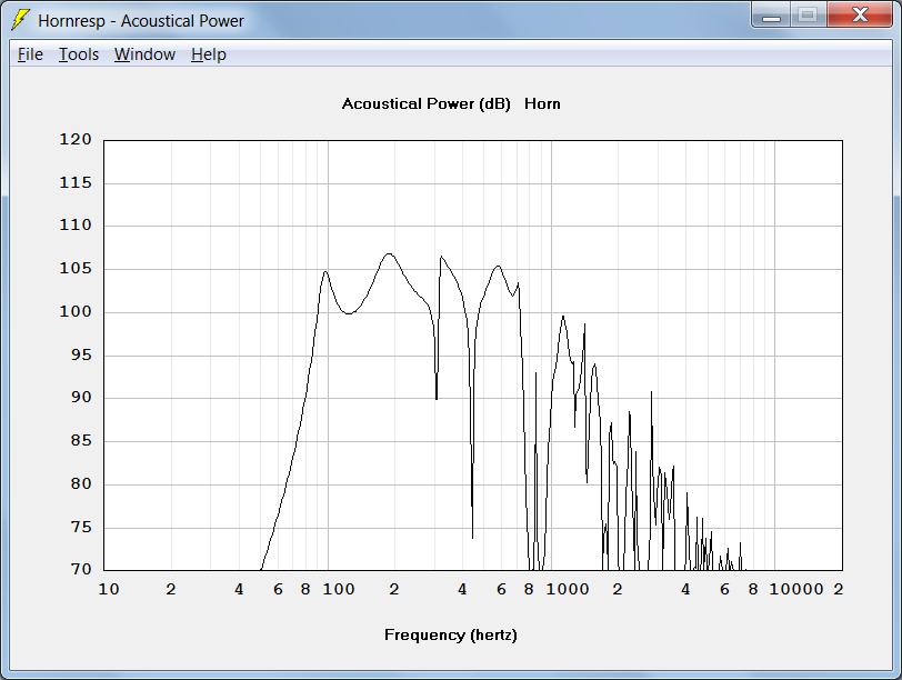

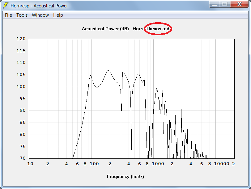

Hornresp Update 5200-210327
Hi Everyone,
CHANGE
Paraflex horn designs exported from BOXPLAN can now be imported directly into the loudspeaker wizard.
BUG FIXES
1. The bugs reported by Brian in Post #11872 and Ty in Post #11878 have now been fixed.
2. Masked / unmasked settings are not applicable to paraflex horns and are no longer shown in the chart captions of those systems.
Attachments 1 (before) and 2 (after) refer.
3. A number of other "loose ends" have now also been tidied up.
Kind regards,
David
