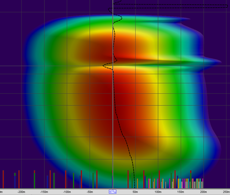

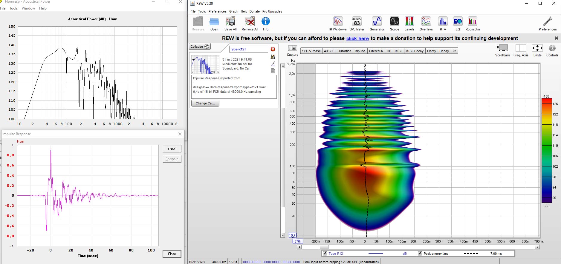

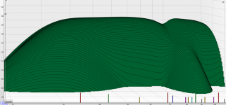

Isn't it easier to export impulse from HR and import it into REW and then view the spectrogram?
In HR: after generating, hit Tools > impuse > Response and [export] button as wav
In REW: File > import > Import impulse response, select exported wav from HR/export folder.
And then open the spectrogram tab in rew.
Easy peasy!

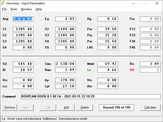

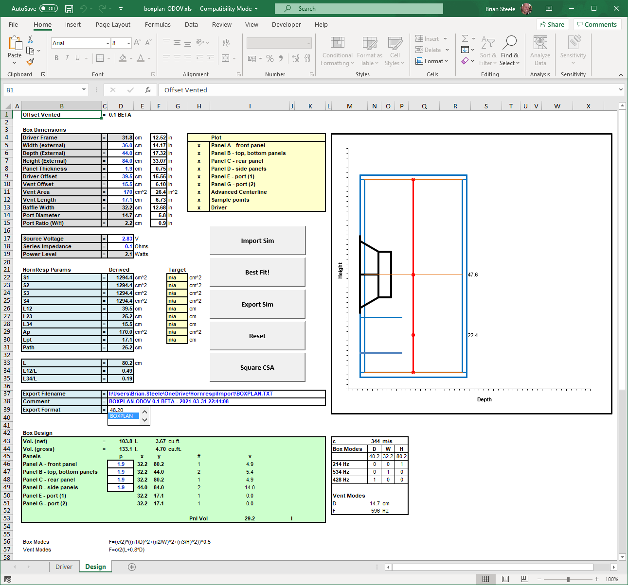

Hi David, I've made a BOXPLAN for the offset-driver, offset vent Hornresp model, but the import doesn't seem to be working. "Fta" isn't changed to "Clo" and the Ql option isn't displayed.
BTW, is there a way to capture the value for Ql in Hornresp's import/export files?
If you'd like to have a look at the BOXPLAN spreadsheet in question, it's BOXPLAN-ODOV at The Subwoofer DIY Page - Horn Folding

Hi Brian,
That's because Hornresp was not expecting to see such a design coming out of BOXPLAN .
Because it would require a change to the existing file structure and because it only applies to vented-box enclosures, I think I would prefer to stay with the current arrangement where the user can experiment with different values of QL if they like, but that the starting point is always the default value of 7 (which is probably the most realistic number to use anyway).
I will check it out over the Easter break.
Kind regards,
David

The new BOXPLAN offset-driver / offset-vent model will be taken into account in the next update. During the design optimisation process QL will remain at the value specified by the user - it will not be automatically reset to 7 each time F6 is pressed in the Loudspeaker Wizard.

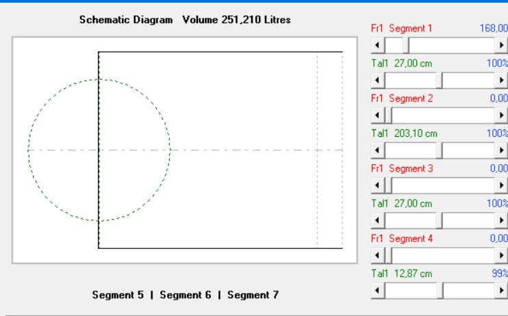

how do i add filling to segment 5,6,7?
You can't. This was one of the limitations documented in Post #11805: https://www.diyaudio.com/forums/subwoofers/119854-hornresp-1181.html#post6553189

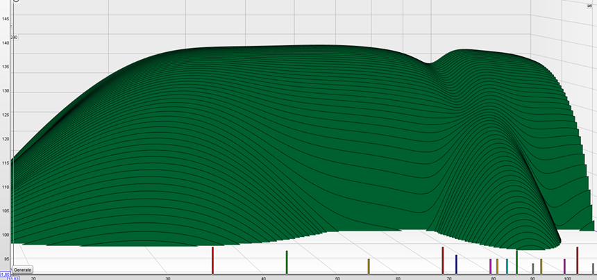

Effect of damping material in the right location (measured in the real-world)
What we are unable to show here in the simulation (unless we swap the resonators in the model maybe) is how we were able to solve the ringing issue by using some damping material in the offset portion of the cabinet's High-Tuned Resonator and that is why USRFobiwan was asking about "filling" or damping in the new horn segments made available in the "PH" modes ..
These measurements below were taken by Patrick Sander (Ballfred1 on DIYaudio) outdoors during a slightly windy day ..... Patrick has been working on this optimization which extends the cabinet's upper bandwidth and it works but damping material is required (at or near the closed end of our angle-brace offset stubs) to keep the cabinet from ringing within that 90hz to 100hz region ... .
