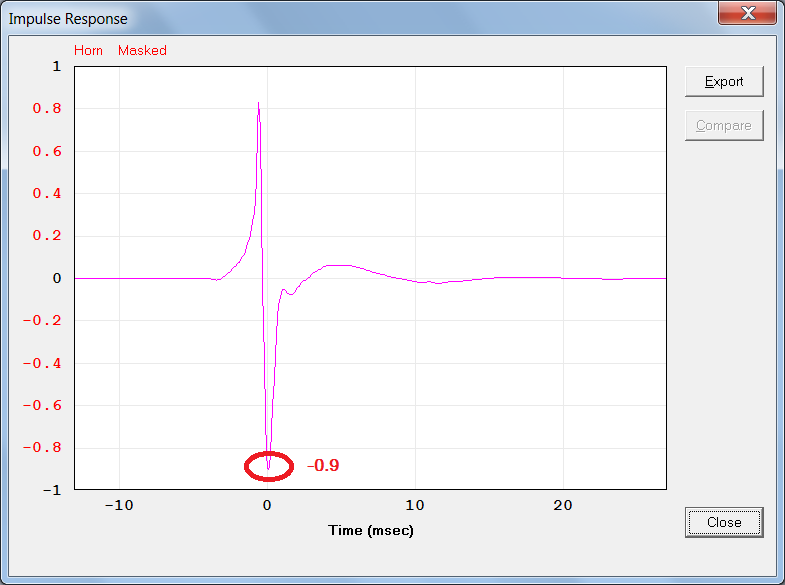

David, if I do an impulse export and import it into REW, it is about 23dB higher than reference. And i do not know why, if anyone knows or has a hint let me know.

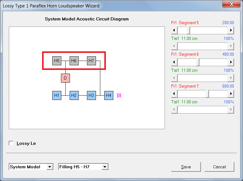

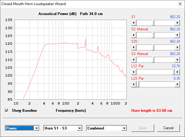

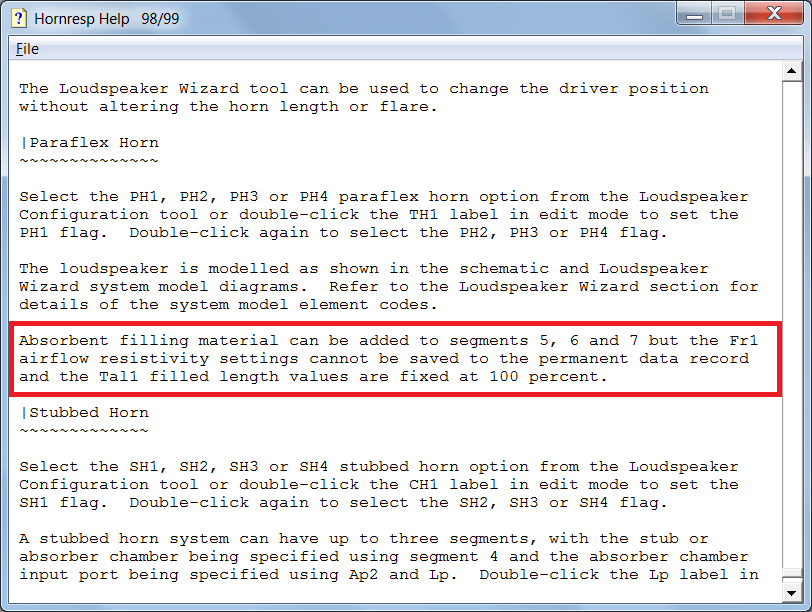

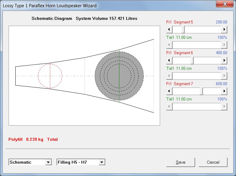

What we are unable to show here in the simulation is how we were able to solve the ringing issue by using some damping material in the offset portion of the cabinet's High-Tuned Resonator
If it was possible to add absorbent filling material to paraflex horn segments 5, 6 and 7 on the understanding that the Tal1 sliders for those segments would be fixed at 100%, and that the Fr1 slider settings could not be permanently saved, would this still be worth exploring?
In the absence of any feedback either way, as far as I can see there would be nothing to lose by having the feature available, even with the stated limitations, so it will be added in the next update.
I don't think he gets updates from the forum as he is in charge of a very busy diy group on FB which bombards people with update info in that position excessivesly. But, yes, that is a very very useful addition and thank you. Youve really opened up the ability of these types of designs to be created. They were very difficult before. Parts were even guesses. This is a game changer once sir! Its ‘easy’ now, if there was one word.
Yes Please

Hornresp Update 5210-210410
Hi Everyone,
CHANGE 1
The BOXPLAN offset driver / offset vent (ODOV) model can now be imported into Hornresp. Post #11926 refers.
CHANGE 2
Absorbent filling material can now be specified in paraflex horn segments 5, 6 and 7 - see attachments.
Limitations:
1. Tal1 slider values for the three segments are fixed at 100%.
2. Fr1 slider settings for the three segments cannot be permanently saved.
BUG FIXES
Several more paraflex horn "loose ends" have been tidied up.
Kind regards,
David

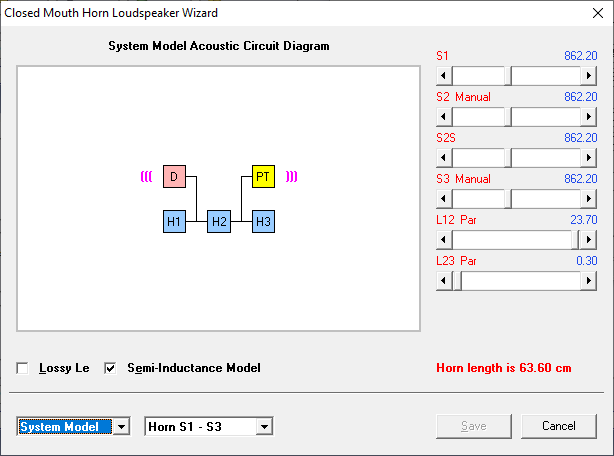

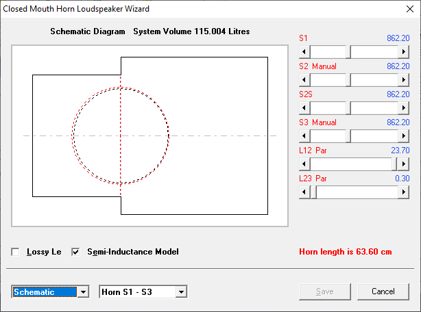

Hi Everyone,
CHANGE 1

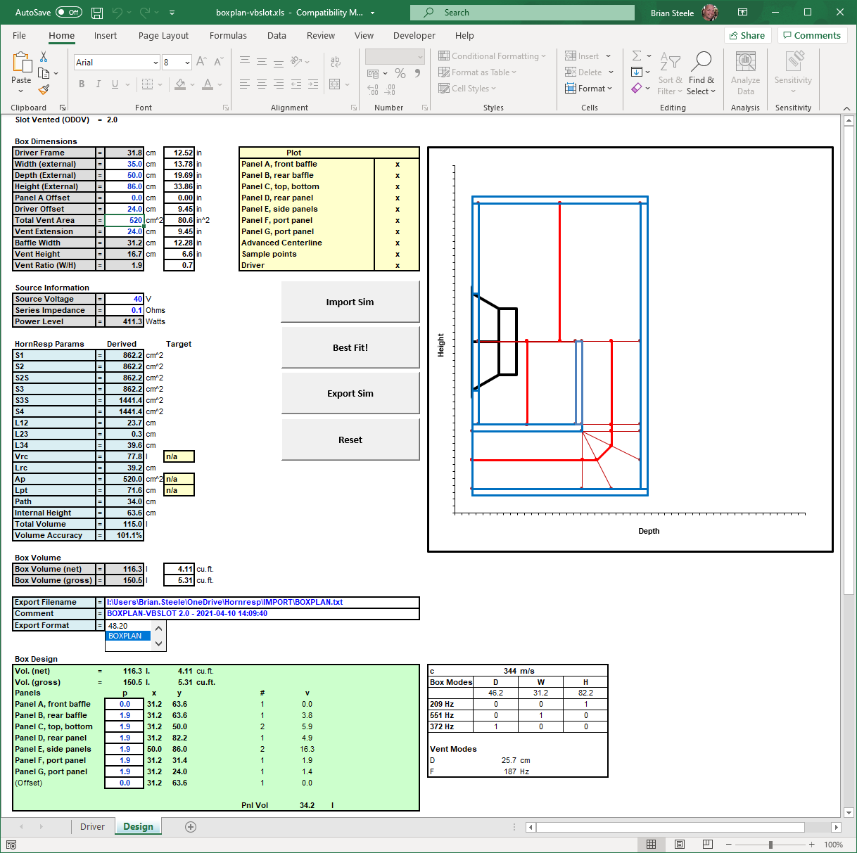

Excellent. I can now release this new BOXPLAN into the wild... 🙂.

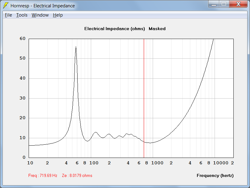

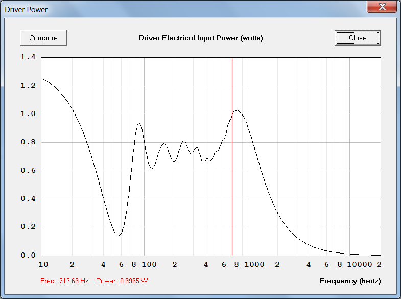

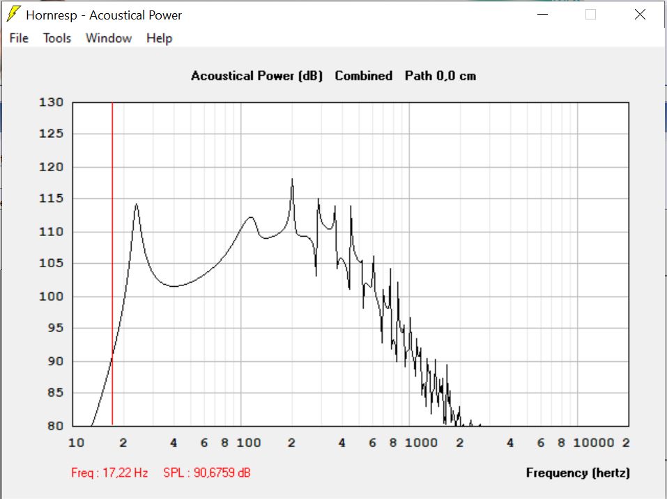

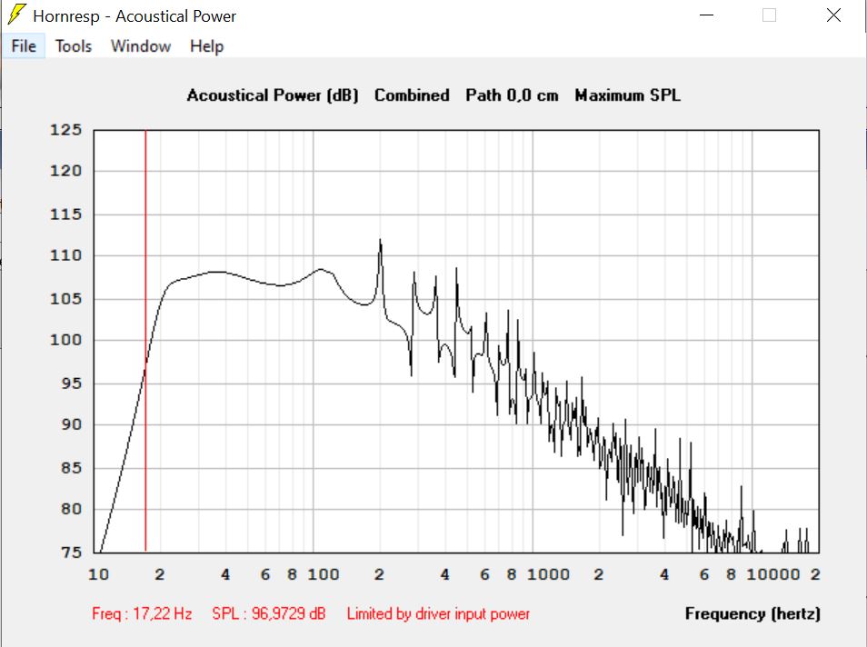

Hornresp calculation default vs 1 watts
Hi Master, Hi have a question, i not sure if was reply before. But there is.
Why hornresp calculation response by default is different giving 1 watts signal to speaker?
Image attached.
Thanks!
Hi moglyman,
The standard calculation assumes a constant input voltage Eg (2.83 volts by default, equivalent to 1 watt into an 8 ohm load). For an input voltage of 2.83 volts, the input power will vary from 1 watt because the electrical impedance of the system is not a constant 8 ohms over the frequency range - see attached example.
Kind regards,
David

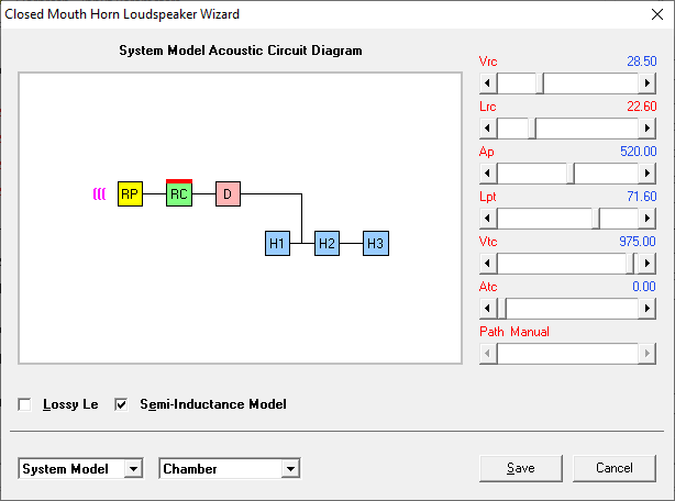

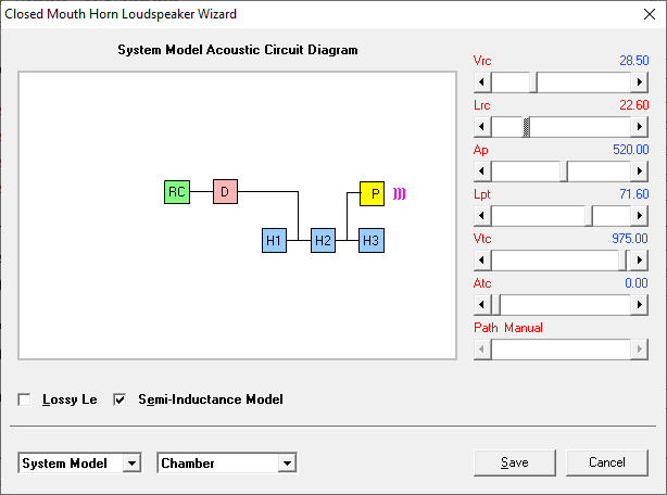

Hi David, once Vrc and Lrc are defined, the model looks like the first image. What's the possibility of having it look like the second, for the "closed horn" model? I think the second version might be more useful (well, at least to me, LOL, as it will allow the more accurate modeling of an offset-driver, offset-vent 4th order bandpass design like my Enigma).
