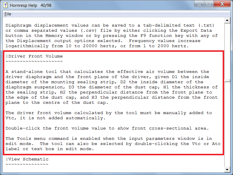

I was thinking about the "throat chamber" conundrum in the putative PA system model and was wondering if the existing "Driver front Volume" calculator be used to define this?
Also trying to work out if SD Vas etc can get us somewhere close to predicting the vtc of a driver flush mounted perpendicular to the path a horn....?
For all sorts of reasons, it's not going to happen.
Is it still worth trying to implement the Paraflex model if driver front volume is not taken into account, bearing in mind that the rear volume occupied by the chassis and magnet assembly is currently disregarded in most cases?
Absolutely. I was just trying to explore if there was a simple way to work around it, I.e. by default its zero (no throat chamber) but if you set the volume in the "Driver Front Volume" popup then that computed CSA, Vtc and Ltc can be used instead. ;)
To be fair I'm surprised someone hasn't suggested an "Export to throat chamber" button for the "Driver Front Volume" popup (for the other system models) already.
I should probably be quiet now and slink off back into the background.... :p
I decided not to do it that way originally because in many designs the driver front volume needs to be added to a separately-specified throat chamber volume, and in other designs there is no throat chamber to export the driver volume to. It would not help with the proposed Paraflex system anyway, because the Vtc and Atc fields in the data record are now used to permanently store the S9 and L89 values, and there are no spare fields left in the record to store exported driver front volume data.
I knew I had another reason, which I have just remembered :).
Depending upon the loudspeaker configuration and the orientation of the driver, it is sometimes necessary to add the driver front volume to Vrc rather than to Vtc.
So there are four possiblities, depending upon the circumstances:
1. Add driver front volume to existing Vtc.
2. Replace existing Vtc with driver front volume.
3. Add driver front volume to existing Vrc.
4. Replace existing Vrc with driver front volume.

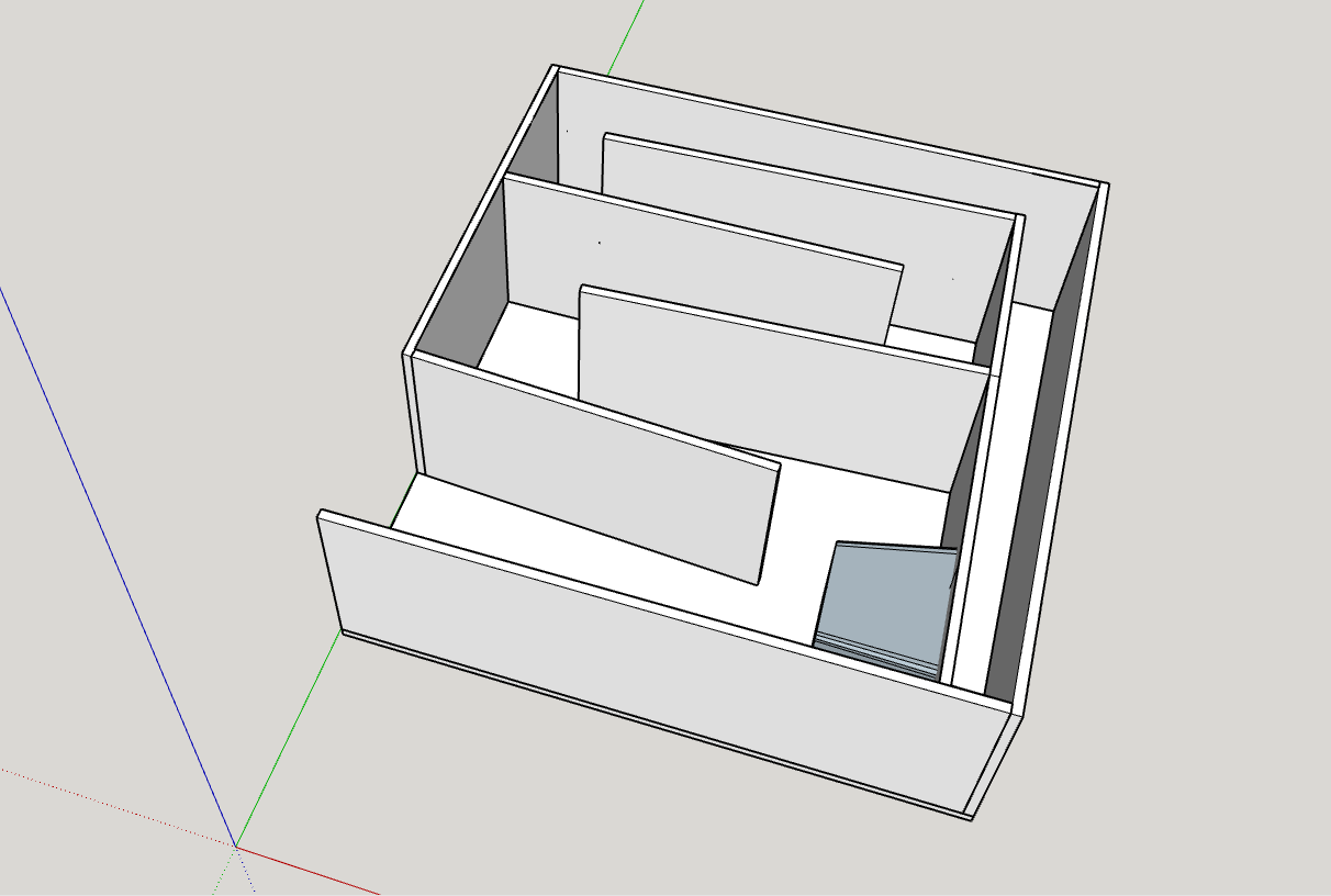

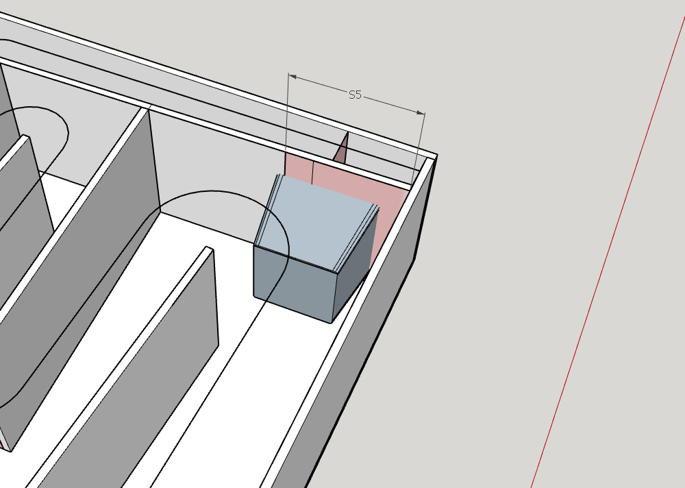

I am trying to duplicate TH-SPUD design with different drivers and model it in Hornresp. Although, i am not sure if i am doing it right. I basically took the "leaked" design of TH-SPUD and put drivers that i have laying around.
I've made a model in SketchUp which makes it easier to calculate S and L values.
Here is how it will look with Kicker 12" L7 Solobaric woofer:
attachment.php

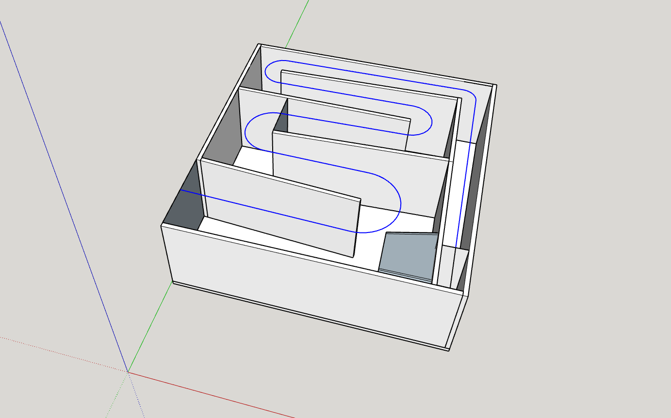

The blue line is how i estimate horn path:
attachment.php

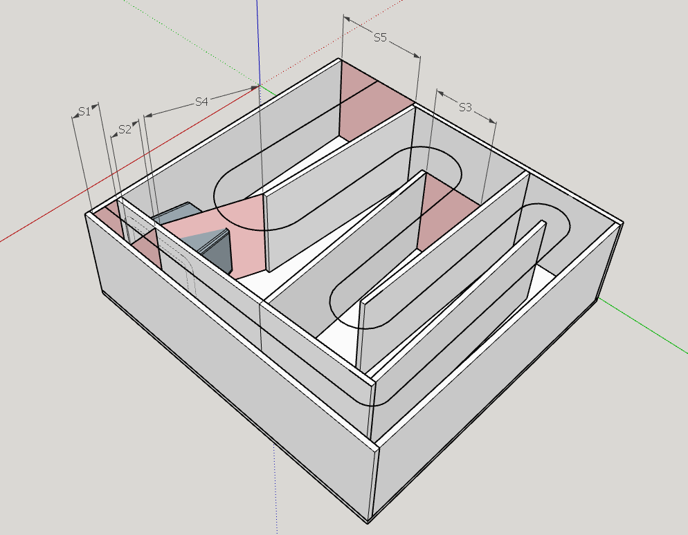

Pale red rectangles is where i put segments of the horn:
attachment.php

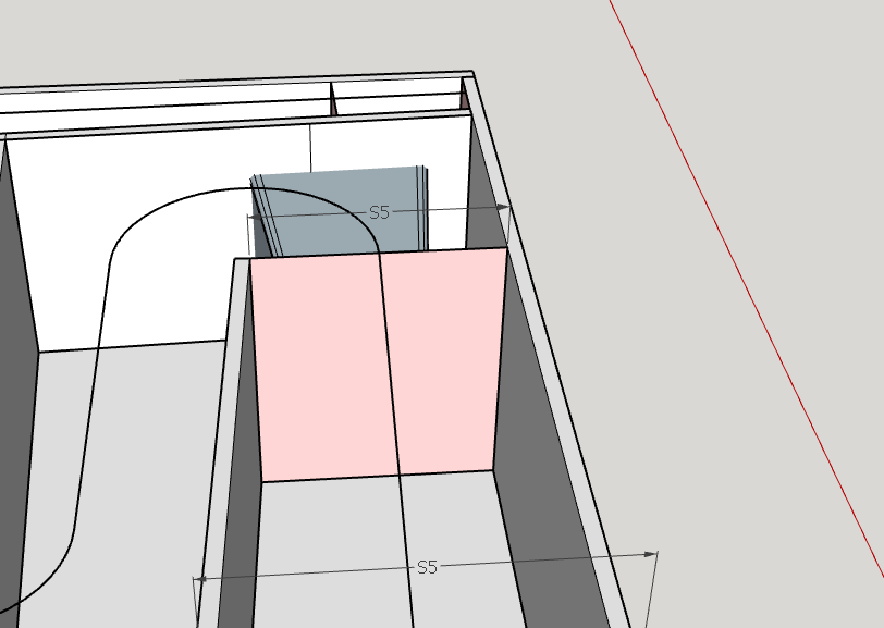

Now, i understand that S1 through S3 and even S5 are placed correctly.
But am i "placing" S4 in the right place?
I am guessing that there are two probable alternatives to where to put it:
Here:
attachment.php
Or here:
attachment.php
This question was probably asked a thousand times before, but i wasn't able to find the answer here.

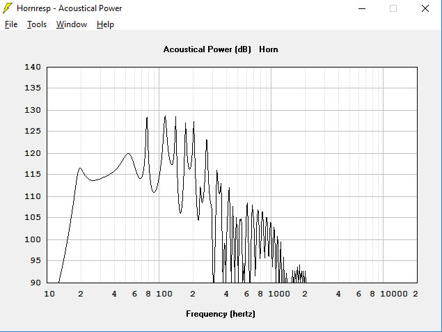

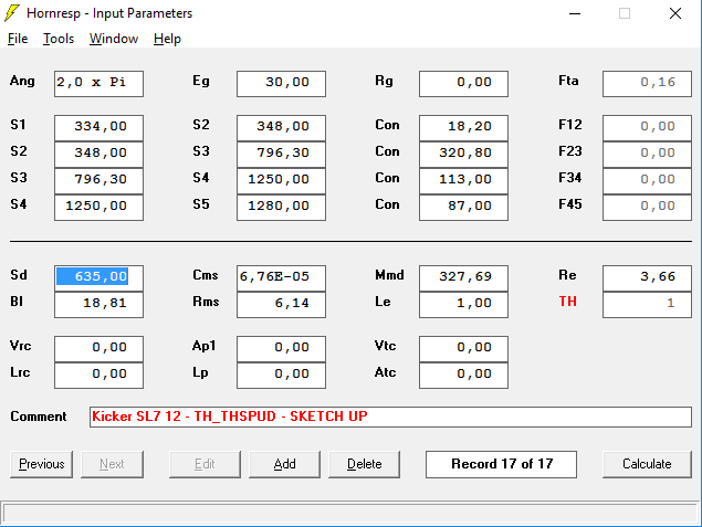

HornResp gives me this estimation (S4 placed as shown in the first example):
attachment.php
attachment.php
Am i really going to get such beautiful response with this tapped horn? Or am i doing something wrong here?

The location of S4 is right (i.e. L34 and L45 will be right). However, the value of S4, if you work it out from that slice, might be wrong. You can estimate the correct value for S4 by working out what would be the theoretical cross-section of the path at that distance from S5 or S3.
Use PAR instead of CON sections to describe your design in Hornresp. PAR sections are the correct type to use for a bass horn folded up into a rectangular box.
As this is likely a high Le car audio driver, I suggest deriving the semi-inductance parameters from the driver's impedance curve and using those in the sim to see how its response is impacted.
