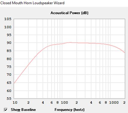

Maybe ‘helpful’ in the troubleshooting? OD, with ‘closed’ mouth. Click on ‘QL’ on main screen or try to go into ‘wizard’ in tools and its likely to get this(pic)?
Note: I am possibly creating an issue as i have multiples of it open for comparing drivers (not sure if thats a factor but important to mention i think)?

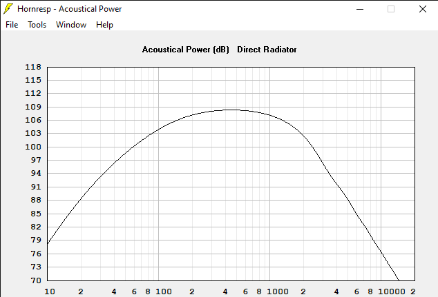

...SPL did rise a bit above 1kHz, but still rolling off dramatically compared with the manufacturer's freq response. Still wondering...
Remember that Hornresp is showing you the power response, not the on-axis response.
Think of it as what you would measure with an RTA compiling an average response as you walk all the way around the speaker enclosure.
Thanks!
I have been thinking about directivity a bit, but I'm admittedly new to this. The design has a rear-firing BLH that'll fire toward a wall, tuned to 80Hz - 400Hz, and now a small FLH tuned down to 250Hz to counter the strong bass from the BLH. The coupling chamber for the BLH could be tuned as high as 600Hz, but I thought it'd be better not to have too high a ceiling because of directivity.
I haven't completed playing around with that crossover between the two sources, but is the way of thinking about it on track?
Hornresp was never designed to handle multiple simultaneous sessions. Installing and running multiple copies of the program can in the worst case lead to a complete loss of all permanently stored design records. The error you have experienced is a mild outcome compared to what can possibly happen, depending upon the circumstances.
I strongly recommend that you immediately delete all but one of your Hornresp installations.
Note - you have been warned. Don't blame me if you keep running multiple copies, and then one day all your valuable stored data suddenly disappears... :).
Oh!! good thing i asked, thank you for the heads up David :)

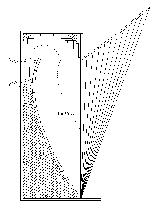

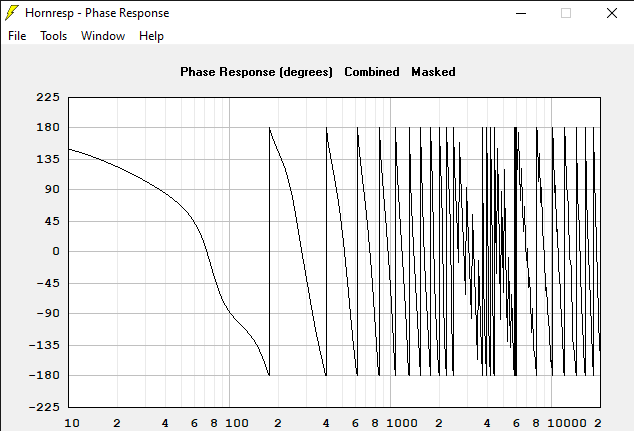

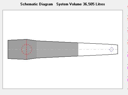

I've been tweaking my model like a madman to achieve as flat a response curve as I can across the broadest spectrum of F that I can. Being new to this, it's hard to tell when to stop :). That is, to know whether these results are at a stage where I can stop modeling, update the physical cabinet design and start building.
Here's some background: This is modeled with an FR Dayton Audio PS180-8, 6.5" driver. The design is a compound horn, with the BLH rear-firing toward a nearby wall. The FLH was needed to fix the response curve sloping downward from 80Hz - 1kHz. I'll make the front horn and the rear chamber on the lathe. The rear chamber's volume is quite small, such that the smallest driver-enclosing rectangle/depth would force it to be too big and short, so it'll be a true cylinder.
I know from a recent RTFM moment from David McB (I did deserve that), that an FR driver represented in Hornresp will be depicted as rolling off at higher frequencies. In addition to the F response chart for the design, I also attached the infinite baffle F response curve here, because it seems to me that, if conservation of energy applies, the area under the curves must be the same, and if true, I have pretty close to the flattest, broadest response curve I could possibly get--all the wiggling is within 118-121dB. But that is the fundamental question.
In addition, I'm not sure I have good phase response or directivity, given two horns firing in different directions. For the length of the acoustic path between point sources, I used the distance from the front radiator to the middle of the BLH mouth in my tentative design, about 81cm, but maybe that should measured back to the wall?
Feedback/advice much appreciated!

Newracer - do you have drawings / sketches of your design?
Not exactly, Neil, but attached is something close--the out-of-date design. I've been making so many modeling changes, I decided to stop trying to keep up with the physical design until I could converge on a good schematic. The attached is the side view of the basic format though. Key differences:
- The BLH won't have an offset driver.
- The FLH has a small rear chamber
- And the BLH will expand linearly (conical), not exponentially.
I'll likely have to fold the horn differently, though, with the driver nearer the top of the cabinet.
Hope this helps--LMK.

How much power are you hoping to pour into this little woofer?
It only has a 25mm or 1 inch voice coil. And the wire gauge will be nearly tweeter thickness to keep up the motor force. 30 watt peaks for a brief time only. Remember that even at the very wishful efficiency rating this driver is almost 95% inefficient. Which means almost all the power going into the driver will get turned into heat!
Other wise.
You have a really flat back loaded horn. But huge!
Are you hoping that the rear wall and or corner will augment what you have worked out?

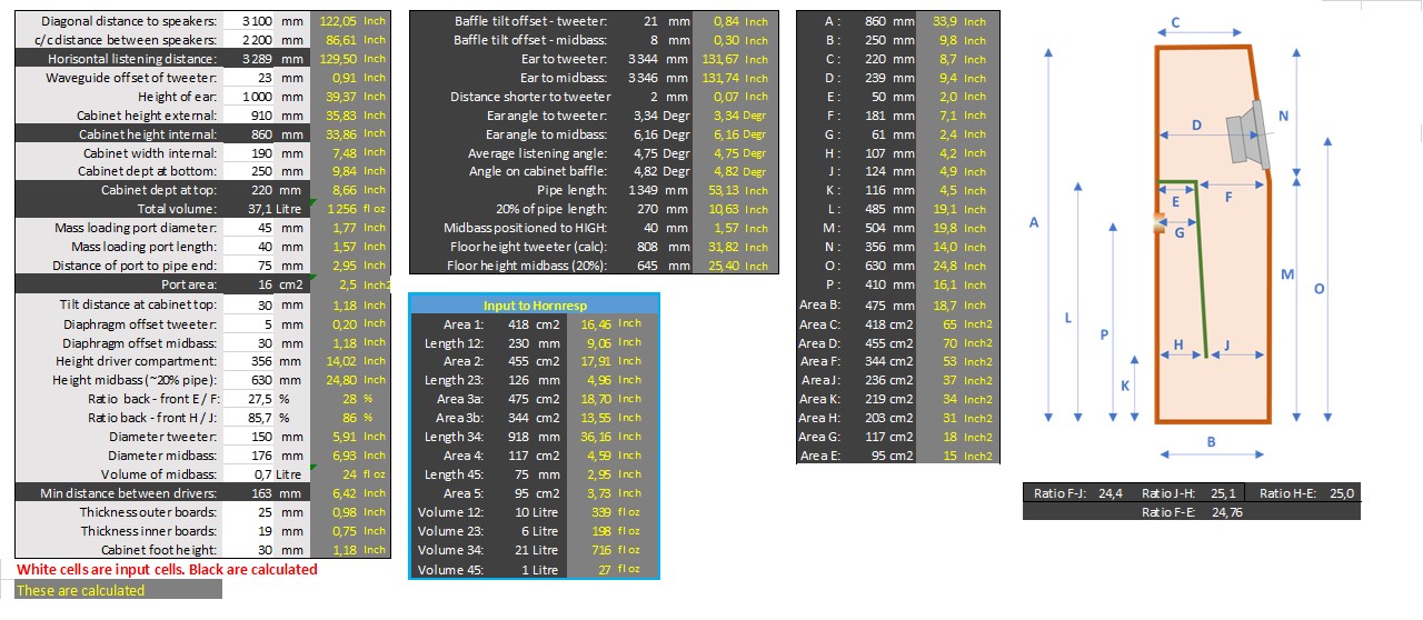

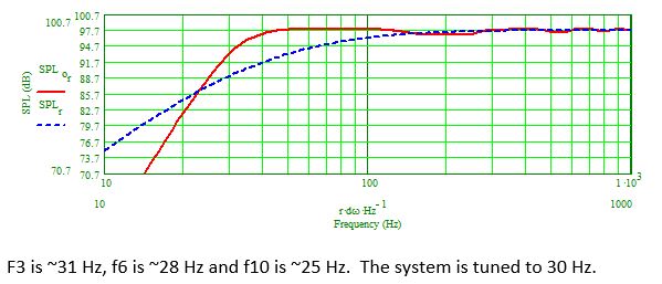

I have a design for SB17NRX2C35-8 done by Paul Kittinger (Google if you don´t recognize the name, who has won a ton of prices for his designs) based on MathCAD by Martin King.
The design is a combination of things I and him have found good in past designs. TSML-TL = Tapered stepped mass loadedd transmission line. The design has an interstingly low f3 and nice smooth spl curve despite rather small volume <37 litres.
Two things:
1)
I have two graphs on the same design - but quite different. One from MathCAD (with little higher input, so don´t care about the showed different output levels) and one from Hornresp. As Hornresp doesnt handle the stepped design into a tapered line I have had to adapt to Hornresp. QUESTION: Are there any other ways to adapt (as my begging to David about this missing feature hadn´r turned out so well until now :) ) to simulate the step between L23 and L34?
2)
OFFERING: I am a lot better with excel than other things. I very often do my designs from a sketch which then input to a modelling Excel sheet for that specific type of design. It makes it very easy to get all the different specs for volumes angles etc right. Take a look at the Excel sheet picture below and you will understand. I like this kind of nerd work so - If anyone is interested I have this and some other designs that you can utilize from. And maybe set up some new ones. It´s also possible to make board saw designs. Just come back to me.
