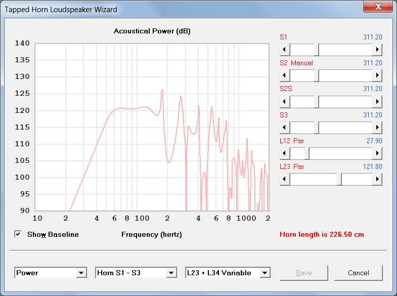

Okay, here's what I did, that led up to a "no save" - I scrolled to an existing file, hit add, and loaded in a new driver (from the driver database) and then edited a number of things in the Loudspeaker Wizard: changed the last two sections, changed the L12 path length, changed the fill values, Saved the changes. I opened Loudspeaker Wizard at least 4 times and saved it each time.
I did a couple of screen captures, and toggled over to my image editor (IrfanView), and toggled back and forth to DataCAD several times. I saved a PDF from DataCAD, and then a screen capture from the PDF. I toggled a couple of times also with Firefox, to post things on the Facebook Transmission Line group.
I exported the file, to be able to reload what I had done, for our friend Justin Case.
When I then clicked Previous in Hornresp, it did not ask be to save the record.

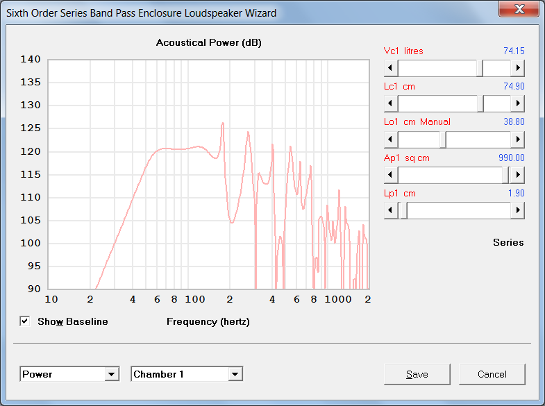

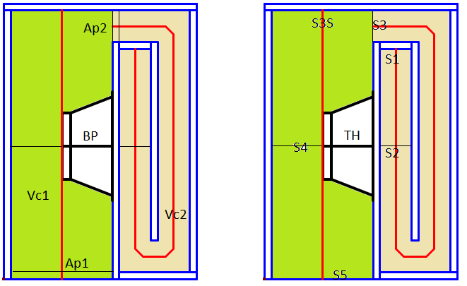

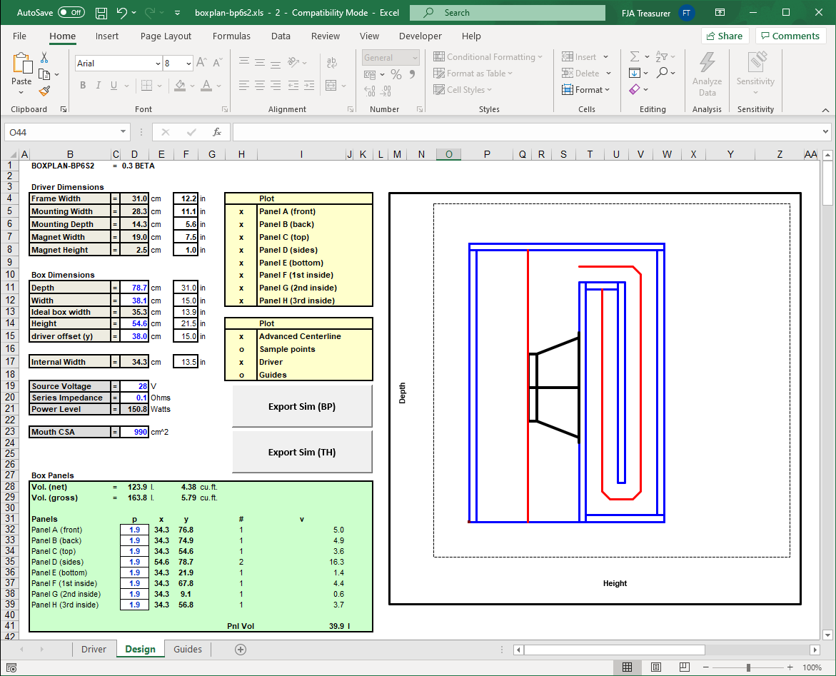

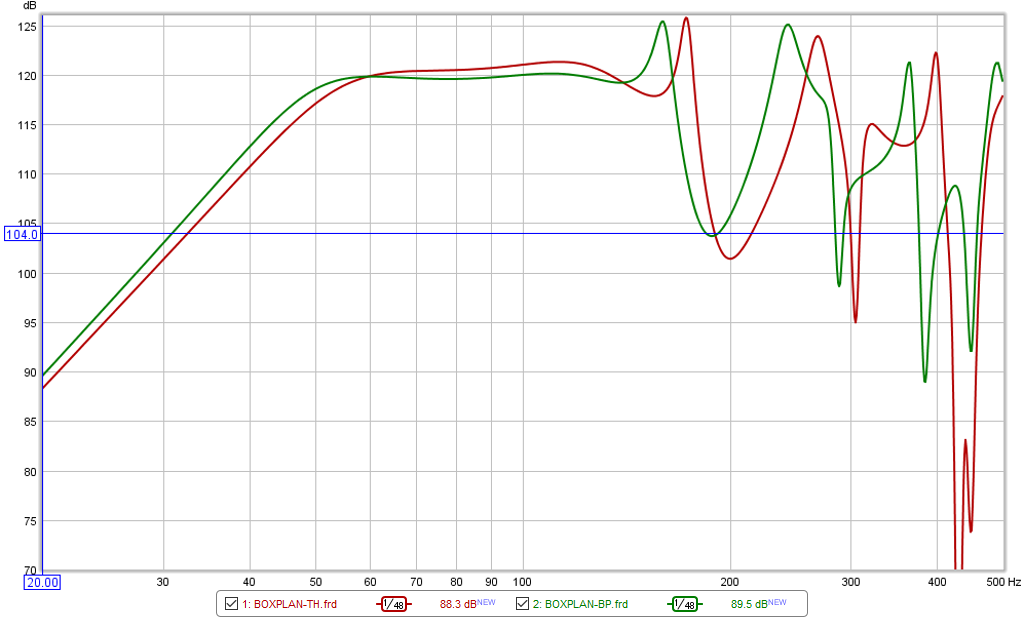

Another comparison that might be of interest - this time it's a design sim'd as a series-tuned BP system and then as a TH. The differences are not as pronounced as my last comparison, but they're still there. Fb in the BP sim is a few Hz lower than that of the TH sim.
So, which one is "more correct" 🙂
The workbook is BOXPLAN-BP6S2 v 0.3 beta, available from my site The Subwoofer DIY Page - Horn Folding

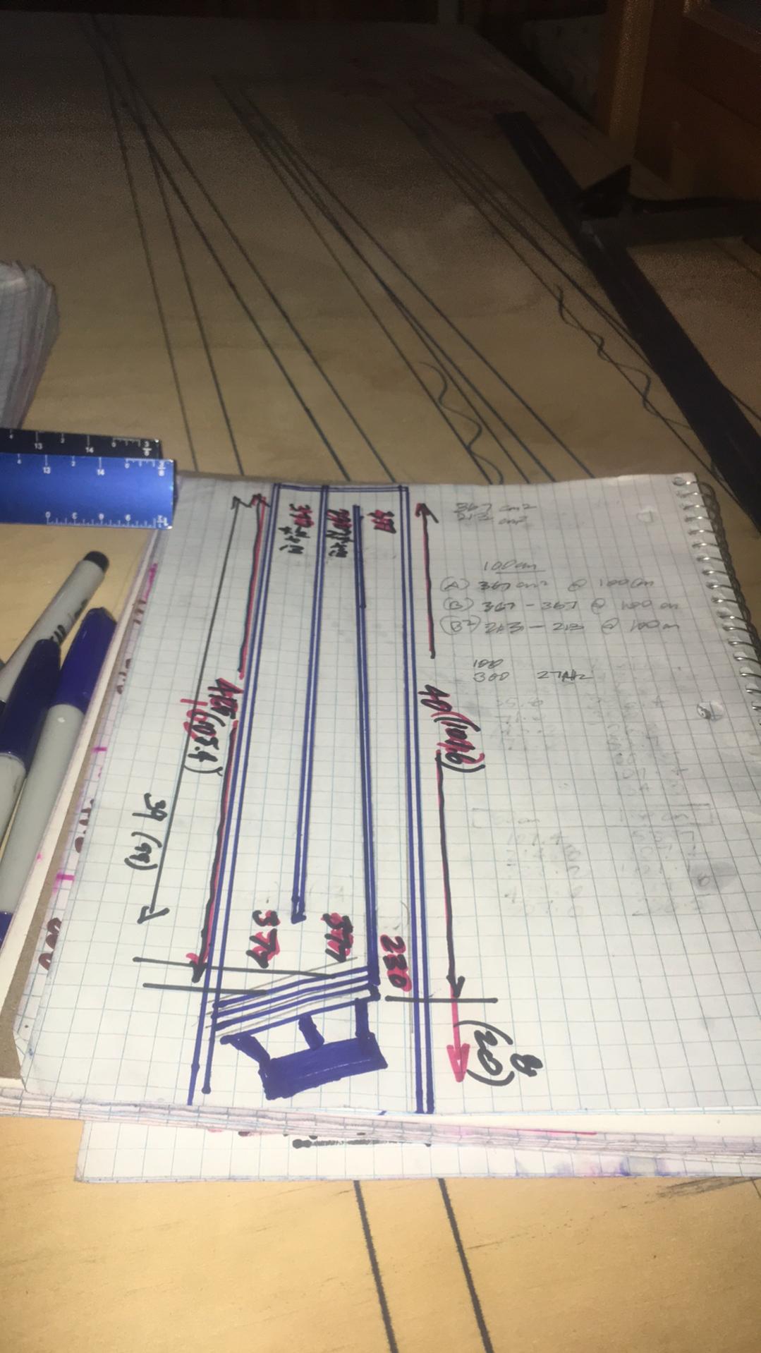

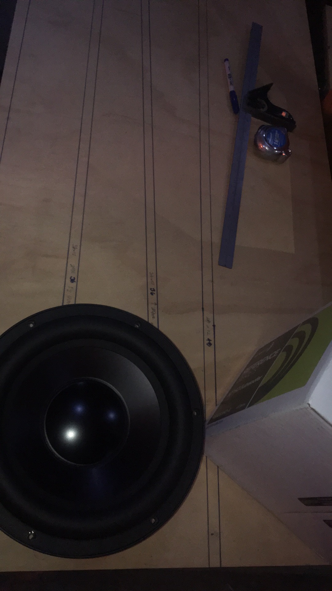

Heres a good one for the experimental people out there
?? .The folding not expressed entirely in this sim changes the top of bandwidth (ie: the Fb/3 ‘void’ is hard to distinguish, if even there at all?). Ill get a proper measurement for this shortly, but dropped the dats into a long vent on an awkward and heavy subwoofer. 🙁
Seems that void is remedied in this Or it can be exploited and become a ripple or bulge. in previous experiments i used 6 or 5 folds and the effect was questionable or lost in the excess of design chambers, port, etc. but this is pretty straight forward and even the offset is inside the useful assumption of the lengths and direct radiator/exit position is nearly zero.
Taking this further is tricky but i wonder if the offset driver position is the only tool In horn response that is representative of this affect? If tapped can be used to look (in sim) for techniques like this which arent otherwise seen because theyre specific to ‘folding’?

In your case everything is working as it should. If a change is made in the Loudspeaker Wizard and the Cancel button rather than the Save button is clicked to close the wizard, then any changes made in the wizard are not saved back to the main screen. Because no changes have been made to the main record, there is no need for the Save message to appear when Hornresp is closed.
If however the Save button rather than the Cancel button is clicked in the wizard, then the Save message should definitely appear when Hornresp is closed.

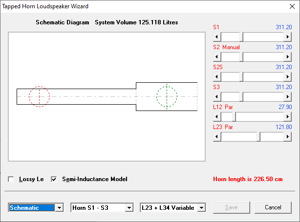

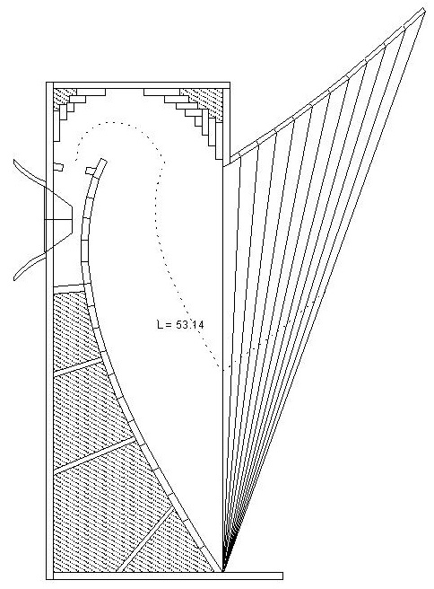

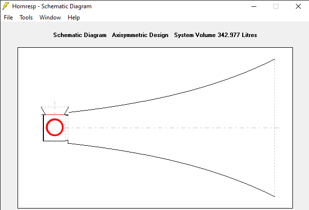

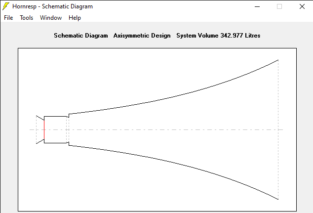

How to model compound horn w/offset
I'm working on a compound horn which has an offset driver horn as Horn 1, and a simple short exp horn as Horn 2. See the design image. Two questions...
1. I can specify the first schematic in Hornresp, but a more accurate depiction would be the second (photoshopped) schematic. Can this be modeled? Does it matter?
2. I'm modeling a with a full range driver (~6.5" diameter), but Hornresp always shows a rolloff above 1kHz--is that just because it's treated as a woofer, and I shouldn't worry about it?

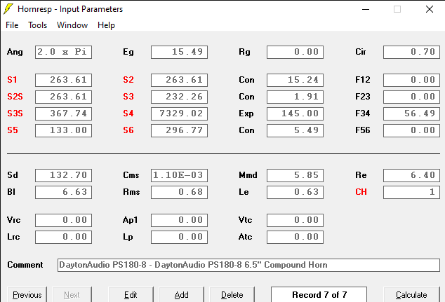

Not an expert here by any means as I am just learning my way through it, but could your roll-off be from not using semi-inductance in the driver parameters?
Learning my way through this too! And accordingly, I don't really know what you mean. Can you elaborate? Attached are the input parameters as presently set, awaiting an answer to Q1. Ignoring the horn parameters, you can see the driver parameters, if that helps.

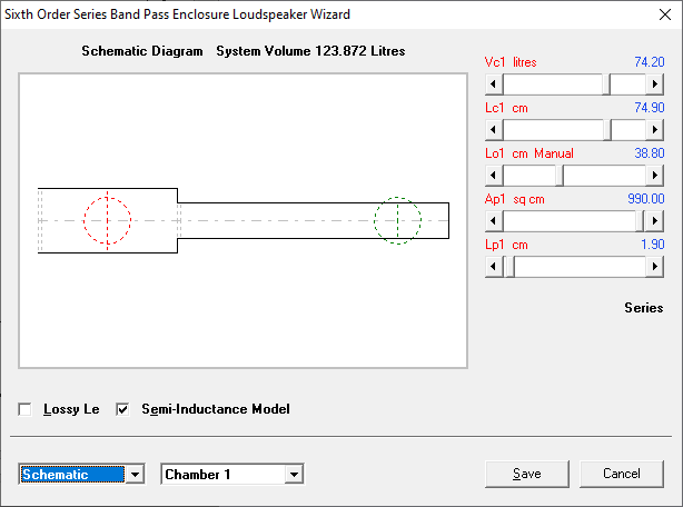

The Le parameter can be set with three different methods. First is just the Le number we get from the spec sheet or our DATs. Then if you double click on the Le icon, it will turn red meaning "lossy inductor". Then there is the more advanced semi-inductance parameters on data entry as Le is not linear in a speaker. ( Icon wil be green) GOOGLE semi-inductance.
Semi-Le_Calc: Calculator for Advanced Inductance Model Incorporating Semi-Inductance
I have not got it to work yet as I get a variable out of range error on import.
Thanks very much for this. Did some reading, downloaded the spreadsheet, and the manufacturer does actually provide the impedance data in an importable file. Loaded the parameters into Le (green), and the SPL did rise a bit above 1kHz, but still rolling off dramatically compared with the manufacturer's freq response. Still wondering...

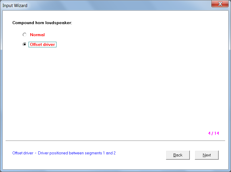

It can be modelled using the CH1 option, and it does matter. Use the Input Wizard to specify the required configuration.

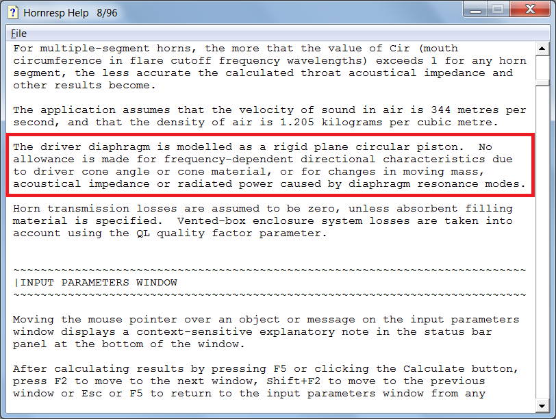

As indicate in the Help file, the driver diaphragm is modelled as a rigid plane circular piston. A full range driver will not be operating as a rigid piston at the higher frequencies.
The TH model is more correct because port tubes (and their associated end corrections) are not really applicable to the design being simulated.
If the physical dimensions are specified exactly the same for both systems (they are not all the same in your given examples) and the BP6S port tube end corrections are removed, then reassuringly, the results become identical, as shown in the attachments.
1hiep0 - my apologies, I had not read your post carefully enough. I missed the critical point that the change to S1 was made prior to opening the loudspeaker wizard, rather than by adjusting the slider in the wizard itself. You have indeed identified a problem.

#1 Manufactures specs are advertising
#2 Specs help you decide to buy. You need to measure for real. Prototype, measure and refine.
#3 look carefully as the graph and the vertical scale. It may not be rolling off as steep as it looks. What looks like a brick wall is only about 6 dB/octave
Now, if I could get the spreadsheet to accept my .zma file. Wondering it is the "+" signs.
Thank you! I have read that part of the documentation, just didn't understand its implications for an FR driver's SPL response, thanks.
