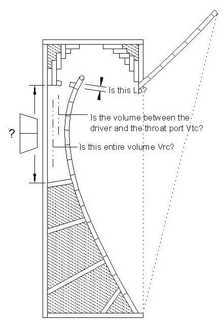

I'm new to loudspeaker design and to Hornresp. I have a reasonable handle on how to model the BLH design I'm developing, but I'm struggling with how to model elements of the coupling chamber. The design supports offsetting the driver location anywhere along the length of the chamber (See the image), but I'm confused about how to model that, as well as a few other terms. Given a driver offset in a throat/coupling chamber, does Vrc - Vtc = the offset? Is Lp simply the thickness of the plywood in the throat port in the attached image?
Basically, any advice in how to go about modeling this is most appreciated.
Thanks in advance!

Forgive my ignorance: What's Zd? Not seeing it in the hornresp help or the MJ King horn physics papers. And what do you mean by "slug"?
The smoothness wasn't for pretty, it was to maintain an exponentially expanding cross-section. Are you saying that's counter-productive? The woodworking for that is easy for me--that's my domain.

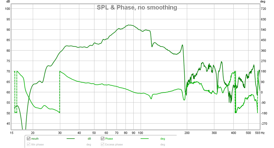

And measurement 0cm from mouth:

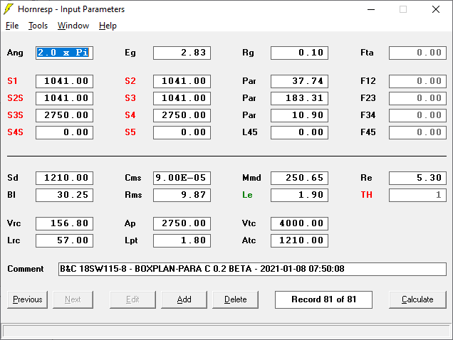

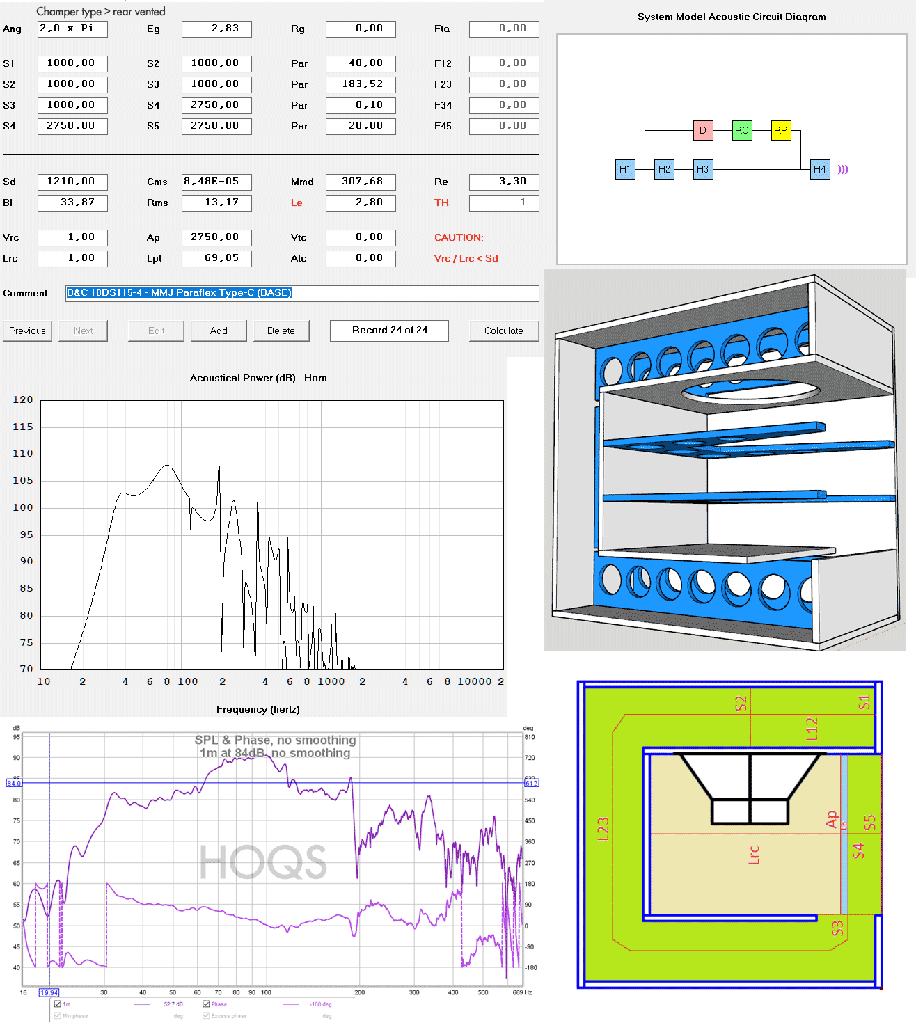

Interestingly enough that sim is a little bit off. The box is a 36" x 24" x 36" box, and the Hornresp sim gives a net box volume that's 9% larger than the actual net box volume once you calculate the gross volume and subtract the volume occupied by the panels.
The BOXPLAN workbook generates a sim with a net box volume that's a lot closer to the calculated net box volume. Even then, there are some curious things happening, as the measured Fb for that build seems to be quite a bit lower than predicted by the sim - it's almost like the box is slightly larger or deeper.

This is partly due to internal end corrections in the BP6P simulation model increasing the effective lengths of the port tubes. Other differences in the results are due to the basic system models / topologies not being exactly the same.
Thanks for this David.
I was working from the premise that if the physical topology of the box as described in both models is close, then the results predicted by both models should also be close. It looks like in this case the TH model for the layout generates results that are pretty close to the measured results, but the BP6P model generates results that show a noticeable "null" in the usable passband that does not appear in the measured response of the built system.
I'm going to repeat this exercise this weekend with the BOXPLAN-BP62 that I used to describe a series-tuned 6th order BP fold. It should be possible to generate a Hornresp TH model for that instead that's an exact topological match to the one described by the existing BP6S model being generated by the workbook. If the two models end up predicting appreciably different results, I may just have to build the thing and measure it, to see which Hornresp model gave the more accurate prediction 🙂.

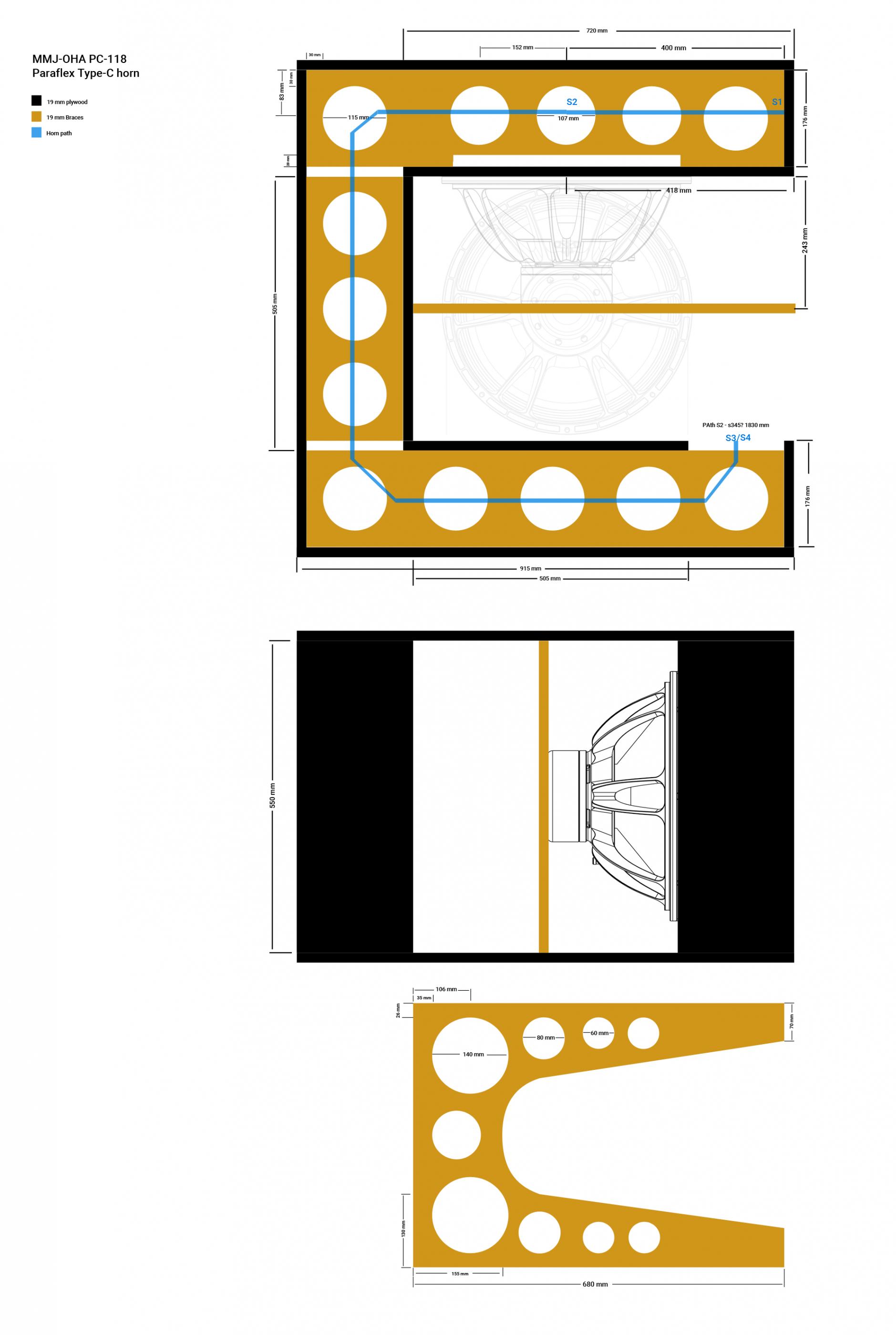

Brian, here is the design what has been build from the sim.
Yeah, the sim was definitely off then.
Look at the mouth - the dimensions are 550 mm x (243x2) mm That gives a CSA of 2673 cm^2 for S4, not 2750 cm^2. Seeing the size of the chamber of this CSA in the box, that should impact the sim a bit.
Also, if the mouth is 550 mm wide, there's no way the box itself is 24" wide unless they used double-thick side panels. 55+(1.9*2))= 58.8 cm = 23.1 ".
If I have a chance later I'd post up another updated sim, but you can see what it's going to be like if you download the BOXPLAN-PARAC workbook and input the external dimensions, panel thickness and correct value for S4 that was actually used for the build.

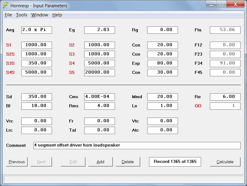

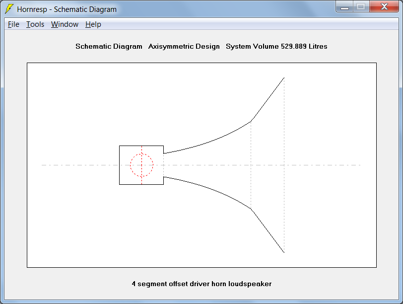

Does the attached design (not to scale) perhaps go some way towards meeting your requirements?
Yes! That's it. Thank you, David. It'll actually be a little simpler, since the horn-part itself is a single exponential segment, although the aspect ratio of the rectangular cross section slowly changes closer to square on the "external" part of the horn behind the main cabinet.

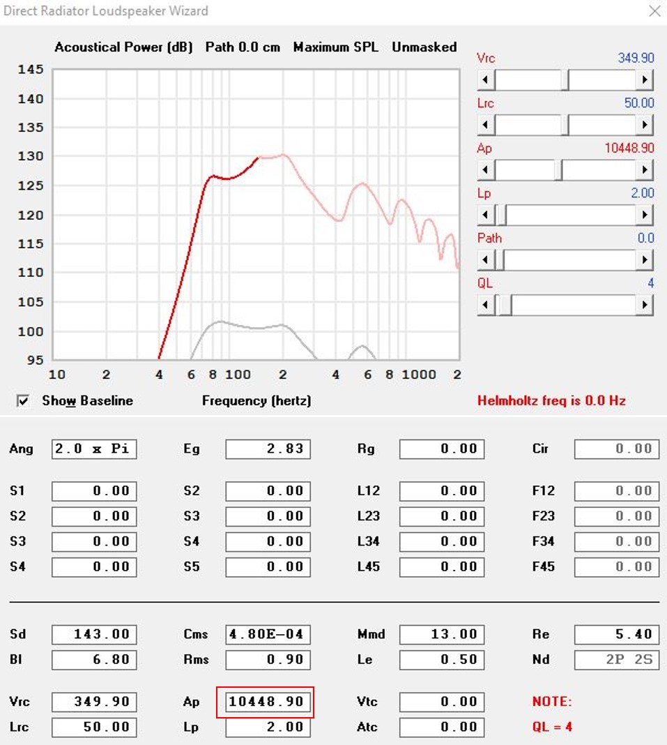

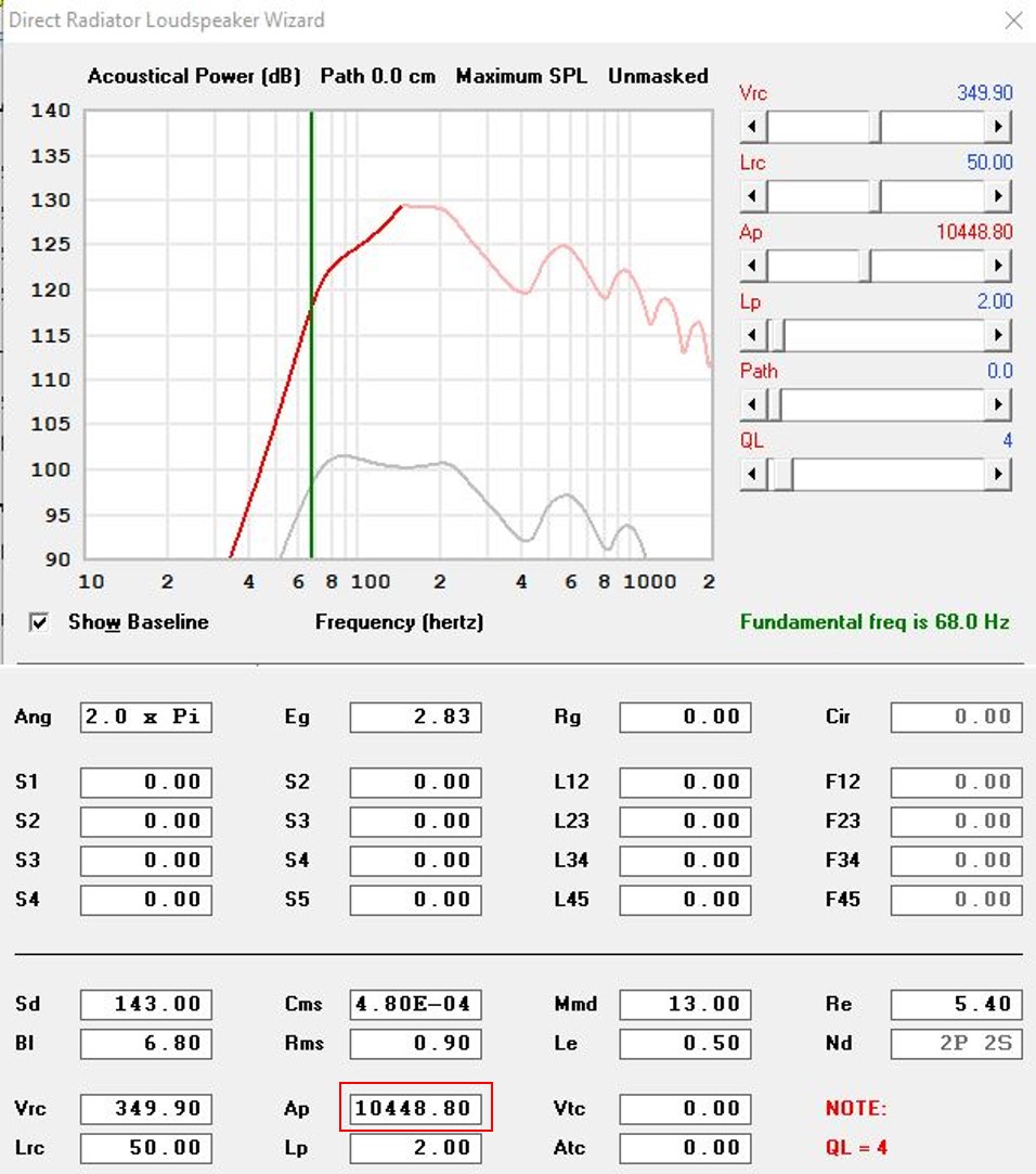

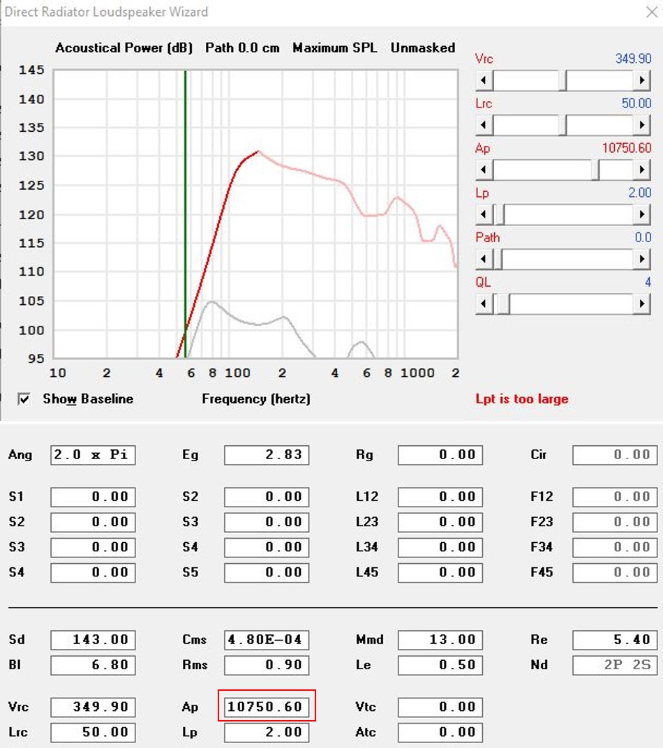

Bug in calculating resonance-2?
Hello David,
I was playing with a BR model, with impedance and resonance, I noticed that the resonance frequency was varying drastically within a narrow range of values. Is this a bug or implicit to the model and assumptions used.

The acoustic circuits are a bit different, but in terms of topology the models are pretty close, so I expected the sim results to be pretty close. However the BP sim puts a pretty big dip in the middle of the passband that does not show up in the TH sim.
FWIW, measurements show that the TH sim is the more accurate one, even though it doesn't take the impact of the offset driver in Vrc into consideration.
I've attached a diagram showing how the sims were created. Yes, I moved the vent a little - I didn't expect moving it from the edge of the mouth to just outside the mouth would make such a big difference in the middle of the passband. I guess it would be more accurate to model it as a series-tuned 6th order system, but Hornresp doesn't provide a means to model an offset rear vent.
