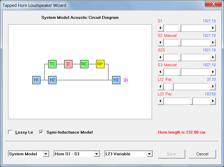

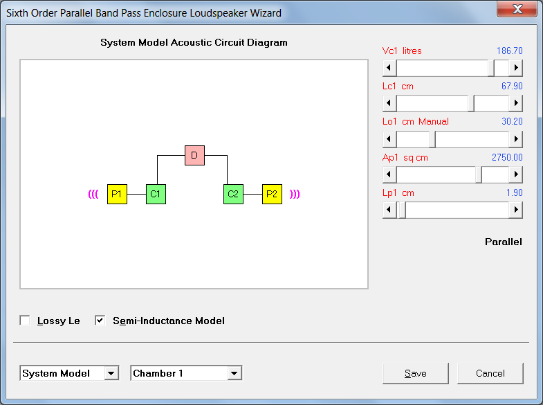

That's because the two systems are different 🙂.

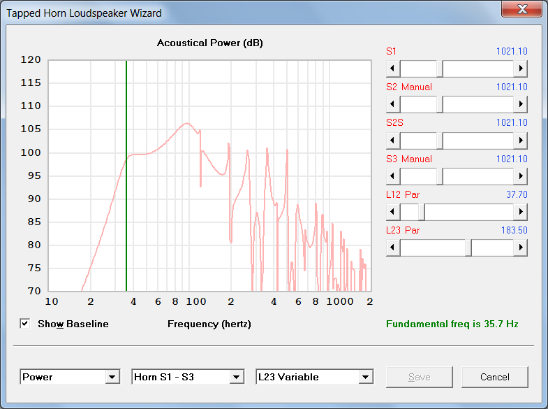

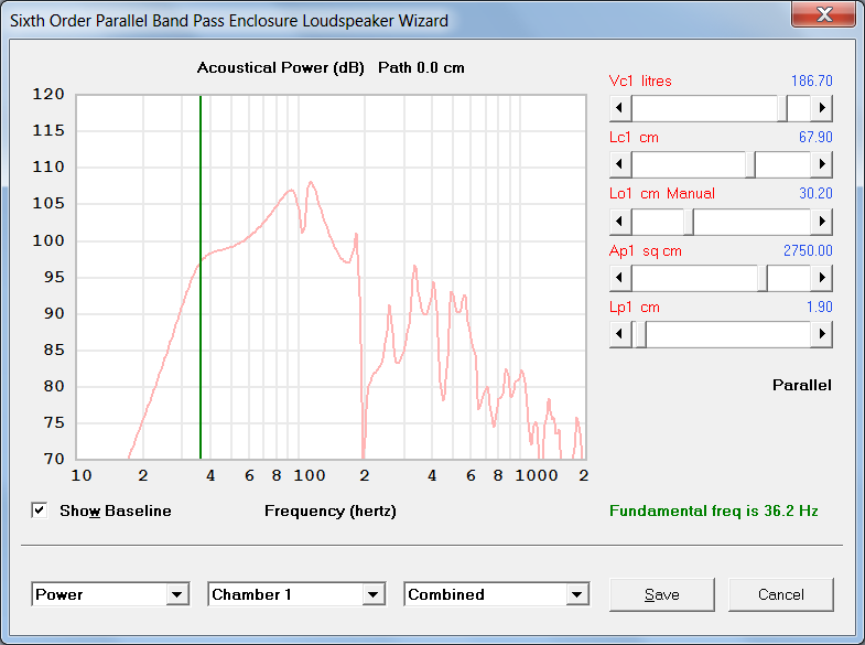

Try comparing the acoustic circuit diagrams - the one for BP6P is attached.

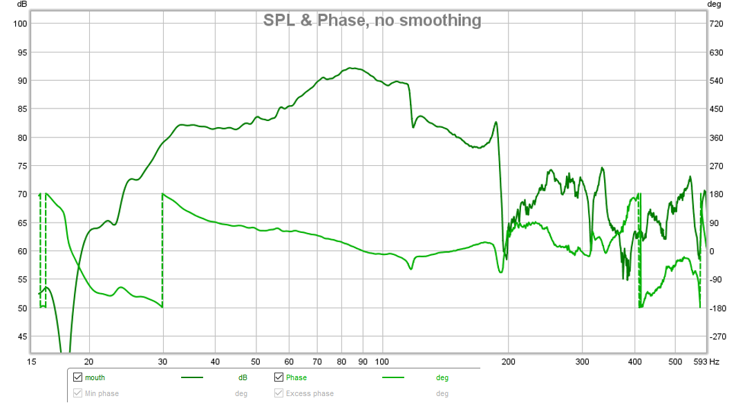

The acoustic circuits are a bit different, but in terms of topology the models are pretty close, so I expected the sim results to be pretty close. However the BP sim puts a pretty big dip in the middle of the passband that does not show up in the TH sim.
FWIW, measurements show that the TH sim is the more accurate one, even though it doesn't take the impact of the offset driver in Vrc into consideration.

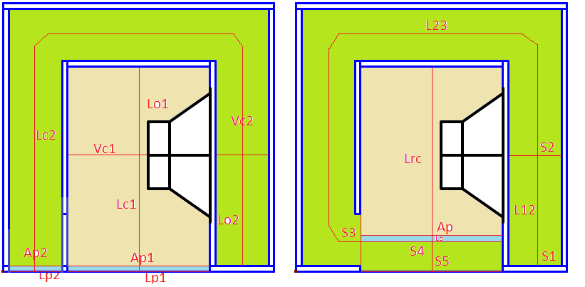

I've attached a diagram showing how the sims were created. Yes, I moved the vent a little - I didn't expect moving it from the edge of the mouth to just outside the mouth would make such a big difference in the middle of the passband. I guess it would be more accurate to model it as a series-tuned 6th order system, but Hornresp doesn't provide a means to model an offset rear vent.

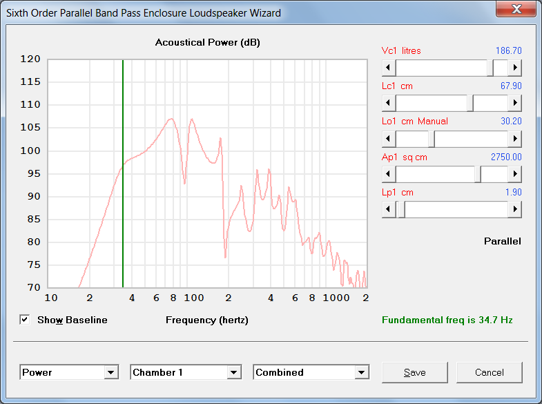

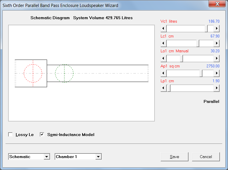

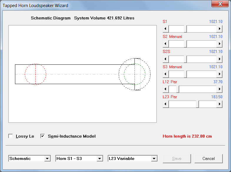

This is partly due to internal end corrections in the BP6P simulation model increasing the effective lengths of the port tubes. Other differences in the results are due to the basic system models / topologies not being exactly the same.
Attachment 1 shows the TH response.
Attachment 2 shows the BP6P response.
Attachment 3 shows the BP6P response with port tube internal end corrections removed.
Attachment 4 shows the TH acoustic model.
Attachment 5 shows the BP6P acoustic model.
Attachment 6 shows the TH schematic diagram.
Attachment 7 shows the BP6P schematic diagram.

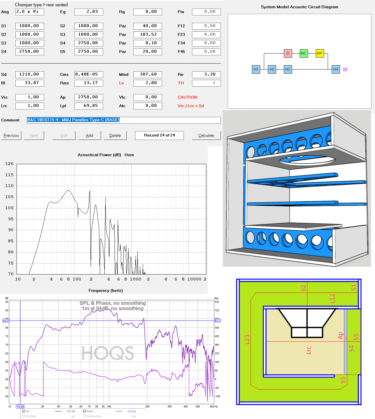

When TH mode in engaged a few things change. it seems to be the activity between taps is given a much greater value in its affect on response. But as L45 grows longer it suddenly is ‘compound’ Horn in its reaction (similar maybe))and also if that is used in a rear vented chamber instead it is some similar action but if you look at unwrapped phase theres a really neat thing occuring and the added length of an otherwise tapped horn with these extras is staggered at harmonics til 100x over and over the cycle.
while im Used to what occurs mostly, as the same driver consistently, is there a fraction or multiplier engaged to the parts of OD, thats then a back wave for TH also? A guideline or similar to grab a firm understanding of probably the most interesting and challenging horn layout and creation if i was trying to pick to date (ME still left).
