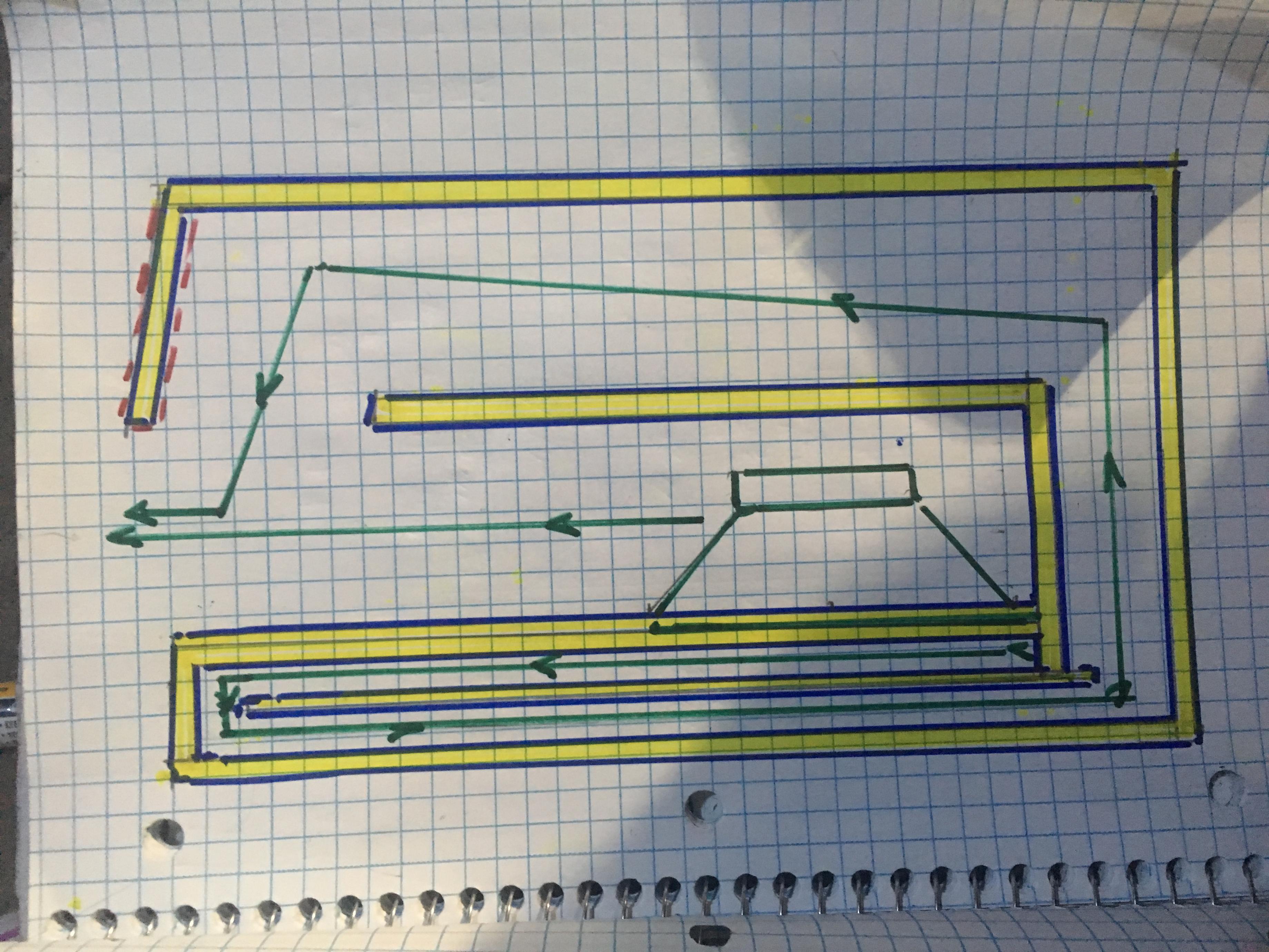

Well darnit! We need to get you an old laptop 🙂 damping by csa? Or stuffing? I prefer to try and get it as well as i can to stsrt (no stuffing) but this rabbitt hole is in segments of 3 not being shown. 3/6/9/12 it adds up. Folding, predictable folding.
Whats missing can be guessed if within the confines of of somesort of pattern?
—so guys like me can bug you with questions, haaa!
I have a Windoz boz. MacPro with Windoz. It is a terrible OS. I do not willomgly use it.
dave
theres something here to see. its worth it! This thing im speaking of is repetative but not shown is the part i dont understand or could measure very well to show. i think its the folding and that makes phase sense. But im failing to describe this and even if its details blur, the fact remains theres a pattrn in folding to assume if setting up thst layout for it. Offset driver folded is missing a detail we can see again at a doubled down on in tapped horn? Still not shown but divide thru it and its offset
4 segments split by the flipping phase each. Fold or driver entry or exit? I dunno, but it can be seen as the pattern continues in many ways

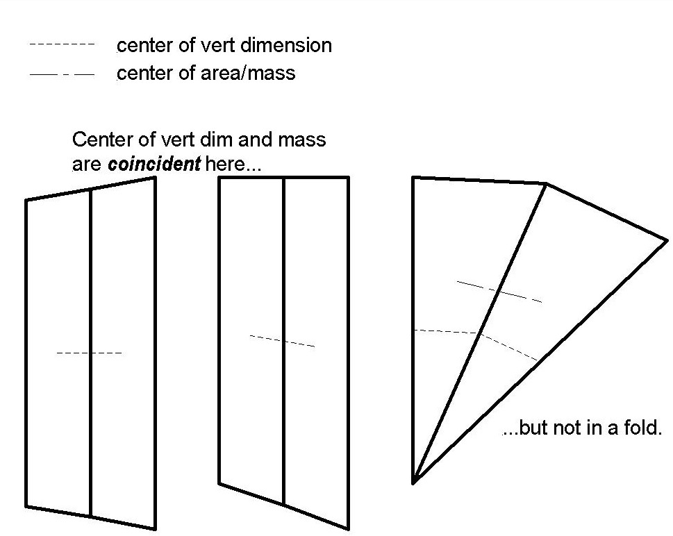

Axial path in a fold follows center of mass?
The (exponential) horn data export from hornresp can be used to create a sequence of vertical dimension "ribs" given a fixed width. My intuition is that axial path follows the the center of mass. Is that correct?
In an unfolded horn, for each adjacent slice of volume (see the image attached, where all three figures have the same area), the center of the vertical dimension and the center of mass are coincident, even if the design top-aligns the ribs against a panel, for example. But around a fold, the path following the center of mass is substantially longer than a path defined by the center of the vert dimension.
So, if true, after a horn is folded, I should measure the center-of-mass path and re-model the horn, which now has the same throat and mouth area, but a materially greater length, right?

Okay, so instead use red ‘s’ and constant CSA in each. And create the idea in portions? i hope i dont confuse the idea, but im thinning the variables or removing potential blurr from a simpler observation point?
But put that horn on jupiter and what frequency? inthink theres a funny ‘mass’ issue to see what about the centifugal course that mass loads in a turn? its ellipse not a circle of mass through a turn. Theres an orbit briefly.
a gas through a manifold maybe...
but use steps instead and apply that in segments? Even better, full wave versions of qw segments.
Take it out to a middle to see the center. why is 1/3 offset 2/3 remaining a thing? And is it the same as folded segments of 3’s endfired?
taped horn entry centered in two single fold pipes? What do we expect to see? Ignoring the heat and losses elsewhere. What is phase or impedance intervals of it?

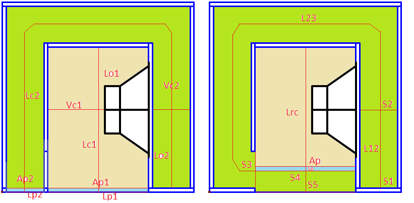

Brian, can you clarify which one is BP and which is TH? And what are these shorthand for? Bandpass and ... or something else?
The one on the left is how I tried to sim it using a Hornresp BP6P (6th Order Parallel-Tuned Bandpass) sim. The one on the right is how I tried to sim the same enclosure using a Hornresp TH (Tapped Horn) sim. The measured results suggest that the TH sim is more accurate.
Both sims contain a few compromises. For the BP6P one, the sim assumes that the vent exits the front of the enclosure, not at the end of the mouth as pictured. For the TH one, the sim does not include the impact of the driver offset in the chamber (the sim assumes that the driver is located at the rear of the chamber Vrc, not at the side.

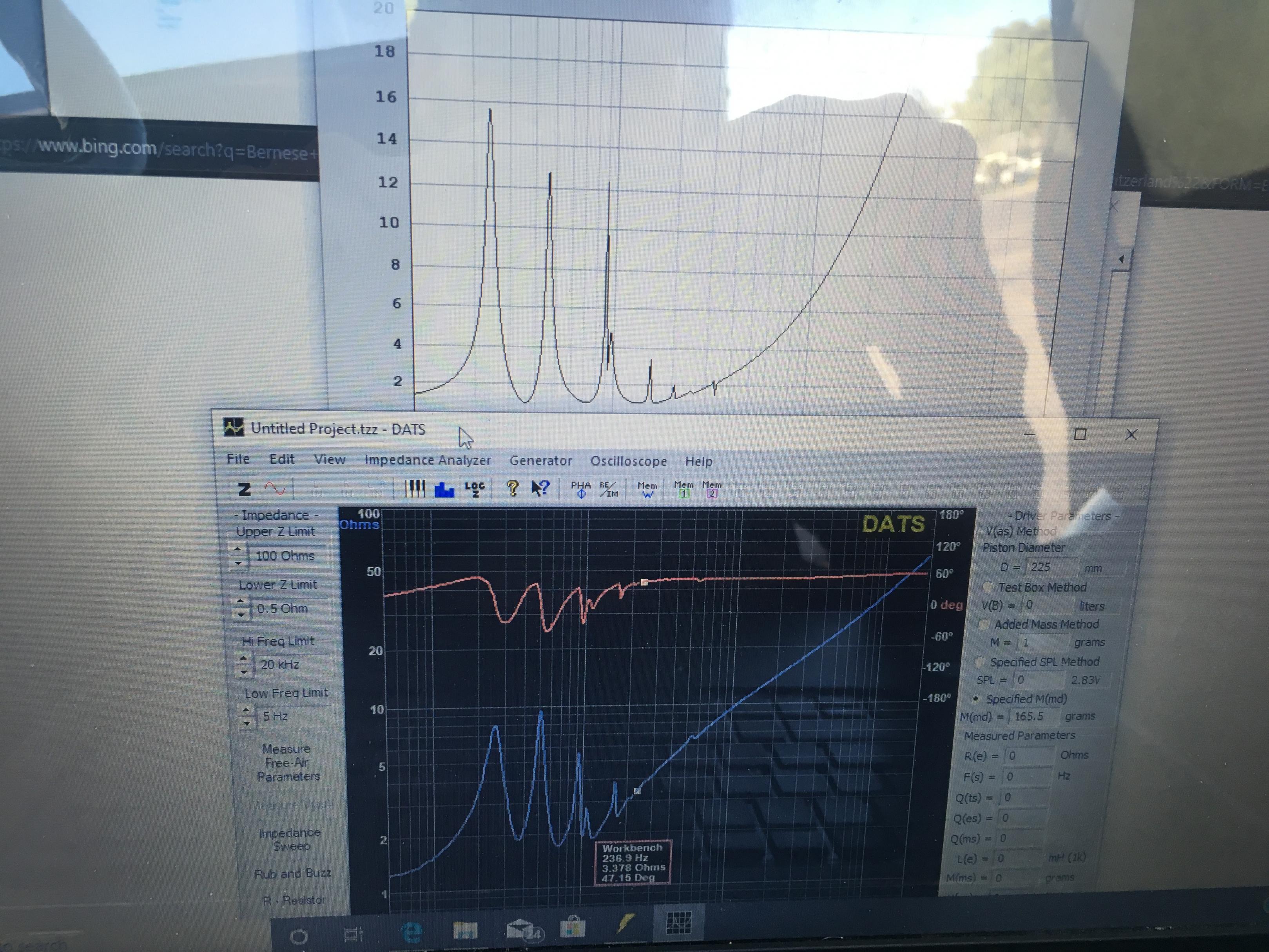

I am quite surprised that the predicted and measured results are as close as they are, considering the differences between the simulation model and the actual loudspeaker design.
If its a measure of your success with Hornresp and if it makes you appreciate things on your end as feedback:
Sketch is the shape of the layout, not to scale but to show character of the real and simmed impedance plots. 80 cm, 120cm and 240cm are kindof the general grouping and then theres 214 hz, and marks all over accordingly.. 430, 145, 180, 72, 36,etc... hard to see but wow
whatever is going on, it seems to be going on pretty good (accurate software results) In fact, this is an easy one. the folding is rather (evenly dispersed, sketch not to scale). Still trying to master the folding results if using some thing that is ‘different’ that pieces of the fundamental in segment lengths within the ‘Zd’ . Or guessing at the results of them being precisely at harmonic intervals or close?

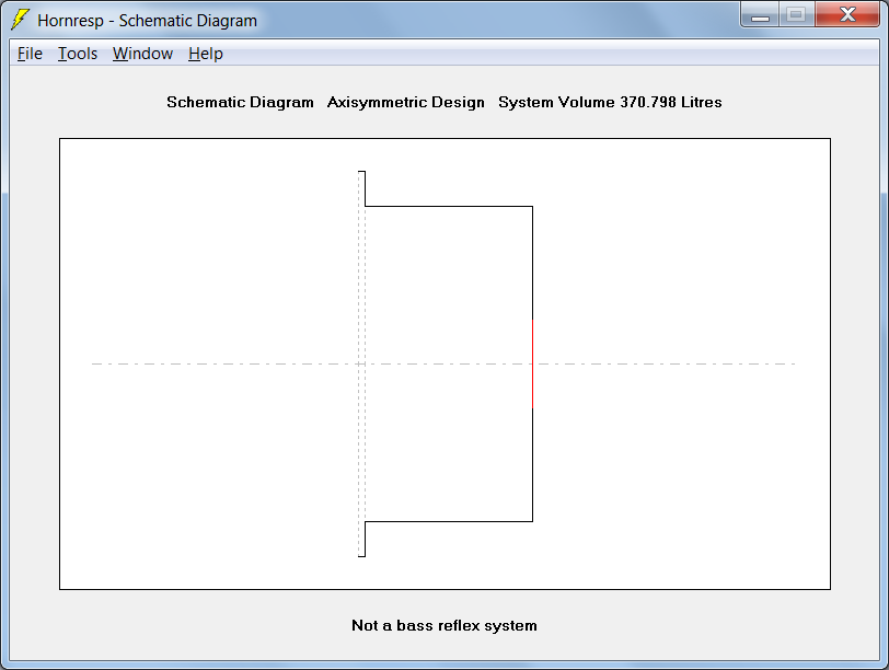

Is this a bug or implicit to the model and assumptions used.
You are really "pushing the envelope" with this one... 🙂.
The Hornresp bass reflex simulation model assumes that the inputs will be realistic and practical. In your example the port tube dimensions are such that the system is not really acting as a Helmholtz resonator, and the status messages produced may therefore become unpredictable as a result.
There are limits on just how far Hornresp models can be pushed, and for the results to remain valid. It is simply not possible to have checks in place for all the input values that users may choose to use.
GIGO - Garbage in, garbage out...
