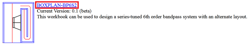

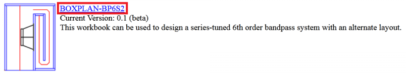

1. Go to my sheets site, and download the BOXPLAN-BP6S2 workbook
Hi Brian,
I cannot download the BOXPLAN-BP6S2 workbook for some reason. Clicking on the link (highlighted in the attachment) simply takes me back to your Home Page.
Kind regards,
David
Fixed... 🙂
That's better 🙂.
2. Open the BOXPLAN workbook and on the "Design" sheet, set target S4 to 900 cm^2 and select "Export!"
There is no S4 - do you perhaps mean Ap1?
I have now found the problem, Brian - it will be fixed in the next update, hopefully to be released on Friday. Thanks for the feedback.

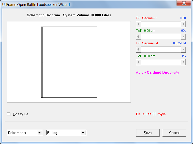

Is it feasible to allow for porous walls, in order to model cadioids such as these models from kimmosaunisto?
Hi Giri,
The system shown in Attachment 1 can be simulated in Hornresp.
The model should be specified as documented in the red highlighted section of Attachment 2.
The other three systems cannot be simulated in Hornresp.

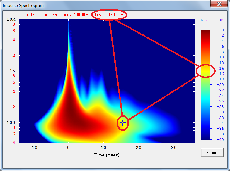

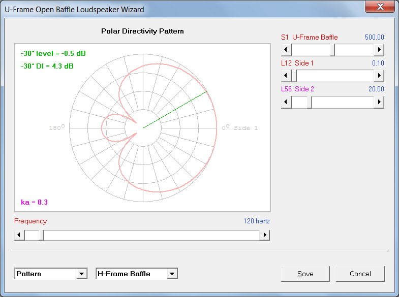

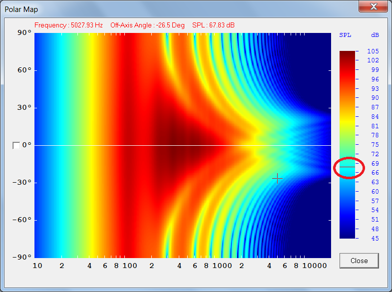

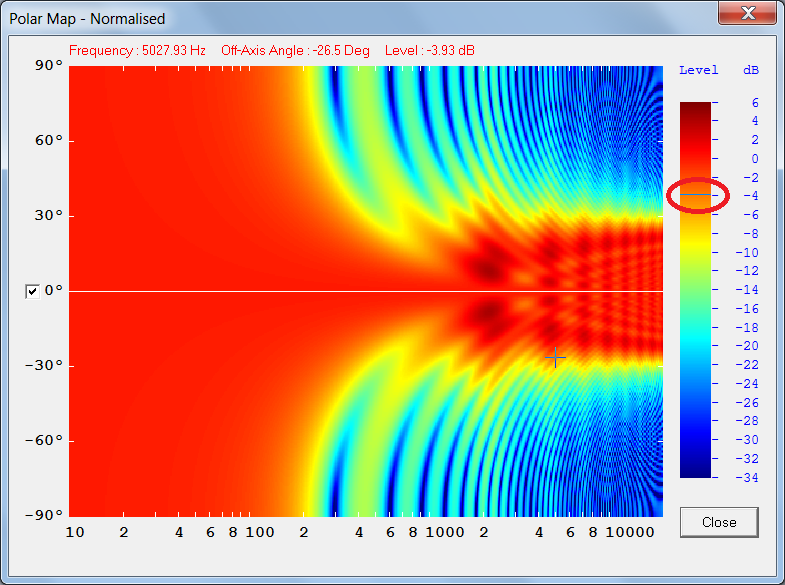

The decibel scales on the Impulse Spectrogram and Polar Map now have a marker line showing the sampled level. Attachments 1 to 3 refer.

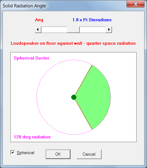

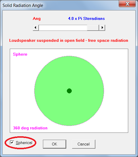

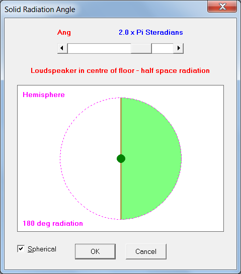

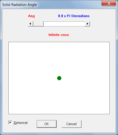

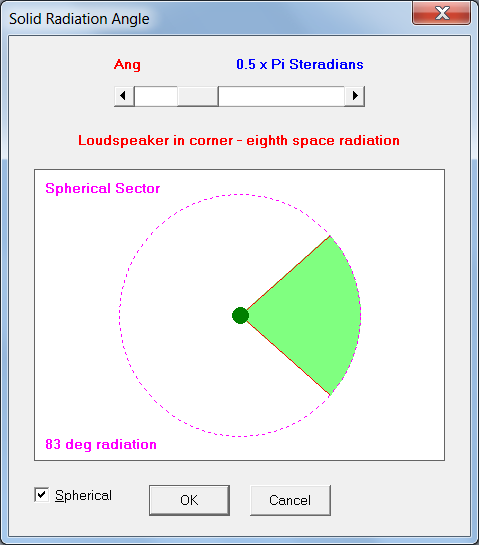

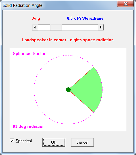

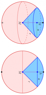

The Solid Radiation Angle input form now has a Spherical option which shows the loudspeaker radiating into a sphere, hemisphere or spherical sector. The radiation angle is given in degrees. Attachments 4 to 8 refer.

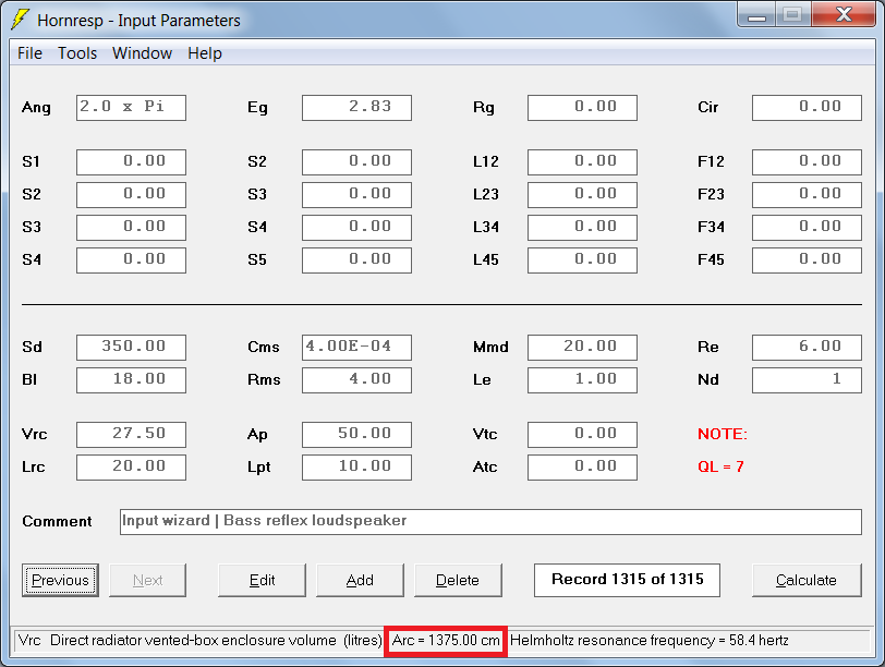

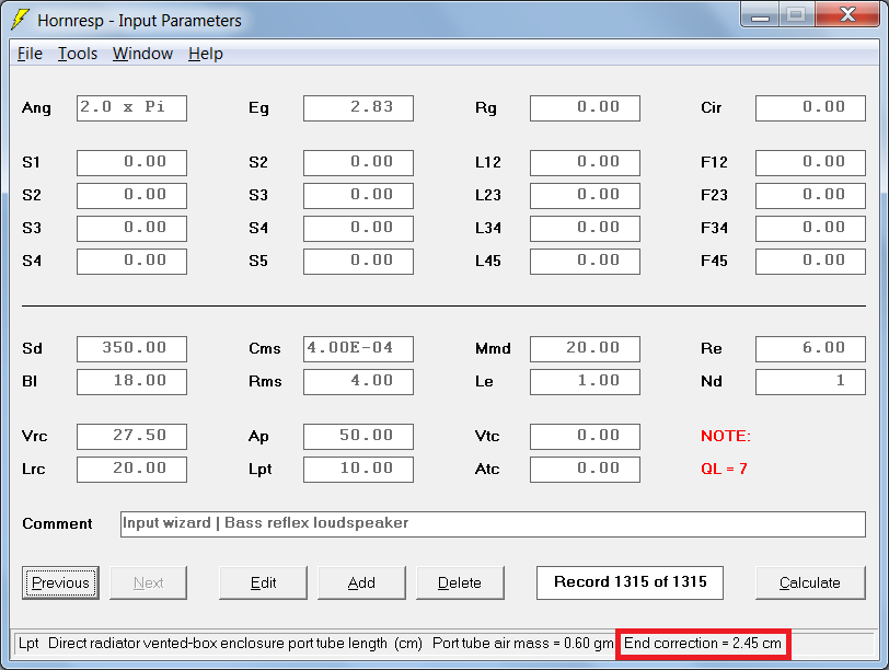

When the mouse pointer is moved over the Vrc or Lrc label or input box, the cross-sectional area Arc of the rear chamber is now shown in the status bar panel at the bottom of the Input Parameters window. Attachment 9 refers.
CHANGE 4
When the mouse pointer is moved over the Lpt label or input box in a bass reflex system, the internal port tube end correction value used when calculating the results is now shown in the status bar panel at the bottom of the Input Parameters window. Attachment 10 refers.

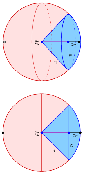

The radiation as sphere???
Would this be a way of anticipating a ‘sum’ of folding increments if using 90/180/270/360 as phase per a sine wave vs frequency in the folding a tapped horn? I should probably admit to not looking at some of these things in more detail, but:
As in: driver entry 120cm fold 120 cm driver entry 120cm
Fold 120 cm exit. the result is the sine wave and half and quarter of the fundamental and harmonics. We trip on this because 80 sneaks in for an offset driver and at either end of 240cm offset or 320 compound.
But 480/360/240/120 is 90 at driver, 180 at tap and exit if zero o
Is aligned with 360. Which is CSA increments and TS parameters poking around with end corrections and things we must accept... but try yo be oerfect in pgase and the result is least imperfect once its phase aligned?
Hoping you have a happy and healthy 2021.
Thanks Mark, and you also.

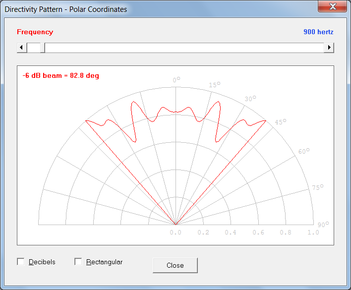

It's just another way of representing the solid radiation angle, and hopefully helps to make clear why the beam width of the directivity pattern in 0.5 Pi space, for example, is confined to 83 degrees as shown in Attachment 1.
Attachment 2 shows the radiation from a point source in a corner. The surface area of the radiating wavefront will be 0.5 x Pi m^2 when r, the distance from the source, is 1 metre.
When the included angle at the apex of the spherical sector shown in Attachments 3 and 4 is 83 degrees (to the nearest whole number) then the area of the spherical cap at a radius of 1 metre will also be 0.5 x Pi m^2.

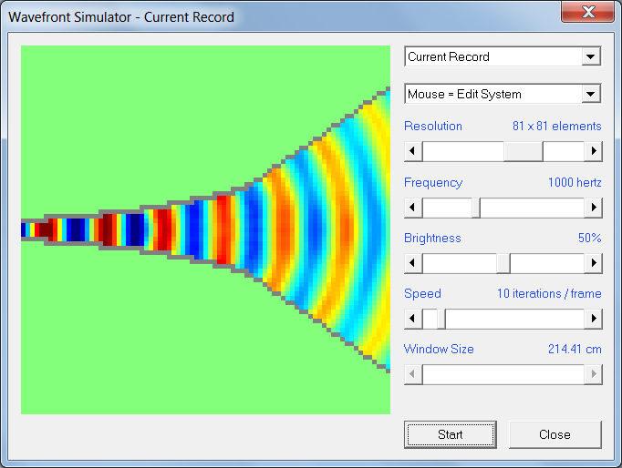

Thanks for the spherical radiation representation. I've been waiting for something like this for a long time. Is the change going to reflect in the waveform simulator as well?
No, the Wavefront Simulator does not take the solid radiation angle into account.
I guess the appropriate boundaries could always be added manually by the user if required, as shown in the attachment.
