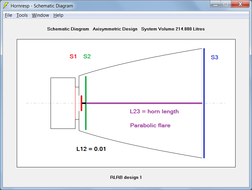

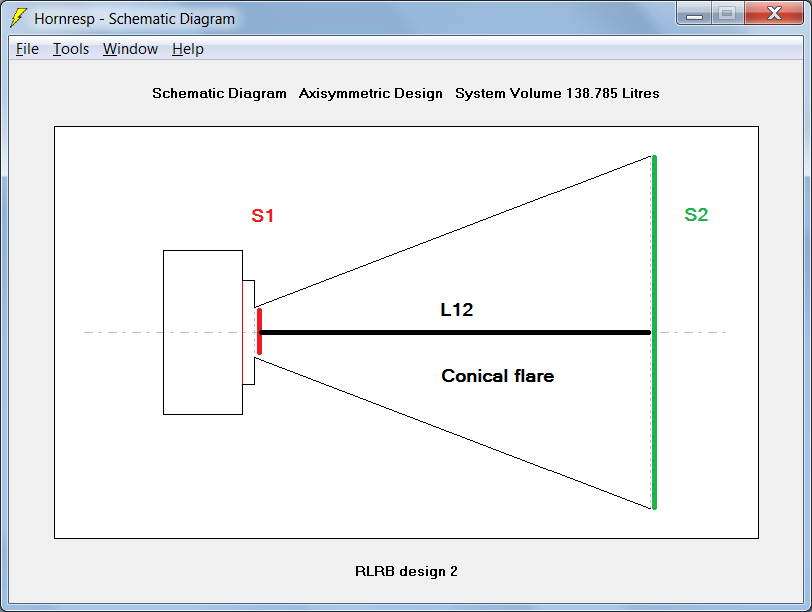

Hello,
i want to ask a question, i have a bass horn designed.
The horn only has conical the sides, papalell to ground is horizontal.
In this case S1 wont be the hole in front of the driver and would be the width of the hole in all the height of the mouth, is this true?
in pdf i sent you can view 2 solutions, one has much more work.
i need the upper surface plain in order to move my midhorns. Or do a bigger chamber to position and even rotate (aim) the oris horns
i can send the plans and hornresp file in case someone wants to help
thanks

Hi RLRB,
Simulate your first (top) design as shown the first attachment (not to scale).
Simulate your second (bottom) design as shown in the second attachment (not to scale).
Just to clarify, S2 = width of S1 throat area * height of S3 mouth area
