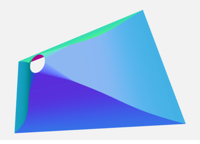

Thanks for posting the link, BP1Fanatic. It is quite a neat tool - very easy to use 🙂.
Thanks for sharing ! It's really nice to play with ! But it doesn't gives result 3D files
But it doesn't gives result 3D files![]()
No, but at least the horn image can be rotated by holding down the left mouse button and dragging the mouse, or be changed in size using the mouse scroll wheel 🙂.
Yes but for >10khz subtil geometry change grives such a difference, it's a least really educative
