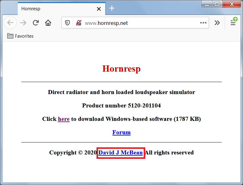

David, can you email me about using Hornresp in a commercial aspect? I'm considering selling designs.
the grinch become kind at the end
True, but the McGrinch doesn't - even after being trapped in a re-entrant trap 🙂.
Hi Etocynned,
Not a problem, you can use Hornresp any way that you would like to. Thanks for taking the trouble to check with me first, though. I know of a number of businesses who are using Hornresp to simulate / design loudspeakers that they sell commercially, but have not bothered to ask me if it is okay for them to do so 🙂.
If you still wish to send me an email, simply click on my name on the Hornresp download page, as shown in the attachment.
Kind regards,
David

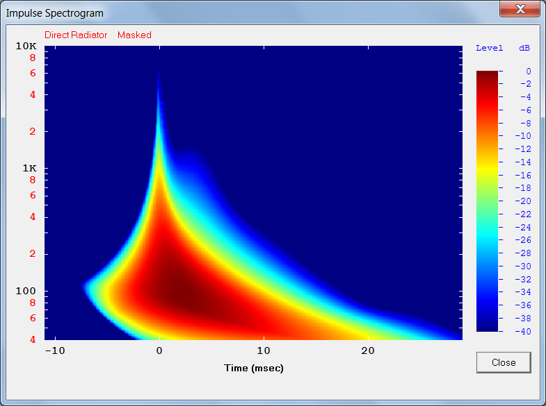

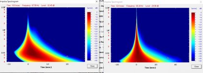

David and friends, I have a question about interpreting the impulse spectrogram. The attached screen capture is a comparison of two 12" subwoofers in a 85 liter box. What causes the one on the left to have a rightward tilt at low frequencies? Is this group delay or a slower rise time? Thanks.
What’s the most interesting or curiously complex speaker designed and simulated using Horn Response?
The most complicated Hornresp simulation model mathematically, is the one used to analyse three-way multiple entry horns. It solves 14 simultaneous equations to find the values of 14 unknown complex variables having both real and imaginary components.
Your guess is as good as mine 🙂.

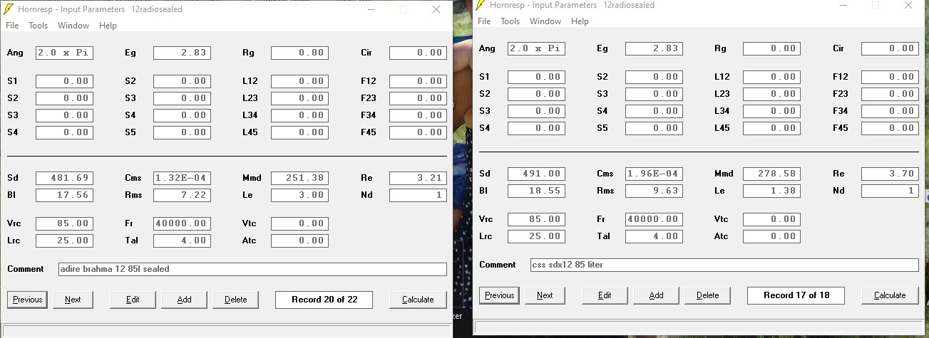

Posting the input parameter values for the two systems would perhaps help people to identify the reason and provide an answer your question.
basically just two long throw sealed 12" subwoofers.
Just wondering what can be learned by the dark red trailing off to the lower right on the left picture. Is this a slow rise time or a slow decay? The impulse spectrum is basically a top view of a CSD correct?

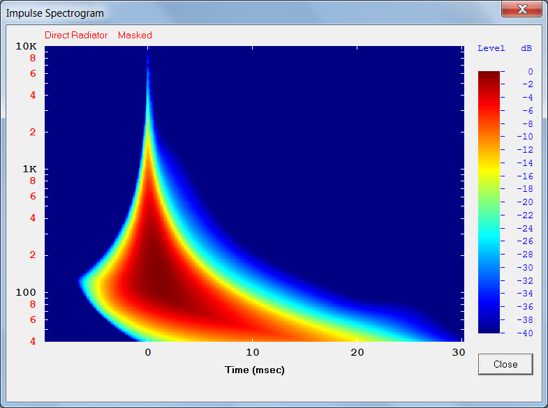

Allowing for the small offset in time scales, the impulse spectrogram results for your two given examples would appear to be quite similar (see attachments).
The impulse spectrogram algorithm used in Hornresp was developed by Jean-Michel Le Cléac'h. He very kindly made his MATLAB code available to me because he believed that the spectrogram feature would prove to be a useful addition to Hornresp. I simply converted his code to Visual Basic for inclusion in Hornresp, making sure that I could replicate the results that he was getting. His algorithm is very elegant, but complex enough that I never really understood the theory behind it or how to fully interpret the results it produces. Jean-Michel was exceptionally gifted when it came to developing such things and I trusted his work completely. If he was still with us he would no doubt be able to answer your question immediately.
I have been assuming that people far more knowledgeable than myself on such matters, and ideally with practical experience, would know how to interpret the impulse spectrogram results and would be able to respond to your questions far more competently than I can.
The impulse spectrogram is in effect a "top view" 2-D representation of the equivalent 3-D waterfall plot.

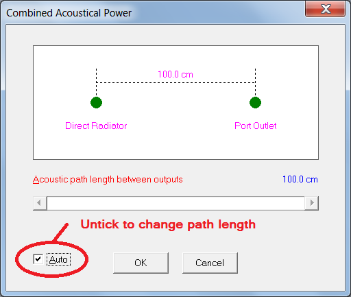

Hornresp Update 5120-201115
Hi Everyone,
CHANGE
Previously the acoustic path length for a system with an offset driver and offset port or passive radiator was calculated automatically and could not be altered. The length value can now be changed manually if required, as shown in the attachments.
Posts #11293 and #11300 refer.
Kind regards,
David
I think this is a sort of wavelet analysis, there's a thread on that here: Help on making MULTIRESOLUTION WAVELET ANALYSIS available ? and an interesting piece of software for Gnu Octave was developed by DIYaudio member Elias. His website may have some useful info: http://elias.altervista.org/html/Easy_Start_on_Wavelets.html
