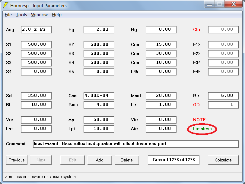

Hornresp Update 5120-201104
Hi Everyone,

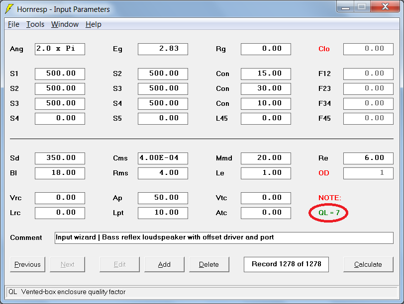

CHANGE 1
The system loss QL parameter value was inadvertently being taken into account when simulating a horn loaded bass reflex system. The parameter now only applies to direct radiator bass reflex systems, as originally intended.
My thanks to Phonetik for making me aware of this issue.
CHANGE 2

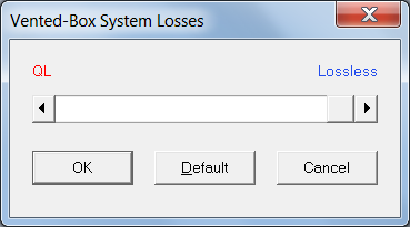

Previously the QL parameter value could only be changed using the slider control in the Chamber section of the Loudspeaker Wizard. The value can now also be changed from the input parameters window by double-clicking on the QL / Lossless label in edit mode, as shown in Attachments 1 to 3.

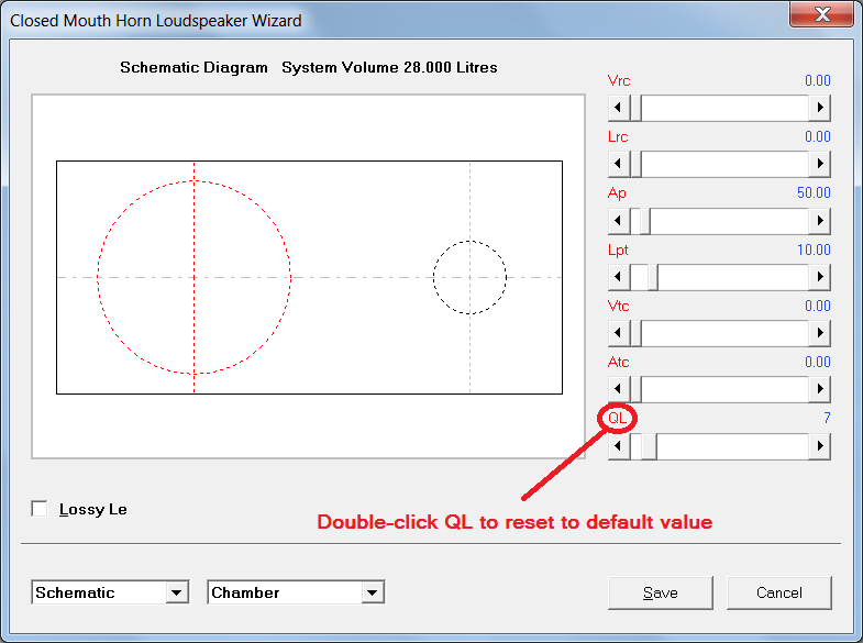

CHANGE 3
Previously the QL slider control in the Loudspeaker Wizard was reset to the default value of 7 by moving the slider to the minimum position. The slider is now reset to the default value by double-clicking the slider QL label. Attachment 4 refers.

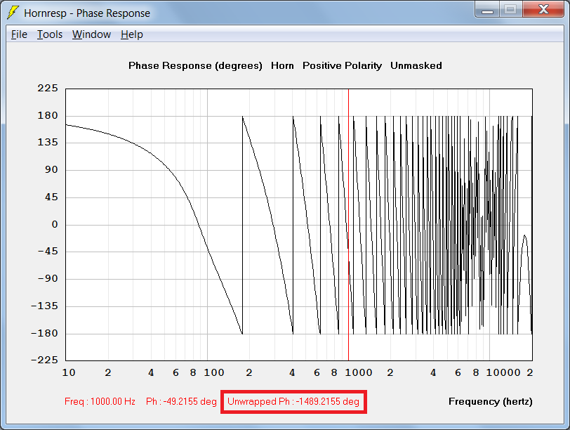

CHANGE 4

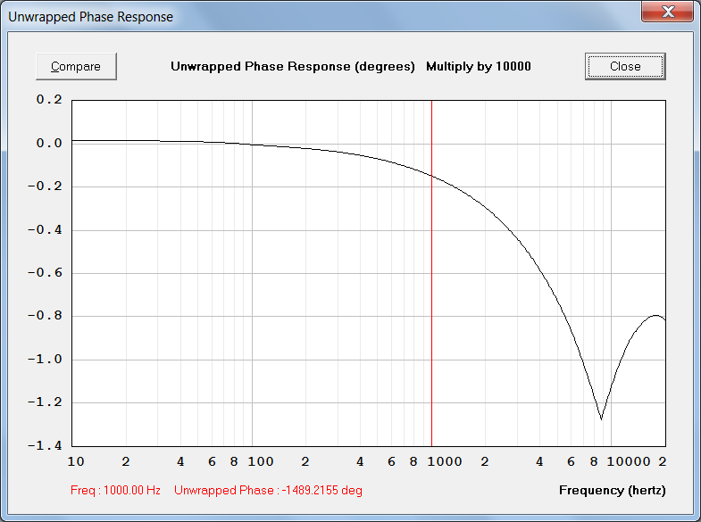

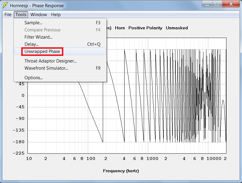

When the phase response chart is sampled by single-clicking the chart, the unwrapped phase shift is now also shown. Attachment 5 refers.
Unwrapped phase values are now also included in the Chart Data export file.
CHANGE 5
Unwrapped phase can now be displayed on a secondary chart accessed from the phase response chart window, as shown in Attachments 6 and 7.

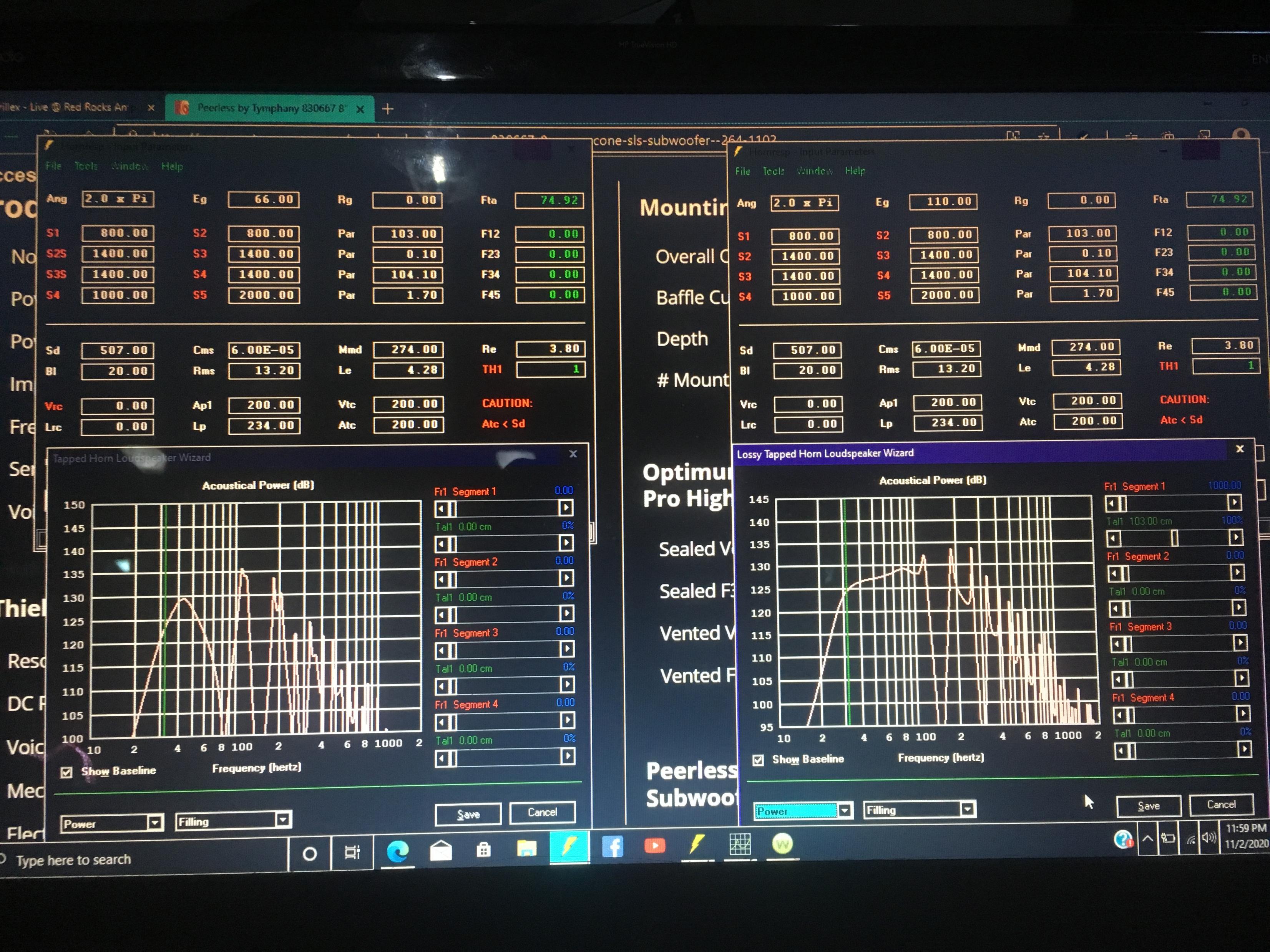

Will this void exist if i unstuffed/stuffed this with 900 Units Dacron per the density and location? If so it is exactly what I been looking for for 18 months now and internet to use this to show combat veterans and families the results of PTSD trauma (by sound ) in therapy. Is this real or possible?
Please advice and thank you in advance !!!
It is neither. You have specified a tapped horn with a 1 millimetre path length between the front and rear sides of the diaphragm.
Of course. But I can just add a basket and a port exit to that.... so go ahead... now what?? Is it still
Amazing??? I wanna build this it so drastically different! Or am I being an idiot?

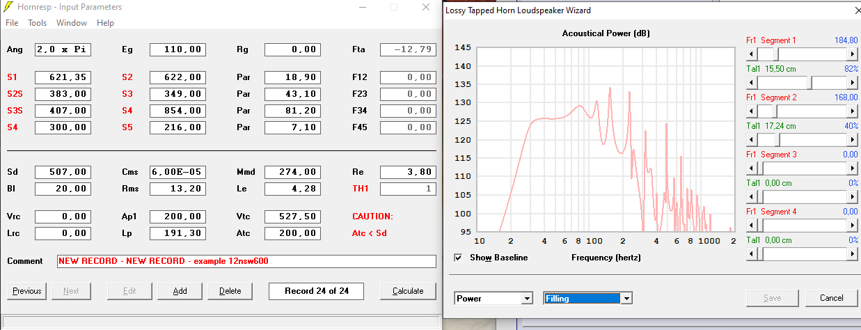

216cm² output. Look at mouth air velocity. It's 60m/s @ 35hz.And this is a lot of lost space. Here the same response shape below 150hz with 120L, and way less stuffing. Not optimized at all, it was just to play hornresp shapping curves as yours with less volume.
But still the same port chuffing/compression issue from segment area at really high power; it depend whether it's a concern or not for you.

I am having difficulty understanding what you have in mind. Perhaps just build a prototype to see if it matches the predictions (assuming of course that the built system accurately matches the simulation model).
In it sim, there's Vtc=200 atc=200 AP1=200 with Lp=200. Maybe you didn't notice, as I at first ?I am having difficulty understanding what you have in mind. Perhaps just build a prototype to see if it matches the predictions (assuming of course that the built system accurately matches the simulation model).
Yes. A qw path already established and well known for this driver as a popular ‘tL’ is placed in the AP1 and ATC areas...
