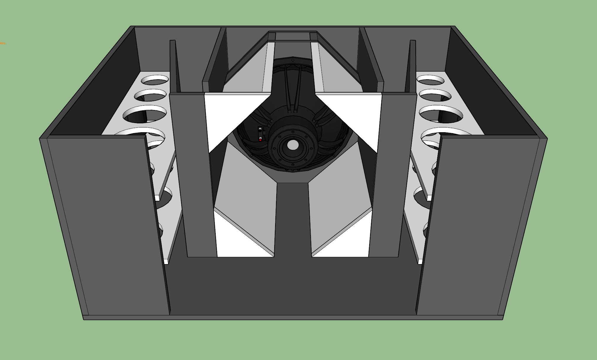

Horn response is still trapped in a very very difficult to ‘envision’ what is occurring I’m sorry(reluctant) to say. The ‘system model’ and/or schematics simply are not helpful past very simple design ideas for most people.. all as separates a d screens ... it all needs to somehow be integrated into something that actively shows a different view or orientation... I’m So sorry to be ’negative, and It has always has been very good to Me, (I am a devoted and frequent user however, so I don’t count, but it simply isn’t catching on to the ‘new’ comers and new wave of DIY people... it is only a visual handicap of sorts, but it is a brick wall to so many people it seems(the are intimidated by it being almost impossible to ‘envision mentally what they are constructing after a single chamber/ vent or similar (untapped)...
I know ‘akabak’ is an option, and a fair statement, but I don’t change favorite baseball teams because the NY Yankees win one season and the San Francisco giants the next🙂 I wish I was more help than ‘complaints’. I will strive to come up with helpful ideas not just thoughts or opinions, but I simply haven’t a clue how to support or side this software and it’s inner maths🙂. nevertheless, David, much love to OZ always. Your a wonderful human, many thanks always

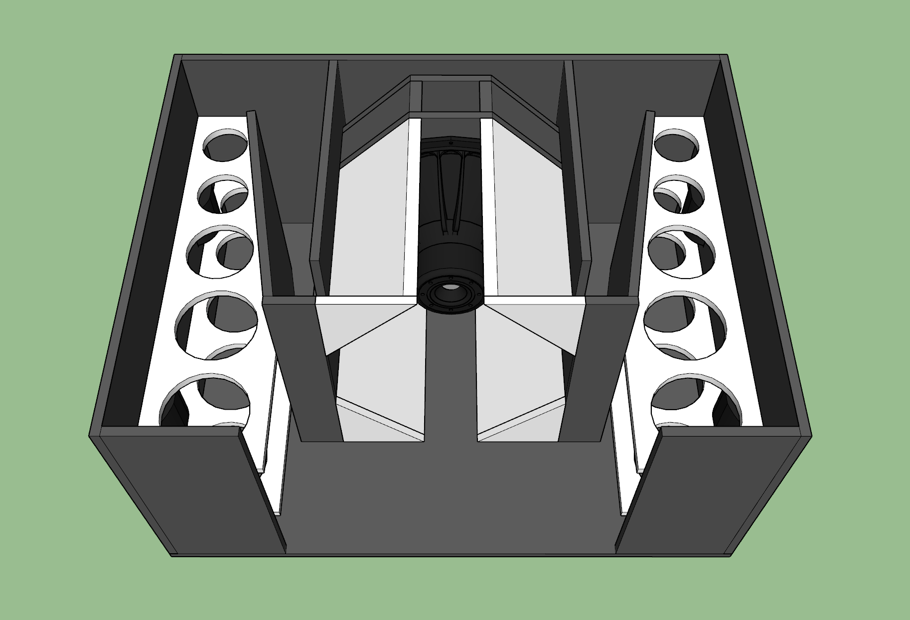

The 200 cm2 at 234cm is established. The fun is cutting this in half and building two unique to compare (science) classroom for vocational college and a few other things more ‘personal projects of interest. the ‘roar’ and ‘paraflex’ higher order qw pipe/compound versions to compare resonate chambers, decay, etc of the quick and energetic type of bass deliveries they generate. I’m not very particular, I seem to like a lot of people’s ideas... all surround your ‘tapped horn’ sim In one way or another 😀. Too much fun David! You create too much fun.. I *think’* writing your own software might be similar? Even better potentially!! Maybe someday.. I’m far behind the computer tech of today already though. And I like saw dust and metallic sparks too much
Give ‘AP1’/AP2’ in TH1/TH? A ‘con/par/exp option instead of L12par/con/exp? BP1 fanatic already went here.... I apologize if I’m not helping or adding any type of possible aid to the cause/purpose.
Maybe all stubs can be cylinder segment shapes in TH/TH1? they are parabolic otherwise if in a wooden box I suppose and only serve as a upstream addition to the main qw pipe/horns ‘path function? In PA speakers the motor side is often offset in an octogan or eight sided pyramid/prism? which is nearly a cylinder.
(Only Thinking out loud, as usual, the grains of salt/sand but not without a motive or pondering yet another handful of ways to spread horn response’ diverse oasis into the arid desert of creative diy speaker building and experiments turbidity to stalling 🙂. Have we have almost made all the boxes and funny shaped tunnels possible?? DsP is the only thing left and it’s here to save the ‘MDF’ (haha)tree from extinction, lol
‘Path’ in OD ‘closed mouth’ is stuck at the L23/34 distance as if it’s unfolded? I’m such a whiner! 😀

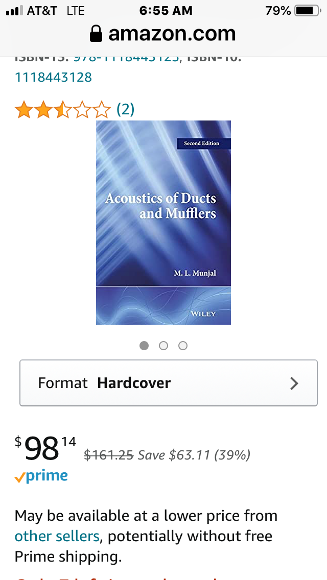

Anything like this in your reference library of documents David?
Nothing specifically on muffler theory.
Flowmaster and Hooker Aero Chamber mufflers use similar principles to BP8 enclosures to quiet exhaust noise without using fiberglass packing and perforated tubes like Dynomax, Magnaflow, Cherrybomb, or most motorcycle exhausts.

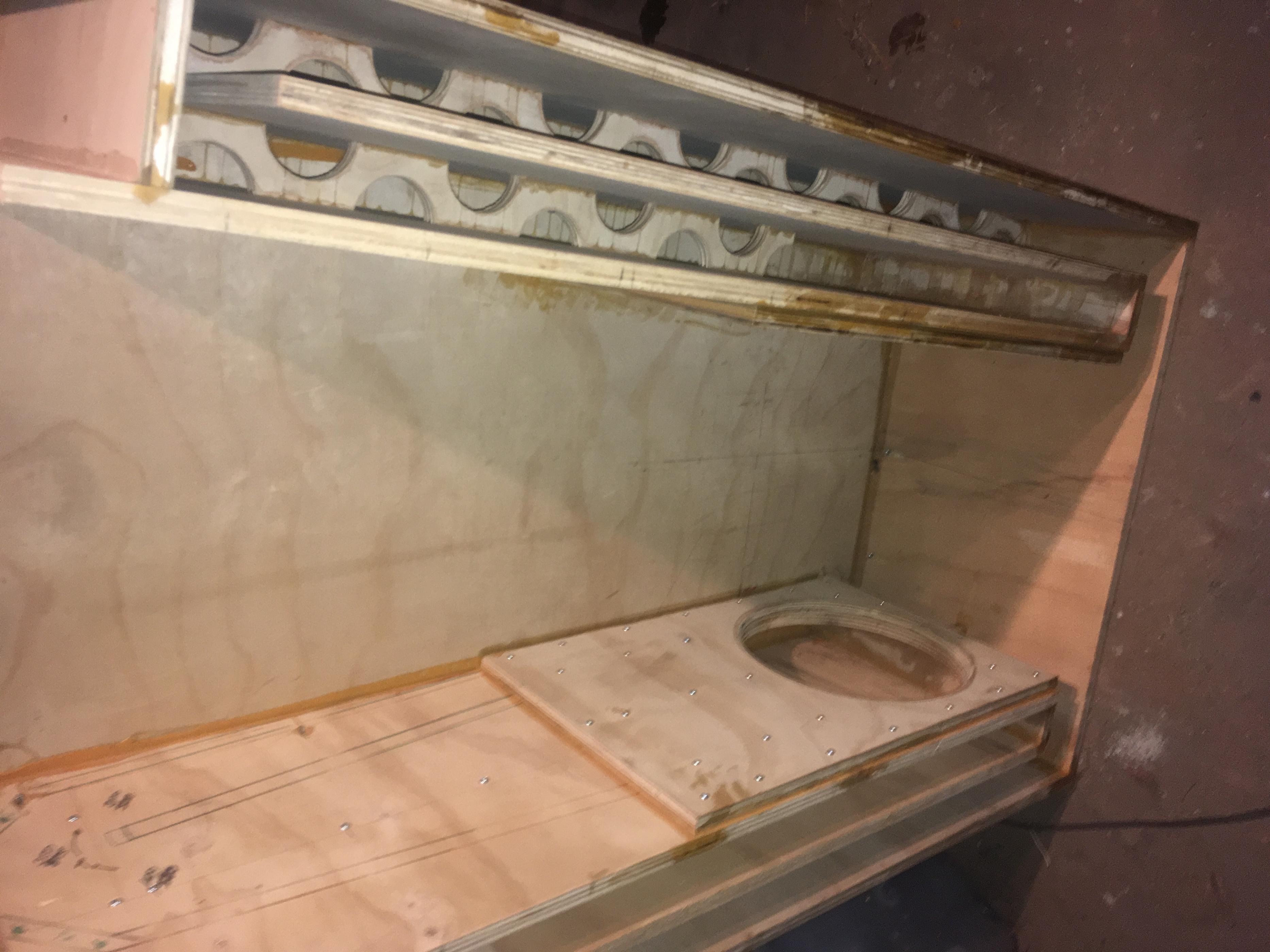

^^^Here’s a good little build and fun read/project. why ‘automatic might limit the shorter designs or the method by which they are created using a ‘path’. One usually must akniwkege if ‘full Range or similar? if given a choice. Or if trying to place a chamber or driver in the area where a nul(3/4or 5/4 H with Fb) that ‘path’ fades away in the diluted listening position or method of applying it to the radiator and vent.(?). David, this one is a good read for you sir. Some well deserved appreciation is Expressed by Kirk for you in the project section and horn resp in his speaker build report😀. They speaker is actually quite unique. We simmed it together as we share ideas often. Or he’s my last chance sim ‘checker’ prior to making wooden mistakes (or lack of)and it reverses for me to him often as well...
We took this idea further now and Into subwoofers with tapped entries... with ideas from ROAR and others famous peoples work. . but this speaker was a match or a spark for Kirk I think... he noticed ‘offset’ working in a new way or location and trying to avoid a long ‘path’ was needed as the mass loaded small exit window used created a short bookshelf speaker out of the otherwise offset and expanding taper toward exit(voight or similar style) was really neat to apply(but needed to manipulate ‘path’, to accommodate a bookshelf speaker instead of a long skinny there or something...
Long story short... adjusting ‘path ‘ is something very popular it seems lately. Lots of ways to fix or kill a resonance in that sim and for some reason its
Very ‘easy’ or cones to the designer quickly in the OD closed mouth (Ap/Lp version. It’s very Special, if I may. Hands down the best TLs I’ve ever made come out of that sim (and it’s only a few months old if I recall) ? A lot of the bookshelf designs will value this sim above all other I think. You made a gem here sir! It creates opportunities!
I encourage anyone to read the link to Kirk’s build and look at David’s OD closed mouth sim, as an option always. Always check it if making a TL for any reason. You might find that offset exit and driver location is a real treat !!🙂. Especially full range or midbass speaker needs?? Give it a looksee when you get a chance. It’ll create a buttery smooth response more often than not if you use both offsets to an advantage and stuffing..

I can’t wait to get this book then... i have made some JUNK motorcycle mufflers, lol. Re: LOUD Vtwin, albeit, not a Harley Davidson or Buell. I’ll have to screen shot anything good I find for your bp4/6/8 endeavors. I’ve read the Nasa(NACA ) version and it was pretty good food and I passed it on from Greg to others (just hard to read old xerox DoD documents was the thing I ran into (farly near sighted but dyslexis and cross eyed while also being a cyclops and on a iPhone SE instead of the computer mostly). I hate it when I gotta ask my son to read the socket sizes for me!. Edie specially if I think it might be the dreaded Toyota 10mm ghost!! Haaaaa ha!! why? always 10mm.... and then clanking in the dryer cause 3 of them are in my pants pocket or something...
