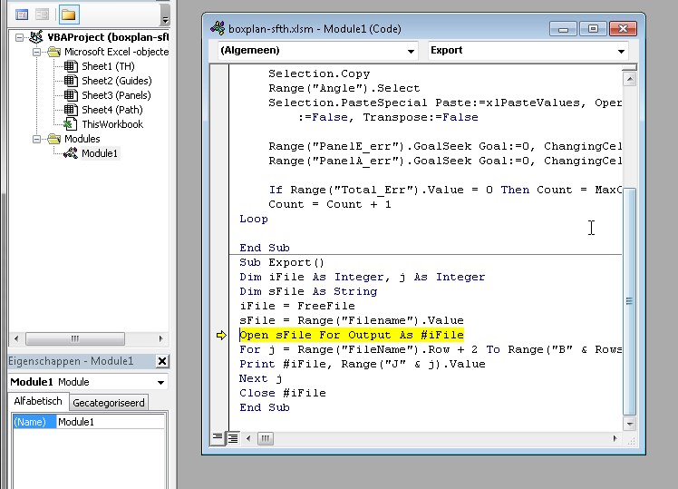

Hi there
That is nice software.
I have download a file for calculation but get a error with it's visual basic, it remember this was also with a exel for resonant smps amybe something is not installed here. I use windows7.
For calculation of a band pass subwoofer can David tell me how? did see in other that it is in tab where to choose system like TH, OD etc. There was also BP but is this gone?
regards
regards

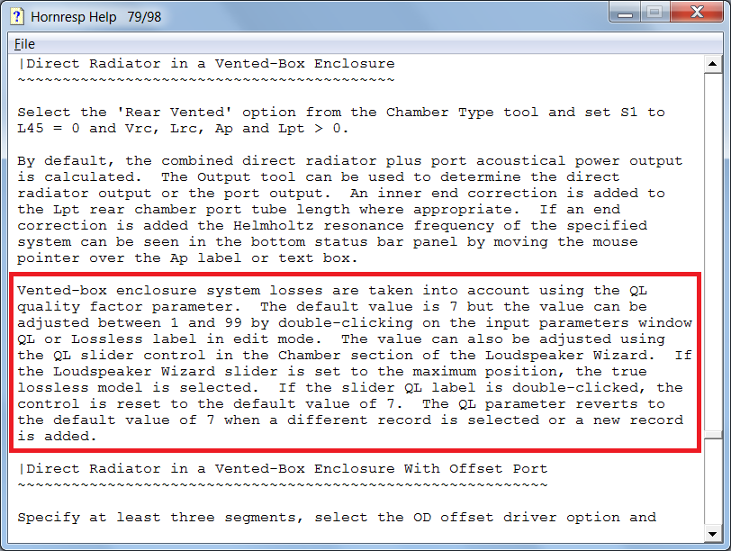

Could someone help me understand why the QL quality factor setting only applies to a vented enclosure in hornresp?
I understand its to do with the real world losses and gives a more realistic prediction, most notably how xmax doesn't drop to zero at tuning anymore which results in less output and lower port velocity, exactly how we see in the real world
But where i'm confused is why it doesn't apply to horns or in the bandpass wizard, they both have the large spike in output and the zero xmax at tuning which obviously isn't how they're going to actually perform
Is there a way to add the losses to horns/bandpass enclosures that i'm not seeing? if hornresp doesn't have this option is it something we could expect to be added one day?
maybe i'm looking at this all wrong but having losses on horns/bandpass enclosures would give us much more realistic predictions like with the vented enclosures
I ask all this because i'm wanting to build a vented enclosure and a transmission line enclosure with as close of a predicted output as possible to compare against each other, but with one being calculated with losses and the other lossless i'm finding it quite difficult

Hi there
Please use the following thread for assistance with the BOXPLAN workbooks. David's "Hornresp" thread is long enough...

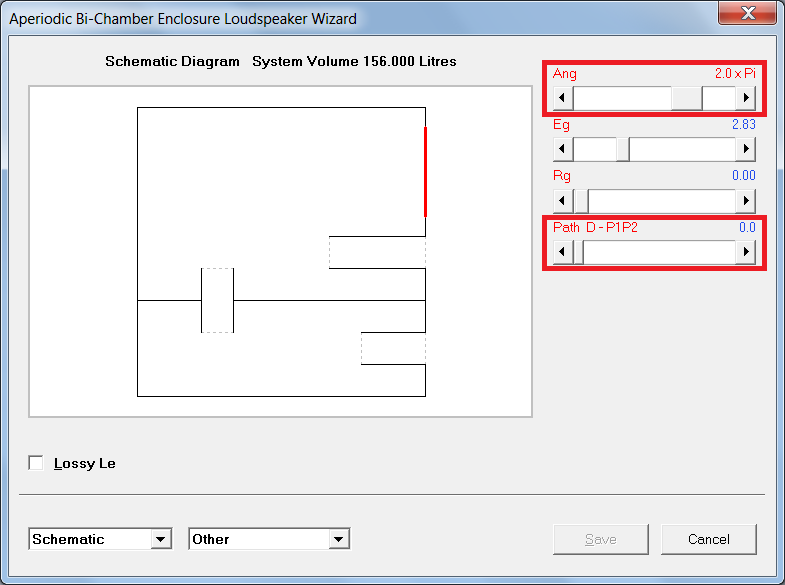

Hi Everyone,

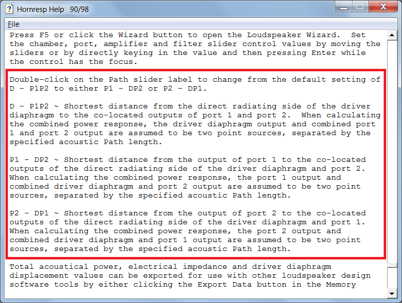

CHANGE 1
Ang and Path sliders have been added to the band pass wizard. Ang applies to all models, Path applies to BP6P, BPA, BPC, DBR and ABC models.
ABC has three path options (D - P1P2, P1 - DP2 and P2 - DP1). See the Help file for further details.

Hi Everyone,
CHANGE 1

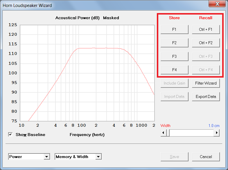

I do that sometimes, but only to be able to do a quick side by side comparison of the effects of some change in design.
If working in the Loudspeaker Wizard, up to four different sets of results can be temporarily stored and recalled for comparison purposes by pressing key F1 to F4 to store, and keys Ctrl+F1 to Ctrl+F4 to recall.

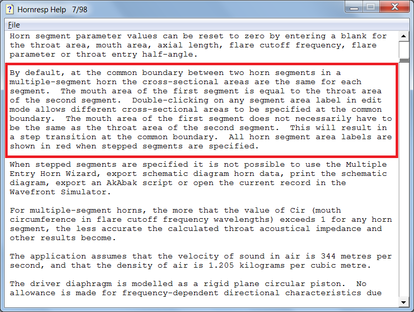

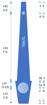

Hornresp doesnt handle the stepped design into a tapered line
Have you tried using the stepped segment option?

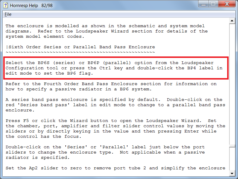

It's in the Help file...
For comparison purposes, simply set QL to Lossless...
Sure, that would work in this specific scenario, but what about when just building a horn or bandpass enclosure in general? they don't appear to have any compression losses in the prediction, leading to much higher peaks in the response and extremely high port velocity
The QL quality factor parameter used in Hornresp only applies to standard bass-reflex type enclosures (see the post linked below for further information). As indicated in the Help file, system transmission losses are otherwise assumed to be zero. I suspect that it would not be an easy task to accurately predict horn loudspeaker internal losses. The best that Hornresp can do in this regard is to allow the user to specify absorbent filling material in the horn segments, and to observe the effect on the results.
https://www.diyaudio.com/forums/subwoofers/119854-hornresp-1100.html#post6308267
Yes, but it only cater for straight/cylindrical segments. It can´t really cater what I like to build. See picture below. The stepped cylindrical approach has a quite different spl result from my design.

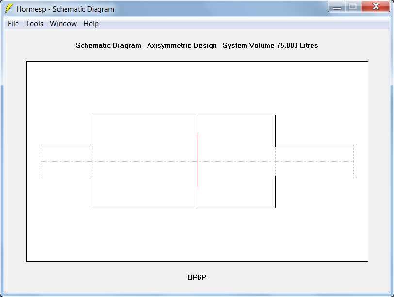

is it possible to simulate a 6th order parallel bandpass with pipes instead of helmholtz resonator chambers in hornresp?
I think that would be a combination of "Loudspeaker Wizard"->"Power"->"Output1" of two transmissionlines with one driver connecting them.
Thanks!
Thanks!
By "pipes", I assume that you mean segments?
If so, then a BP6P system can be modelled as a compound horn (CH).

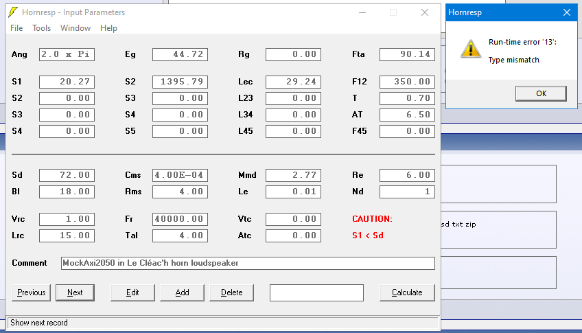

Runtime Error 13 on certain sims after update?
Do you have a specific design that generates the error, that I could use for testing purposes?
