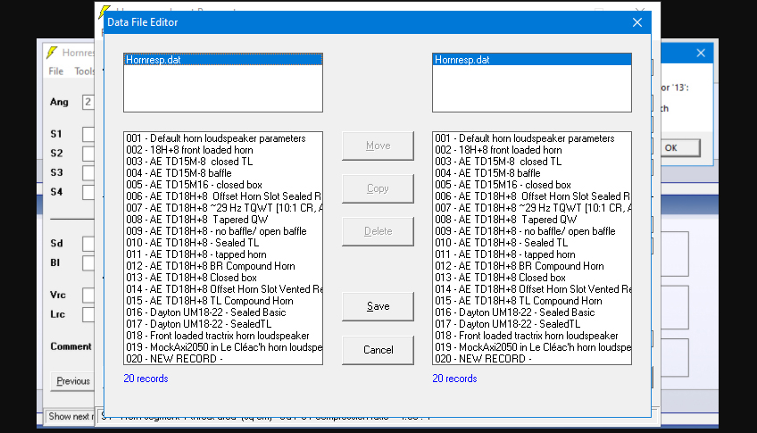

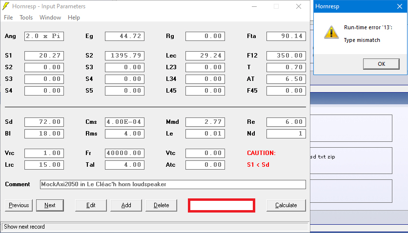

Your Hornresp.dat data file appears to have been corrupted - notice how in Attachment 1 there are no record number details displayed.
Your Lec design works just fine for me, as shown in Attachment 2.

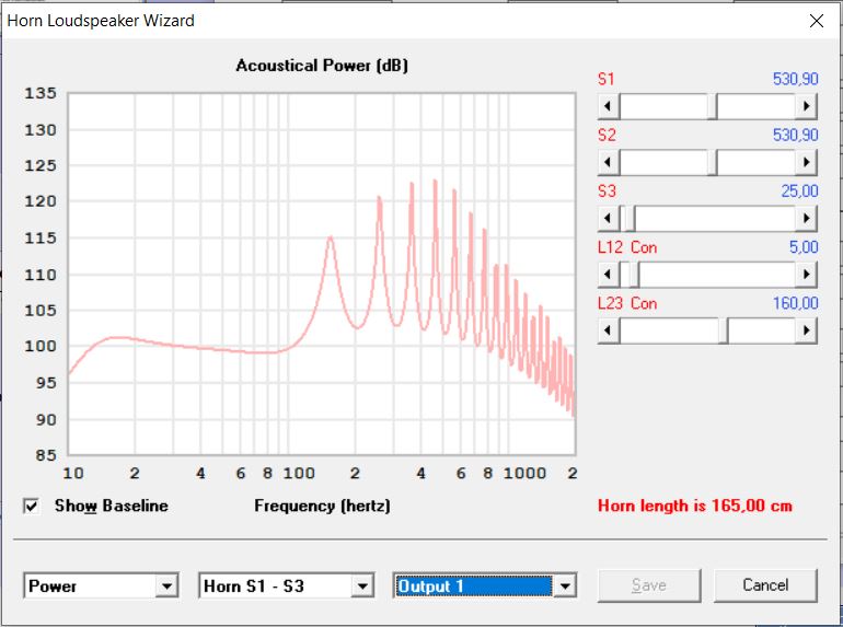

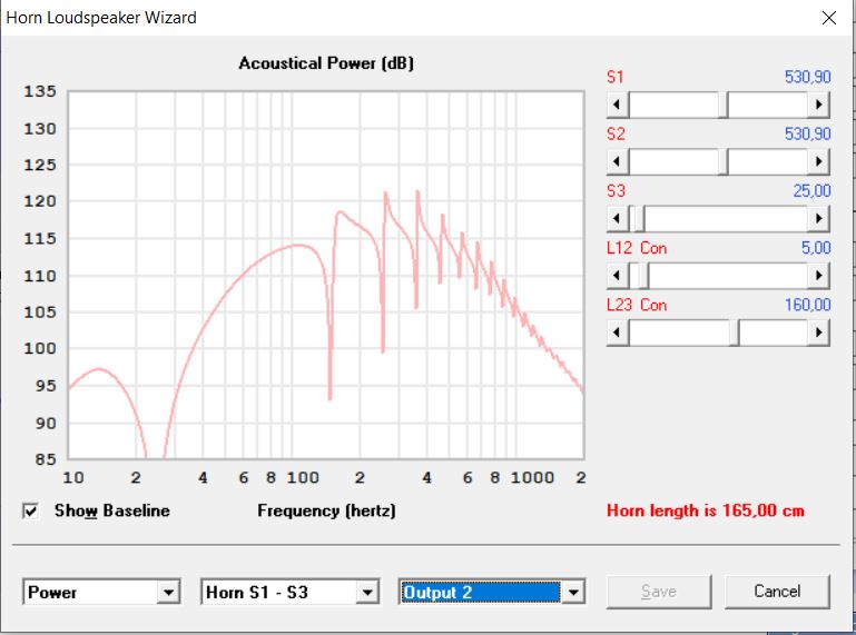

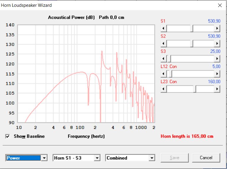

I am working on an Nautilus shape subwoofer, both with finite element analysis and HornResp.
Nautilus Speaker - Finite element simulation
I have some doubts about understanding the results. Supposing a sealed subwoofer, I choosed:
Tools -> Chamber Type -> Rear Lined
A understood this is for sealed enclousure
Then looking into Power response, we have Output1, output 2 and Convined. I attach some ilustration.
Should I consider only Output 1 (driver output?) and forget about Output2 (port output) and Combined for sealed enclusure?
Than you
I just realized that the pictured project is loaded and its only when I click next, does the error come, so project 20 out of 20 is corrupt...the only difference between now and yesterdays message is that I happened upon the "Sort" command.....My projects are now undesirably sorted but it moved the corrupt project to position 20 out of 20.....the MockAxi project shown in the picture loads...once again, only when I click next does the error appear....so I went to the editor and deleted it...
attachment.php
If I change the numbers I can re-sort my projects?
Not sure what you mean by changing the numbers. Suggest you do the following:
1. Create a new data file named Hornresp1.dat using the File > New menu.
2. Use the Data File Editor to copy records in the desired order from Hornresp.dat to Hornresp1.dat.
3. Close Hornresp.
4. Delete the Hornresp.dat file.
5. Rename Hornresp1.dat as Hornresp.dat

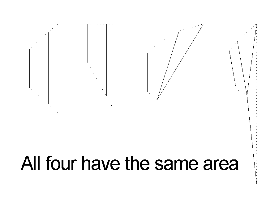

Folding while preserving sim results...can preserve volume, but not length
I doesn't appear to be enough to merely preserve volume while folding a horn into a cabinet in order to preserve the Hornresp sim results. Folding lengthens the horn. But it's impossible to know the ultimate length until the design is complete.
See the attached image for clarity. Given a horn profile defined by a sequence vertical dimensions at, say, 2cm intervals (cabinet width is constant), all four examples have the same area (& thus volume), however, the lengths are different if you use the advanced centerline method, which appears to connect the center points of each of the vertical "ribs" (?).
I can re-simulate with the new length and see what damage I've done to my beautiful Hornresp results, but iteratively changing the design is very time consuming. Is there a better way?
Many thanks!
I doesn't appear to be enough to merely preserve volume while folding a horn into a cabinet in order to preserve the Hornresp sim results. Folding lengthens the horn. ...................... Is there a better way?
