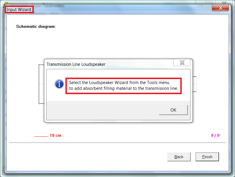

When you first start Hornresp there is a Help tab top far left.
Click on it. Second down is the input wizard.
Click on it.
Choose half space to match normal simulation conditions.
Choose direct radiator.
Choose transmission line
Choose mass loaded
First segment choose Parabolic
Second segment choose parabolic
The input driver parameters are for the standard Hornresp driver. You will have to enter your driver parameters in there.
You can modify the stuffing and the section profiles in either the input screen or the Loudspeaker Wizard under tools menu.
This will at least get you started.

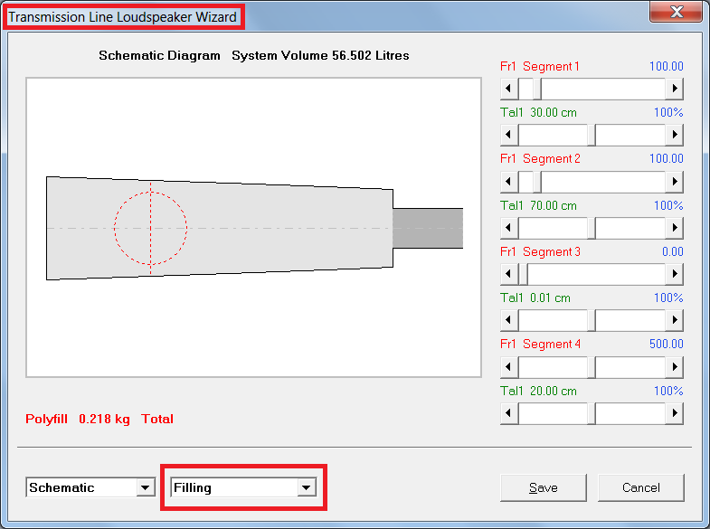

I have started the software and made some graphs with a woofer and something that I could like. The figures went crazy, to many reasons. I didn’t figure out (in the ten minutes I used it) how to insert damping. I will certainly read the manual. I just couldn’t see how I could import anything from MathCad.
Thanks!
You won't be able to import anything from mathcad. But looking at your design you can simulate it if you know the dimensions.
It is done using the Loudspeaker Wizard - see attachments.

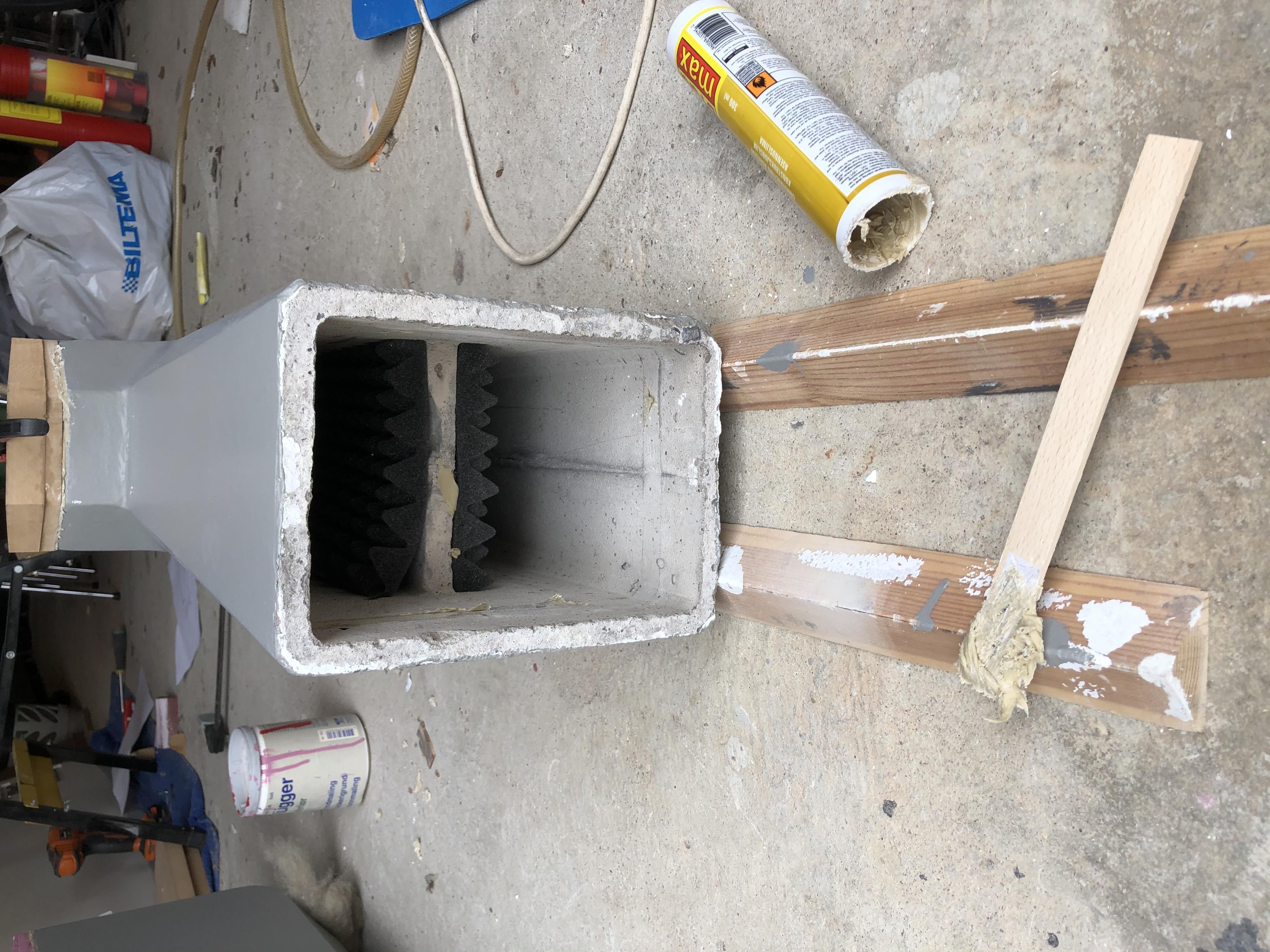

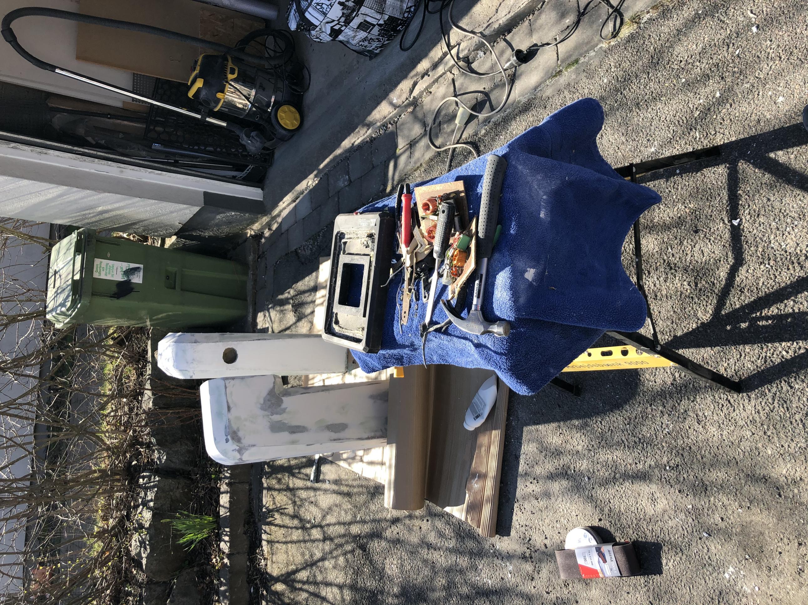

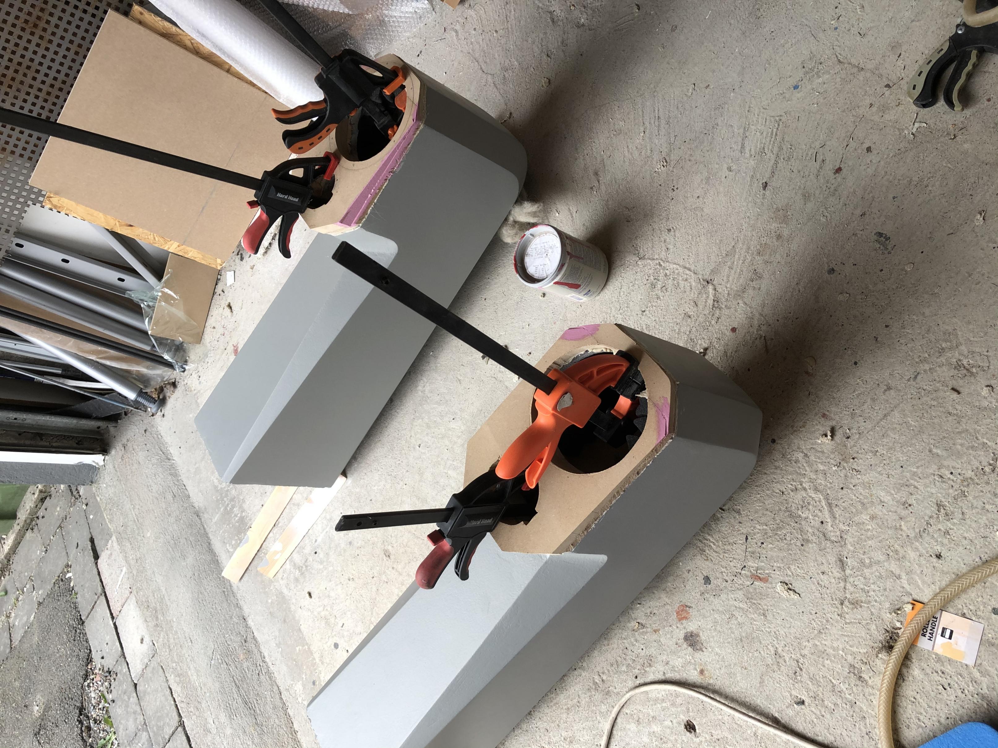

Been doing HiFi projects since I was 8, which was 1964 but only from “just doing what seem reasonable” or from someone else’s design. Last totally new Elsinores (from this DIY site), lately a total remake of Rauna Leira, which inspired me to look at a tapered MLTL design. Paul Kittinger made me this enclosed design. The Leira (or ET as my woofer call it) strange look is a consequence of wanting a chamber with back part of the pipe going all the way up. I wanted a chamber but not the ET look and ended up here. See below pictures
The big Elsinores are really great but biiiiiig. I was thinking of surprise her with a smaller build. The grey ones, ET (as my wife call them) are for our weekdays home (just tested alongside the Elsinores). They are originally made by a legendary speaker designer/producer in the 70s without basically no calculations and computing. Made with a concrete and some polyester mixture. Really dead material. Totally re-modelled with new drivers, xo and damping a few years ago by the guys who bought Mr Hansson’s company. I bought the kit for the speakers and renovated them to modern fairly good standard.Nice speakers!

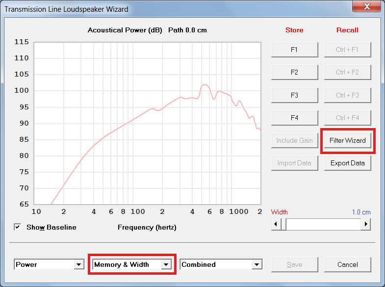

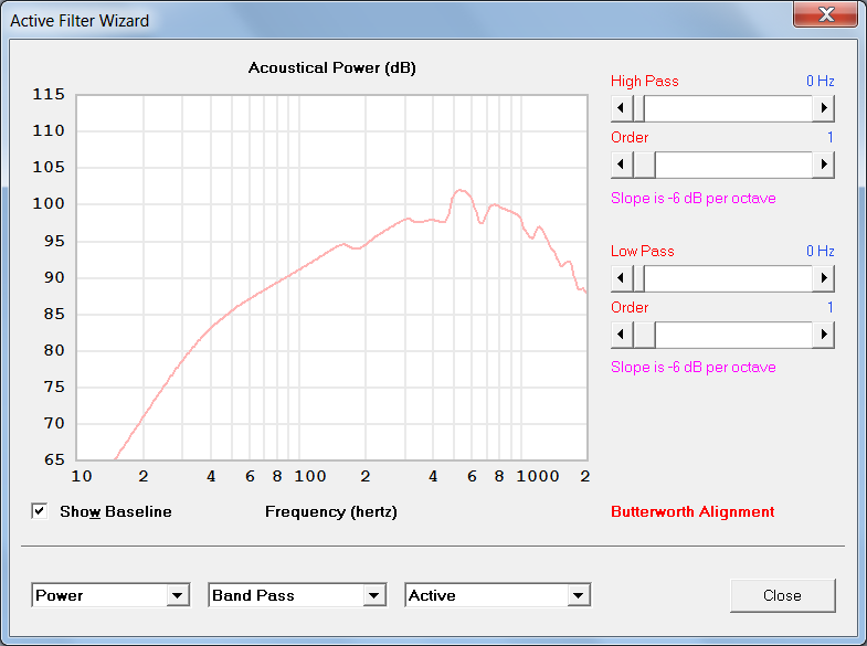

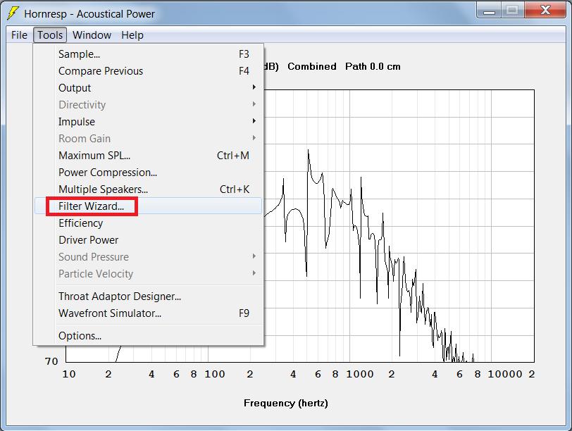

Have you tried using the Hornresp filter wizard?
If a passive rather than an active filter is required, it can only be specified from the main output windows. The effect of absorbent filling material will not be included in that case.
I have a similar question on that. I'd like to calculate the impact of a serial crossover from a 2-way speaker on the HR simulation of the woofer.
I'm interested mostly in the low bass impact, so a passive series coil in th HR filter
might do?
Even if it does, as the filling is not calculated it might not give that much usable information.

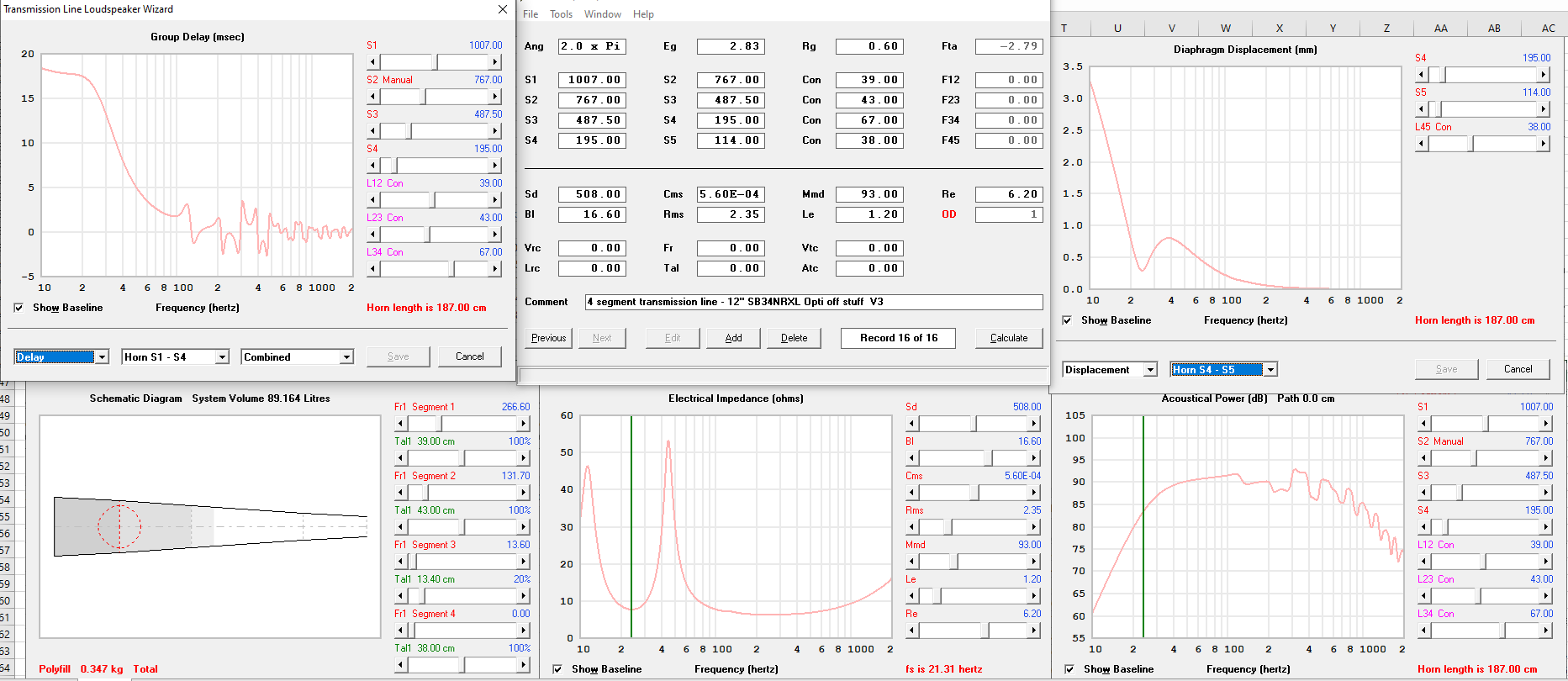

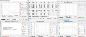

I am now simulating and closing in the design of my first DIY louspeaker ever, a 12"/6.5"/1"+WG design! I' m more excited than my wife, to say the least 🙂
I am here trying to design a TL for the SB34NRXL from SBacoustics, and did a 1:10 scaled drawing, and entered pretty accurate areas and length into HornResp via 4 segment transmission line.
Transmission Line properties:
Length=1m87
Offset=0.21
Tapper=1:8.8
Volume=89L
Driver properties:
Qes (after inductors) =~0.35
Fs(free air)=22Hz
Vas=205L
I heard that a TL would be optimized when both impedance peaks are of same height. Not sure why. Is that true?
My design goals are deep and articulate bass, and keep a high sensitivity to avoid as much attenuation as possible on the 6.5" MR16P-4 mid.
I have a hard time knowing if I got a line length too long or if my volume is too large.
I know it depends on design goal, but let me know if you see something off.
Also, I am not too worried about the ripple above 200Hz as the line is a 3-fold (not simulated by HornResp). Shoudl I be more worried? 🙂
Length=1m87
Offset=0.21
Tapper=1:8.8
Volume=89L
Driver properties:
Fs(free air)=22Hz
Vas=205L

I'm interested mostly in the low bass impact, so a passive series coil in th HR filter might do?
If all you require is a passive series coil, then just add the series inductance value to the driver Le. That way, you can still use the loudspeaker wizard to include filling.
