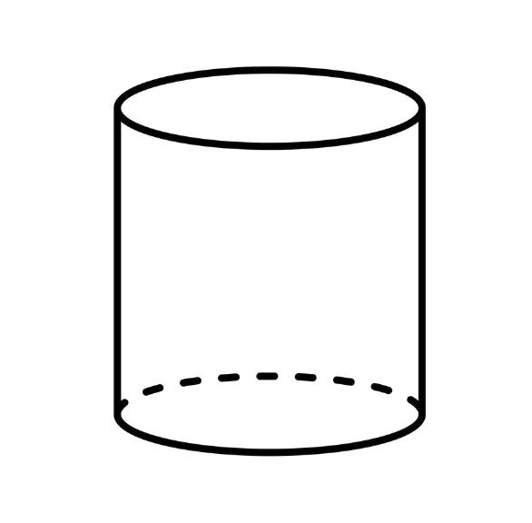

Am I to understand that Vrc, Lrc, Ap, Lpt, Ap1, Lp, S1-S5, and L12-L45 are all cylinder sections? If so, then sq cm and Par are throwing me off. Cylinder makes me think diameter instead of sq cm. Parabolic is not a cylinder profile.
A cylinder is a three-dimensional shape, as shown in the attachment. It is round and has a top and bottom in the shape of a circle. The top and bottom are flat and always the same size. A cylinder can be described using length, area and volume parameters.
The Hornresp simulation models assume that all ports and segments are axisymmetric - that is, that they are symmetrical relative to the axis, and have circular cross-sections.

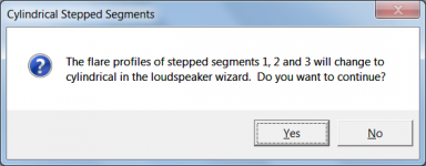

Stepped segment are awesome. I don't manage to understand the problem as it is so much easy to switch off even for wizard.
Stepped segments are indeed an excellent part of the program and sometimes allow a more accurate portrayal of an easier build architecture in steps that can be placed at folds in a line instead off folding up an assumed constant smooth taper throughout the length of a TL. Merely measuring width at the beginning and end of a segment(folded section) to verify accurate instead of spreading a taper out evenly through multiple turns and possibilities. If lucky you can even drop the driver offset at the first turn.
Instead of nickel and diming a design through folds and turns trying to create the taper or flare entered in the sim. It can simply be segments of the same CSA throat to mouth for each L12,23,34.... in a grouped taper or flare.
I don’t know if that helps anyone but it’s applicable in everything from pvc pipe sections and couplers to a wooden box full of rectangles. So far so good in a half dozen or so using this approach?
Hi Booger weldz,
I am sure that Mårten would agree with you that the stepped segment functionality can be very useful. His key concern I think, is that what is specified on the main input parameters window can sometimes change in the loudspeaker wizard (depending on what was originally specified), so that the system simulated in the wizard becomes different to the one the user intended. My view is that even though this can happen, it is still beneficial to retain the feature so that absorbent filling material can be added to those stepped designs that do not change.
It is really just a question of the user understanding the limitations of the tool...

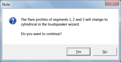

It’s bit me a couple times before I realized what was happening in and out of ‘wizard’. But knowing that ahead of time, there is no major upsets in things and /or problem and if that’s a slight necessary evil to an otherwise priceless feature than I say well done(once again). Btw, the recent offset port feature in OD ‘closed’ is another brilliant addition that allows a great many opportunities to explore cancelation/supportive standing waves from two closed ends and the associated length/area creating a fundamental and harmonics off each. 🙏 exciting stuff David!
Hi Booger weldz,
In an attempt to reduce the potential for confusion, in the next update Hornresp will check the input parameters window stepped segment design before the loudspeaker wizard opens, and display a context-sensitive warning message when required. Hopefully this will also go some way towards allaying Mårten's concerns. An example of one of the proposed messages is shown in the attachment.
Stay safe,
David

Hornresp now checks stepped segment designs before the loudspeaker wizard opens, and when required, displays a context-sensitive warning message as shown in the Attachment 1 example.

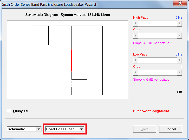

This has probably been asked before, but this topic is just to huge and the search wasn't really helpful:
So I simulated a bandpass and finally got in nailed down to something I'd like. Now however I seem to stuck with the wizard. How can I now do a MaxSPL or start a Filter Wizard?
Hi 4real,
The maximum SPL option is not available with band pass loudspeaker systems. The BP wizard was added as something of an afterthought at the request of users, and the features provided are relatively limited. It does have an inbuilt active band pass filter though.
Stay safe,
David
