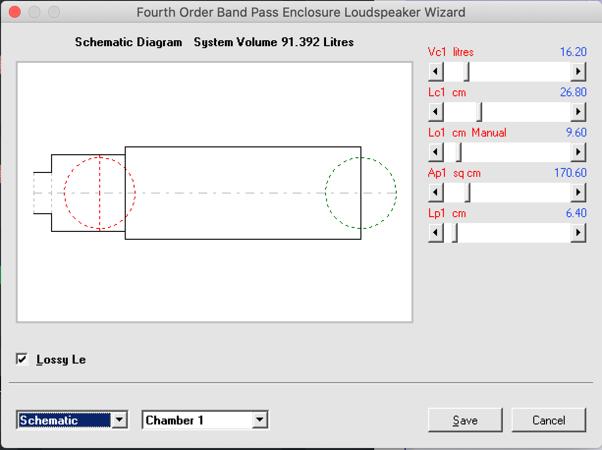

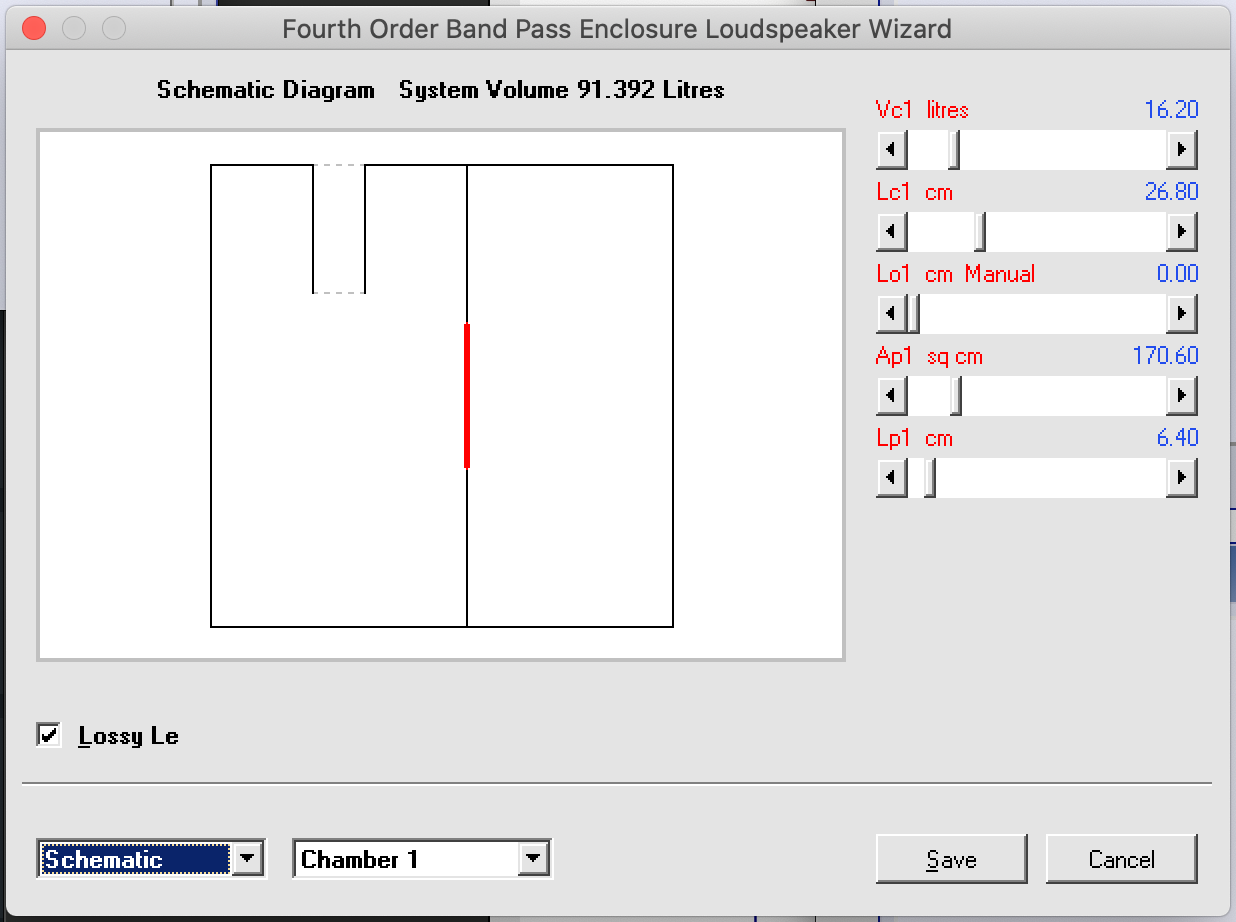

One more curious thing. When I work from the Input Wizard and go to "Schematic" I see the first picture. If I then close the Wizard, change the "Loudspeaker Configuration" to the same, then start the Wizard again, I get the 2nd picture.
This is because the driver offset parameters Lo1 and Lo2 are set to zero by default when a BP4, BP6S or BP6P band pass loudspeaker configuration is selected. In your first picture the Lo1 offset value is specified as 9.60 cm, and in your second picture Lo1 has been reset to zero because the BP4 option has been reselected.
(If the old offset values are retained, it can get quite confusing when experimenting with switching between different band pass topologies on the same record).

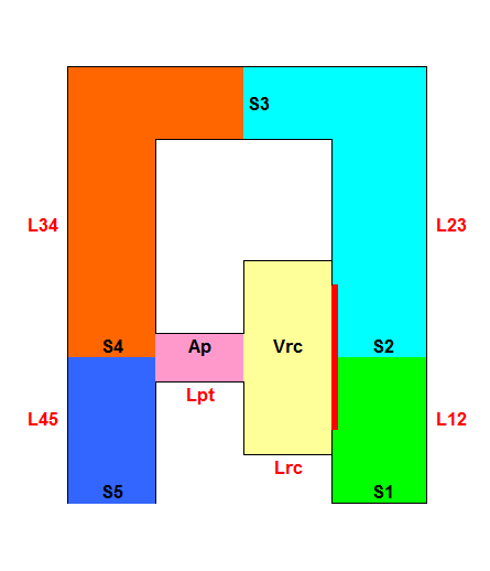

I model this in (TH) as shown. Rear vented chamber and port in yellow and orange shades. This is a constant CSA in both the port and rear chamber portions so no defining ‘port’ or ‘chamber’, just a single closed end pipe. I can shuffle the Vrc/Lrc and Ap/Lpt around and still represent the same exact thing, but through the mid section things get goofy if I split this 50/50 vs 10/90 or 90/10. But the question is what would you fellas use as shown(and adjust for any various driver positions from closed end) or just use a very long Lrc with a minimal Lpt, or? Am I technically suppose to be at the closed end or by chance is the designation of ‘port’ helping describe the driver position at various points in this as L12 is in that section? Thx!

Hi Booger weldz,

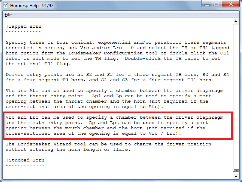

Hornresp models the rear chamber (Vrc & Lrc) and port (Ap & Lpt) in a tapped horn as shown in Attachment 1. As indicated in the Help file, the port can be omitted if the required inlet area to the horn is equal to Vrc divided by Lrc.
Not sure if this helps to answer your question 🙂.
Stay safe!
David

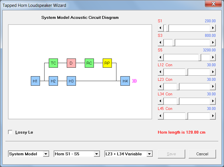

Visiual BASIC have a possible allowance for simple block diagrams in the help file?
Hi Mark,
The Hornresp Help file is purely text-based. The way that it is set up, it would be difficult to add diagrams of any sort.
What I am currently working on though, as result of the post from 'Booger weldz', is a context-sensitive "acoustic circuit" block diagram for tapped horns in the loudspeaker wizard, similar to those already provided for band pass systems. The tapped horn block diagram will be in the next release, and an example of the sort of thing I have in mind is attached.
In the diagram, H1 to H4 are the horn segments, TC is the throat chamber, D is the driver, RC is the rear chamber and RP is the rear port.
Stay safe!
David
